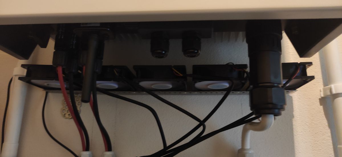

    I have a sofara 8.8 inverter with panels with a total power of 8.97.
    The inverter itself is suspended in a small boiler room in a one-story house, so the temperature inside, due to the underfloor heating in winter and water heating in summer, is always at the level of 27-28 °
    Therefore, I put 5 fans 8x8cm under the inverter and they work daily from 8 am to 5 pm.
    According to Solarman, the temperature on the inverter is in the range of 50-58 ° during the day
    I called the service and it is supposed to work up to 60 ° without grumbling. We'll see how long
  • #486 19356042
    3301
    Posts: 2100
    Help: 224
    Rate: 868
    If you have fans, it will probably not exceed 60.
  • #487 19356053

    Without fans, the temperature during the day reached 63 °, so I decided to add fans. By the way, passive cooling is probably not a very successful solution.
  • #488 19356060
    3301
    Posts: 2100
    Help: 224
    Rate: 868

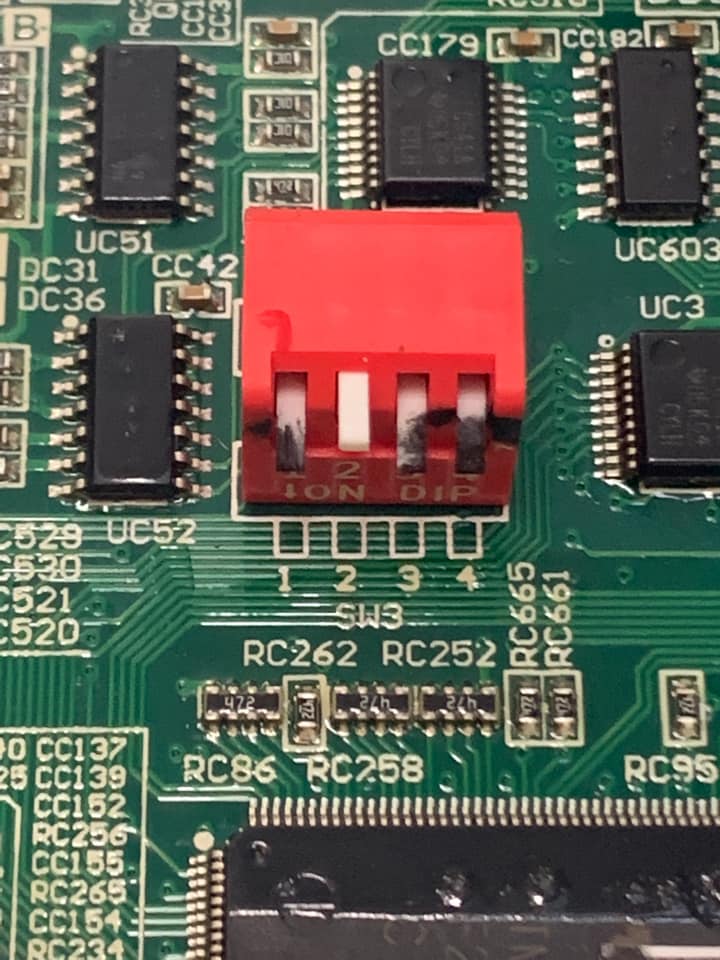

  • #499 19358359
    toolpusher
    Posts: 794
    Help: 35
    Rate: 210
    These jumpers look hot?
  • #500 19358442
    slaslo
    Posts: 185
    Help: 24
    Rate: 56
    This processor below also looks like something has burned in its structure and burned holes in the casing.
    Maybe it's some late April Fool's black joke ;) .
  • #501 19358746
    toolpusher
    Posts: 794
    Help: 35
    Rate: 210
    Maybe it's the result of switching jumpers? :twisted: :twisted:
    Edit: Everything OK - I read that the guy had black jumpers that need to be moved with the marker.

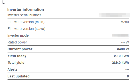

  • #509 19364881
    bioly
    Posts: 34
    Rate: 18
    I have firmware version 2.80, if someone needs it I can send it. In addition, I also have an update manual.
    Of course, everyone updates at their own risk. For me it went and I have 2.80 now
    SOFAR 8kW PV Installation: Opinions, Durability, Failures & Experiences with Inverters
  • #510 19364934
    3301
    Posts: 2100
    Help: 224
    Rate: 868
    What did you update? what was the previous soft? and what changes have you noticed after the update?
