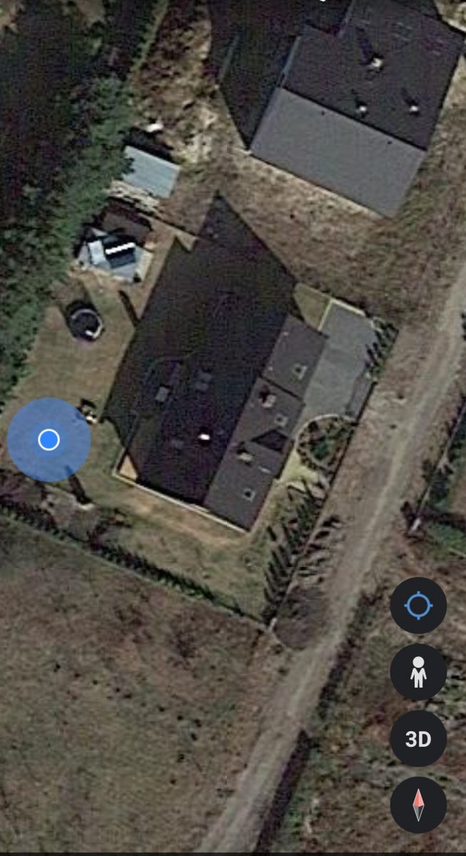

    Unfortunately, the only thing left for me is the roof, because on the south-facing plot, there may be a house that will cover the installations on the ground, and I would not like to limit the view from the south window with a rack. The garden is a shadow from my house again. The roof is large, but also difficult (chimneys and dormer windows). Rather, such a compromise remains. What is the Sofar's maximum output power of 8.8ktl-x per AC side, because I don't know after reading the thread?

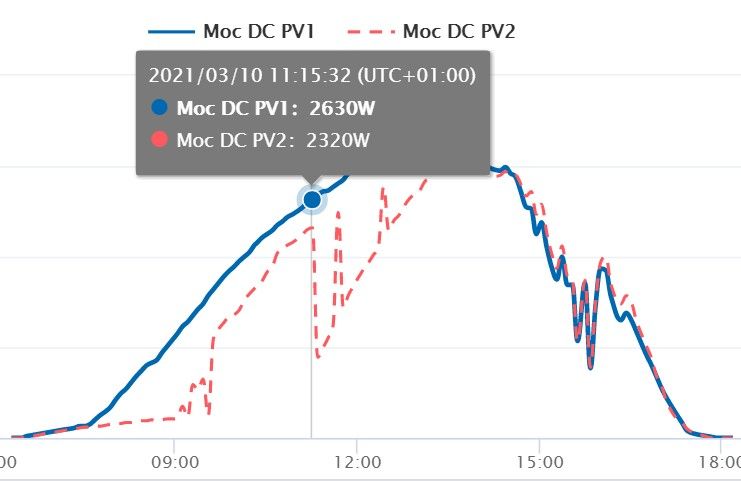

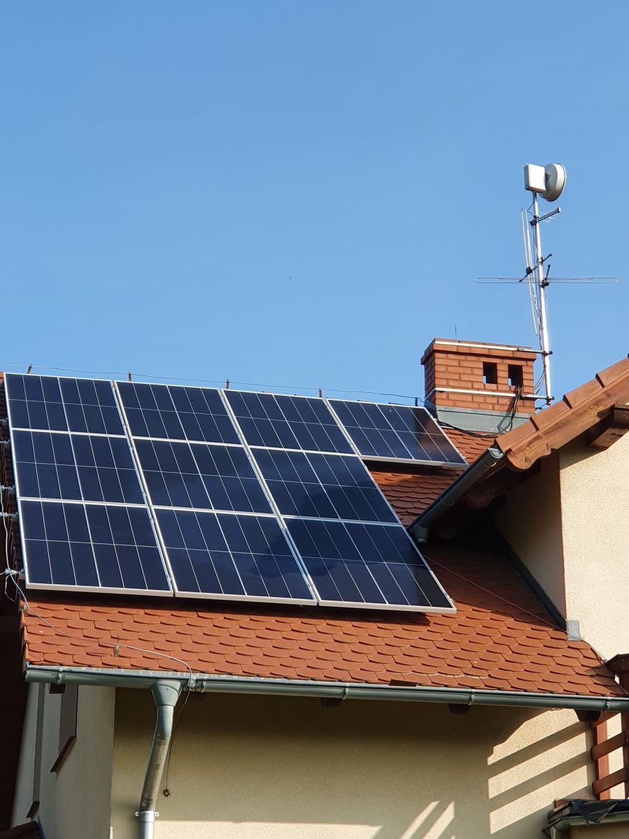

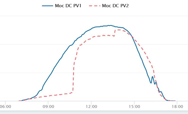

    There is only one tigo in the installation on one panel, this is the lower right panel.
    The problem appears when only this panel is shaded, while when the shadow falls on this panel plus any other in the PV2 Tigo string works ok you can see it on the charts
    SOFAR 8kW PV Installation: Opinions, Durability, Failures & Experiences with Inverters
    Before installing Tigo:
    After installing Tigo:
    SOFAR 8kW PV Installation: Opinions, Durability, Failures & Experiences with Inverters [
    With the new soft, it should give 8800VA, which is too much in your case. There is no way to expand the installation, because energy above 10kW takes 30% instead of 20% and it will not pay off.
    It is actually difficult with the ground, although I would consider at least one string in the place where there is probably a trampoline. The question of how far the shadow of the house reaches in winter. You would have easier then with it on the roof because the dormer and chimneys will also collide there.
    The power of the sofar is, as a colleague writes above, allegedly working with the new soft without cutting off at 8 kW, I have not checked it yet because I have not updated.
    Do you mean that before installing the tigo, it was generally better to shade only that one panel? You probably need to go back to work without it or install it on all panels that are shaded. I think so, but someone who has tigo mounted on some panels will say them.

    And you watched what was happening with the current and voltage in the string? Power alone doesn't say much.
    In the initial phase, it probably helps by increasing the tension. Anyway, it is then half-shaded. Then it seems to fall completely into the shadows and maybe the Tigo just turns off.
    In the off mode, the panel should bypass and it probably does not work.
    I don't have optimizers (so I don't know), you can't connect to it from the cell and see what is happening on it?

    You still have a wall to the south. You can give something vertically on it.
    Thanks for the answers.
    The place with the trampoline is exposed to shade in winter (the house is about 9 meters in the ridge), as well as from pine trees growing on the other side of the neighbor's (even in summer after 2 p.m.). The roof surface remains. The roof is difficult, but quite large (19 meters of ridge). The installer will have the opportunity to demonstrate ...

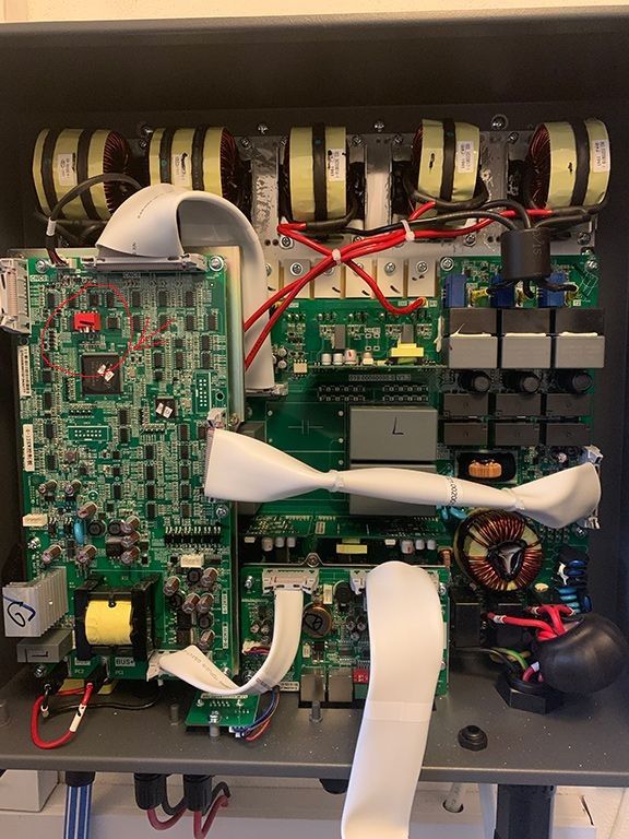

    Only switch to SW for higher power. SOFAR 8kW PV Installation: Opinions, Durability, Failures & Experiences with Inverters
    how to set up a txt file

    prose wrote:
    Just switch to SW for more power ....
    Where's that file?
    Will it change from 8.8kW 1100 to 11kW 1011?
    Someone checked if the hardware is identical?
    I also read somewhere that they are all the same, only a matter of settings, even the firmware has one for all powers. I will not check it yet, but if this is true, it is a good alternative for the future. Or you can simply oversize the power of the panels without fear that something will fall in the inverter.

    th33nd wrote:
    Where's that file?
    the sw3 switch in the 1234 positions usually has a down (1) up (0) power switch so we have settings for the power based on the photos received: 3.3kW 1001, 4.4kw 1111, 5.5kw 1110, 6.6kW 1101, 8.8kW 1100, 11kW 1011,

    According to the manufacturer, the 3.3-6.6 inverters weigh 21kg, 8.8 and more 22kg, so I would be careful with this switching.

    Because inverters are divided into power ranges, usually 3-6kW, 7-11kW, 12-15kW, etc. 3-6kW at 90% is the same inverter limited by software or DIP, as here Sofar.
    Models up to 6.6 are the same in electronics, from 8.8 there are larger chokes, in the settings you can change the inverter from 3.3 to 6.6 and then the inverter from 8.8 to 11.
