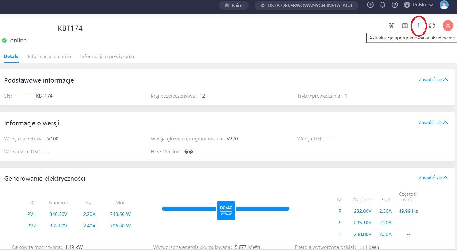

  • #518 19367003
    3301
    Posts: 2100
    Help: 224
    Rate: 868
    Cytro12 wrote:
    Sofar has no remote upgrade or management?
    Are you sure there isn't?
    I am using the website: //pro.solarmanpv.com/business and there is such an option, but in my case it did not work, I think that I am doing something wrong and I did a trip and already on, from the sd card
    • SOFAR 8kW PV Installation: Opinions, Durability, Failures & Experiences with Inverters zdalna.tom.pr.jpg (137.6 KB) You must be logged in to download this attachment.

    Cytro12
    Level 26  
    Posts: 928
    Help: 47
    Rate: 303
    I am asking because it looks like Sofar has been lagging behind today. Where are the rest of the settings?
  • #520 19367153
    toolpusher
    Posts: 794
    Help: 35
    Rate: 210
    Apparently, there is such a possibility in these new firmware, but I have not yet found anyone who would use it. In the new series of inverters marked as Generation 3, which will be launched at any moment, it will already be standard.

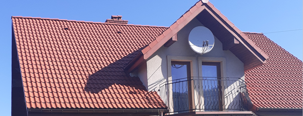

    I also plan to buy this 8.8kw sofar because now there is a good price and panels for it, I have 28 320W panels in the plan,
    allegro.pl/oferta/panele-sloneczne-320w-fotowoltaika-pv-mono-9838565937
    I counted the voltages, everything is ok, but I'm afraid that I will cut the power because the nominal power is 8,960W and I have a roof 40 degrees perfectly south, quite high because almost 400m above sea level and I'm just wondering how much the power of the panels will exceed me.
  • #536 19386216
    3301
    Posts: 2100
    Help: 224
    Rate: 868
    The inverter 8.8 is 8800 W and you have 8960 in modules.It may of course happen that it will be 100 or 105% and unfortunately the inverter will limit to 8800 but it may never happen and this is more likely
  • #537 19386235
    Janusz_kk
    Posts: 5702
    Help: 216
    Rate: 1431
    So what to buy 10kW or let go, the prices are good and 8.8 or 10 is almost the same.

    Janusz_kk wrote:
    I also plan to buy this 8.8kw sofar because now there is a good price and panels for it, I have 28 320W panels in the plan, ...
    I have a SOFAR 8.8 KTL-X and 26 310Wp panels, which is 900 Wp less.
    Janusz_kk wrote:
    ... I counted the voltages, everything is ok, but I'm afraid that it will cut my power because the nominal power is 8 960W
    and I have a roof at 40 degrees south, quite high, because almost 400m above sea level, and I'm just wondering
    as long as I exceed the power of the panels.
    Height 80 m above sea level, roof 30 °, elevation 200 ° (almost noon, peak power around 1:15 pm), and for example on Wednesday it was 9000 W for a while!
    then it cut to 8,800.
    I'm afraid you'll over-invest in those 2-4 panels.

    if you have 8960 in modules and you do not intend to add 2 modules, then 8.8
    I don't have room anymore, so it's full. I make two asymmetrical thongs because I have a 'swallow' which shades my sides a little SOFAR 8kW PV Installation: Opinions, Durability, Failures & Experiences with Inverters
    this photo from August 21 at 9.05,
    therefore I give one g string on top which will cover the top row and 3 on the second left and 2 on the right for a total of 15 giving Voc max = 840V, Vm = 598V and a power of 5,760W. The second string is the rest, 13 panels, Vm = 395V, just enough for the inverter to enter the optimal range. power 4 160W.
