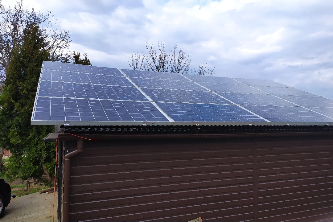

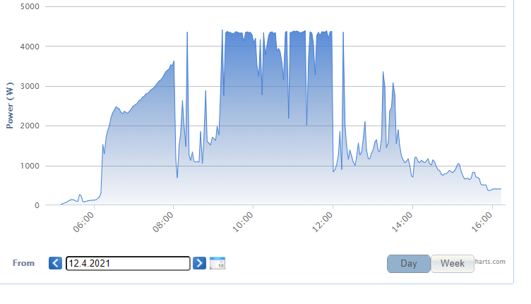

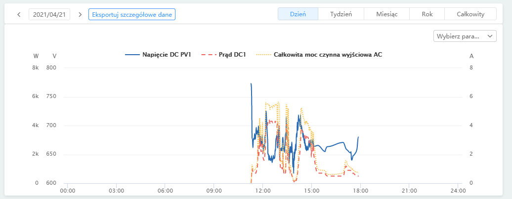

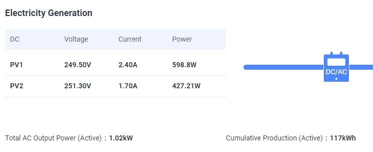

    I have recently enlarged the installation and gradually added panels - in our south there has not been a sunny day for several days. Here is a fragmented generator then had 5.44kWp. By the way, does downloading pictures from Solarman work? Because I have to do it via prtscreen. I don't know if chrome is blocking me or I can't download jpeg. Although the same on MS Edge.
    • SOFAR 8kW PV Installation: Opinions, Durability, Failures & Experiences with Inverters theo.png (45.13 KB) You must be logged in to download this attachment.

    :spoko: . 1 string on 2 MPPT in parallel mode. The interesting thing is that I was looking for the original MC4 Staubli tees but nowhere to find only the stiff ones. I have the original MC4 for the entire installation and I did not want to have Chinese at the inverter, so I was forced to do it myself. I clamp all the ends and solder additionally.
    All in all, it is strange that there are no original MC4 flex tees and I have written to several stores.

    So I have switched in the inverter to parallel. I once corresponded with a serviceman from China regarding such a large oversizing of the installation and he told me to do it. Anyway, it was probably logical. I just wanted confirmation. For the readability of the chart, I only gave 1 string.
    I turned on the inverter late because I changed the jumper last night and wanted to be turned on. The best part was that at night I had nightmares that when turned on, the inverter went up in smoke :D

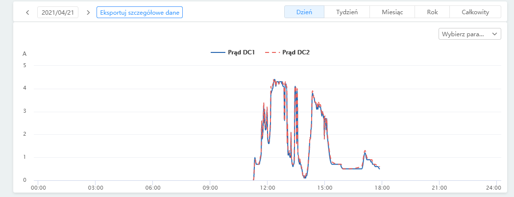

    I also skimmed the report and so 99% is even, but sometimes there is a difference of 0.1A. There may also be rounding of values.
    I also have the impression that with 2x MPPT the inverter has become cooler.

    As I thought, the module's current splits into two, here it comes out after about 4.5, so in my opinion the efficiency of the inverter will drop
    Why did you connect in parallel, since you have one string and most modules will not exceed 11A, unless you have modules with some higher current?

    Because I have a 6.5kWp installation on a 4.4 inverter. The currents and voltages are normal, but the power is a bit too high, although it does not matter, because whether it cuts from 6.5kW or 5.0kW is probably the same.
    On the other hand, in this manual for installers, such connection is recommended - page 27 - Link
    What may the loss of fitness be? Looking at the graph, for example, the 600 and 800V curve is practically horizontal from 50% of the power.

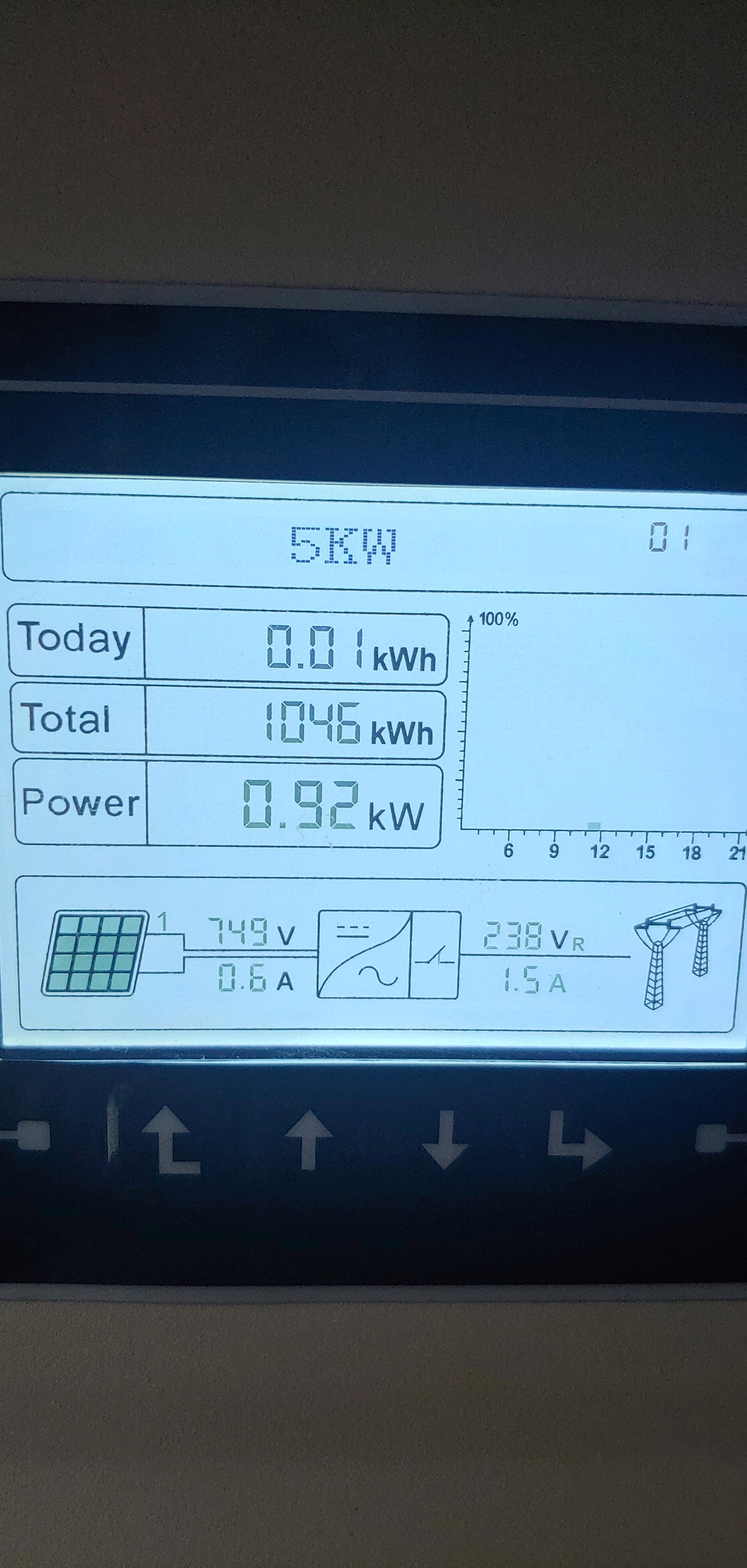

    @toolpusher And the info menu should now be 5 kW
    And is.

    Now just check that the temperature doesn't go too high.

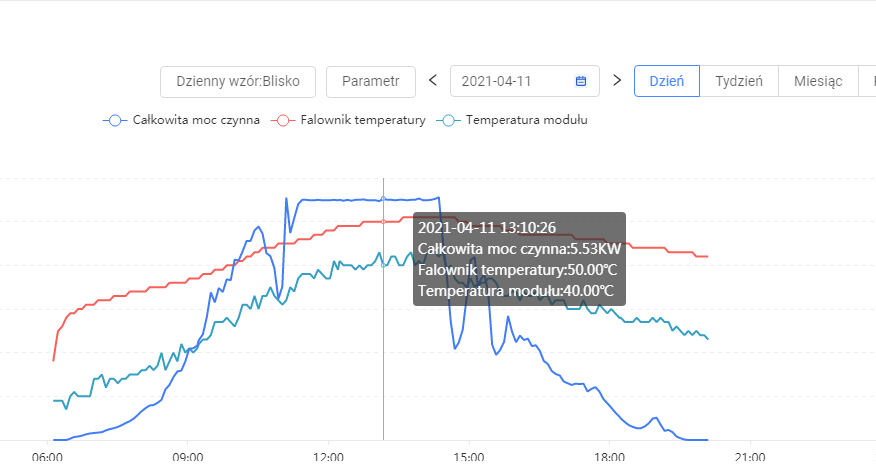

    Well, it seems to me that it has become cooler, but it is probably because 2 MPPT work but with less load. Besides, if it is the same inverter up to 6.6, I think it will be fine at 5.5.

    It got colder because you split the load equally on the MPPT inputs, 5.5 ktlx reaches the temperature at full power 50 degrees.

    I wonder if this module temperature is not a detector on the heat sink. Because in my case, the heat sink at 50st the inverter is slightly warm and now it's even summer.

    From what I was able to find out the module is the IGBT AC temperature on the heat sink.

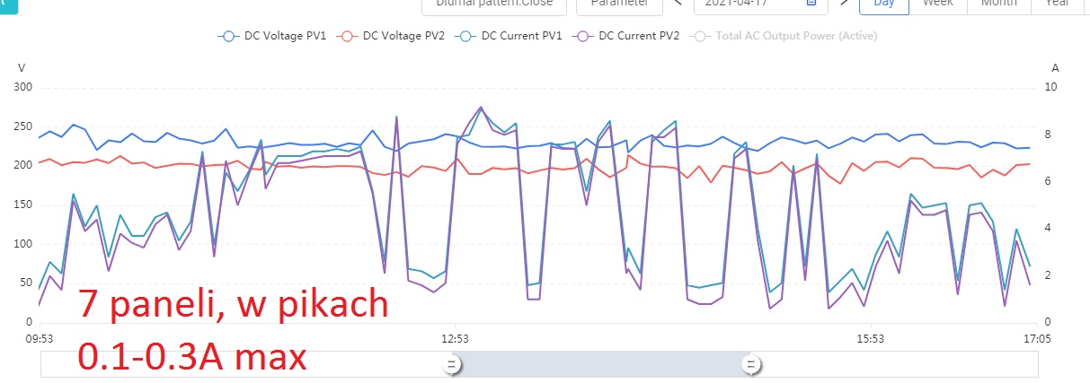

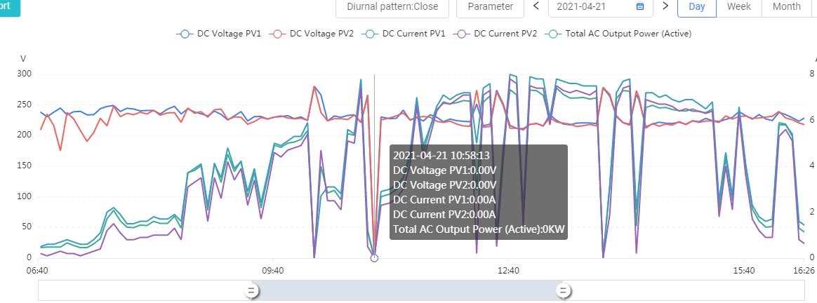

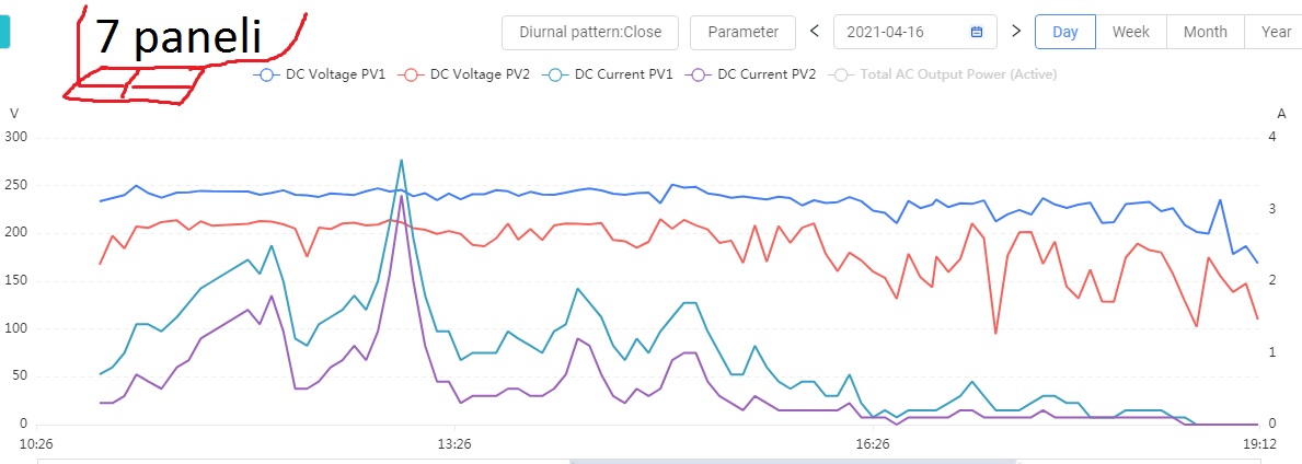

    Is it normal that the current is always lower in the PV2 string by about 0.5A
    Hello, Sofar 3.68KTLM Panels 2 strings, 8 pcs each, the same.
    For a few days I had only 7 panels plugged in the string PV2 and looking at the statistics I had better production with seven than when I plugged in the eighth one. Maybe this is a margin of error, but I certainly did not notice an increase in prod. rather a reduction (I have a comparison to an adjacent installation). Mathematically, I got about 4% less total production after plugging in the eighth module.

    You may have a partially damaged panel and therefore have more production without it, or it is shaded which gives the same effect.

    These charts show that you already have 8 modules here, show the charts from 7 where the production was higher and compare which parameter made it worse.
    Also, swap the inputs because the input algorithms are not the same, and if the situation changes, it could be considered that the strings differ, maybe in length, lighting, I think that the parameters of the modules do not differ?

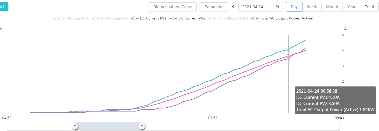

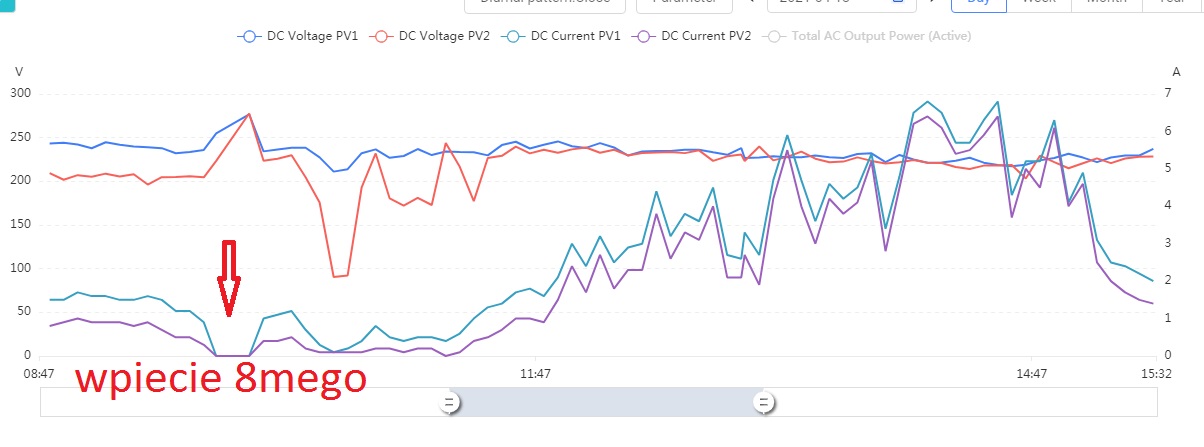

    Charts from Solarman Smart.
    The thongs are identical, no shade.
    I have analyzed these charts in more detail, I can also give the login and password to someone who is insightful, because I would like to understand it better myself.
    So you can see the difference in Amps even when there were 7 panels, but in the peaks it is much smaller then.
    At least that's how I see it.

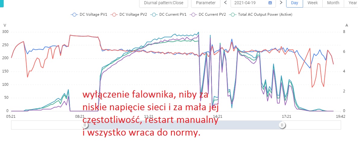

    On the third day of operation of this installation, the allegedly low V grid and frequency was turned off (see diagram below), but the inverter did not turn on by itself, so I turned off DC and AC and fired and started normally.
    Two days later (also the graph) the inverter recorded zero DC and AC voltages too! but it did not turn off, why?

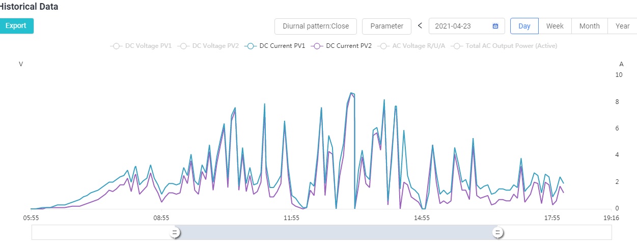

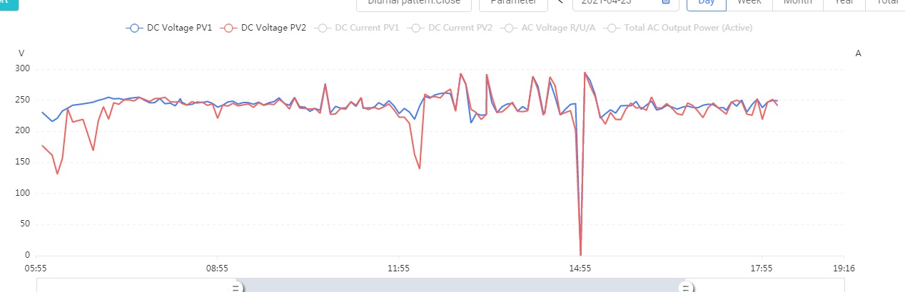

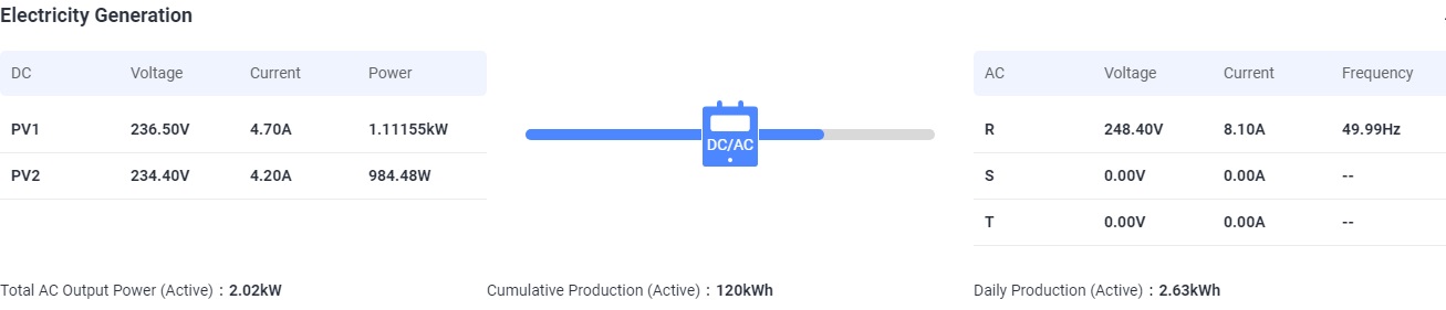

    Today's data.

    Drop on private. this access and enter the page, I can browse.
    And as I wrote before, swap the inputs
