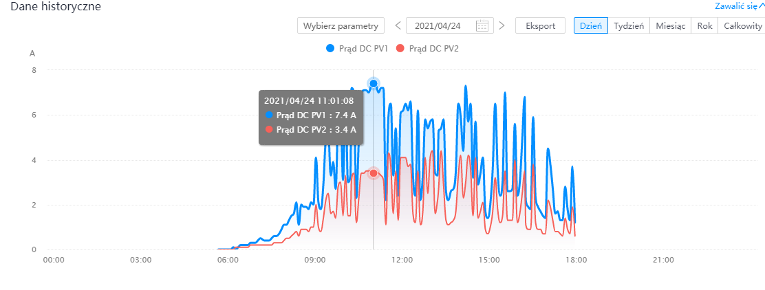

    Do any of you have information about the voltage thresholds in the country of Netherlands? At my next neighbor, I see an inverter configured in the default settings. And I think I found the reason for the high voltage in the network ...
  • #621 19400481
    adamvfr
    Posts: 130
    Rate: 16

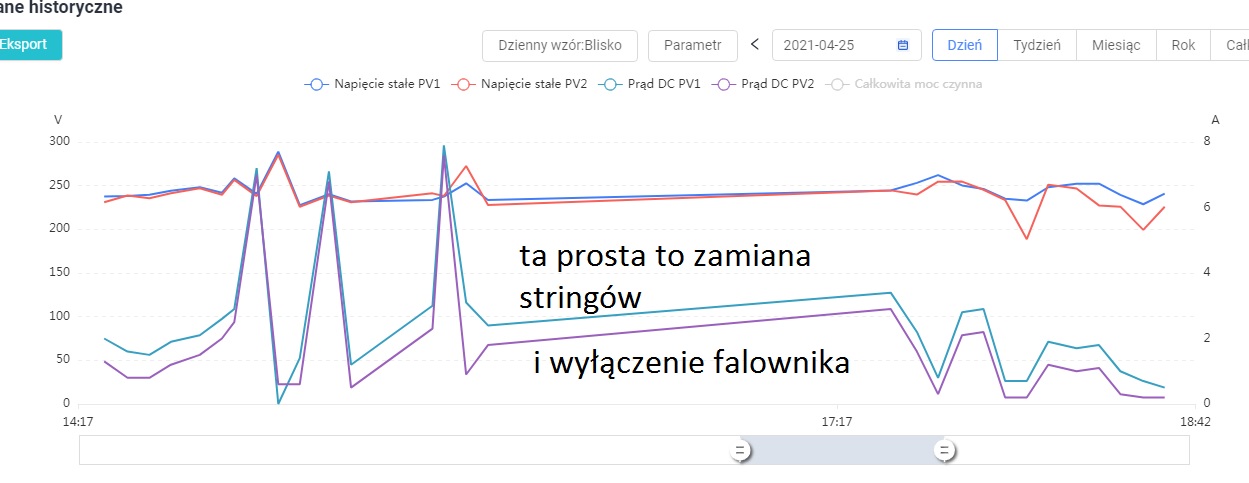

    adamvfr wrote:
    Is it normal that the current is always lower in the PV2 string by about 0.5A
    Hello, Sofar 3.68KTLM Panels 2 strings, 8 pcs each, the same.
    For a few days I had only 7 panels plugged in the string PV2 and looking at the statistics I had better production with seven than when I plugged in the eighth one. Maybe this is a margin of error, but I certainly did not notice an increase in prod. rather a reduction (I have a comparison to an adjacent installation). Mathematically, I got about 4% less total production after plugging in the eighth module.
    That's a surprise!
    I have replaced the strings at the input to the inverter and it is the same as before the replacement.
    Further on, there is less current at the PV2 input.
    What does it mean ???

  • #622 19400512
    prose
    Level 36  
    Posts: 3031
    Help: 172
    Rate: 846
    adamvfr wrote:
    That's a surprise!
    Download (105.05 KB)
    Try to enable MPPT scanning.

    Scanning is basically always on ...
    adamvfr wrote:
    Recently, I installed two inverters, one 3.6KTLM and 3300TL, both single-phase, both from the EU market.
    Going into the settings, "mptt scanner" and below - turned on, I do turn off and it writes "success".
    I go back in and write that the scanner is on.
    Are you sure it is turned on? Because when I really want to turn it on, I have to provide a time frame.
    Someone once wrote that the scanner is off by default. but when i check it in the morning it is on even right after the alleged shutdown.

    Set the scan to 1 minute and then you can see the scanner is working on the display you can see the power dropping and then increasing every 1 minute.
  • #625 19400634
    adamvfr
    Posts: 130
    Rate: 16
    I'll do it, but what will it do? There is no shade there, nothing. What's on your mind?
    If you swapped the inputs and then the current at input 2 is lower, as before, it indicates not the circuit and modules, but the inverter, turning on the scan is a faster search for the correct operating points and, as it were, the elimination of shading, but it is still interference in the circuit and here it clearly indicates on the inverter elements together with the plugs mc-4 input 2 and check here if they fasten properly and if they do not heat up
  • #628 19400805
    That's a surprise!
    You fasten it into one string and see how it works, because with the string voltages you have, it may be all right with the panels and the inverter and one lowers it because it eats up a bit for its operation.
  • #629 19400821
    3301
    Posts: 2100
    Help: 224
    Rate: 868
    After all, if he joins one string, if he can and they are not in different directions, the voltage will pop out over 600V and for this inverter it is too much, and even if it did not turn off because the temperature outside is high, then it will compare with how the current will be one and one tension
  • #630 19401371
    adamvfr
    Posts: 130
    Rate: 16
    Exactly and I know that it will turn off on cold days because I have another Sofar and tests with 16 practically the same panels.
    Besides, I wanted to add 4 more panels.
    Okay, but what conclusions in connection with this situation ??? Why ???
    Nothing gets hot, I always give the MC4 attached to the inverter at the inverter.
