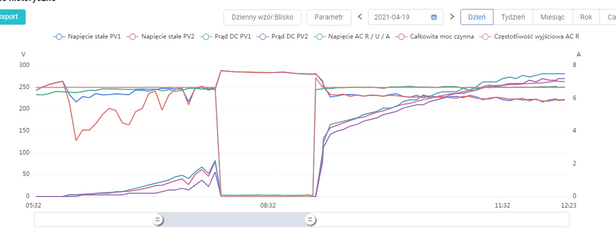

    The inverter generally shows no errors, but why is not the inverter's fault what?
    The inverter showed GridUVP 02 GridUFP 04 errors on April 19th.
    It did not turn on by itself, I had to restart it, I have a neighbor installation and nothing like that happened, the fact may be in a different phase, but I doubt that something was wrong with the network, because there were no power outages in the countryside.
    Well, the zeros from previous posts, I understand zero on modules, but everywhere ??? on the web too ??? I did the installations just like the one behind the fence, so ...?

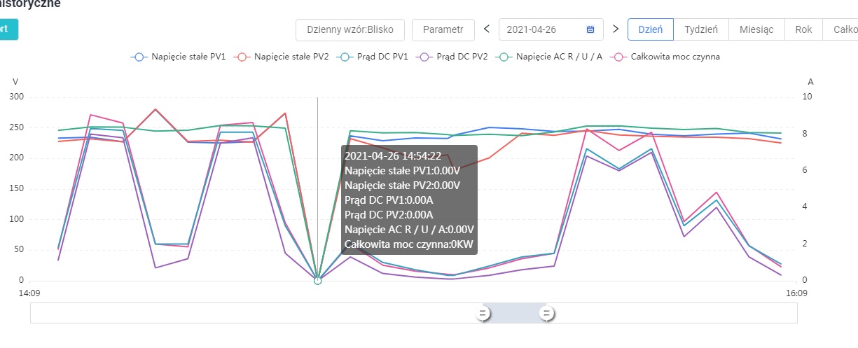

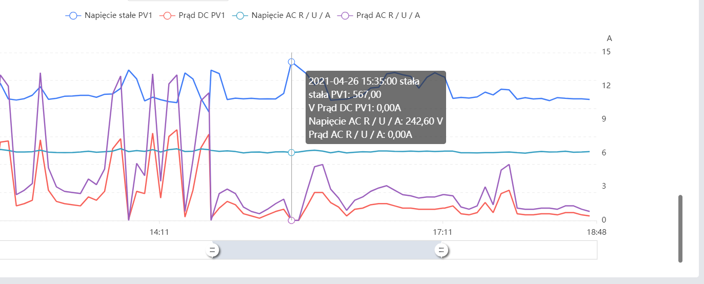

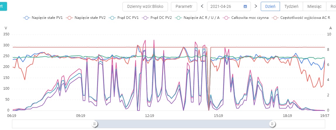

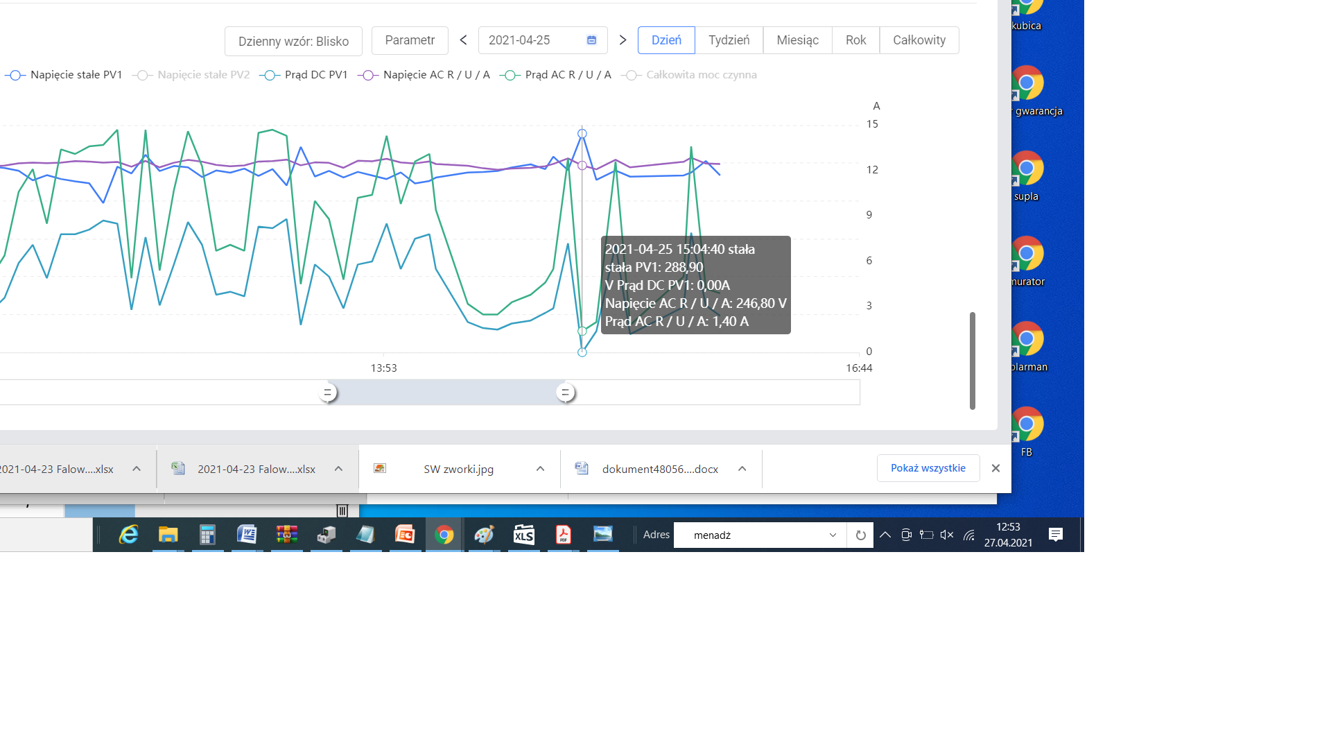

    After replacing the strings 0.5A on average less PV2 and these zeros !!!
    Added after 6 [minutes]:
    Here is yesterday's graph, pay attention to the lower peaks, the fact yesterday was snow showers, peaks down the norm, although the installation next door was doing better, but WHY? one peak is a peak with zeros even in mains voltage ???

  • #642 19403633
    theo33
    Posts: 849
    Help: 78
    Rate: 320
    adamvfr wrote:
    The adjacent installation always looks ok.
    It's not ok. If you extract the interesting parameters, you can see that there are at least three high AC shutdowns
    • SOFAR 8kW PV Installation: Opinions, Durability, Failures & Experiences with Inverters 26.04.powiększ,.png (94.56 KB) You must be logged in to download this attachment.

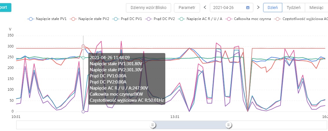

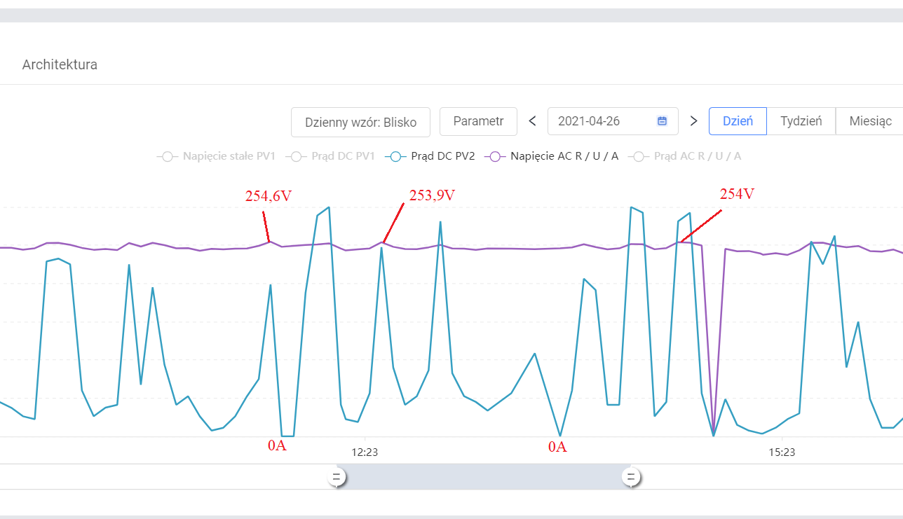

    Pay attention to what is happening before the zeros, for example the one on 26.04. 11:43 Uac voltage 254.6 and further 11:48, nap. Udc 301.8 went up because the inverter stop and the load dropped and the current Iac 0
    The next switch-off is around 13:48, here is the higher voltage. Uac has not been registered but you have to take into account that the readings are every 5 minutes
    And the next one is 14:49 to 14:54 and this is the most interesting thing, it looks like it has been turned off from nap. DC strings and AC mains

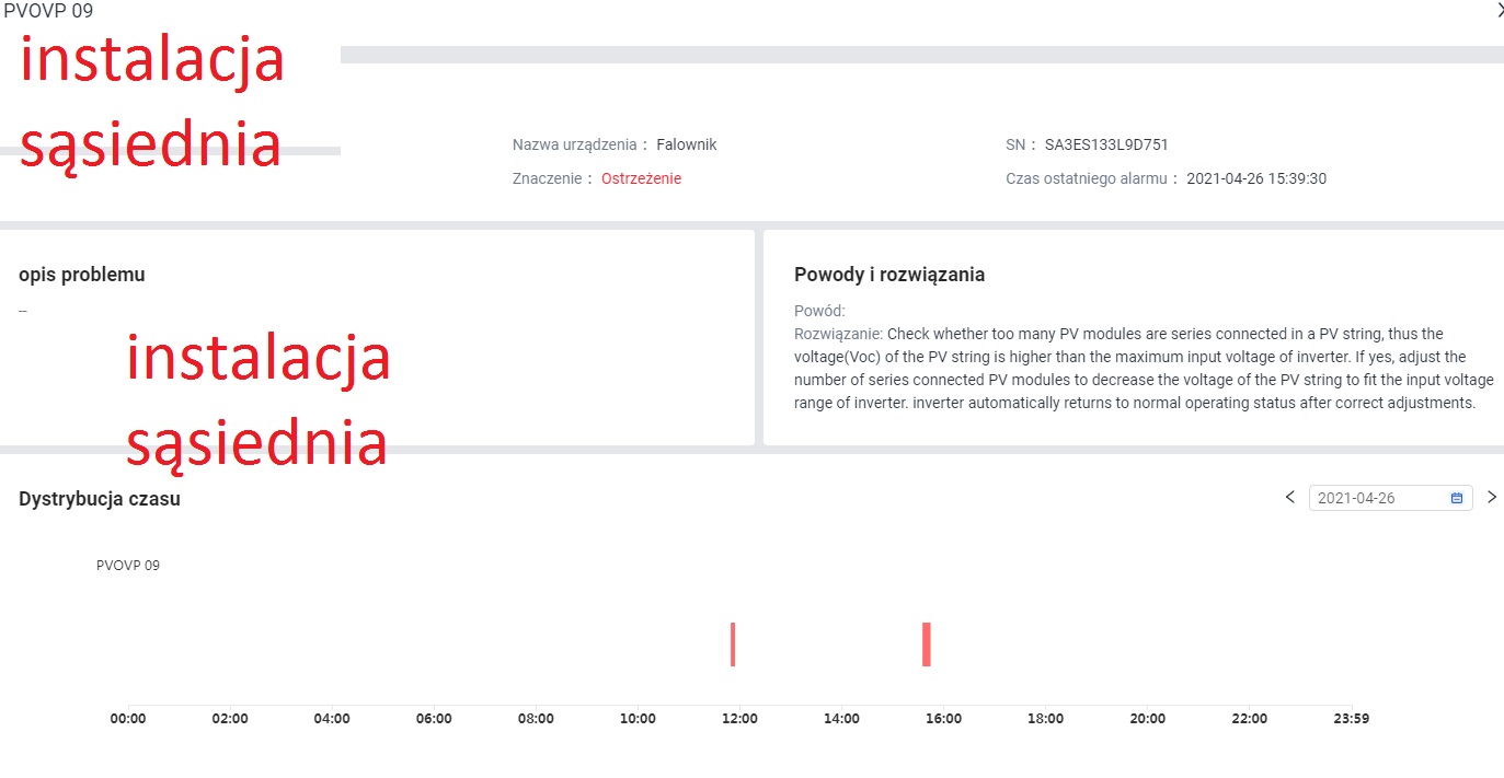

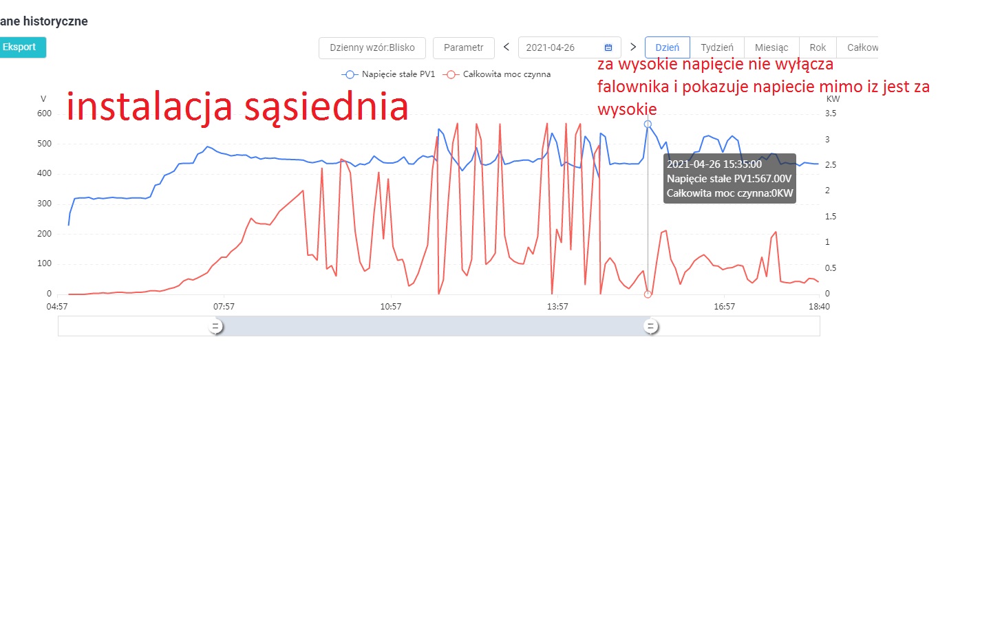

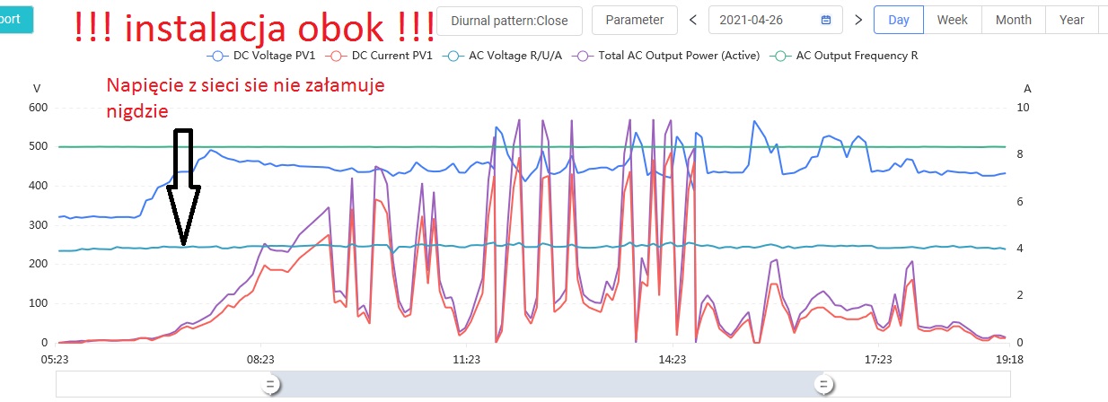

    theo33 wrote:
    Then why doesn't it crash an error ???
    see the attachment, voltage even 257V, but the production is still there, not everything.

  • #645 19403781
    adamvfr
    Posts: 130
    Rate: 16
    Udc is the voltage on PV1 or 2?
    Even if the voltage of 301.8V is not a reason for switching off, besides when it turns off the inverter for some reason, you can still observe the data, e.g. how it turns off because the PV voltage is too high, the voltage shows, as well as the rest of the parameters and the error.
    Added after 8 [minutes]:
    On the neighboring installation on the same day also mega high voltage, also zero productions but never everything at 0
    From the beginning, voltage above 250V on both installations at peak, what to do with it, because it is getting worse.

  • #646 19403812
    theo33
    Posts: 849
    Help: 78
    Rate: 320
    adamvfr wrote:
    theo33 wrote:

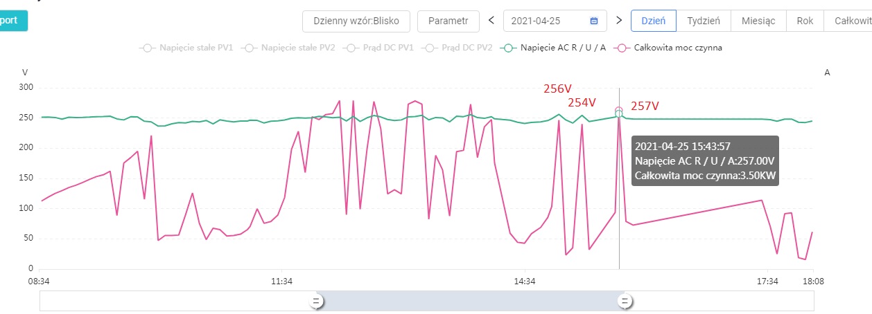

    Maybe the 257V was too short, but see what happened a moment after the 256 you selected occurred: DC voltage up DC current to zero and AC current to 1.4, again the records are every 5 minutes and not everything goes will save

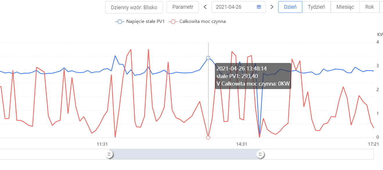

  • #647 19403830
    theo33
    Posts: 849
    Help: 78
    Rate: 320
    adamvfr wrote:
    And a moment after 13:46 at 13:48 what have you got? DC up, power down, switching off this voltage from 13:46, all parameters need to be analyzed, not only selected ones

    You need to know what are the upper parameters and their duration for the inverter to turn off.
    I would like to remind you that the inverter does not turn off for the reasons given by you and does not generate an error code or even warnings, such as for the second installation. But maybe this one doesn't have such a function.
    And once it turned off because of too low mains voltage and / or too low mains frequency.

  • #649 19403908
    adamvfr
    Posts: 130
    Rate: 16
    I understand that the fault lies with the high voltage of the network.
    There is no doubt here.
    But...
    1. Why does it show all zeros - even if it crashes errors, it should not show all parameters as 0?
    2. Why does PV2 show an average 0.5A lower current? Even after changing the strings.
    And what to do with such a high voltage in the network?
    Each time you find a different time and I do not know what you mean by turning off the inverter because if at 3:35 pm we have AC and DC current of zero and the DC voltage has risen, k in my opinion, the inverter does not work.
    Attached, the same graph that you threw earlier, only with other more important parameters, although the DC power is zero there too

    adamvfr
    Posts: 130
    Rate: 16
    This is a neighboring installation, not the one mentioned in this thread.
    As long as a parameter is shown, it is ok, it is clearly not the fault of the inverter, i.e. as shown here, too high DC voltage, but the grid voltage is shown and this is important because in the installation I mean all parameters are shown as 0 - all parameters!
    Turning off the inverter - I mean it does not work for some reason and it crashes an error - must throw an error, if it shows everything at 0, why does it not crash an error?

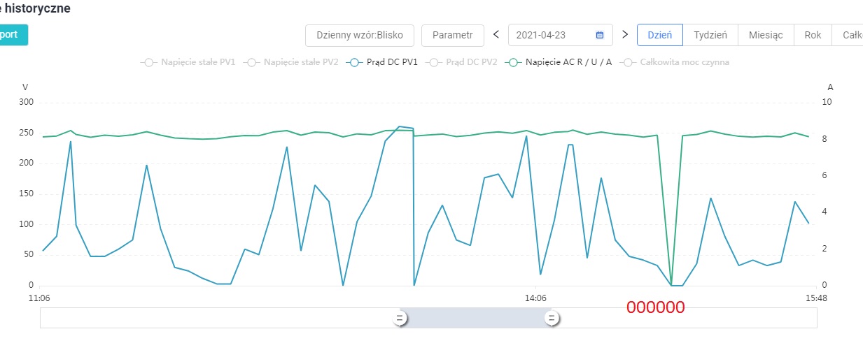

  • #652 19403985
    adamvfr
    Posts: 130
    Rate: 16
    There is something repetitive at these 0 readings. This precedes so far I can risk saying "always" too high mains voltage.
    So the only meaningful explanation for me is that when the grid voltage is too high, the inverter prudently disconnects all functions, thus showing all parameters as 0.
    And it should have crashed GridOVP and never did!
