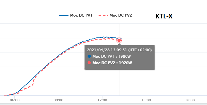

    For me and for znojomego there are discrepancies between two of the same strings, these are so small differences that I do not pursue the topic, installations annually make a very good yield. Swapping the inputs does nothing, DC2 still has less current and power according to the measurements. The measurements may not be accurate.
    I have a single phase 4.6 kw G-2
    The familiar KTL-X 5.5

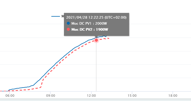

    This may require a coefficient reset, sometimes they are not calibrated too accurately, I do not know what parameter is responsible for it in Sinter, but in another inverter, the coefficient reset helped MPPT now go the same.
    If you have a brick meter, measure it and you will know if it is a measurement error.

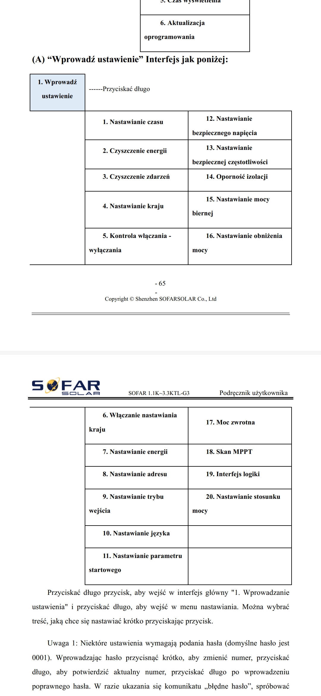

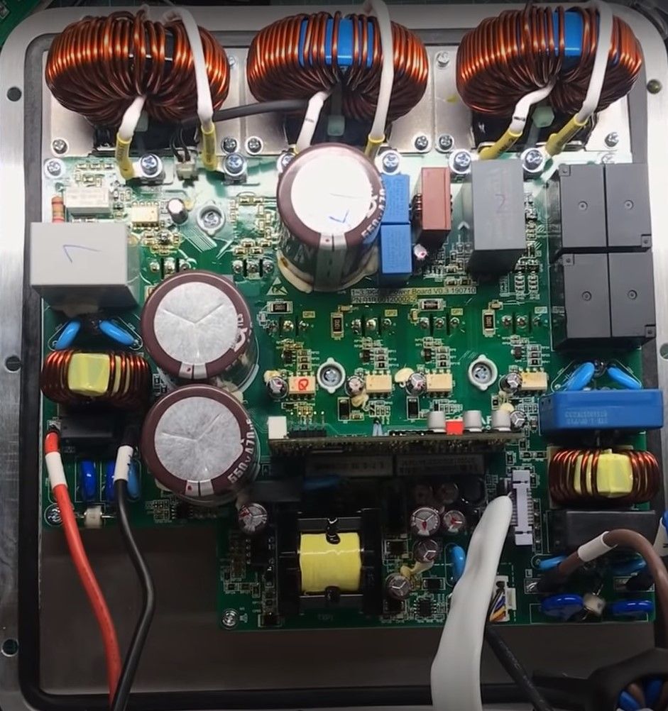

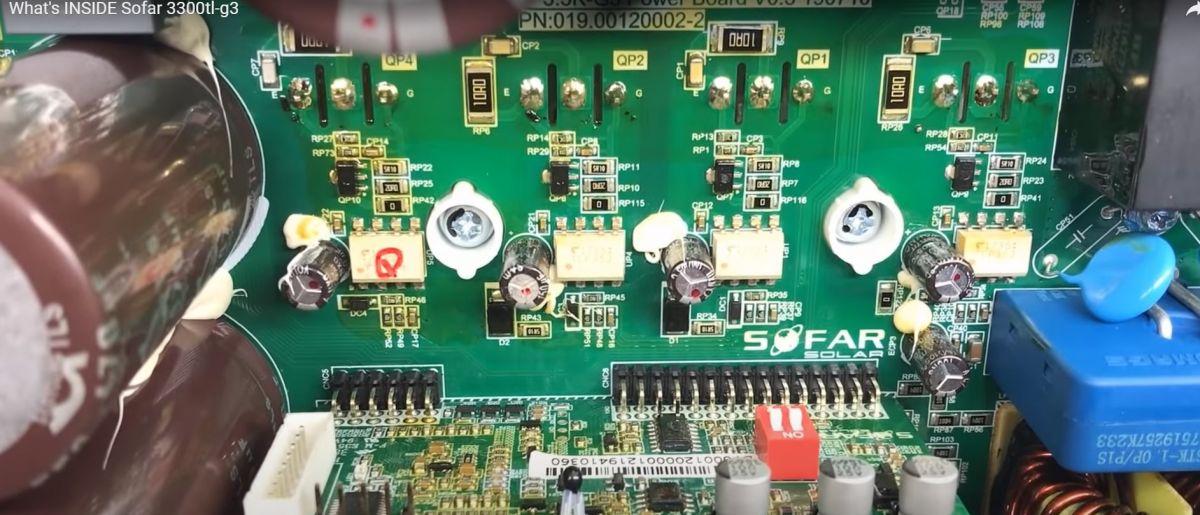

    SOFAR 8kW PV Installation: Opinions, Durability, Failures & Experiences with Inverters I am a user of sofara 3300tl-G3 and I want to ask what RS485 / USB communication looks like. What parameters can be observed? Is any application required.
    As for power switching, it's probably the red jumpers. For PLN 1500, there is not much of it in the inverter. SOFAR 8kW PV Installation: Opinions, Durability, Failures & Experiences with Inverters
    Found on YT
    I will quote my question and ask for an answer again. Probably in sofars it is similarly implemented.
    prose wrote:
    There is no change here anymore
    Up is probably not, but maybe you can lower the power. I just suppose these jumpers are for that, maybe they are for something else.

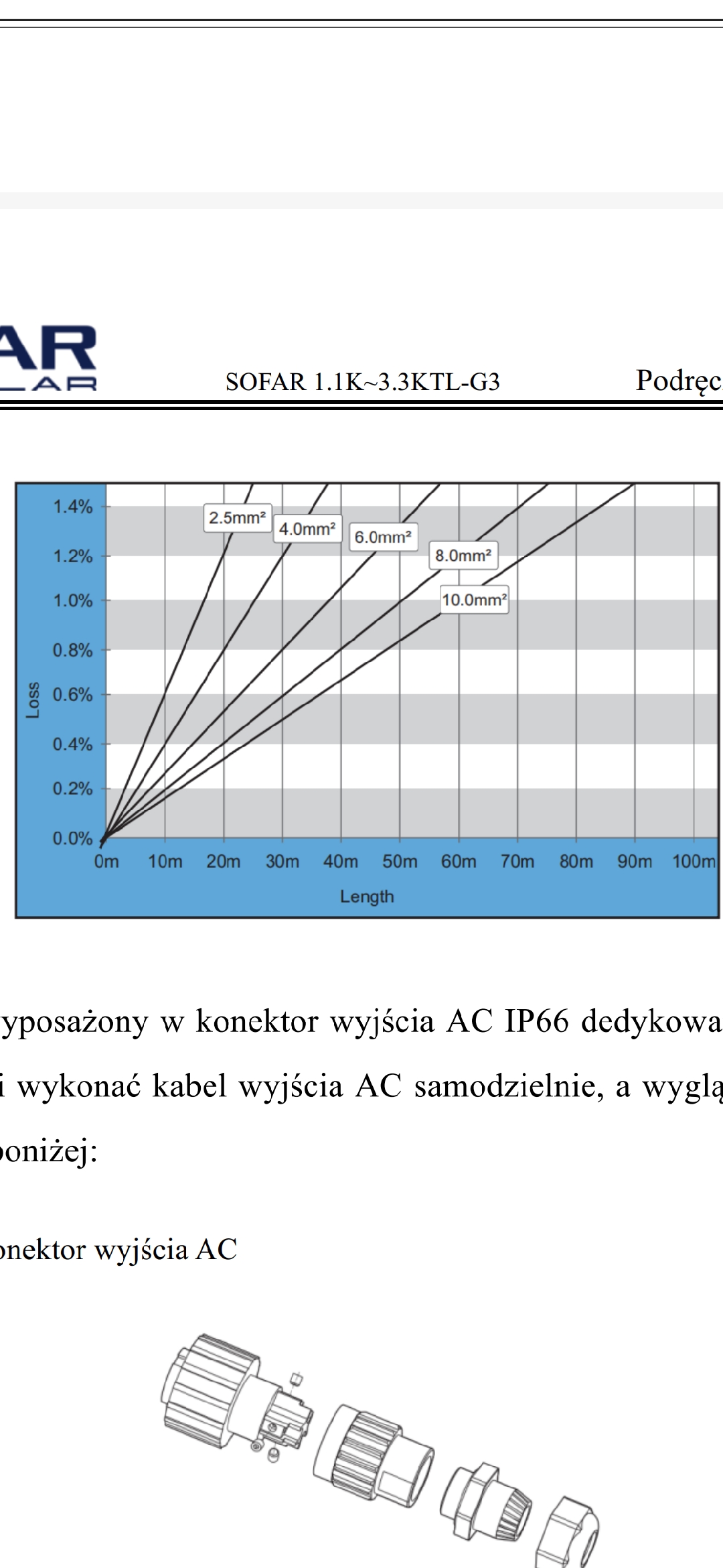

    But I did not ask about it, but whether it is possible to change the parameters on this inverter so that the inverter does not restart but works with lower efficiency, e.g.
    In any case, I will also check it .. In the inverter manual it says that up to 20m, 6 square is enough
    Up to 20m, it's 4 square meters
    • SOFAR 8kW PV Installation: Opinions, Durability, Failures & Experiences with Inverters Screenshot_2021-05-04-14-20-19-782_cn.wps.xiaomi.abroad.lite.jpg (354.18 KB) You must be logged in to download this attachment.

    ultimate33 wrote:
    Hello. I have a Sofar Solar 3.3 inverter one phase ..
    Well, with such power and distance, your cable is definitely not the cause of any problems.
    At cos (phi) = 0.9, there will be 16A. Copper 4 square should be OK.
    However, take an interest in the short circuit loop impedance. I don't know your net, but if it's a village with some old luck on a pole
    then we have the guilty party. The OSDs keep the voltage high on it to ensure the parameters at the end of the line.
    It hardly harmonizes with the invention of PV ... :cry:
