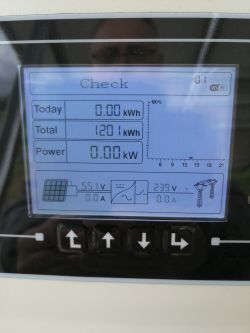

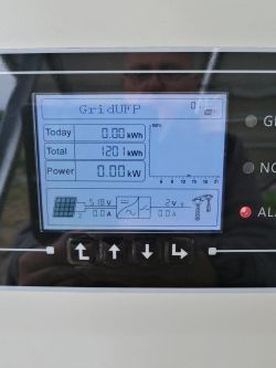

    Hello. Since yesterday the Sofar Solar 11KTL-X does not work, the green diode is blinking, after turning the inverter off and on, it writes check and it does not work, please let me know what could have happened. Soft is 2.30 as shown on the nameplate.
    SOFAR 8kW PV Installation: Opinions, Durability, Failures & Experiences with Inverters SOFAR 8kW PV Installation: Opinions, Durability, Failures & Experiences with Inverters SOFAR 8kW PV Installation: Opinions, Durability, Failures & Experiences with Inverters
  • #729 19446066
    toolpusher
    Posts: 794
    Help: 35
    Rate: 210
    Janusz_kk wrote:
    Prose, do you have a Polish sofar manual?
    Here: Link

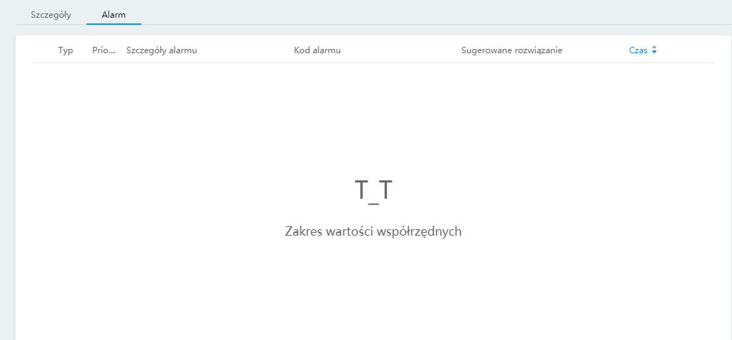

    jareksz wrote:
    Hello. since yesterday the sofar solar 11ktl-x does not work, the green diode is blinking, after turning the inverter off and on, it writes check and it does not work, please let me know what could have happened.
    And what errors does the solarman display?
  • #730 19446080
    jareksz
    Posts: 34
    Rate: 15
    It does not display any errors
  • #731 19446094
    toolpusher
    Posts: 794
    Help: 35
    Rate: 210
    You probably have a faulty inverter - faulty PV input 1 or 2 or something else - Link

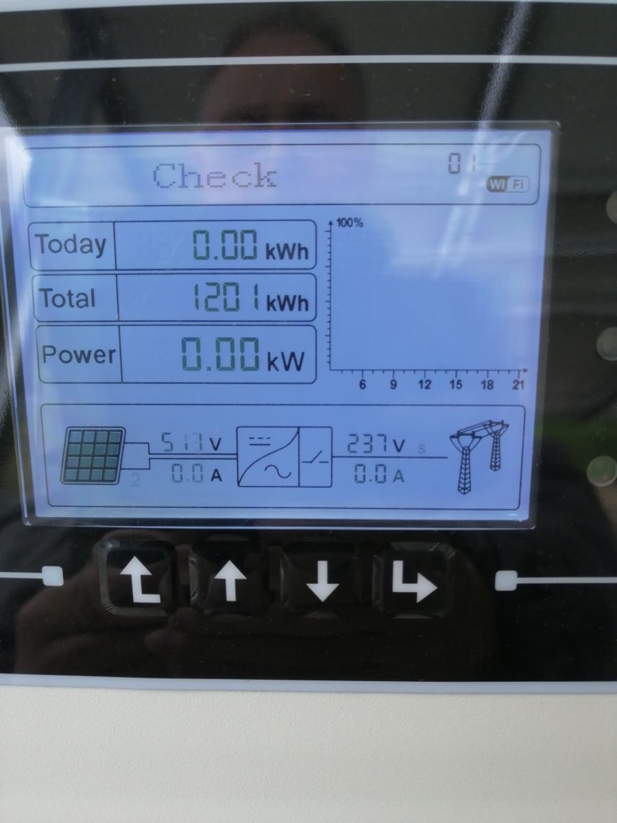

  • #732 19446113
    jareksz
    Posts: 34
    Rate: 15
    Is it possible to check it without sending it to the site?

  • #741 19446737
    jareksz
    Posts: 34
    Rate: 15

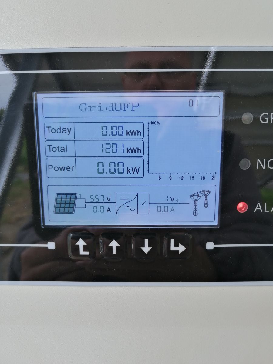

    I was doing tests, I disconnected PV1 and PV2 without changes, after switching on the check inscription and the green LED is blinking, will uploading the new firmware help?
    ps. has anyone got firmware 2.70?

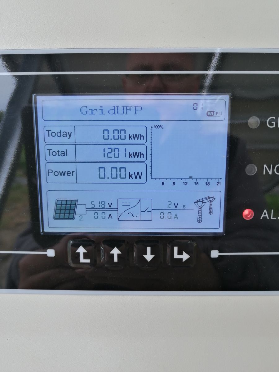

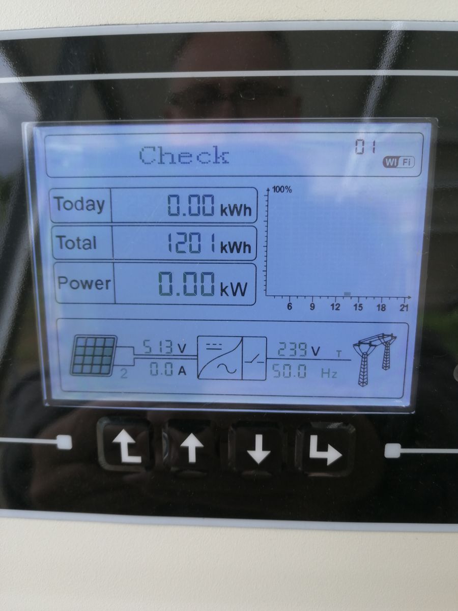

  • #742 19446777
    3301
    Posts: 2100
    Help: 224
    Rate: 868
    You do updates with the AC voltage off and the red LED is lit without any blinking and you should see the voltage from individual DC inputs, what firmware version do you currently have? because if the older one, e.g. 201,210, it is such an area. 250 is better not to install, there were problems with the suspension and stop of the inverter, the most stable is 220 and it is sufficient for correct operation

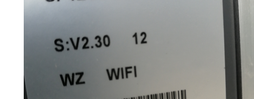

  • #743 19446815
    jareksz
    Posts: 34
    Rate: 15
    Now I have 2.30 just like on the nameplate

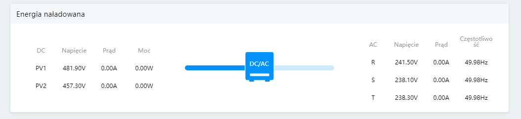

  • #744 19446832
    3301
    Posts: 2100
    Help: 224
    Rate: 868
    If I can borrow something like 220, just check what's on the display after turning off the AC

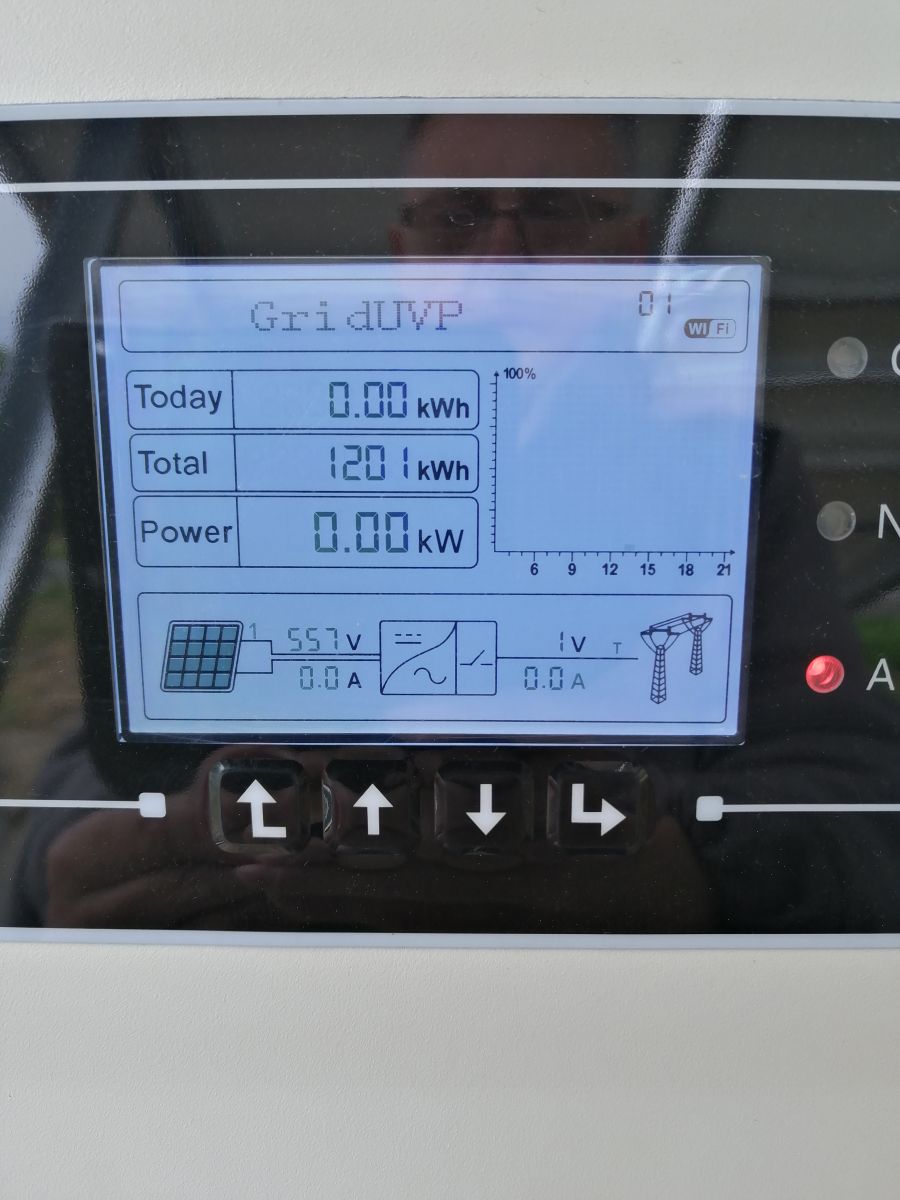

  • #745 19446889
    jareksz
    Posts: 34
    Rate: 15

  • #748 19447148
    toolpusher
    Posts: 794
    Help: 35
    Rate: 210
    @jareksz
    If changing the software does not help, you just have to contact the service.
  • #749 19447180
    jareksz
    Posts: 34
    Rate: 15
    toolpusher wrote:
    @jareksz
    Does anyone have 2.30 or higher?
  • #750 19447185
    toolpusher
    Posts: 794
    Help: 35
    Rate: 210
    Why do you need a higher one, it does not give you anything - upload soft 2.20 - there is a link in post # 726. If this does not help you, the inverter is blown. I have the impression that the inverter is without warranty and you are grabbing a razor.
