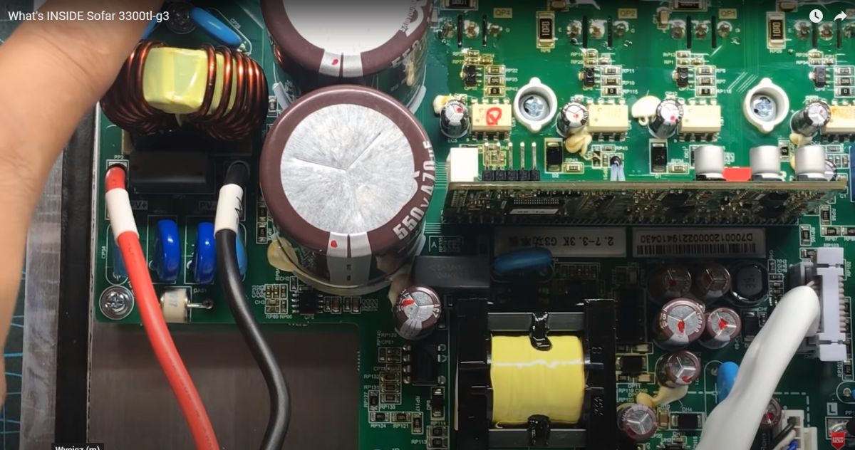

    Is anyone able to provide me the software for sofar 3300tl-g3
  • #786 19462830
    If you have a fault that prevents you (the inverter) from working, take action to complain.
    If it's just a whim, don't take any chances.
    Follow the rule; if it works, don't touch it.

    A whim of an attempt to change from 3000 TL to 3300 TL

    Perhaps the change of power is possible as in the case of bigger brothers by changing the jumpers. It is my assumption, even on the board of the device there are power ranges in this weight group. SOFAR 8kW PV Installation: Opinions, Durability, Failures & Experiences with Inverters

    @ stev-an Do you have a photo of the entire CD?

    To find the jumpers, you need to remove the entire housing? Is the cover at the bottom enough?

    @ cygan32 The bottom cover is not enough, you need the entire housing.

    After unscrewing the housing, we see the plate. There are two jumpers on the vertical PCB with the processor, four combinations on of / red / SOFAR 8kW PV Installation: Opinions, Durability, Failures & Experiences with Inverters
    And there you have the settings, you would have to view the inverter with a different power and set the SW, it is also important if the soft is the same for all tl-g3

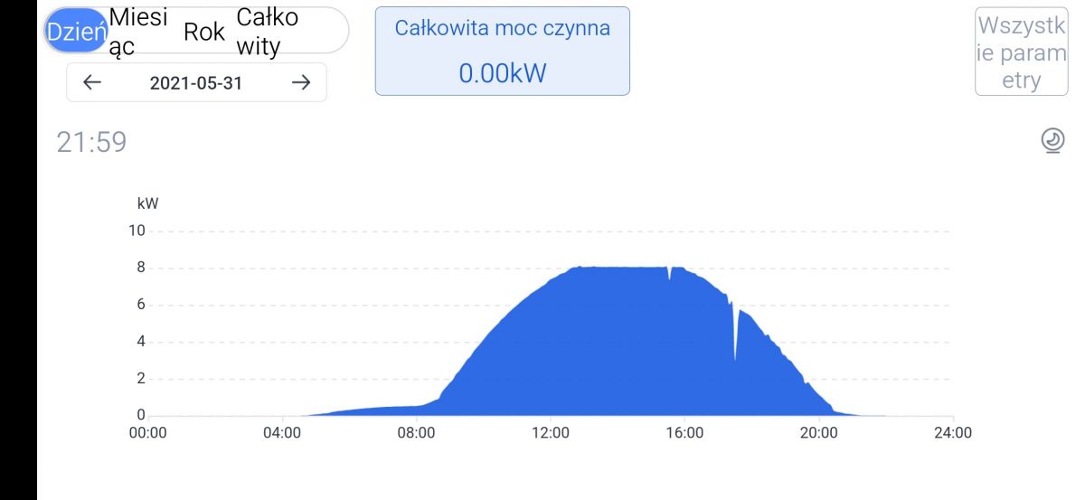

    Hello :)
    The Sofar Solar 8.8 KTL-X does this to me in good winds
    Cuts to 8kW, 9.92 kW in panels, firmware 2.0, hardware version 1.0
    After reading the topic - you need at least 2.2 firmware
    I wrote to the PL website and without lying, about pouring errors, a full register from time to time. I suggested updating the firmware. In response, I received information that "I do not have any security parameters set. Please, in the menu - settings - set the country code - set 12 (Poland)"
    Inedited, can they see it online?
    I wanted to do it officially, it didn't go :cry:
    Therefore, I am asking for a bearing on a proven soft, and if necessary, I will also change the sw3 switch.
    best regards

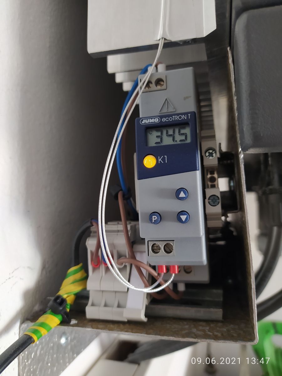

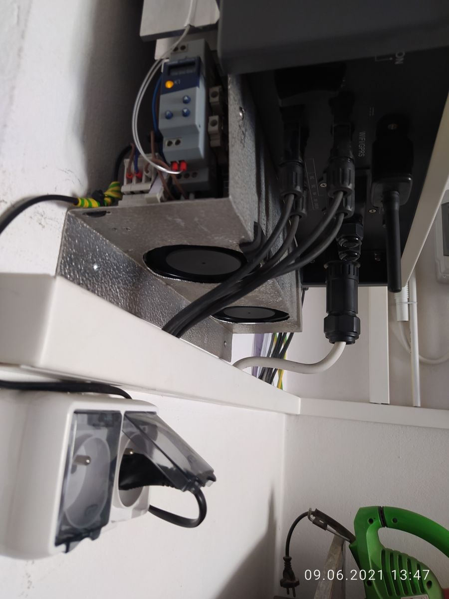

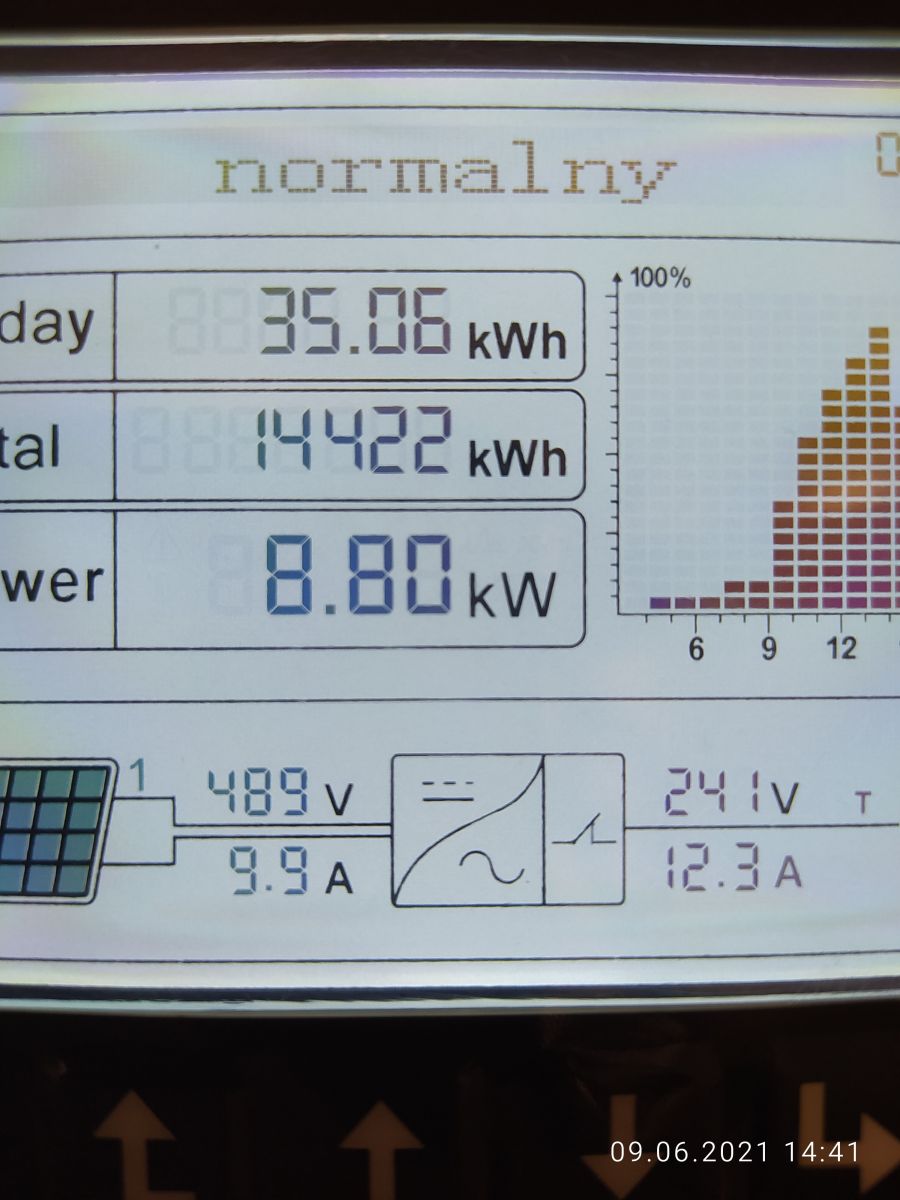

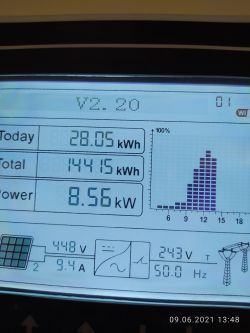

    Firmware updated to 2.2, language PL present :)
    It no longer cuts to 8kW :)
    After a short shading by clouds and a slight cooling of the panels, the sun came and it peaked to 8.95 kW, it's good :)
    Due to the requirement to keep the appropriate distance from the ceiling, I installed a blast under the inverter, bent a piece of metal sheet, two fans and an old thermostat with a Pt-100 sensor located in the upper part of the heat sink.
    Temperature after long full power operation (upper part of heat sink), lower part is cold.
    I am considering this sw3 switch, it would probably give something a little kWh ahead but probably only April, May due to lower temperatures.
    I will observe it and when it cuts the production, I will "crack" it
    Problem solved.
    Thank you very much and best regards :)
