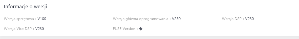

    As suggested by prose, I installed version 2.20, the "SWVersionFault" will disappear, the inverter is working fine. So it looks like you cannot download any higher firmware version to the inverter. In my example, version 2.80 cannot be installed on version 2.10. Thanks for the help.
    It also depends on what the hardware version is.

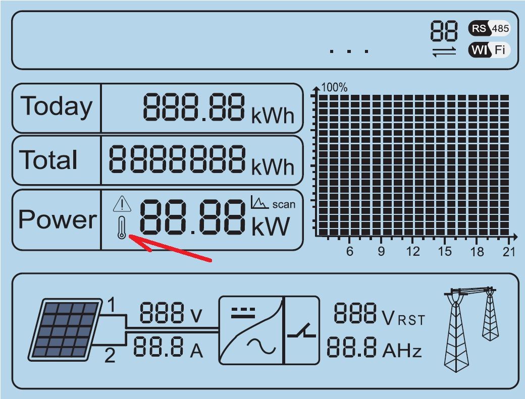

    SOFAR 8kW PV Installation: Opinions, Durability, Failures & Experiences with Inverters
    Can I have a hint; when the error indicated in the attached photo occurs.
  • #759 19447786
    rokbok
    Posts: 4256
    Help: 624
    Rate: 995
    The thermometer symbol as a warning usually signals that the temperature limit is exceeded, but I may be wrong.
    Well, it is impossible to write once, because I wanted to upload 2.80 and I have 2.20 and there was this error. So I stay at 2.20 and do not combine any more.
    It is not worth it because in higher softach it is only additional country standards and languages.

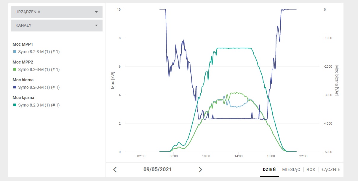

    grzes601 wrote:
    Does SMA (which model) compensate reactive energy?
    Rather, it produces especially as it approaches the max voltage, it will not compensate you in the reactive network because it is not used for that.
    What are the possibilities in this regard?
    Probably, like most devices, it has PF set to some extent, but it works best with the factory settings and the selected Polish standard. Do you have a workshop that you want to compensate for?

    It will compensate the passive but with its own and not with the other receivers.

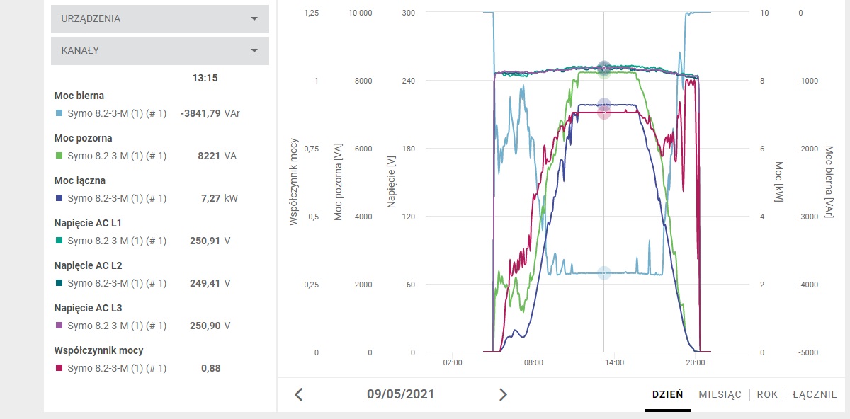

    It will not compensate, because the assumption is that it should only produce active and that is how the Polish standard is set. Any combination with PF settings can cause reactive power and cause trouble. At night, the inverter does not produce reactive power either, at least it shouldn't do that to a large extent. Another device is used for compensation.

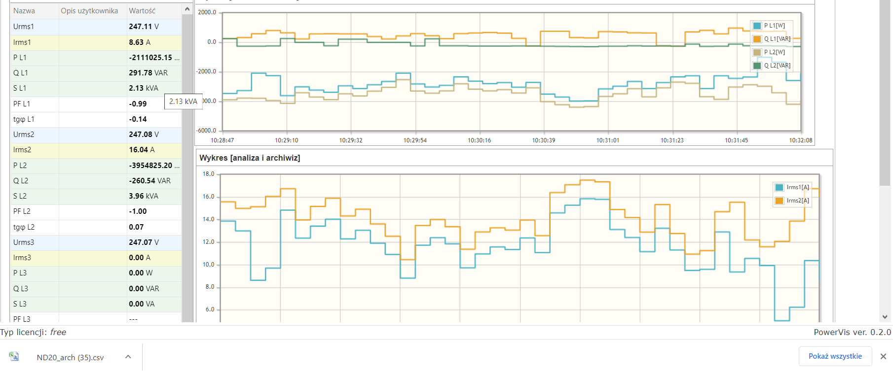

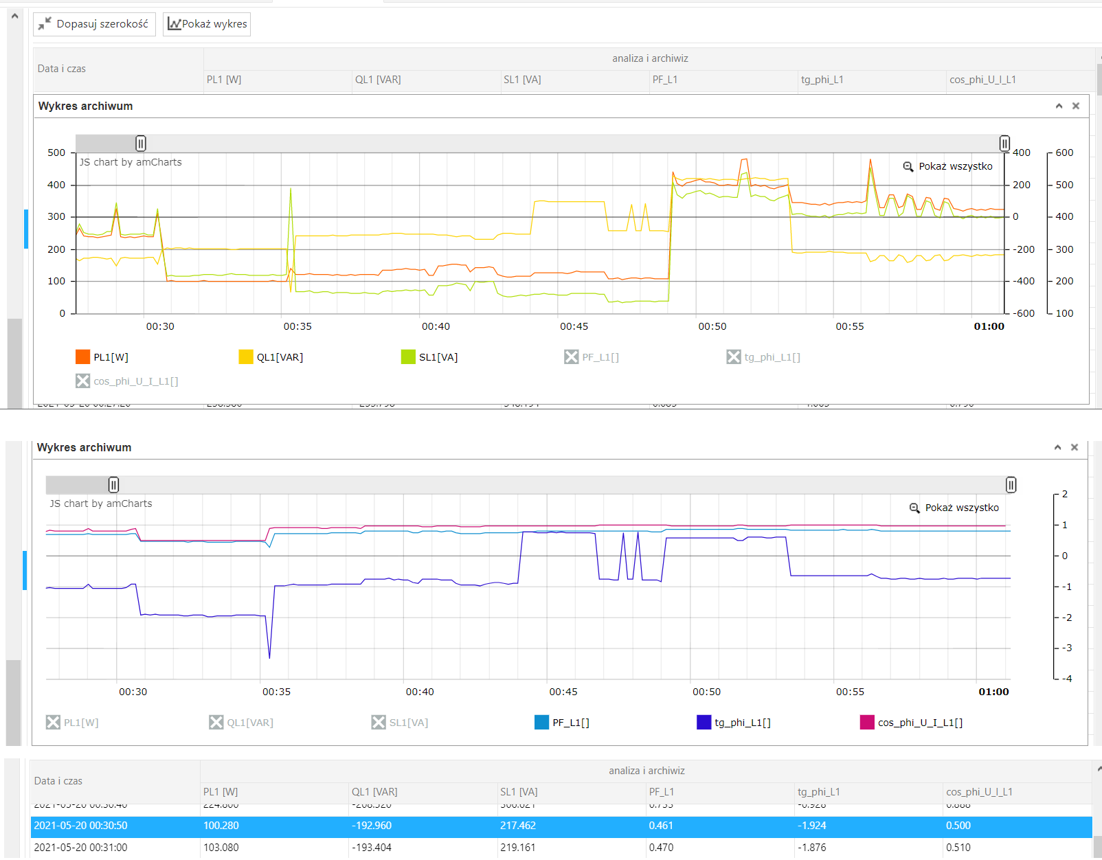

    Unfortunately, this is your wishful thinking.
    For example SOFAR 11KTL-X below 500W active power starts littering the capacitive reactive on each phase.
    The closer to zero the worse it gets. At night, SOFAR generates about 60-70 var of reactive capacitive on each of the phases.
    The situation improves with the dawn as the generated active power increases.
    Djhoshi wrote:
    Add and buy SMA.
    We have no problems with them, there is a service in Poland. The initial warranty is also 10 years with the possibility of extension.
    Overall a top shelf product.
    Write something more.
    What's so good about SMA that others don't.
    Service ?
    SOFAR also has a service. Please do not think at this point about the support of this something sofarsolarpoland that usurps the right to be the "guiding force ... ... sofara".
    Drink water and a photo montage as big as a beer shop. Search for the company's address and go on a trip.
    If you want to get to know your website, I suggest you visit my salesperson in his office and see what the company is. See the website. Talk about possible repairs.
    Let it not be "a booth with a beer and sofara corpses on the wall"
  • #773 19454205
    No wishes, just measurements of my third-party inverter, I hope you write about the real behavior of Sofar and not "theories" again
    If you know an inverter that produces zero reactive at night, what a wonder it is.
    Then you are a little for and a little against.
    You wrote here that the inverter should only produce the active one and at the night also the passive one it does not produce at least to a large extent.
    But it is not so, and you also deny it referring to the measurements of your third-party inverter, and at the end you want to know a miracle that produces zero reactive at night.
    Cytro12 wrote:
    How to understand it? that you have an inverter that works with PF equal to 1 in each stage?
  • #775 19454388
    Cytro12
    Level 26  
    Posts: 928
    Help: 47
    Rate: 303
    Instead of quoting me, write what your opinion is on the subject because it looks like you don't understand something.
    3301 wrote:
    It will compensate for the passive but own
    How? I am eager to read.
    Have you read the OSD requirements for PV connection? You can see not very much, or at least you missed the technical issues.
    3301 wrote:
    at night, it also does not produce at least to a large extent.
    Well, what is it like, does it produce, compensate or maybe not much, so negligibly according to the comprehensive agreement? I am eager to meet such a miracle that produces nothing if someone has too much of what is now.
  • #776 19454823
    3301
    Posts: 2100
    Help: 224
    Rate: 868
    Clarifications and answers to queries about Cytro12
    1. The lower the active power production, the more the inverter produces reactive power with the "+" sign, which means the production of capacitive reactive power, including the parameters from the analyzer for 1-phase inverter operation. from 25.05 where the weather was bad and compared to 26th when it was sunny.
    2. The inverter aims to achieve a power factor close to 1, so it automatically compensates for the reactive energy it produces.
    3. The assumptions of the OSD are in IRIESD and the installed inverters have the appropriate certificates, but unfortunately they also produce garbage.
    4. see item 1. and if you trace the results, you will find hours where the actual reactive time is 0
    Generally speaking, I really do not understand your entries and I hope that you will try to explain and not answer the question, changing the meaning of your statements.

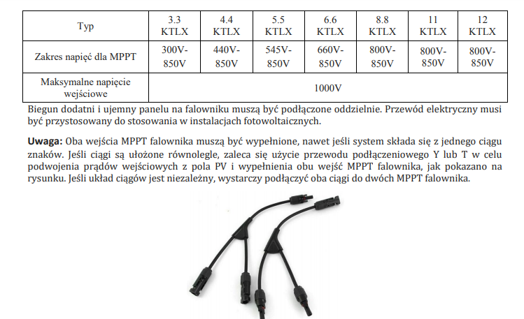

    Connecting panels over 11 A to sofar or someone tried this method SOFAR 8kW PV Installation: Opinions, Durability, Failures & Experiences with Inverters ?

    3301 wrote:
    1. The lower the active power production, the more the inverter produces reactive power with the sign "+"
    So you have an inverter not fully compliant with the Polish standard, at least at this point (in the power range of 20-50% of available active power, the micro installation works only as an active power source). My inverter shows exactly this relationship.
    It does not compensate for anything if it is not already producing as above. And again you have not read the technical conditions because the inverter does not always go to PF1. It depends. Since PF = 1, the inverter produces ONLY active power, it does not compensate for anything, if you set PF = 0.8, the inverter will produce 80% of active power but also 20% of inductive reactive power. For obvious reasons, playing a PF other than 1 means production losses as understood by the prosumer. Of course, by force or stubbornness, you can call it some kind of defective compensation, but without knowing what you are doing and measuring, it usually always ends up badly. The inverter is not used to compensate for reactive power, it is enough that it does not produce it. And when it produces as little as possible. In addition to PF, you can also set the characteristics, this is standard for the selected standard, hence it is so important to correctly set the standard of the country in which the inverter works.
    Good equipment has to be assembled.
    Decide that the inverter compensates or just doesn't produce reactive power because you don't understand yourself either :) Another thing is that you did not provide what you measure it, when again with some Chinese invention, I am not surprised either.

  • #780 19456364
    theo33
    Posts: 849
    Help: 78
    Rate: 320
    Cytro12 wrote:
    I have a Samil inverter and zamel mew01 is installed between it and the switchgear and everything that appears there is recorded, but it does not save power or display the PF factor, only active and reactive inductive and capacitive energy, so based on hourly indications I took average powers to calculate other important parameters like PF and tan fi.
    practically during the sleep period, i.e. from 20:30 to 05:30, zamel charges about 30 Varh every hour, at the time of starting active production, passive is at the level of 250 Var and begins to decrease only at 1.5 kW, i.e. at 38% of the nominal
    In the range of 20-40% of available active power, it probably produces the most reactive power, PF = 0.99 occurs only above 50% of the rated value.
    Based on what is above, this inverter should also not be compliant with the standard? and I also found https://www.forum-fronius.pl/forum/topic/czy-falownik-musi-produkowac-moc-bierna/?part=2 and the chart shows that this is only producing the passive because at 3 kW active 3.5 kVar reactive and at max. active, i.e. some 7.5 is almost 4 passive, is it supposed to be a compensator?
    Can col. Perhaps refer to this data?
