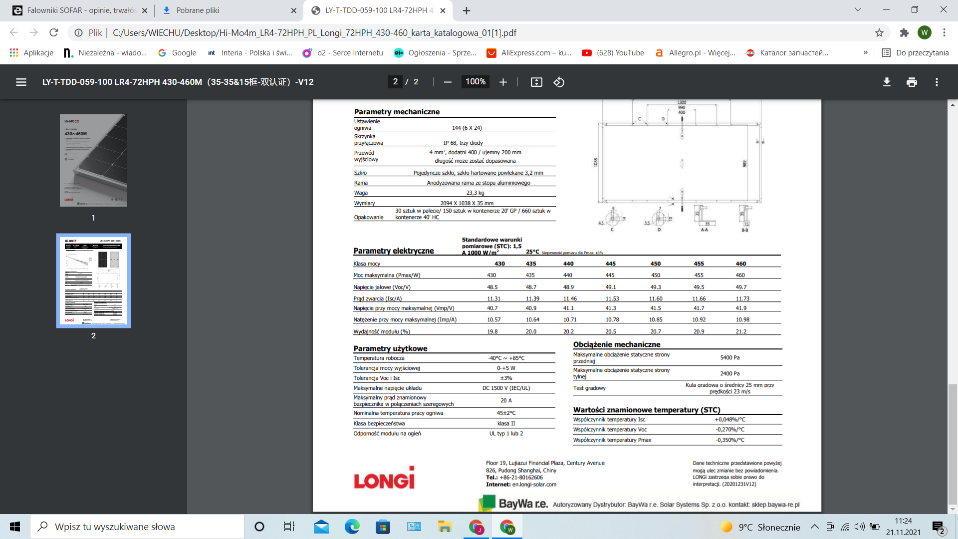

    I do not want to start a new topic, that's why here.
    I bought a SOFAR INVERTER 6.6KTLX-G3 THREE-PHASE, I have a dilemma and would like to consult professionals, I bought 14 pcs of Longi Solar 455W LR4-72HPH-455M panels and I am thinking about connecting, whether to connect in one string or divide into two, panels arranged from the south on one roof slope without shadows. Maybe some optimal solution, equal or unequal thongs? I am asking for some tips.
    The parameters of the panels in the attachment and in the photo.
    SOFAR 8kW PV Installation: Opinions, Durability, Failures & Experiences with Inverters
    Regards. [img-3]
    • Hi-Mo4m_LR4-72HPH_PL_Longi_72HPH_430-460_karta_katalogowa_01[1].pdf (378.6 KB) You must be logged in to download this attachment.

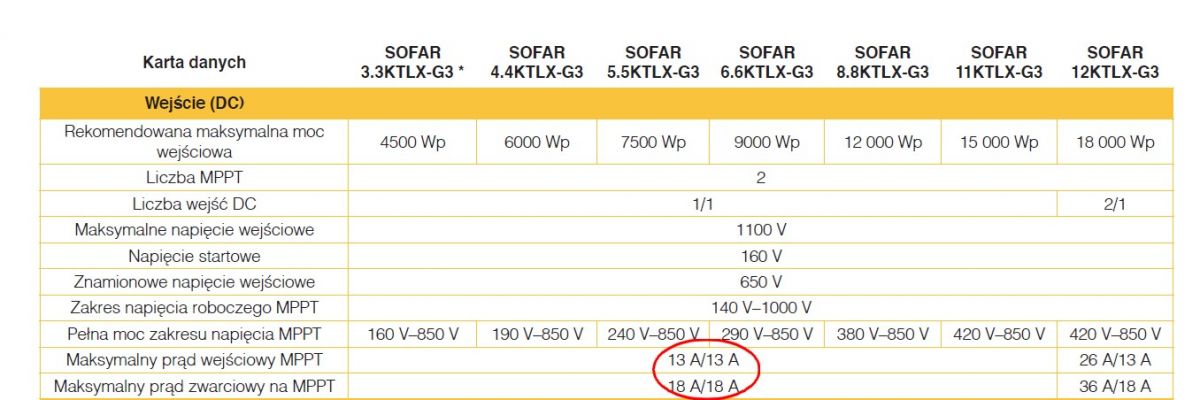

    Connect into one string, the max voltage will be 795V, so in the inverter, the inverter inputs (2 strings) should be connected in parallel with adapters due to the higher current.

    Janusz_kk wrote:
    the inputs in the inverter (2 strings) should be connected in parallel with adapters due to the higher current.
    In one string, the current will not change, so why connect the MPPT inputs in parallel ;) .

    lary504
    Posts: 35
    If you connect the inputs in parallel, the current will be half the input. Although the g3 so far is probably 13A, it will not exceed.
