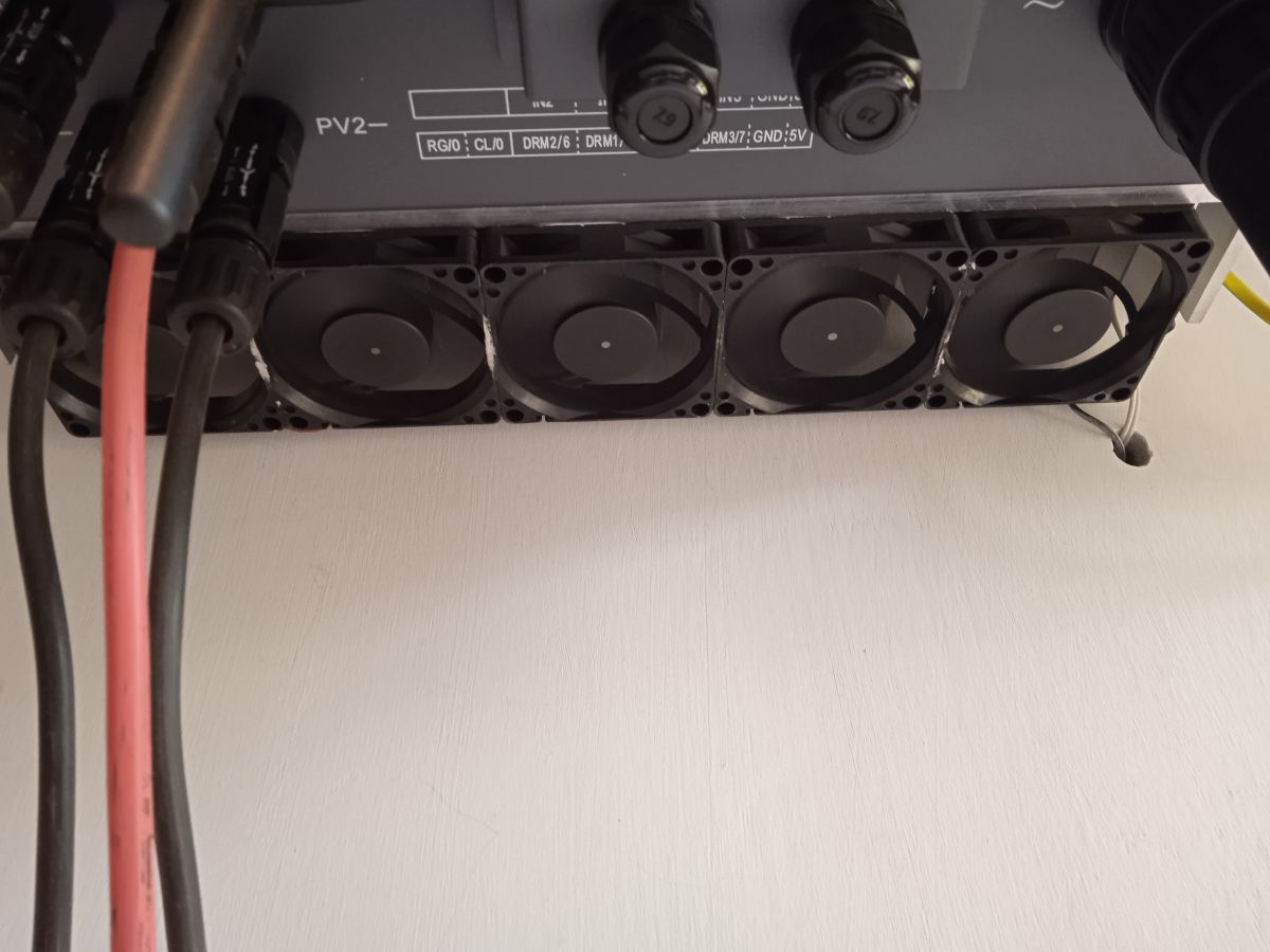

    Are any of you for some additional cooling for the sofar?
    I did the cooling for the inverter and I have the impression that the profits have improved. The installation from April to September was only passive without cooling. Since September I have fans under the heat sink and I have the impression that the profits are better.
    I compare to several similar installations in my area from the very beginning and I have the impression that after assembling the fans it is better with the yields, the temperature of the inverter has dropped by 20p from 60 to 40 in full sun.
    What do you think about it?
    Overall, I am very happy with the installation because I rather have top-shelf profits with my 6.84kWp
    Installation preview https://www.solarmanpv.com/portal/Terminal/TerminalMain.aspx?pid=133231
  • #918 19648113
    cygan32
    Posts: 21
    I have fans for cooling, but apart from the temperature drop, I don't see any difference
  • #919 19648334
    10Tysiecy
    Posts: 102
    Rate: 10
    What is this fan? All in all, this is the only thing I wanted to do with this inverter. It does not rummage in the software, etc., because I am satisfied and I am not looking for impressions ;)
  • #920 19648485
    galica01
    Posts: 220
    Help: 10
    Rate: 47
    I bought computer fans 5 pcs 70x70x15mm, glued them together and mounted under the heat sink, I had the controller from the old stove and it was great, I set the switching on at 27 degrees with hysteresis 1 level. Of course, the regulator can be whatever I had, I gave it
    The assembly was very simple and aesthetic, I installed two springs on the connection 1 and 2 of the fan and 4 and 5 for the springs - a wire and retraction from the top of the heat sink so that the springs were slightly stretched all the time so that the fans rest against the heat sink from the bottom. Installation totally non-invasive
    The total cost for me is the cost of the fans PLN 4 / pc
    One note is that the fans are on 12v but they work on 5v because when I gave them 12v they were spinning too much and the noise was considerable and not needed, and the heat sink does not exceed 30 degrees and the fans stand more than spin.
    I hope that thanks to this cooling, the inverter will survive because the electronics do not like heat :D
    If someone wants to do such cooling and has questions, I will help because it really works
