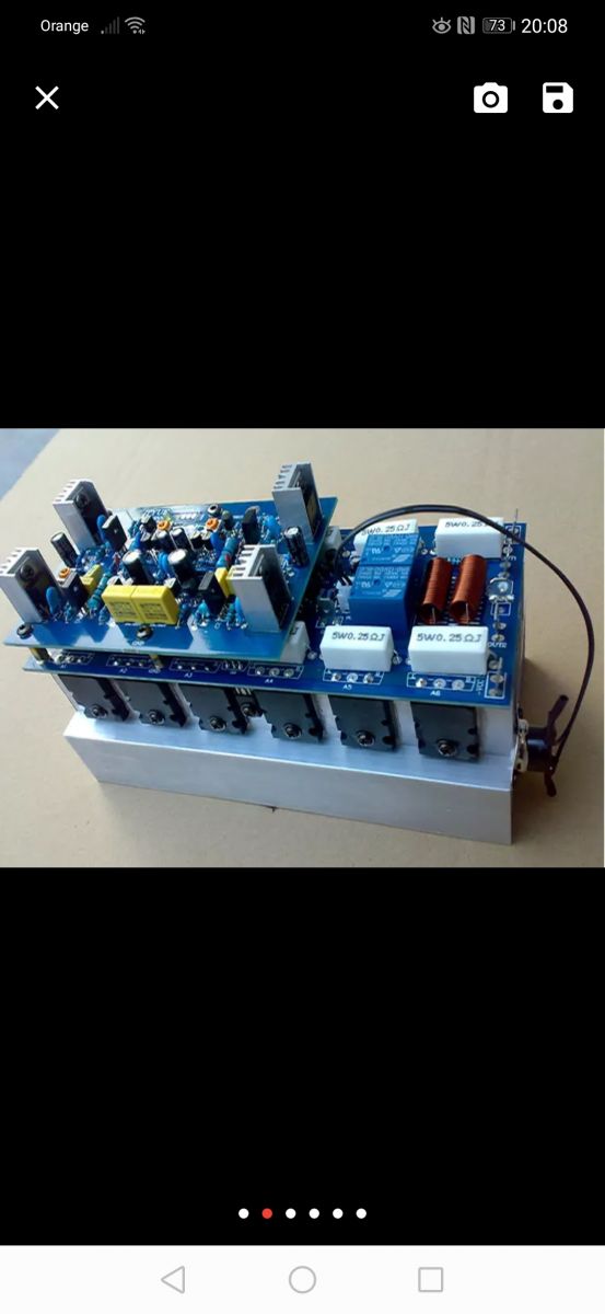

    kudlatyy1 wrote:
    I gave up, I bought two-channel modules from the Chinese, two pieces, 60v power supply and 300w power
    I understand that you are going to develop the T.AMP housing with new guts. You need to plan the layout of the modules well to make the most of the airflow.
    kudlatyy1 wrote:
    and now the question is, is a 1500 watt converter enough?
    What are these modules? Give them a name so we can find out more about them.
    When selecting a switching power supply, you need to take into account:
    - the efficiency of the amplifier
    - maximum load
    Regards.

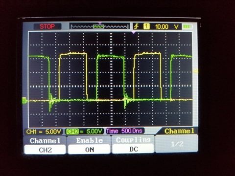

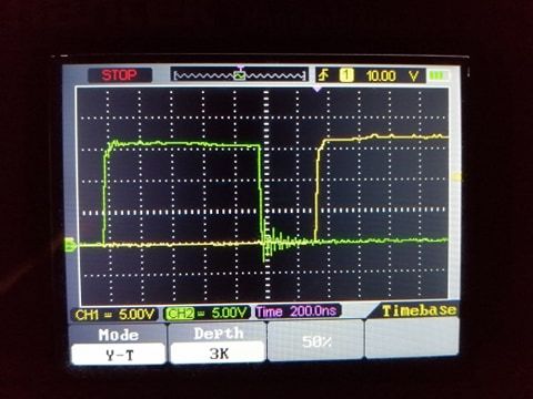

    And here we come to the merits of the case. Probably the manufacturer used a version of the system dedicated to him, because the system has been produced in a dozen or so companies over the years and as a property it was also sold to competitors on the production market several times. In addition, there are licensed products with the same or similar designation. Despite this, the old catalog notes from the time of paper catalogs from the 1980s and 1990s are still widely available today. In addition, the system was produced in various versions, including military and professional industrial ones. It is a fact that the available catalog note in many production executions does not fully reflect the applied R, C values of the generator, and dead time, and yet such systems work properly and sometimes for decades.
    It remains to check the practical frequency of work, the dead time for the entire implementation system and the selection of elements.
    In our serviced amplifiers, the value of the Ct capacitor (up to pin 5) was different for individual units from different production periods. Usually these values were: 330,390,420,430pF (measured with a laboratory bridge at a measuring frequency from 1kHz to 1MHz). Similarly with the 470-620 ohm dead time resistor.

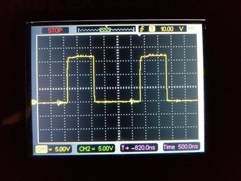

    I was able to get this converter on my feet. In my case, the damage was quite extensive, but there were no burned paths or broken chips.
    First, the BTA41-600B triac on AC power (located on a small heat sink) flew for replacement,
    Then removing all damaged elements: 4 IGBT, 2 IR2110, SG3525, LM339, Diodes and resistors on IGBT gates, the entire auxiliary converter system (+ 15V).
    In general, the process of replacing these elements mentioned in previous posts, in my case, the bootstrap capacitors on the IGBT drivers were an additional problem, after their replacement and increasing the bootstrap capacity to 4uF, the converter gets up. I am left with the assembly of power amplifier blocks (there were probably 8 power transistors burned in them, all the control ones survived). From the further start-up, I will report how the amplifier comes to life.

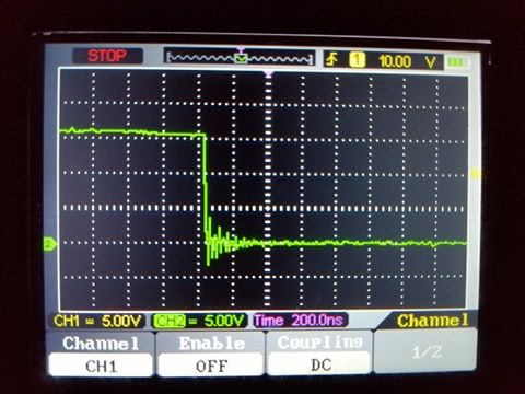

    4 ceramic capacitors 50V / 1uF. As for the bridge, he survived, and the triac behaved weird during the test: one way it kept the conduction state after the signal loss on the gate until the voltage dropped to 0, while in the opposite direction it would keep conduction, but it also faded out. right after the signal disappeared at the gate, so I preferred to replace it.
    After starting the amplifier with the main luck, instead of the artificial load, the oscilloscope was clamped only on the low voltage winding, there is 17VAC. Faulty did not want to go down, and you can clearly hear the converter, quick measurement of DC voltage at the output of the power amplifiers: 8V ... Removal of the output transistors including power bus switching transistors, then more op-amps, then 8V at the output.
    This DC voltage remains the same for each of the 4 channels, interestingly even behind the relays that are normally open, and the control does not activate them, so it's very strange ... Anyway, I will have a little digging in this invention.
    Maybe someone has any suggestions for this DC output voltage?
