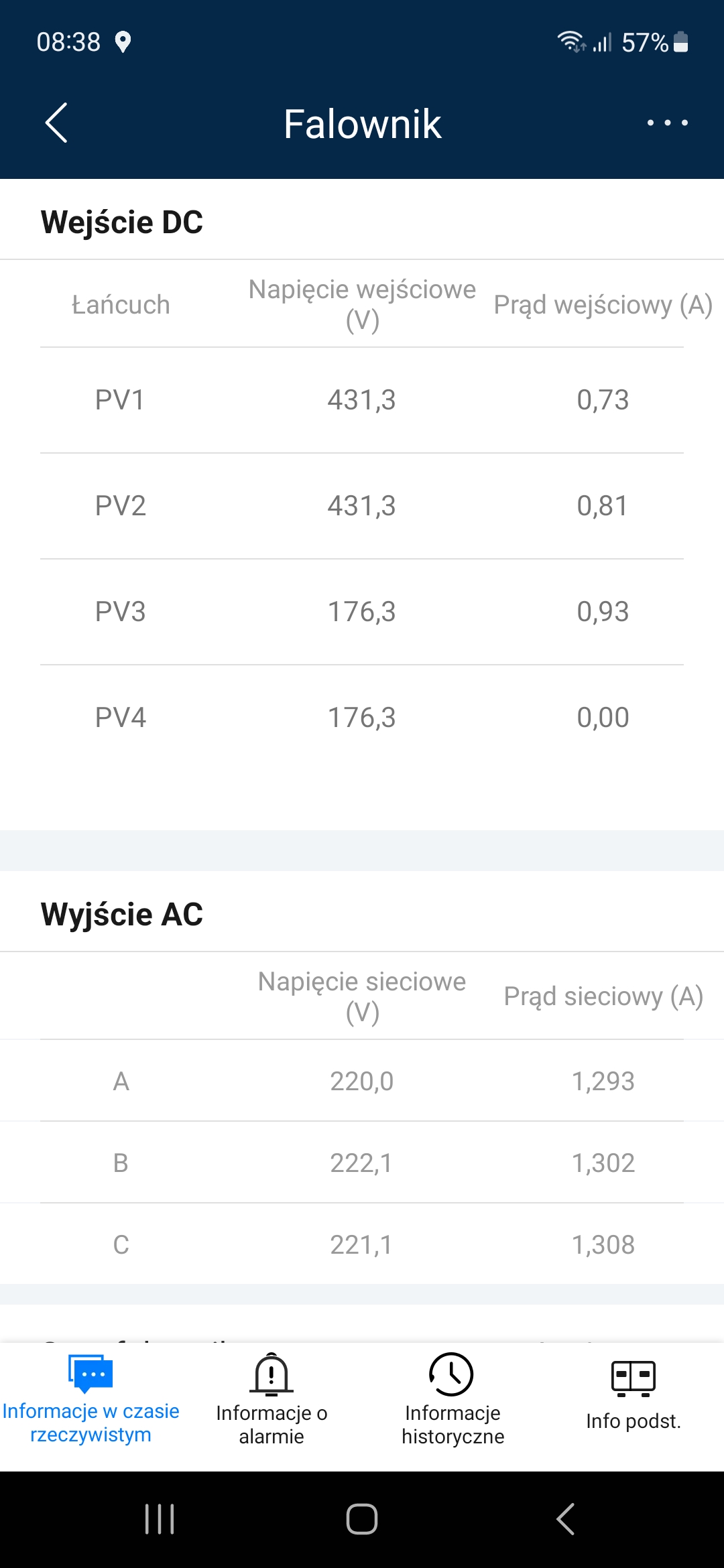

    Take screenshots in the middle of the day, as production should be, not from almost 6 pm when the installation will no longer work. You will see if the optimizers have connected to the inverter and what is the DC voltage and current. Is the first LED on the left lit or blinking during the day?
    Have you reported the problem to the installer?

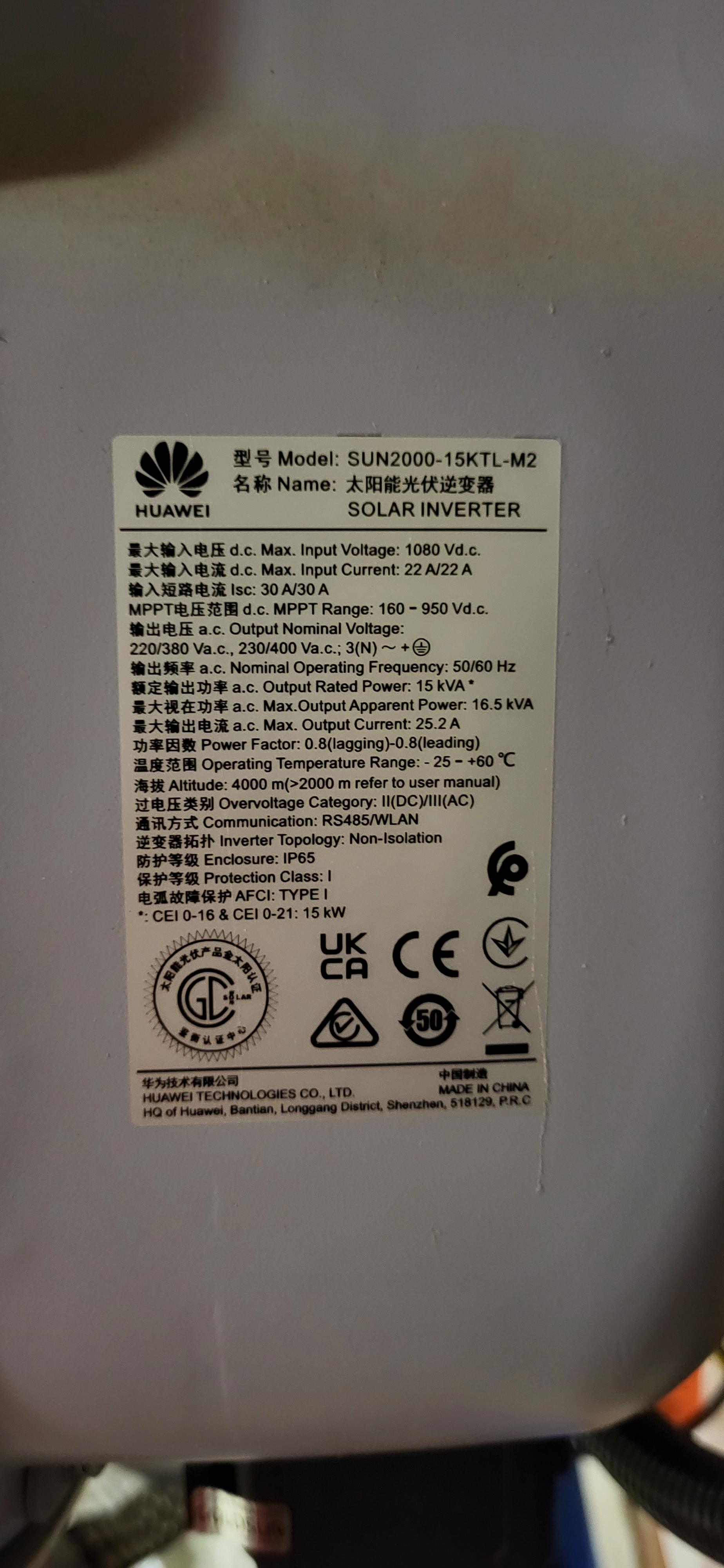

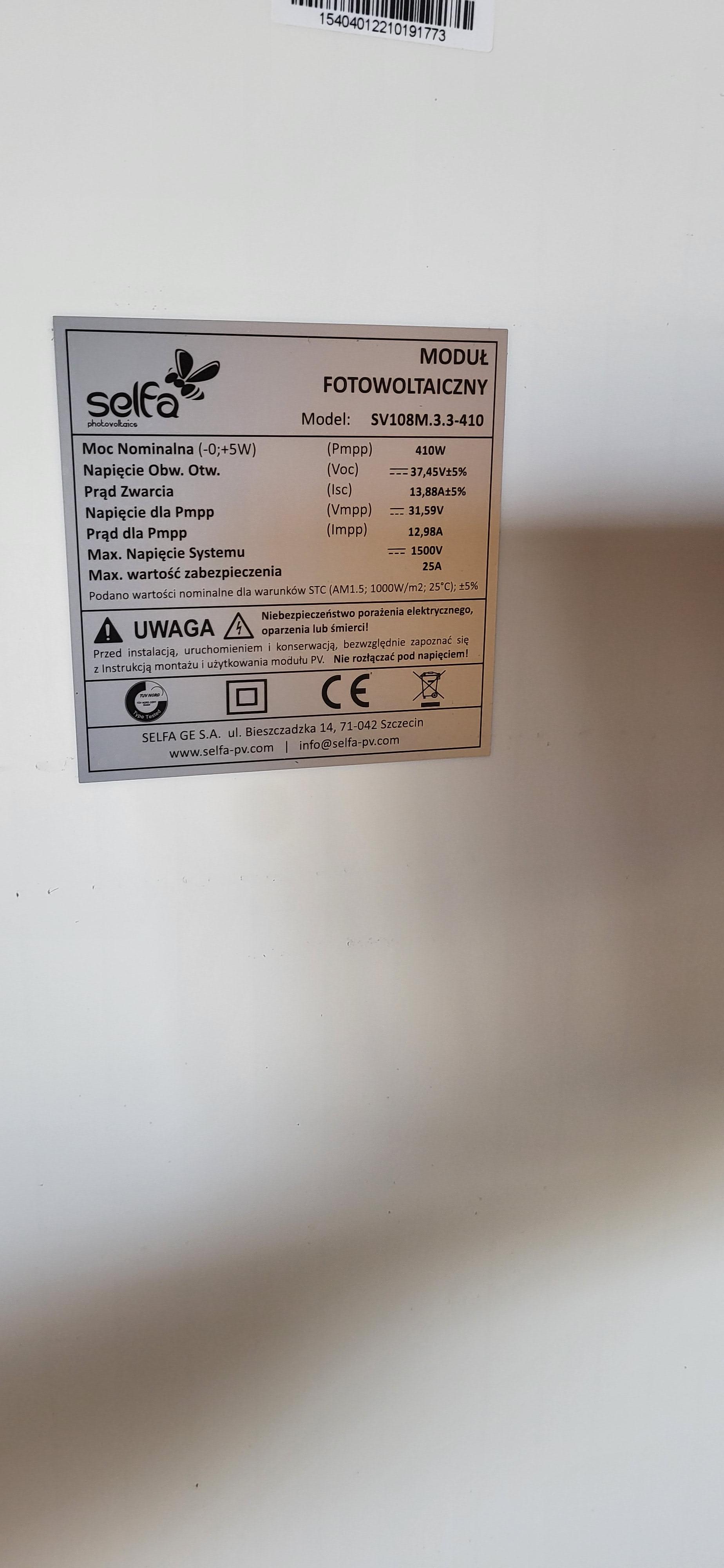

    Hello, I have a SUN2000-15KTL-M2 inverter. Two 5kW strings are connected to it, connected to the PV2 and PV4 inputs. Now I added 6 panels with a power of 2.4kW and they are on a separate 3rd string. As far as I know, the inverter has two MPPT inputs PV1 PV2 and PV3 PV4. If two 5kW strings are connected to the PV1 and PV2 inputs and the third 2.4kW string to the PV3 input will be ok. And the question is whether you need to set something in the inverter configuration if I add this 3rd string

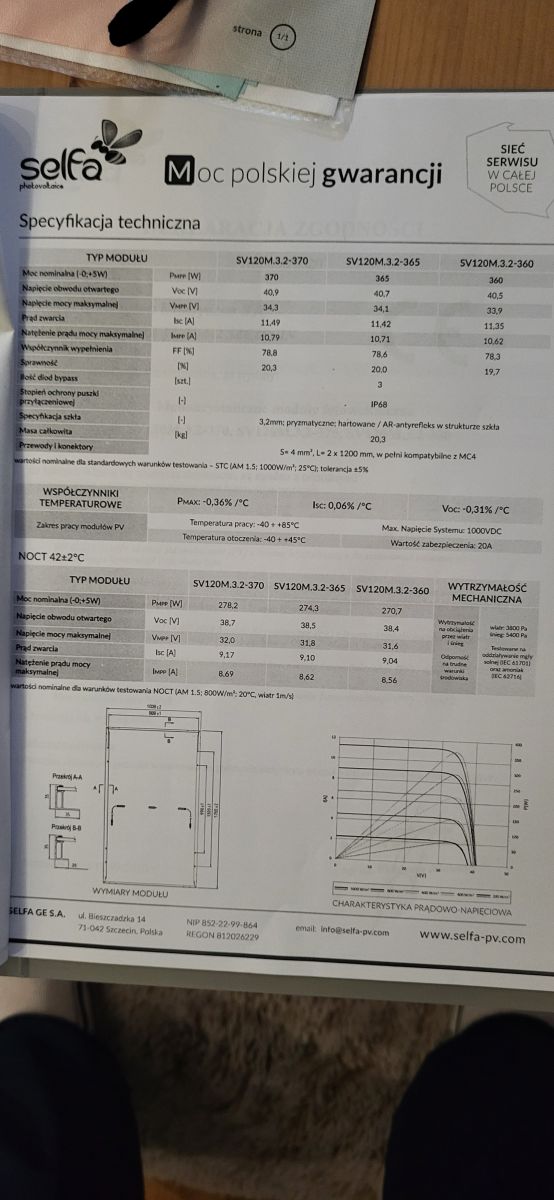

    The number of panels on two strings is 27 pieces with a power of 370w Huawei SUN2000 Inverter: WIFI Dongle Connection, Firmware Update & FusionSolar

    Thanks for the photo, it really helped :)
    Theoretically, on a string under the same MPPT there should be:
    - the same number of panels,
    - should be in the same direction
    - should be equally lit (shaded).
    If any of the parameters is not met, the MPPT becomes stupid and the efficiency generally goes down. How much lottery.
    So similar to the one above :)
    1. The connection of the panels into 2 strings 13 14 will not introduce any mega-riots. The installation may start 1-2 minutes later,
    2. Do you have the panels in the same direction?
    3. Is there uniform lighting (i.e. shading)?
    When it comes to the new 2.4 kWp ... I'm sitting counting ... and it looks bad. The exact model may help.
    4. I understand that you have already bought the panels for this 2.4 kWp, do you want to buy?
    And the important thing about the 15KTL-M2 inverter was 3 versions. Give the exact model or shoot a photo of the nameplate. You can delete the series ;)

    Yes, all panels are on the same roof surface without any shading. I have already installed 6 pieces of panels. Currently, I have two strings of these 13 and 14 panels plugged into the PV1 and PV2 inputs, and this new string of 6 panels is connected to the PV3 input. I am currently working only if there will be too much voltage on MPPT 1 on sunny days. Or would it be better to connect these 6 roof panels to one of the two tycww strings Huawei SUN2000 Inverter: WIFI Dongle Connection, Firmware Update & FusionSolar Huawei SUN2000 Inverter: WIFI Dongle Connection, Firmware Update & FusionSolar
    Yes, all panels are on the same roof surface without any shading. I have already installed 6 pieces of panels. Currently, I have two strings of these 13 and 14 panels plugged into the PV1 and PV2 inputs, and this new string of 6 panels is connected to the PV3 input. I am currently working only to make sure that the voltage on MPPT 1 will not be too high on sunny days. Or will it be better to connect these 6 panels to the roof to one of the two strings.

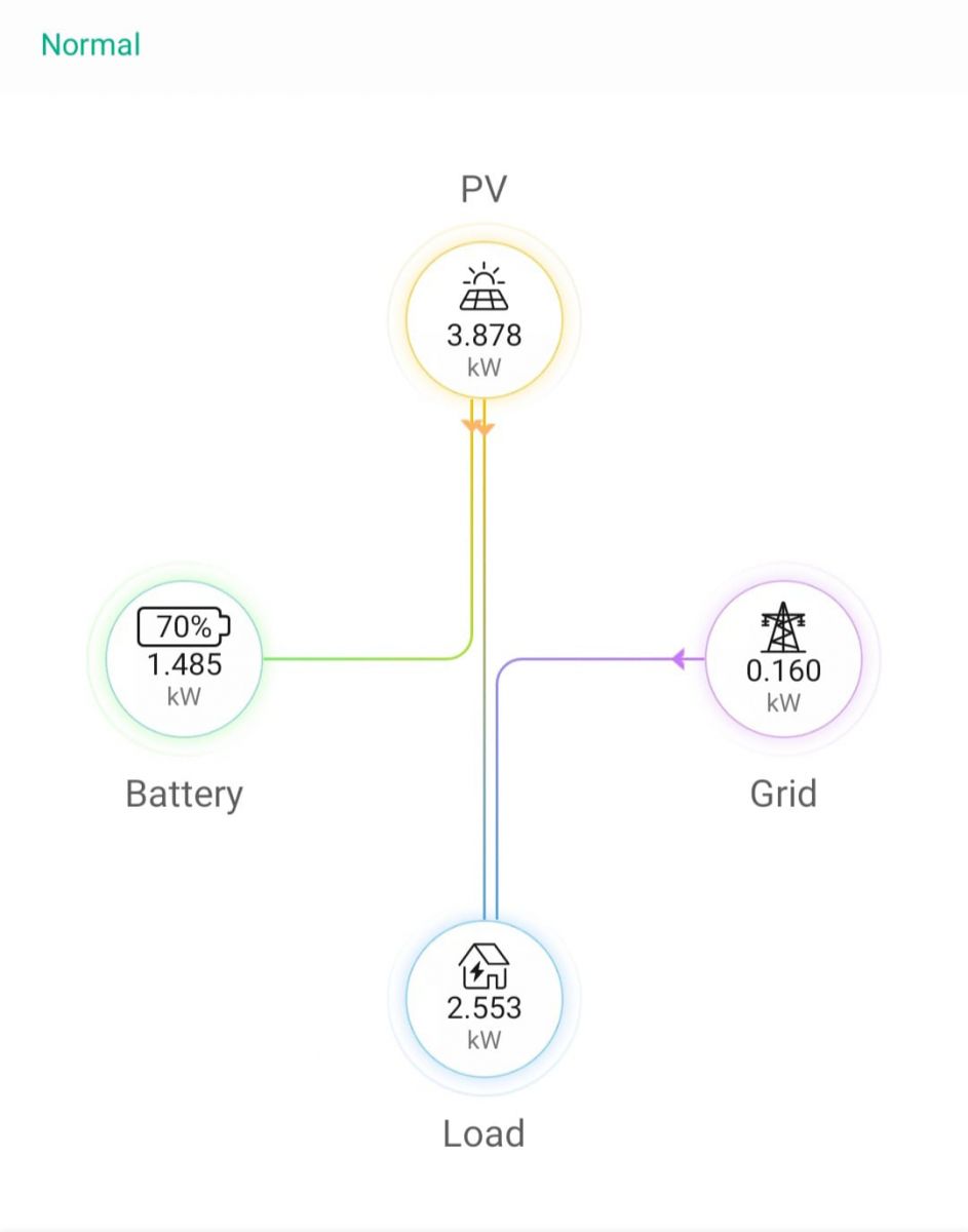

    This is what it currently looks like in rainy weather

    String 13, and 14 panels connected correctly and that’s how it should be. Don’t move anything here.
    As for string 3, it is problematic:
    According to the documentation, the start voltage for the inverter is 200V.
    Operating voltage range 160V-950V
    The panels you used have a voltage of Vmpp 31.59V
    Open circuit voltage Voc 37.45V
    And now in understandable language for a mortal.
    If you have a nice sun...
    37.45 * 6 = 224.7V, i.e. above the start voltage for the inverter = production will start
    31.59 * 6 = 189.54V above the operating voltage so once it starts it will not turn off
    But unfortunately, like clouds, weak sun, or early morning, the string reaches sufficient tension very late and production will start late or on a weak day it will not start at all.
    Someone chose the panels poorly, if you wanted to add only 6 panels, then longi or jinko would be better because they have about 41V Vmpp and 35 Voc. Not much, but with 6 panels there is already 20V.
    The only solution is to add panels to string 3 (just remember that the parameters must be the same!!) . This is not a problem, the inverter will easily pull.
    It’s interesting how someone chose the equipment. Have you indicated that you will want to expand the installation (should predict and tell you how much power of the panels you have to add later). Because if not, it’s poorly chosen.
    From experience, I will say that HUAWEI likes a load of 110-115% of the nominal power. eg KTL6 - 6kW fastens nicely with a load of 7.2kWp. It is about the efficiency of generating alternating voltage.
    In your case, with the panels installed so far, KTL10-M0/KTL10-M1 would be enough.
    In the version with 6 panels added, KTL12.
    With this inverter, what do you have, I would suggest the total power of the panels in the range of 16.5-17kWp :) but I know it costs, and space for assembly.
    Another note, but only if you are a prosumer. Does not apply to net meeting (new rules).
    One more thing to consider when expanding. If you are a prosumer and you have 10kWp, you "recover" only 70%. In practice, it looks like that when you collect electricity on the heat pump and you had 10kWp, you expanded it to 12kWp. It is by changing the billing that you will collect a very similar amount of electricity for the winter :] You have spent extra hay and a big ch... So it is only reasonable to expand to 10kWp, and then above 15kWp.
    It is true that you can always switch to new billing rules, but remember that we currently sell electricity at the average price from the previous month, and from June REVOLUTION will be billed hourly. A friend lives in Germany, he has hourly settlements and there you pay for peak productions. Time will tell what will happen to us.

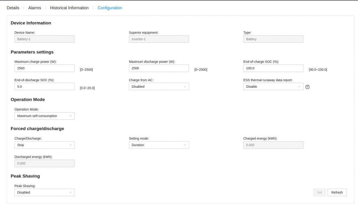

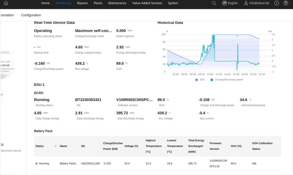

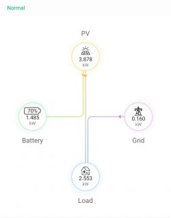

    Hey everyone, after long searching I found this forum and would like to get advice on my installation that no one seems to be able to help me with. I have Huawei sun2000-6ktl-l1 with one battery and 9kwp panels. It works in grid-tied mode with maximum self-consumption without giving any energy to the grid. My issue is that even I am on maximum self-consumption I am always taking some energy from the grid 1-2kwh every day and in the morning my battery is always half full. What I would like is not to take any energy from the grid. Can I do it somehow with changing the settings or do I have to go to Island mode? I am a bit scared of Island mode when there will be not enough sun but for me it doesn't make sense to pay for 700kwh per year when I produce more energy than I will ever use. Thank you everyone :)

    Hello, after a long search I found this forum and I would like some advice on my installation where no one is able to help me. I have a Huawei Sun2000-6Ktl-L1 with one battery and a 9kWP panel. It works in a mode related to maximum consumption without consumption, giving no energy to the grid. My problem is that even I have maximum consumption, I always take 1-2 kWh from the grid every day, and in the morning my battery is always half full. I wish I didn't take any energy from the grid. Can I do this with changing settings or do I have to switch to island mode? I'm not afraid of island mode when there's not enough sun, but it makes no sense to me to pay for 700kWh a year when I'm producing more energy than I'll ever use. Thank you all :)
  • #1045 20519999
    velkhor
    Posts: 49
    Hello oliverco. Welcome to the Polish forum.
    You didn't specify how much energy you have. Is it Huawei Luna-2000 or some other manufacturer?

    Thank you for your answer. Yes, Huawei Luna 5kW
    Added after 9 [minutes]:
    >>20519999 Huawei SUN2000 Inverter: WIFI Dongle Connection, Firmware Update & FusionSolar
    I mean there's enough power, but it picks up off the grid like it always needs something

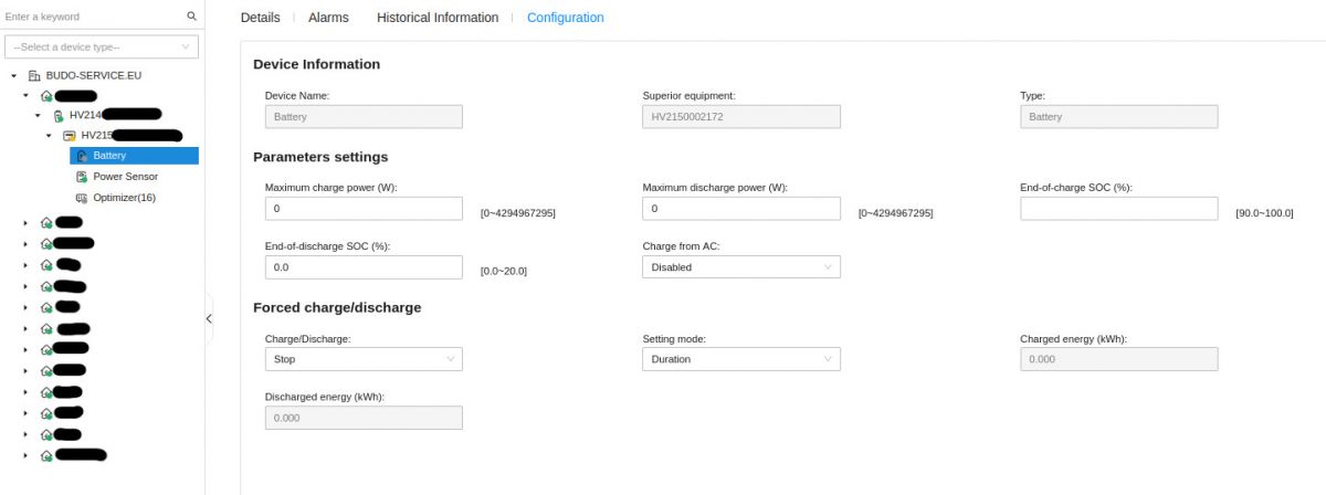

    Can you provide a screenshot of your configuration. What I mean.
  • #1048 20520074
    oliverco
    Level 4  
    Posts: 7
    Sorry, this is different
