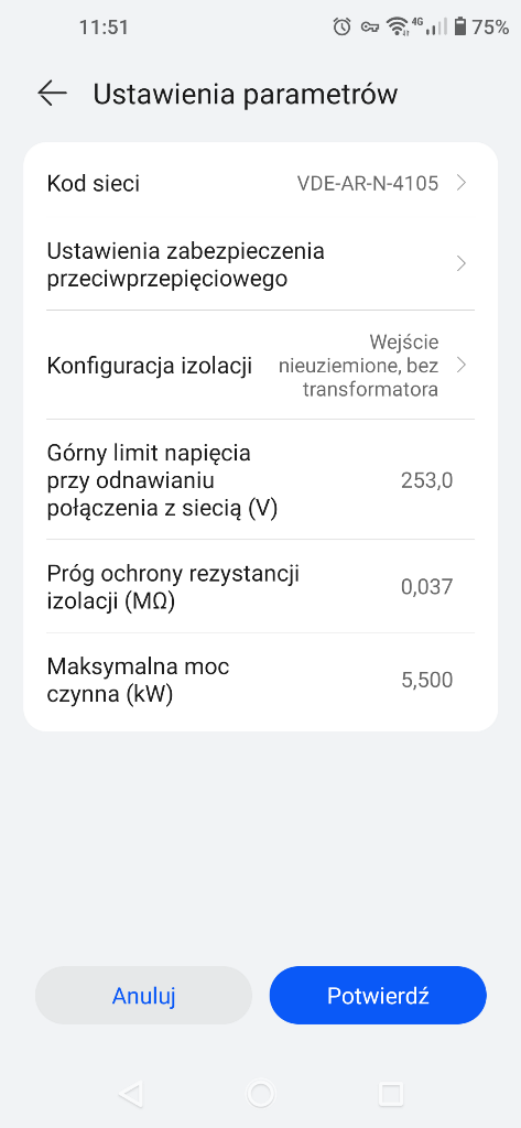

    What, then, should I set something on the network? VDE ARN 4105 is the default but it is a German network.

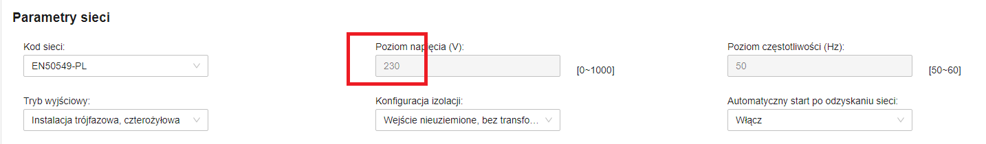

    WS Transport AS wrote:
    >>20566618What's there in this other post that isn't in this?
    At the beginning, I will refer to the fact that there is information that the installation is in Norway and the electricity goes to the operator in Norway, not in Poland. But about this 2 sentences at the end.
    After analyzing and counting, it turns out that everything is well-chosen. I have 2 suspicions, wrong connection, as one of my colleagues has already mentioned, 11A is over.
    I didn't have 10KTL-M1 in my hands, so here's a question for you. Do you know which terminals the installer connected the DC strings to? In KTL 4,6,8 version M2 number of connectors = 2x number of MPTT. It connects to pair 1 and 3, because pair 1 and 2 are MPTT1 and 3.4 MPTT2. I don't know if it's the same here.
    The second issue is that someone set something wrong. It is definitely a mistake to set the network to the Czech Republic. You know ... a few years ago, when the networks were crawling, the "installers" made such rubbish in Poland that they uploaded the Czech network, instead of making generic and entering the parameters from the finger. They argued that it was also 230V. Except the frequency limits, disconnection voltages, and a few bugs were completely different.
    Later, they started to set up the German network in our place, it is much more similar to ours, apart from a small detail, our maximum voltage is 252V, Germany a few volts higher. Installers still believe that if the inverter turns off too often, you have to switch to the German network instead of verifying what is wrong with the installation. With my own eyes, I met such a bummer that the "installer" put on 2.5mm2 about 40m and when the inverter turned off, he ordered to switch to the DE network, it helped a little but not well. I suggested to a friend to replace it with a minimum of 4mm2, he went crazy and assumed 6mm2. PL network settings, shutdowns still occur but sporadically.
    In addition, important considerations for introducing substandard voltage into the grid are very high fines, or seeing a square sun. And hardly anyone will tell you that the meters have the ability to record the maximum voltage that is introduced to the network, just as they register reactive energy, cos fi max power and a few other parameters. In my area, people have already received "penalties" for the fact that the paper was 8kW, and the falowik was 12 and additional panels were added, without notification.
    Returning to the installation, it suggests changing the network to a network with the correct parameters. Check with the configuration required by the operator.
    Alternatively, there is always a factory reset and setting from scratch. I do not know how in Norway, but in Poland, when I got equipment from customer import (from DE), the inverter at the first startup based on GPS location detected that the network is in Poland and suggested changing the network to PL. It was really hard to screw this up.

    Your inverter has 230V, 4-wire installation, i.e. you have the following voltages:
    L1-N 230V
    L2-N 230V
    L3-N 230V
    and in Norwegian a 3-wire installation, i.e.:
    L1-L2 400V
    L2-L3 400V
    L3-L1 400V
    ^^^ here's a mistake thanks for the explanation man learns all his life.
    Seemingly the same, but not quite ... if you do not understand, it means that there is no elementary idea of \u200b\u200belectricity.
    And if you don't understand it, then don't try it. ELECTRICITY IS NOT A TOY, ESPECIALLY WITH SUCH POWER. You can experiment with what happens when you drink a liter of milk and eat a jar of pickled cucumbers... :D

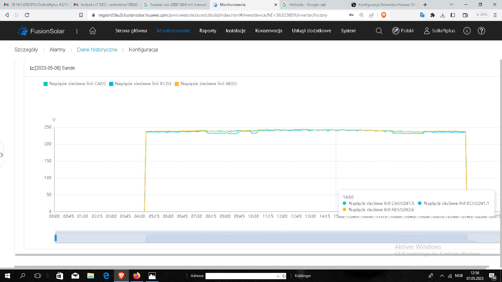

  • #1086 20568322
    WS Transport AS
    Posts: 19
    Everything is correct. I use a transformer to power 400V equipment.

  • #1088 20569069

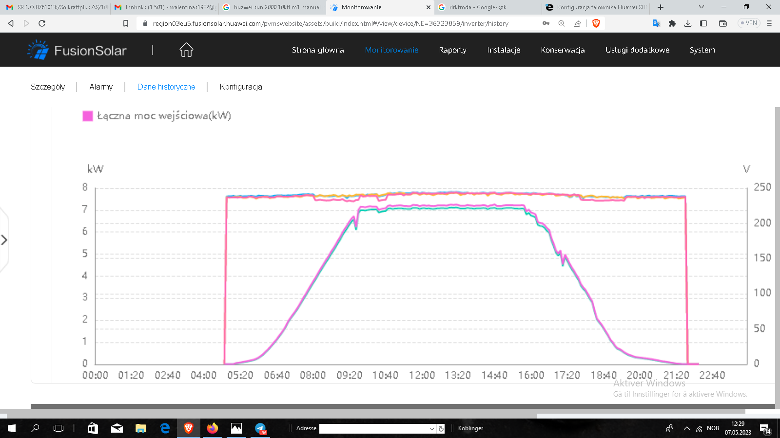

  • #1092 20570605
    WS Transport AS
    Posts: 19
    Hello again.

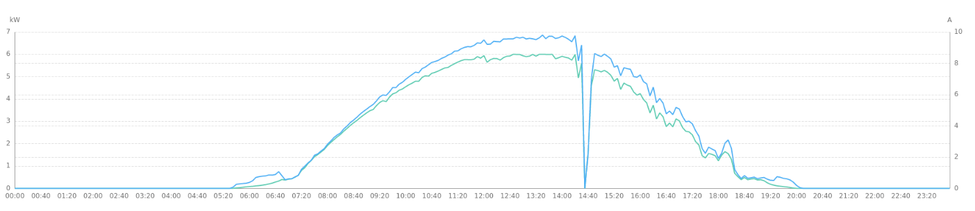

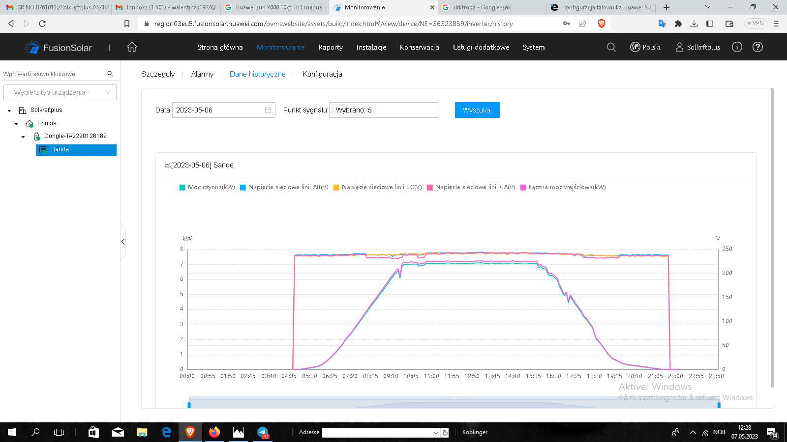

    After many attempts to change the settings, I come to the conclusion that either the panels are defective or the overline is not optimal for maximum energy yield. Max you get out of the panel is 7A. Rated power current of the panels is 10.72 A. The panels are mounted on a house with a gable roof on a slope facing south -10 degrees. The slope of the roof seems to be a bit too small, about 15 degrees. We will wait a little longer for the operator's response regarding the settings and try to enter "by finger".
    Huawei SUN2000 Inverter: WIFI Dongle Connection, Firmware Update & FusionSolar Huawei SUN2000 Inverter: WIFI Dongle Connection, Firmware Update & FusionSolar Huawei SUN2000 Inverter: WIFI Dongle Connection, Firmware Update & FusionSolar Huawei SUN2000 Inverter: WIFI Dongle Connection, Firmware Update & FusionSolar Huawei SUN2000 Inverter: WIFI Dongle Connection, Firmware Update & FusionSolar

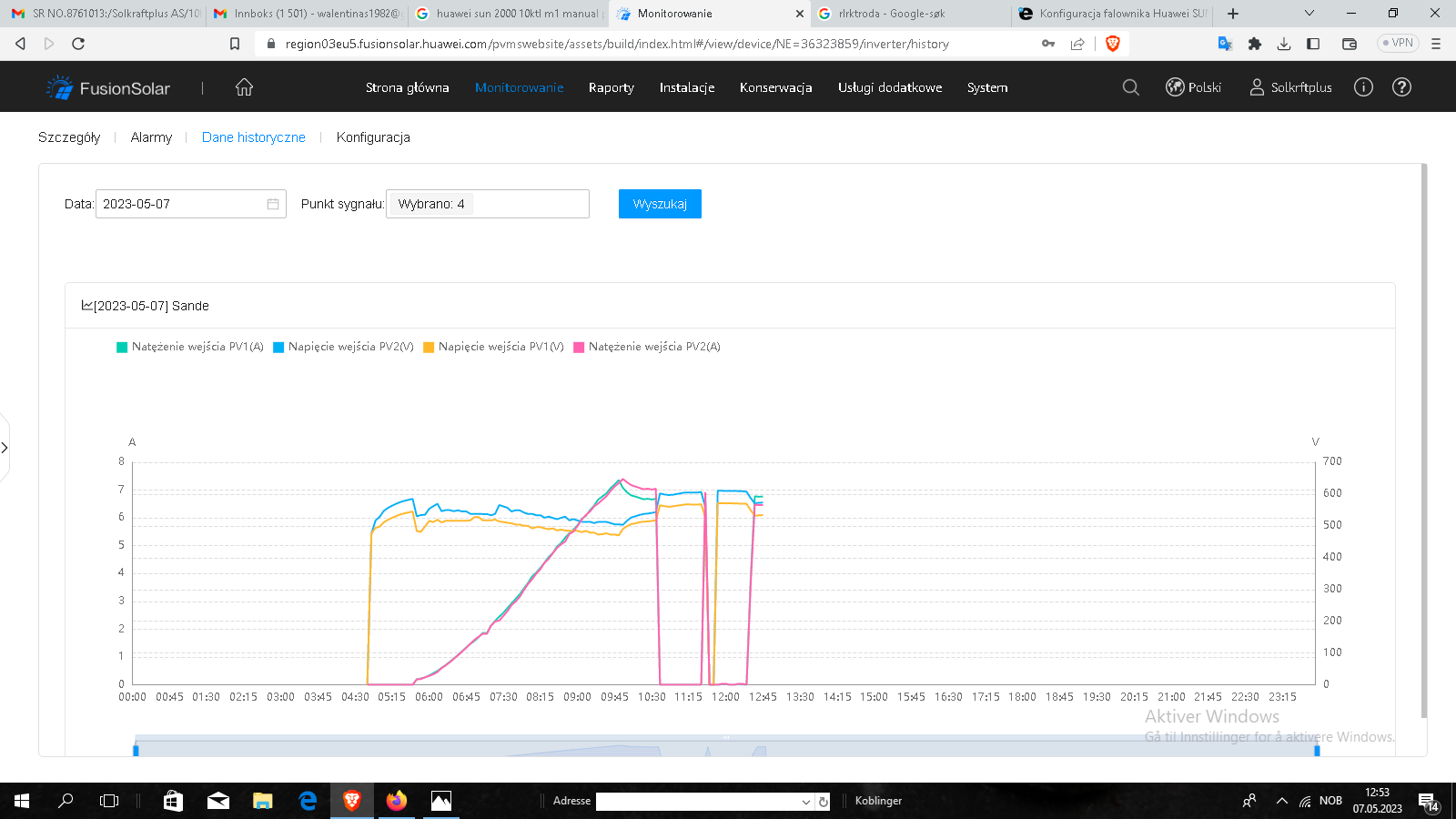

    And ass, with my idea. I was hoping that the problem would be too much asymmetry of the voltages L1-L2, L2-L3, L3-L1. But it looks good.
    Max you get out of the panel is 7A. The rated power current of the panels is 10.72 A.
    The output graph shows that the cutoff is an inverter issue, not a panel issue. I don't think it makes sense to look for a problem here. There is no current limiting device in the panel. It is limited by the internal resistance. If the panel did not keep the parameters and max had 7A, the graph would be such a nice sine wave, without flat cut, only max would be 7.
    And post a graph of DC voltages and currents from 06.05. :)
    How did you check it, when connecting to the inverter, the MPPT on the inverter cuts like that. You won't be able to measure it that way. It was ideal if you had a meter for measuring PV installations, there is a short circuit measurement, but you can also measure it with a multimeter (just set the right range so as not to burn it, 20A is enough, if you have a 10A chance that you will fail the meter).

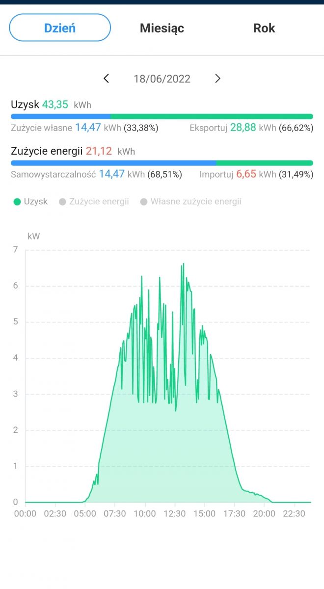

    Panel data: current at maximum power (Imp/A): 10.85 (STC). It did not reach the maximum current because the sun was weak, but the graph is such a hill, without a cut.

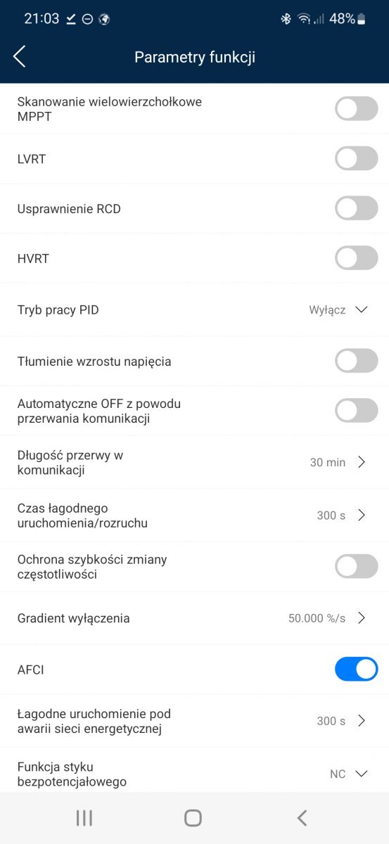

    Upload a screen of the inverter settings, but all settings, Network parameters, Protection parameters ... etc.

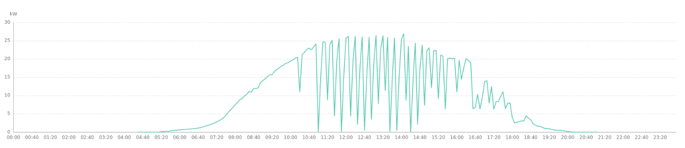

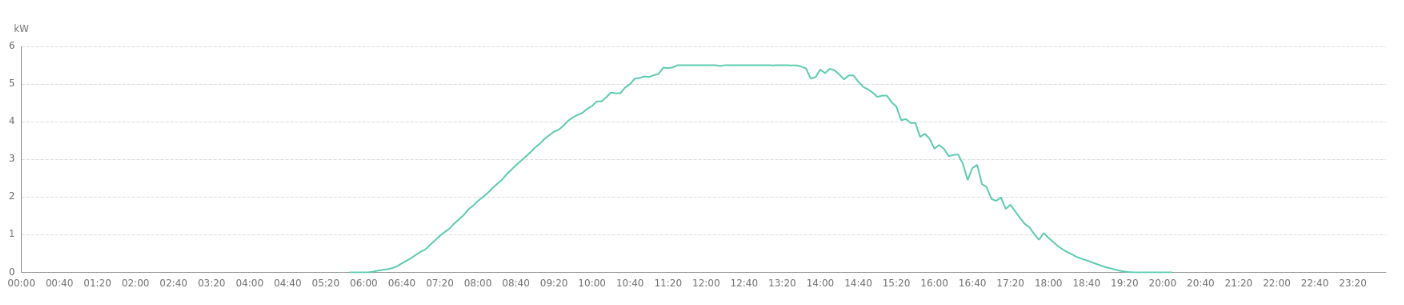

    And this is what it looks like when you exceed a parameter and disable the installation:
    definitely different than yours, with you it looks like trimming the output power from the inverter.
    Here you have a case when the power of the panels is greater than the power that the inverter wants to process:
    [img]https://obrazki.elektroda.pl/4409674800_1683474163_thumb.jpg[/img
    KTL5 inverter, 6.23kWp panels.
  • #1094 20571152
    pv1
    Posts: 182
    Help: 12
    Rate: 34

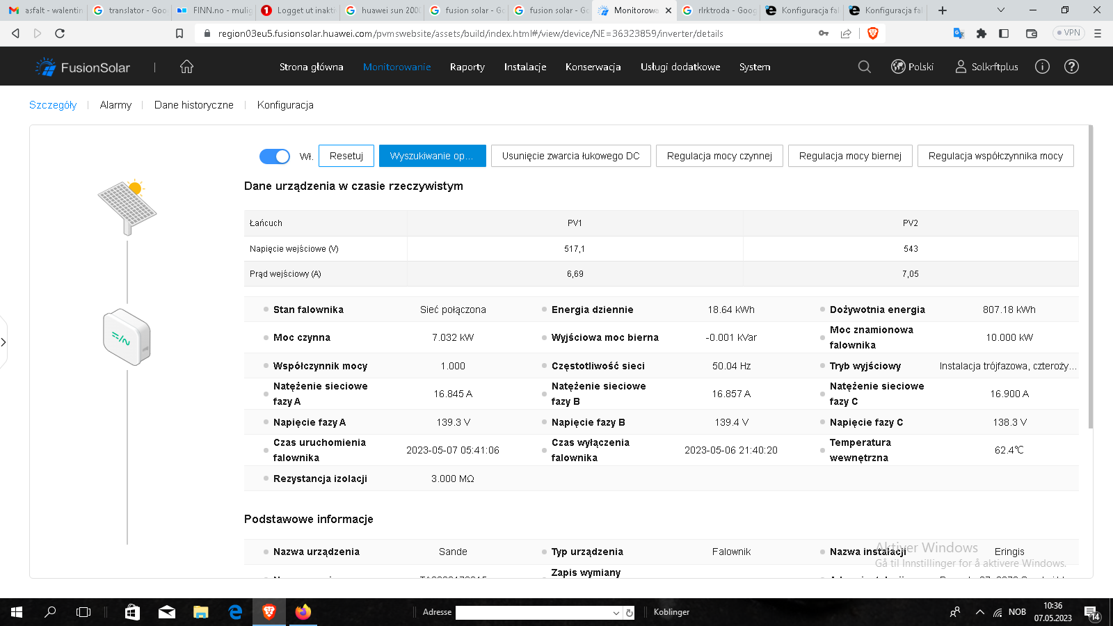

    Looking at these device data in real time, there is already a max. AC current and voltage within 140V.
    The SUN10KTL M1 inverter has a max. AC current 16.9 A and at 140 V it will not squeeze more out of it, although there is much more from the DC side.
    That is, the selected parameters for the country (grid) are incorrect because the inverter measures phase A, B, C voltages incorrectly.
    You are indeed right :) The inverter chokes because it exceeds the maximum AC current, not a DC problem.

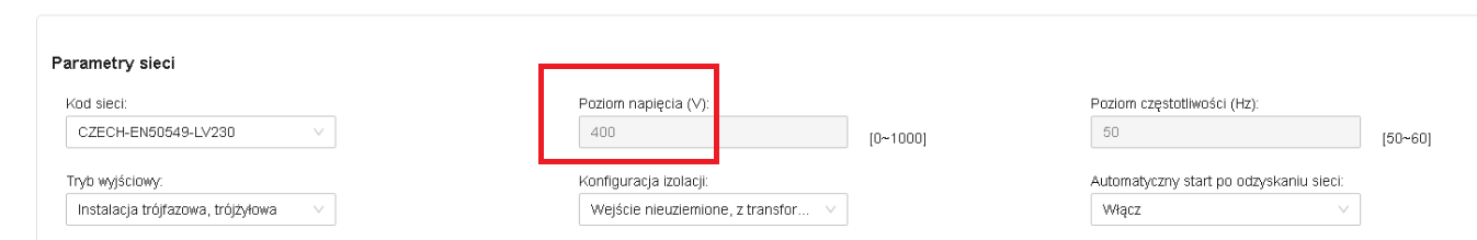

    The inverter measures the voltages well. A colleague wrote that this is a Norwegian network and there is a little different with voltages. Not like our 230/400, only the devices are powered phase-to-phase and the phase is actually about 130V.
    There seem to be 2 possible solutions. Replacing the inverter with a larger one, or adding a 3x400V / 3x230V transformer.

    On the "CZECH" network, the inverter measured AB, BC, CA phase-to-phase.

  • #1106 20627002
    Toms_81
    qrko wrote:
    macif wrote:
    qrko wrote:
    I'm 145 and it's called the same. It works quite nicely, it lowers production, but not by as much as 10 shutdowns of the inverter. I set that above 253V to drop production to 25 percent. Yesterday the lamp was on all day and not a single switch off.
    Do you have the "Voltage suppression function" enabled? If so, can you show where it is, but logging directly to the inverter? I don't have an installer account via www. Today the frying pan and the voltage jumps again on the third phase .... :/
    It's in 2 places, here's one of them. I don't remember the second one and I'm away from home. Huawei SUN2000 Inverter: WIFI Dongle Connection, Firmware Update & FusionSolar
    Hello, I tried to set this option at home but unfortunately it is not in my menu in Sun2000.
    Do I need to activate it somehow or has it been removed in some update?
  • #1107 20627888
    xszuflax
    Posts: 53
    Rate: 7
    It's in FusionSolar on the latest firmware. This option is for active and reactive power. In the case of frequent shutdowns, I would try to enable in both places. "Installer" access is needed.
  • #1108 20628128
    Math13
    Posts: 112
    Rate: 34
    @xszuflax I have downloaded the latest firmware 6.24.00.111 for the application and installer permissions. I don't see this option anywhere. And anyway, on FS in this latest firmware in "Parameter Settings" there is a negligible number of parameters to change. Only 6 items.
    Can you indicate where to look?
    There are definitely more configuration options in the SUN2000 application version 6.24.00.111, but I cannot find the "voltage suppression" setting for active and reactive power there either.
  • #1109 20628706
    xszuflax
    Posts: 53
    Rate: 7
    Hi,
    I use FusionSolar for iPhone and I have everything.
    best,
  • #1110 20628759
    Math13
    Posts: 112
    Rate: 34
    xszuflax wrote:
    Hi,
    best,
    I see.
    So Android and iPhone users are not treated equally by Huawei. :-(
