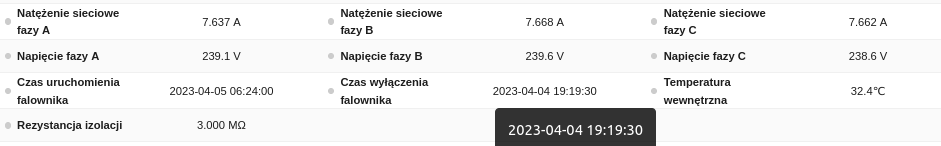

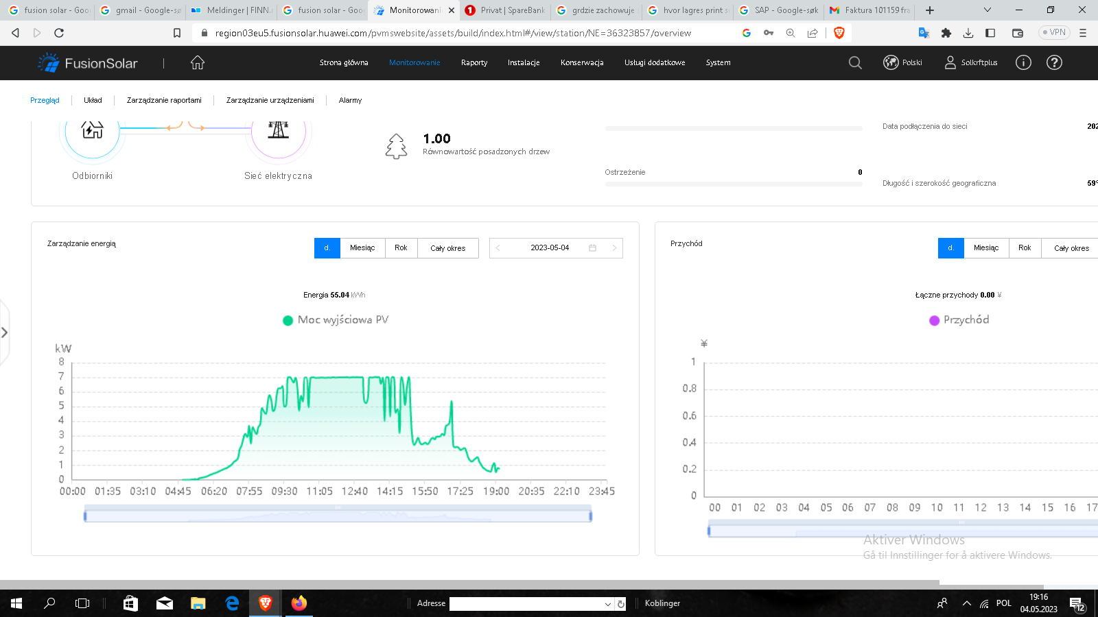

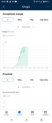

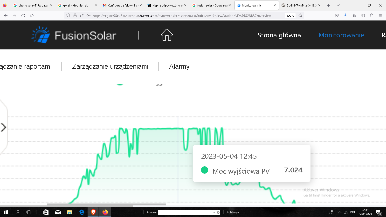

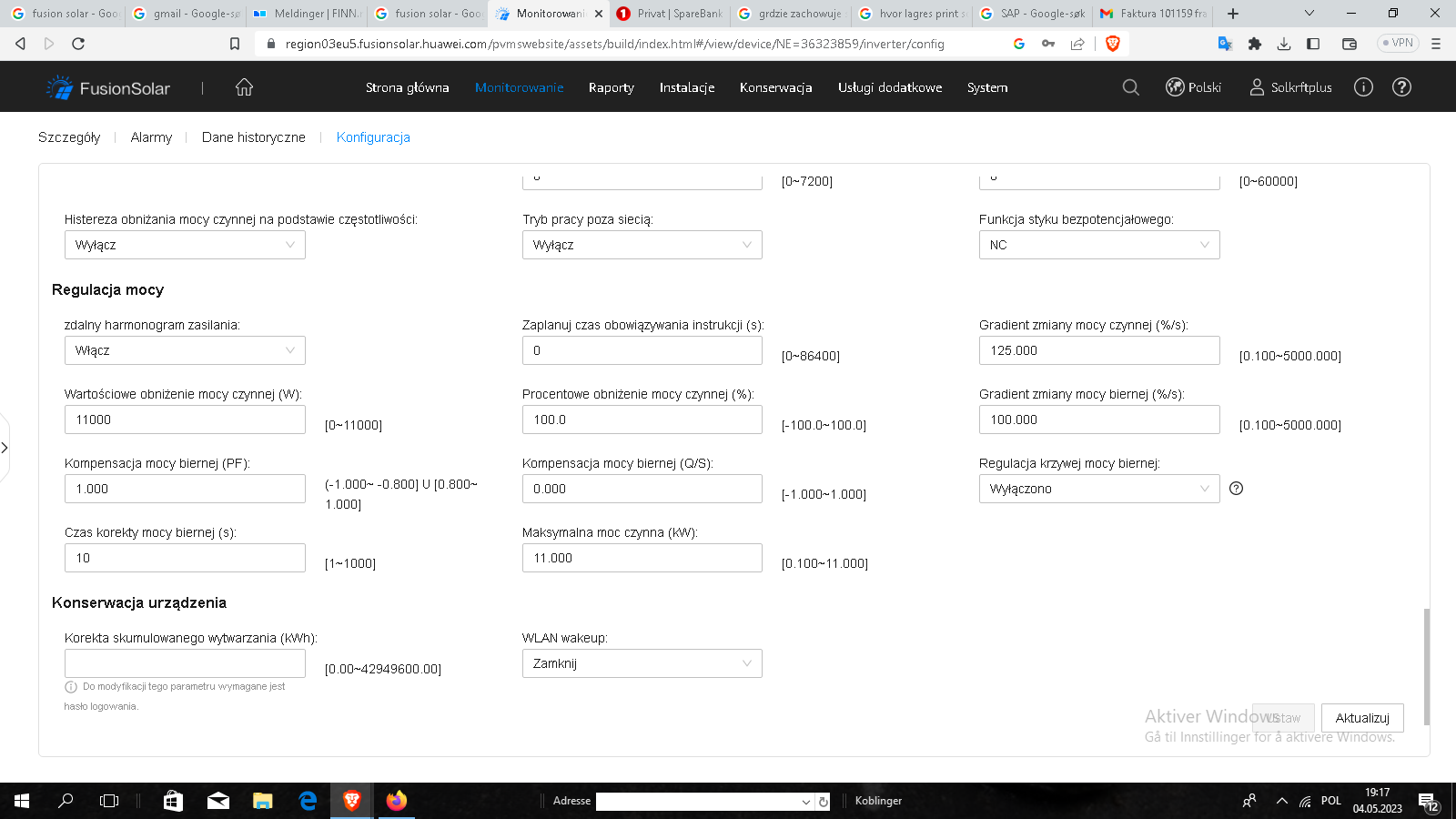

  • Possible inverter power limiting despite max settings
    #1066 20566174
    WS Transport AS
    Posts: 19

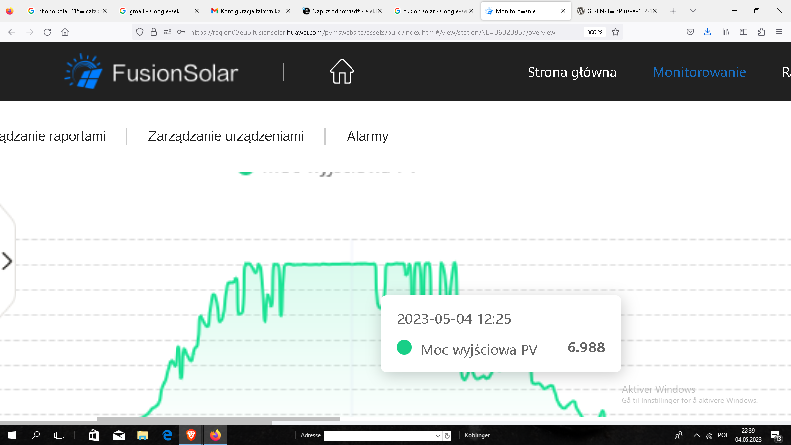

    I have a 10ktl inverter - M1, rooftop 11200W all south. The maximum temporary power of the installation does not exceed 7100W. In my opinion, this is definitely not enough. The graph is completely missing peaks, the graph looks as if it has been cut off. In the network and security parameters, the values are set to maximum. Where else can you look for the cause of limiting power? Huawei SUN2000 Inverter: WIFI Dongle Connection, Firmware Update & FusionSolar [/url]
  • #1067 20566235

    Maybe you have too strong panels that have a current greater than 11A
  • Check active power reduction setting in inverter menu
    #1068 20566250
    velkhor
    Posts: 49
    I can't enlarge the photo, it's hard to relate without it, but it looks rather like a power cut in production, not the maximum current.
    Can you give more information about the panels, number of strings, etc?
    I don't remember where it was in the app, but it's on the web at:
    Inverter settings -> Power regulation -> Value reduction of active power (W) In addition to the input field, you should have given limit values, for KTL-11, it is probably 0-12100 (writes from memory).
    If the installer put a "block" there, he may have done it intentionally. Huawei do not have a power limit turned on by default, at least I have not encountered it. What is your declared power connection, what wires.
    Don't touch the rest of the parameters!!!

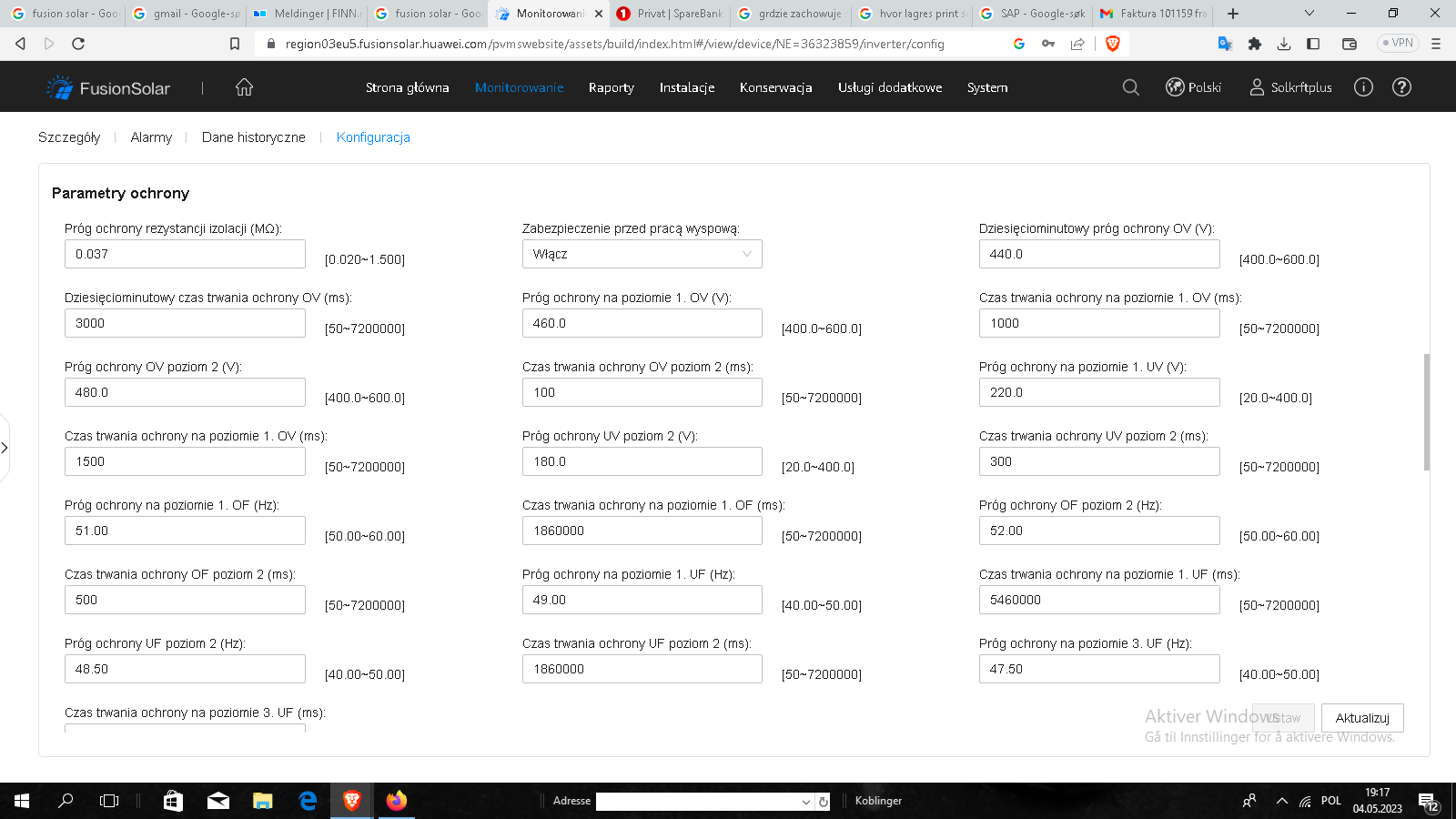

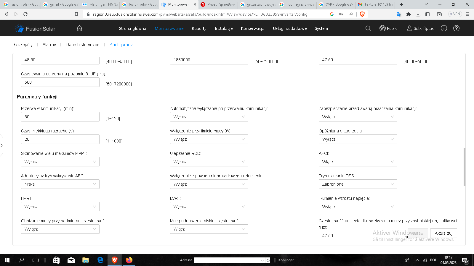

  • Request for paid Huawei inverter settings guidance
    #1071 20566685
    WS Transport AS
    Posts: 19
    10KW inverter. On the roof, 2 strings connected to two MPPTs. The first string of 13 panels of 415W, the second string of 14 panels of 415W. The inverter works with the 3x230 V IT installation. At the moment, the inverter is running, but it needs to be optimized, among other things, the active power. Can someone who knows exactly about the settings of Huawei inverters, be able to conduct an online course with me and explain what, what function means, and how to select parameters in individual windows? Of course, for a fee.
    Huawei SUN2000 Inverter: WIFI Dongle Connection, Firmware Update & FusionSolar Huawei SUN2000 Inverter: WIFI Dongle Connection, Firmware Update & FusionSolar Huawei SUN2000 Inverter: WIFI Dongle Connection, Firmware Update & FusionSolar Huawei SUN2000 Inverter: WIFI Dongle Connection, Firmware Update & FusionSolar Huawei SUN2000 Inverter: WIFI Dongle Connection, Firmware Update & FusionSolar
    • Parametry ustawień 10 ktl.zip (75.68 KB) You must be logged in to download this attachment.
  • #1072 20566687
    WS Transport AS
    Posts: 19
    >>20566641 I don't think so. And anyway, how would the operator affect the active power of the inverter?
    [postid:c1e8712b67]20566618 Nie podałem, bo tamten problem został rozwiązany. Falownik został uruchomiony, jednak moc jest ograniczana którymś z parametrów.[/postid:c1e8712b67]
    Added after 5 [minutes]:
    [postid:c1e8712b67]Parę postów niżej powklejałem zdjęcia z ustawień. Zabezpieczenie główne jest 63 A 3x230V[/postid:c1e8712b67]

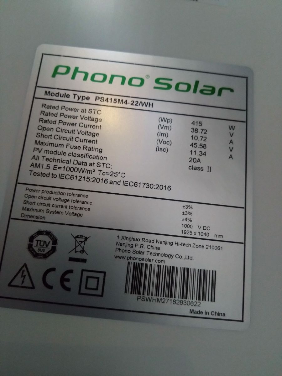

  • Requesting inverter screenshot and panel model details
    #1073 20566922
    velkhor
    Posts: 49
    strucel wrote:
    It is a pity that he did not give what in his second post https://www.elektroda.pl/rtvforum/topic3974432.html#20556899#20556899
    Well done. It's a shame that people write what and how....
    I didn't, because that problem was solved.
    It has not been resolved. It doesn't work as it used to, so something is wrong. You can't say something works A LITTLE right, either it works right or it doesn't. Just like something not a bit clean :)
    And the fact that you didn't write that the installation in Norway is another minus, because none of us know what the conditions are there, the connections, what protections and restrictions the operator uses, etc.
    But back to the topic. From this second post, it actually looks like it's not limited by the inverter. Take a screenshot but from the computer so that you can see this line up or is it straight because it seems slightly wavy. As the wavewik cuts, it is always a "needle". Give the model of the PV panels, because I'm starting to wonder if there is a problem with the selection.
    When it comes to installations, are you an installer, or did someone install them and they don't work?

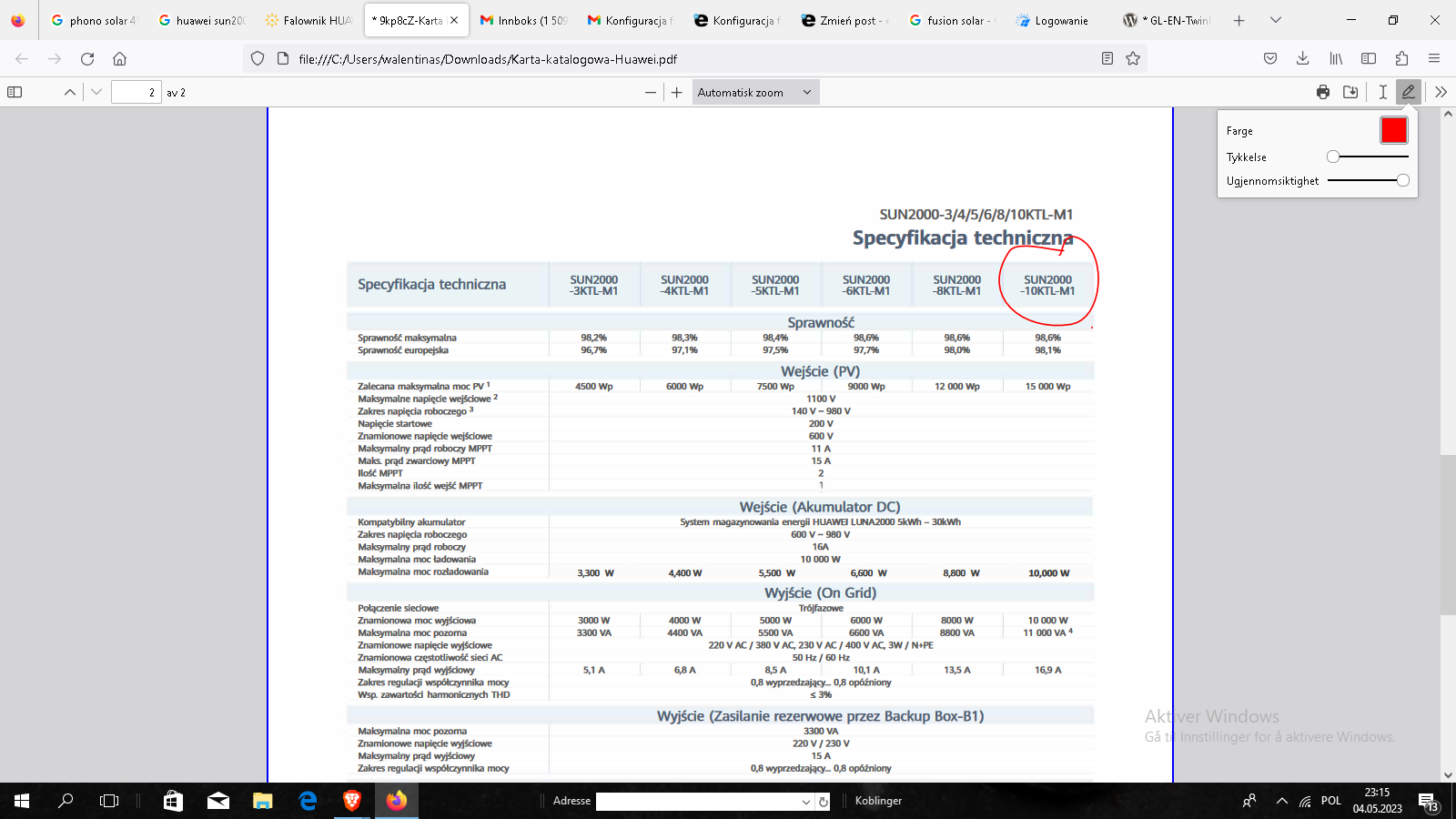

  • #1074 20566976
    WS Transport AS
    Posts: 19
    I checked. Rated current of panels 10.7A. Short-circuit - 11.17A. It is within the norm.
  • Need installation details to diagnose inverter issue
    #1075 20566999
    velkhor
    Posts: 49
    Okay, I don't want to write a million times and do offtopic. Because later, when someone is looking for information, they have to wade through junk messages that don't add anything, so I'll be brief.
    If you have a problem and you ask, and someone of good will wants to help you, and you don't answer questions, what should we, who are willing to help, think about you?
    For your convenience:
    Your answer is missing.
    You:
    I checked. Rated current of panels 10.7A. Short-circuit -11.17A. It is within the norm.
    The panel has more parameters than just current.
    But since it's fine, and you don't want to say anything about the installation specification, you have concealed that the installation is in Norway. I am asking why did you come here? Do you want to boast that everything is OK and does not work or how because I don't get it.

    >>20566922 I sell inverters and panels with assembly elements. The customer bought via an online store, installed it by his Norwegian electrician. Now it is not known whose side is at fault. Panel parameters: Huawei SUN2000 Inverter: WIFI Dongle Connection, Firmware Update & FusionSolar
    The graph of the function is not a perfect "needle", it is slightly wavy: Huawei SUN2000 Inverter: WIFI Dongle Connection, Firmware Update & FusionSolar Huawei SUN2000 Inverter: WIFI Dongle Connection, Firmware Update & FusionSolar
    And here is the specification of the inverter: Huawei SUN2000 Inverter: WIFI Dongle Connection, Firmware Update & FusionSolar

  • Possible power limit from incorrect grid settings
    #1077 20567090
    Baqo
    Posts: 233
    Help: 11
    Rate: 83
    Hello group.
    I encountered the problem of configuring the Huawei 10ktl m1 inverter for the 3x230V IT network. Installation site in Norway. It's just a startup problem. in network parameters I choose the EN-50549 network , three-phase three-wire installation, unearthed input with transformer. After several attempts, I managed to run the installation, but I was so careless that I did not take notes from the settings. After a month of time, the customer began to complain that the installation only gives 7 kW out of 10 kW. And it really looks like something in the settings just cut power. m experiment with the settings, as a result of which the inverter informs about the error: grid voltage too low. Has anyone encountered such a problem?
    Czech power grid CZECH-EN50549-LV230.
    Voltage level (V): 400V
  • #1078 20567151
    strucel
    Level 36  
    Posts: 3086
    Help: 271
    Rate: 622
    For several years, inverters installed in the EU must support LFSM-O, the fact that our operators do not use it does not mean that it is so in the entire EU, but it will be rather difficult for you to find a RES specialist in Norway here.
  • #1079 20567153
    WS Transport AS
    Posts: 19
    The inverter started with the settings as they are, on the Czech LV230 network - low voltage 230v. Now it comes to active power, which does not exceed 7100w and with a 10 kW inverter and 11200w panels it should give over 8000w.
  • Localization norm may be limiting inverter output
    #1080 20567215
    gitpusher
    Posts: 50
    Rate: 7
    I don't understand why you don't set the correct localization norm. So in this case, the relevant Norwegian standard. After all, it depends on a number of other factors, voltage limits, etc.
    The fact that he started in the Czech Republic is not an argument for me. It could just as well "start" on many others - but is it supposed to be set like this?
