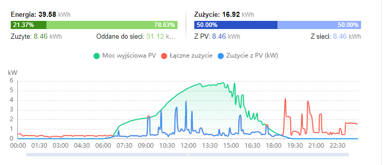

    It works without a problem. I have an inverter 6kW and 20 panels facing 75 degrees west with a power of 6.7kW and 8 panels facing -105 degrees east 2.64kW, It works very well. The ones to the west I added a year later and they greatly improved energy production before noon.
    Here you can design your layout of panels and check if everything will work.
    https://eu.smartdesign.huawei.com:31943/login...://eu.smartdesign.huawei.com:31943/index.html
    Below, the production without panels to the east and another picture with panels to the east. The peak does not change much, but in the morning the installation wakes up early in the morning. Not to be taken by the fact that the total production is similar because it was production from April and it was hard for me to choose perfect days where the sun was all day.

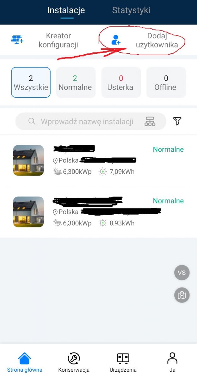

    I have two installations, made by 2 different companies.
    During the configuration, I gave each of the installers exactly the same e-mail address of my wife. Both installers assigned her without any problems as a user.
    Always in the FS app on the phone, it has a preview of both installations, without the need to relogin.
    He simply logs into the application with his e-mail address, enters the password and immediately has both in the preview.
    It seems to me that each of the installers can do it quickly and easily from the application level.
    After launching the FS app, the installer has an "Add User" option at the top right.

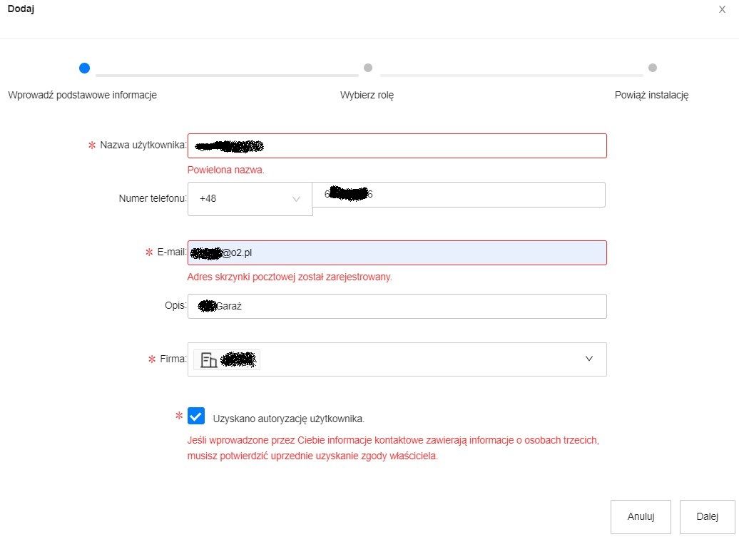

  • #1008 20482486
    Gretz
    Posts: 42
    Rate: 38
    my second installer gets these messages when trying to enter data like for the first install
    Huawei SUN2000 Inverter: WIFI Dongle Connection, Firmware Update & FusionSolar .
    and of course, the add user wizard does not let go.

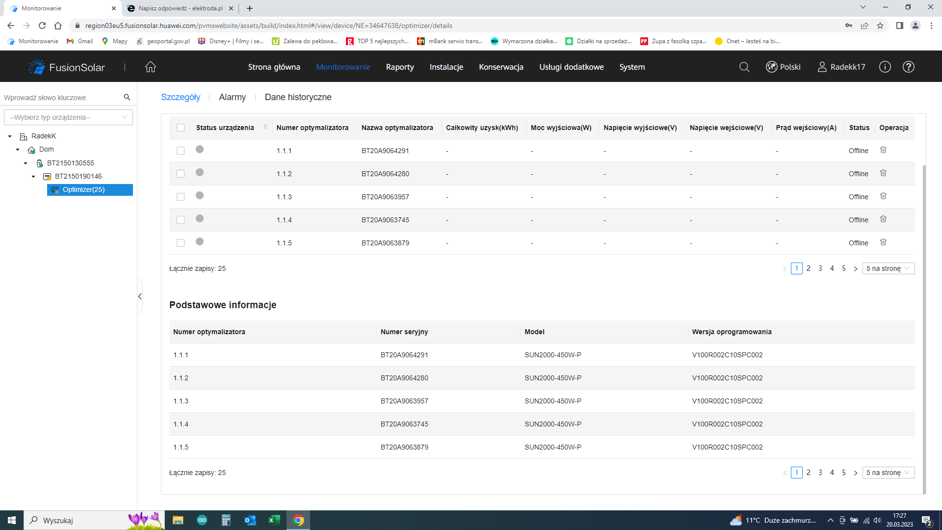

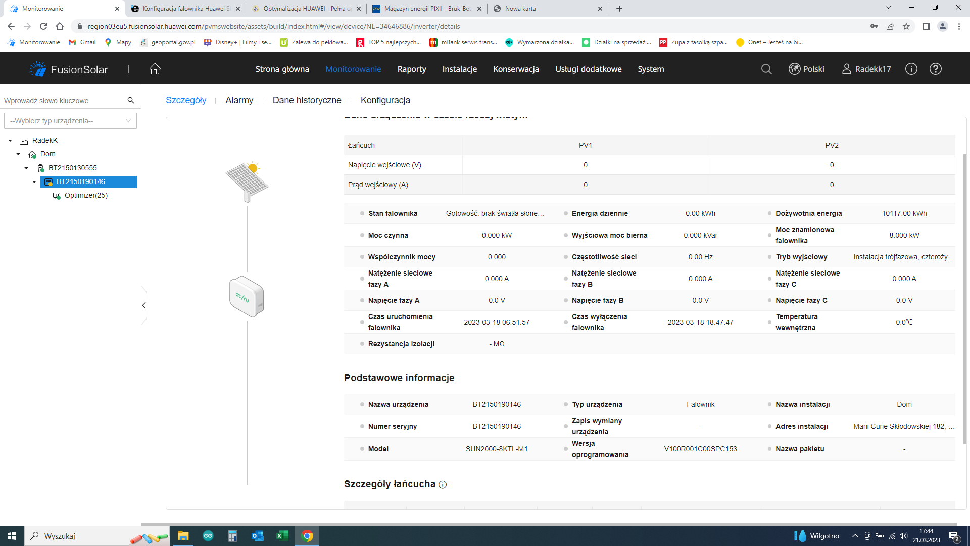

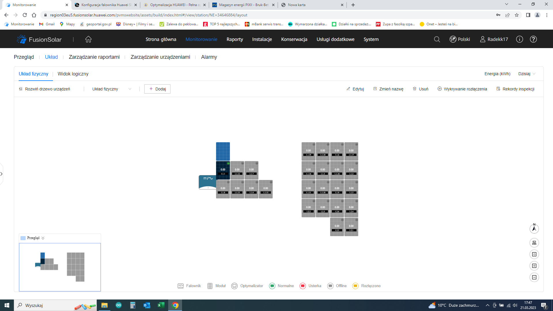

    radekk17
    Good morning
    I had a problem with the installation on Saturday worked normally all day. The inverter did not start on Sunday. no errors or crashes. Inverter state ready - no sunlight. Below screenshots from the application, anyone have an idea what could have happened?

  • #1015 20499842
    x4robbo
    Posts: 15
    The fuse blew from the DC side

    radekk17 wrote:
    Good morning
    I had a problem with the installation on Saturday, it worked normally all day. The inverter did not start on Sunday. no errors or crashes. Inverter state ready - no sunlight. Below screenshots from the application, anyone have an idea what could have happened?
    Huawei SUN2000 Inverter: WIFI Dongle Connection, Firmware Update & FusionSolar [url=https://obrazki.elektroda.pl/7173298700_1679329762.png 0008fcaaa6 [/url]
    Check in the middle of the day if the optimizers connect to the inverter. At the time you posted the screen, it's already after production, so it's hard to deduce anything.

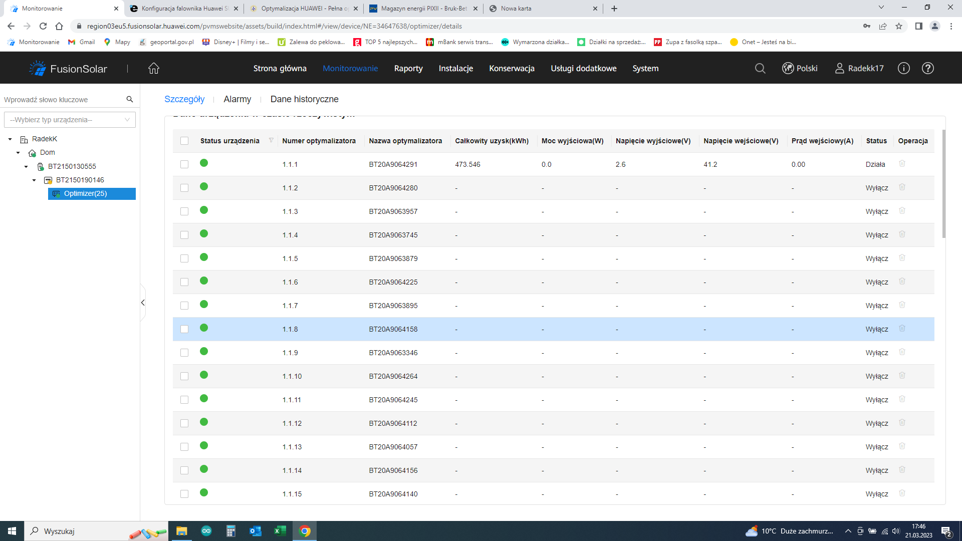

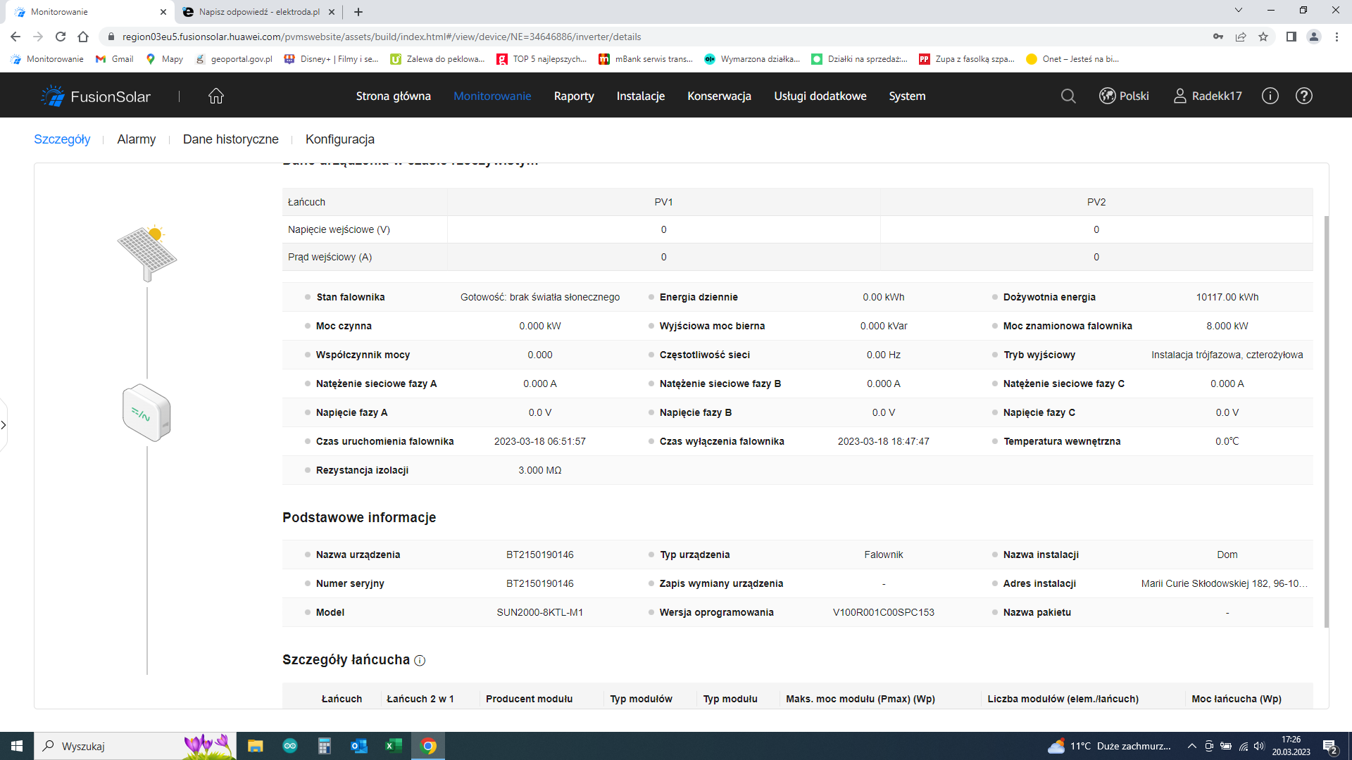

  • #1018 20500651
    radekk17
    There was also no connection during the day. And here is the problem, is it not the fault of the inverter.
  • #1019 20500750
    Robyn212
    Posts: 197
    Help: 12
    Rate: 30
    Upload screenshots as I wrote plus additionally a screenshot from the optimizers view. Have you messed with the inverter settings? Maybe you need to update the inverter and it will start.
    Try to measure the DC circuit in the evening and check if the resistances are correct. Just like in the video below, from 4.50 min.
    https://www.youtube.com/watch?v=H6Efx1Fgr0s
  • #1020 20501577
    radekk17
    I did not make any changes to the inverter. The installation, as you can see on the screen, turned off on Saturday evening, on Sunday it did not turn on. Today after the inverter has been deprived of power again and the power supply from the panels has been cut off, the situation as on the screen. I'll take measurements later. Huawei SUN2000 Inverter: WIFI Dongle Connection, Firmware Update & FusionSolar Huawei SUN2000 Inverter: WIFI Dongle Connection, Firmware Update & FusionSolar Huawei SUN2000 Inverter: WIFI Dongle Connection, Firmware Update & FusionSolar
