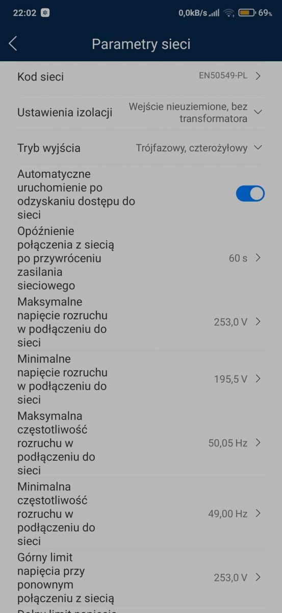

    Posts: 9
    >>20628128
    There are also a lot of setting options in fusionsolar for android. There is no "voltage suppression" but there are options for power regulation. Huawei SUN2000 Inverter: WIFI Dongle Connection, Firmware Update & FusionSolar Huawei SUN2000 Inverter: WIFI Dongle Connection, Firmware Update & FusionSolar

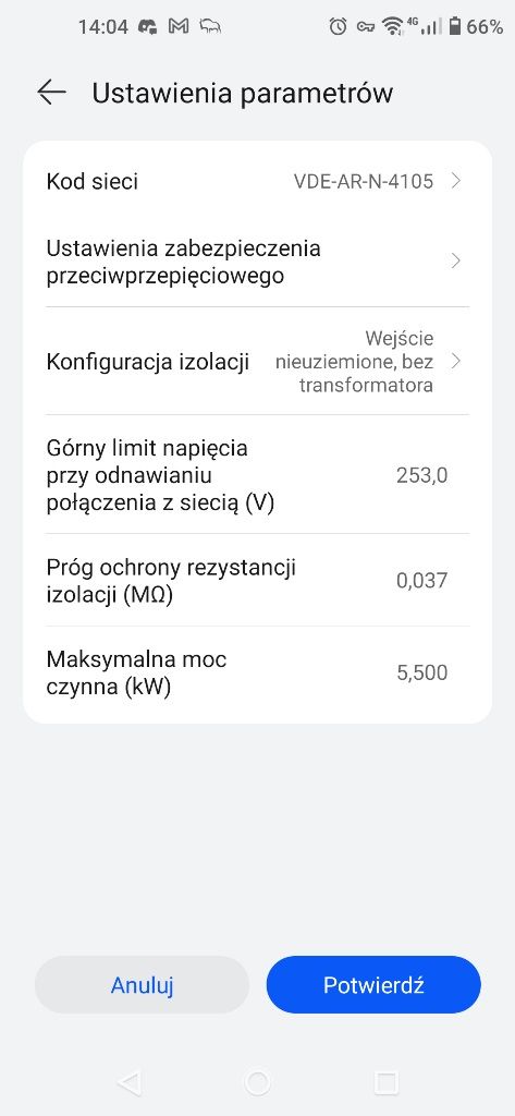

    #1112 20629323
    Math13
    Posts: 112
    Rate: 34

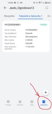

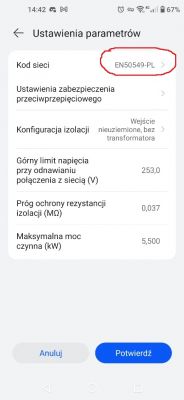

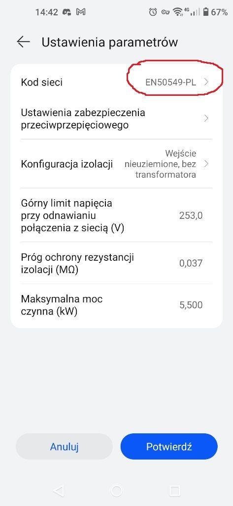

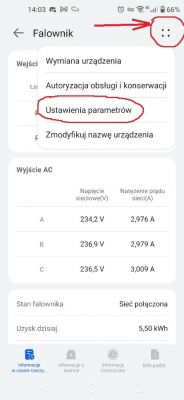

    @bpsw9a I haven't had the settings you showed in a while.
    In Fusion Solar on Android, I select in turn: Installation - Devices - Inverter
    Then I click on the 4 dots in the upper right corner, where I select "Parameter settings" from the list.
    Only 6 parameter items to be changed are shown.
    Maybe in this new version, after update, I can't find the settings you showed. Where to look for it?
    In the SUN2000 application I have all these options. Unfortunately, it is cumbersome to run to the inverter to view them and possibly change them.
    I'd rather do it remotely from anywhere in the FS app like it used to be.
    P.S
    I changed the network code from GER to PL.
    Unfortunately, it did not change anything in the number of options to be set in the FS application. :-(

    @gitpusher I wrote in an earlier post.
    Through the SUN2000 application and connecting to the inverters via the internal Wi-Fi network, I have a lot of configuration options. But it's not convenient.
    I supervise several installations in a family in which I am assigned as Installer. It's hard to drive from house to house.
    I would like to be able to access, even when away from the inverter, via the Fusion Solar app. Just like @bpsw9a , @xszuflax and others.

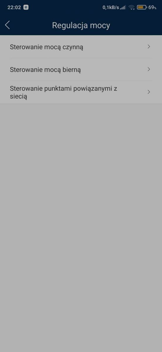

    Hi,
    I think we misunderstood each other. I have these options in FusionSolar, however, the access itself is carried out through the "Commissioning device" function, which involves direct access to the inverter via its internal WiFi.
    The option itself is available in Power control > Active power control.

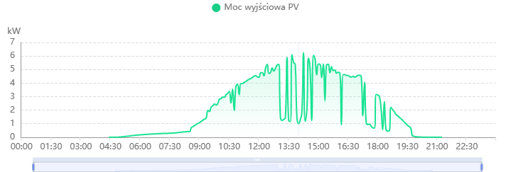

    #1126 20649915
    berserker1
    Posts: 234
    Rate: 47

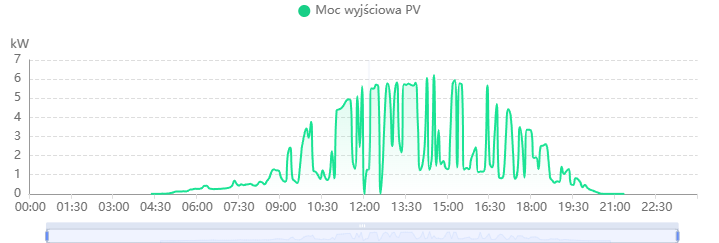

    What to do if the inverter is switched off several times a day during sunny weather? In the attached picture, such peaks to the very bottom is the inverter turned off? And such drops not to zero, but on a cloudless day, what do they indicate? When the voltage is exceeded, the inverter turns itself off? Could it be that the electricity supplier specifically causes the inverter to shut down?

    Check the voltages.
    Shuts down at 253V (as well set)
  • #1128 20650544
    berserker1
    Posts: 234
    Rate: 47
    Today, my highest recorded voltage was 254.5V and after that there was one shutdown of the inverter, but a few days ago I saw on the graph on one of the phases 255.2V and it did not turn off. Why is it that there is a shutdown at different voltages?
  • #1129 20650677
    bpsw9a
    Posts: 9
    The inverter shuts down when the 10-minute average exceeds 253 V, and immediately when it is around 260 V (I don't remember exactly). Of course, it depends on the settings.
  • #1130 20651155
    szczukot
    Posts: 826
    Help: 6
    Rate: 83
    You are basically grounded. You probably won't do anything about it. The topic has been discussed many times. Most likely you have a lot of installations next to each other, and each one raises the voltage.

  • Use AC voltage graph to confirm inverter shutdowns
    #1135 20651855
    k_pec
    Posts: 1772
    Help: 271
    Rate: 562
    In general, a decrease in the graph to zero means that the inverter is turned off, and decreases around 1 ... 2kW look like typical decreases from cloudiness. Well, but if the weather is clear, then maybe your inverter can show interruptions in production for some reason, or there is some other reason.
    Interruptions in production are best viewed on the output voltage (AC) graph. There it is unambiguous and in this way you can verify the situation.
    You can, to prevent the inverter from shutting down:
    • 1. Use an active artificial load system that will prevent the inverter from tripping. Exports will disappear, all production will go to self-consumption plus an artificial burden. There are ready-made solutions. And there are forum threads about it.
      2. If the inverter has the function of adjusting the reactive power factor depending on the grid voltage, you can try to reduce the exported power by setting the inverter options accordingly.
      3. Harass ZE (preferably with neighbors) to reduce the tension on the hit.
  • Optimizer and MBUS firmware updates fixed shutdowns
    #1136 20652580
    damian16400
    Posts: 9
    The inverter shuts down when the voltage is too high. I, however, had similar graphs, constantly shutting down production to 0 or minimum values.
    The reason was probably the optimizers, or rather their software. After properly updating the inverter, optimizers and MBUS, the problem disappeared. MBUS and optimizer updates are recommended to be done in bright sunlight.
    It's worth starting with. However, for an inverter shutting down due to overvoltage, it certainly won't help.

What causes the SUN2000 to trip on sunny days?
A 10-minute average grid voltage at the terminals above 253 V triggers disconnection per VDE-AR-N-4105 [Elektroda, lizak1983, post #19657944] High roof-top cable resistance adds 1-2 V, so measure at the inverter. Load shifting (e.g., 2 kW boiler) or DSO tap change fixes the issue.
Can I lift the 253 V reconnection limit?
Raising “Upper voltage limit when reconnecting to grid” breaches EU NC RfG and risks neighbour equipment damage. Installers and DSOs can audit logs [Elektroda, rokbok, post #19639893] Keep 253 V unless your DSO grants a written exception.
