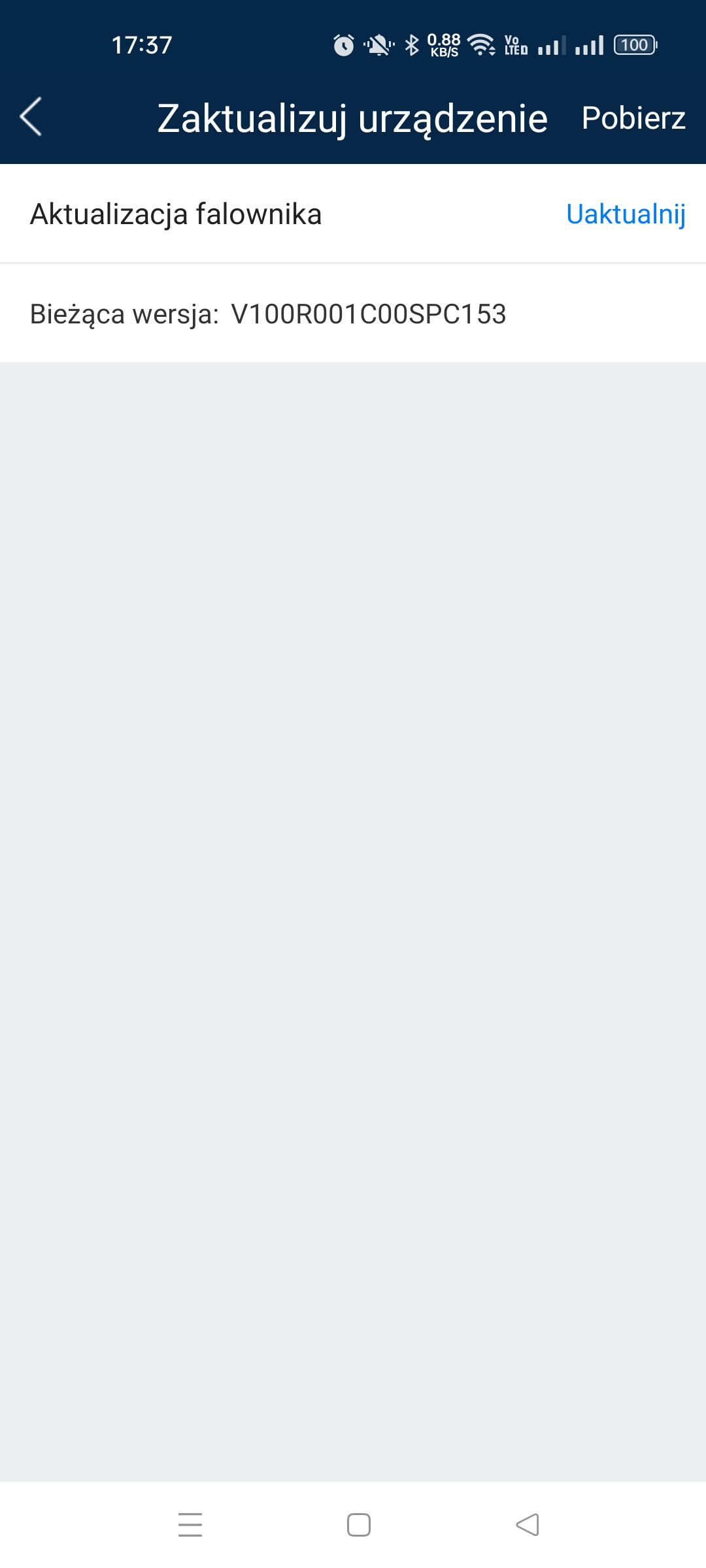

    #1153 20665712
    Jusand
    Posts: 8
    I added the dtsu666-h meter yesterday and everything worked fine. I also installed the SCharger-22KT-S0 car charger, which required this meter to be able to charge only with PV. The meter is set to operate in virtual counter mode. I encountered some problems here because I was able to add it, but then it didn't load the data and the charger crashed because it couldn't detect the meter.
    So, I decided to install the latest firmware for the inverter, Dongle, and MBus. After this update, the charger was able to detect the meter, and I could switch on the PV charging mode.
    However, something happened to the real-time data on both the inverter and the meter. The data is "stuck" and shows the same values all the time. However, the data in the chart displays correctly.

  • #1156 20666970
    Jusand
    Posts: 8
    >>20665712
    I will answer myself, unplugging the dongle and plugging in helped.

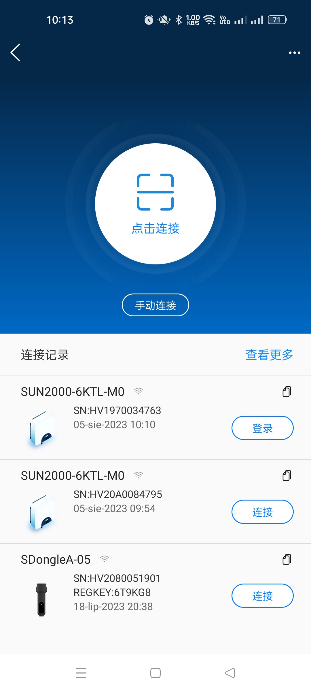

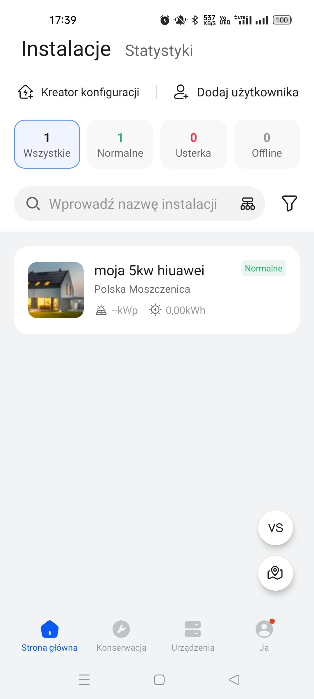

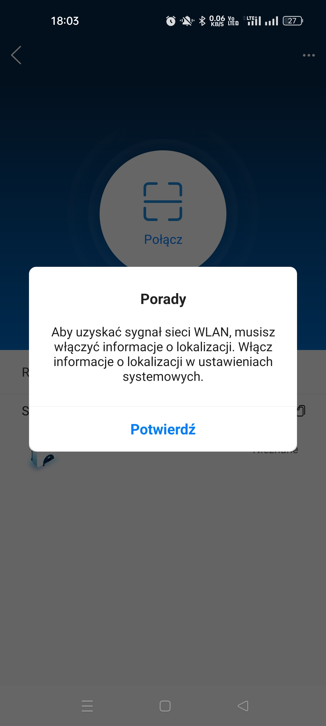

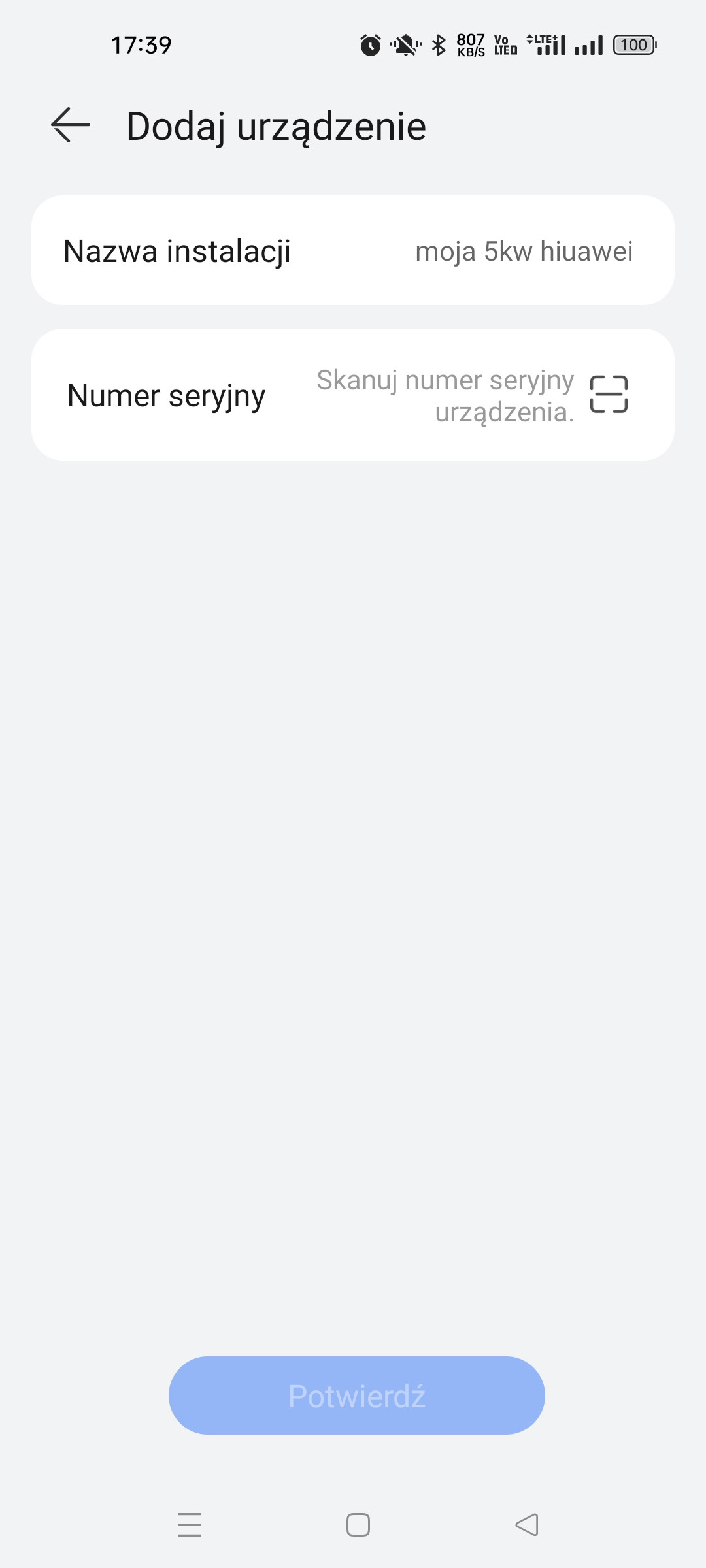

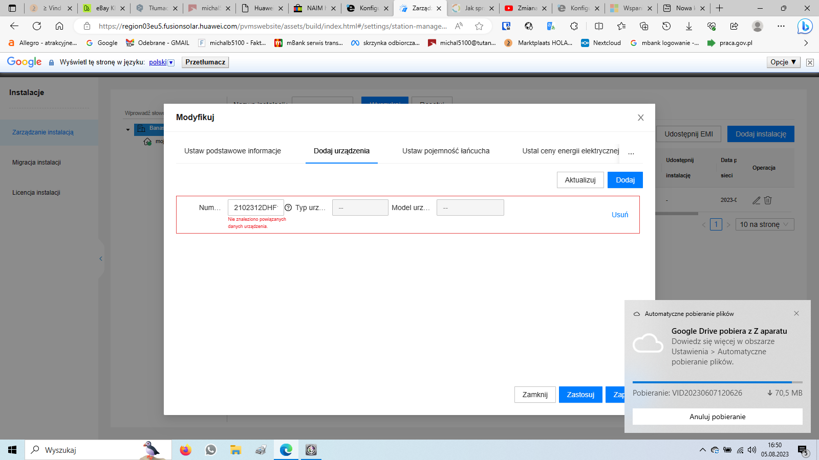

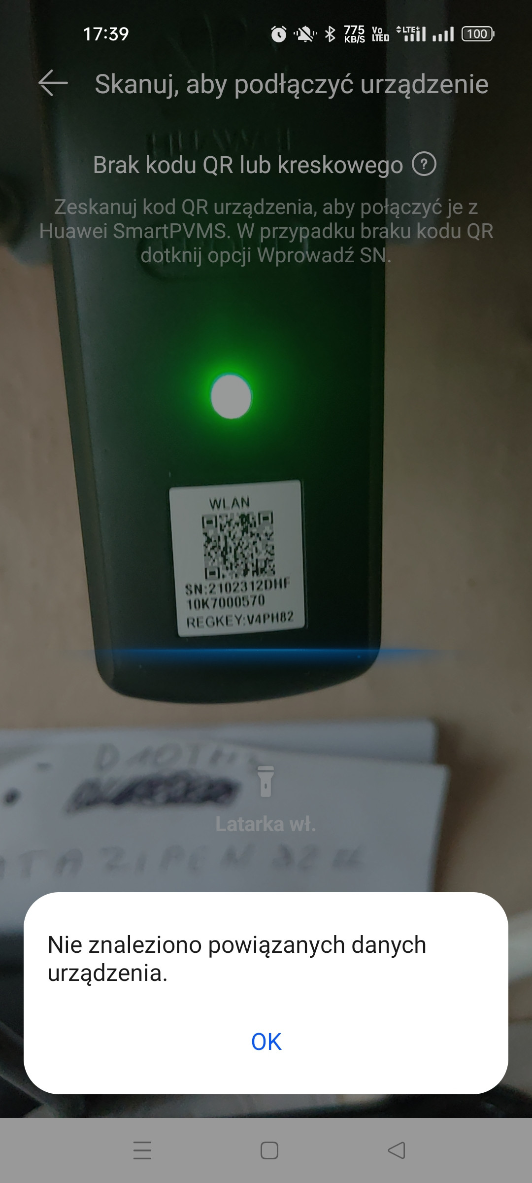

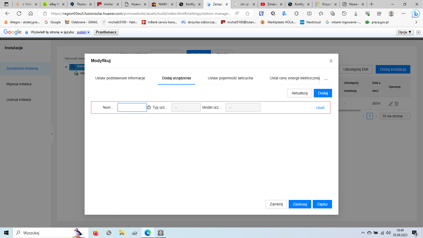

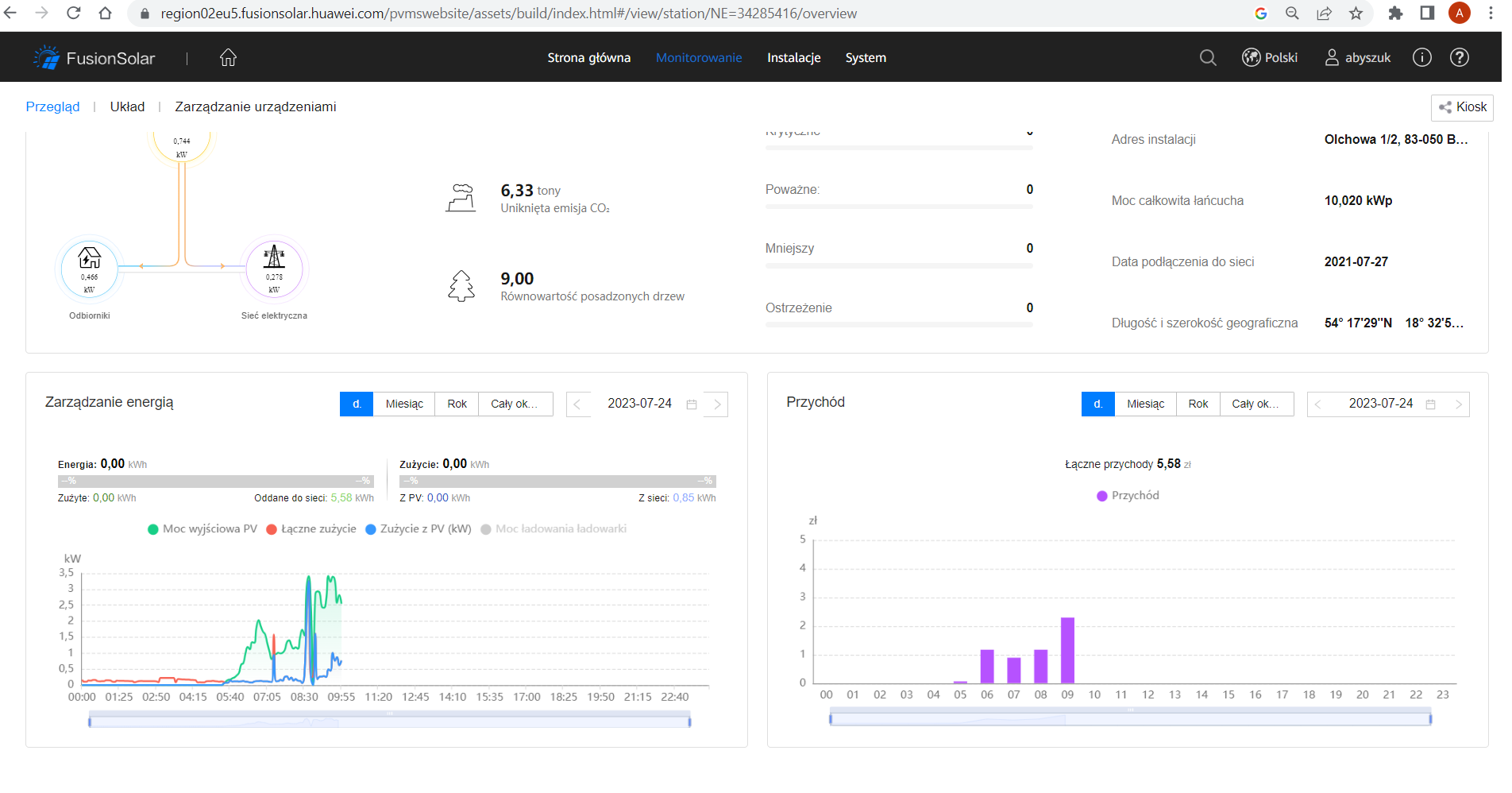

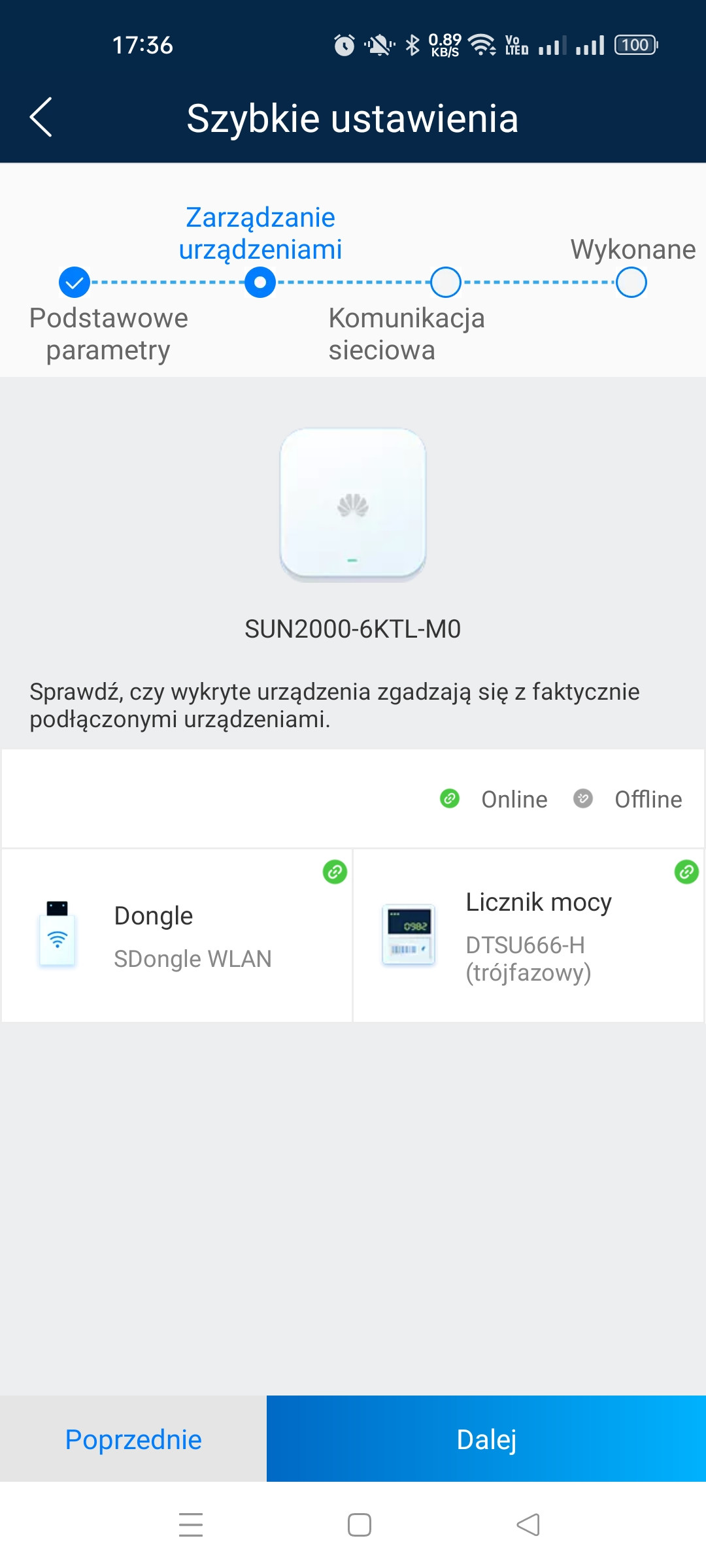

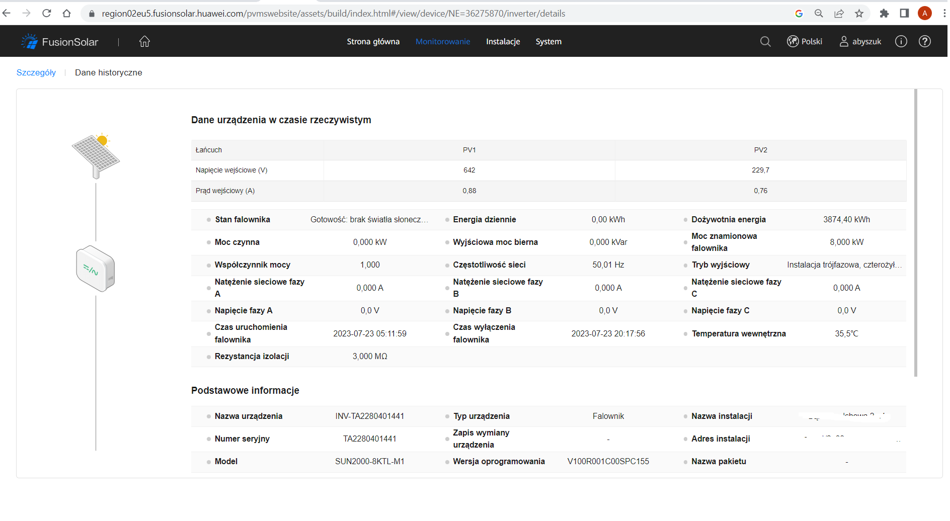

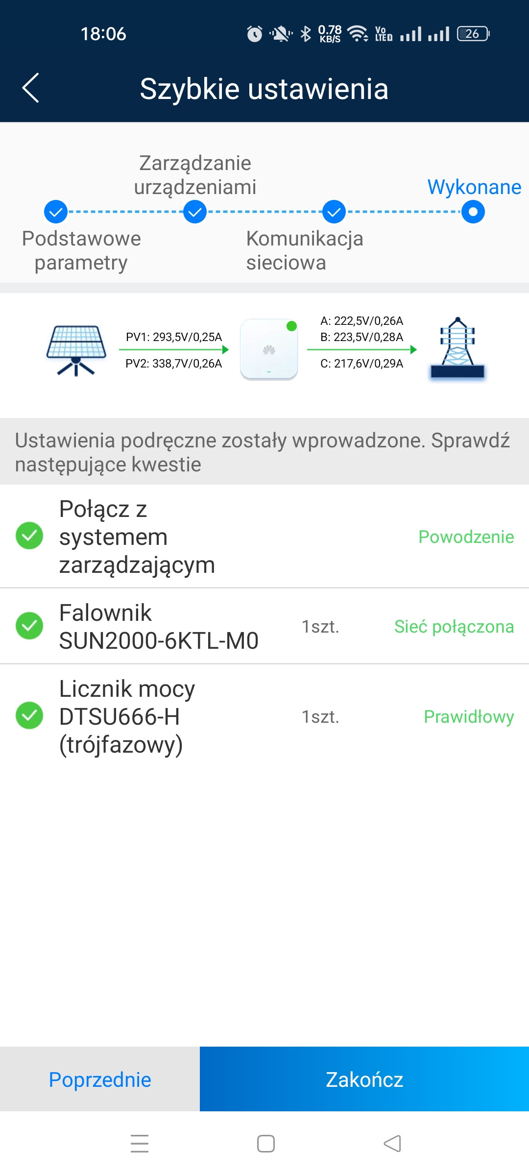

    #1159 20682144
    michalb5100
    Posts: 112
    Rate: 26
    Welcome back.
    Today I bought another HUAWEI SUN2000 and certainly from Polish distribution.
    Is there instructions anywhere to add a device to an existing installation in FusionSolar?
    I have an installation in the FS app, photo, and now the question is how to connect devices to this installation?
    I tried all the ways, the photos will show the answers from the FS app.
    I also tried via www, and it doesn't help either, it doesn't find devices if I type SN: DONGLE... what's the point here?
    I will only add that only one inverter remained in the new configuration and the language was changed to Polish.
    I had to update the photos, I added another screenshots, maybe it will help

  • #1160 20683916
    velkhor
    Posts: 49
    In short:
    1. Open the FusionSolar app.
    2. At the top, click on "Configuration Wizard."
    3. Scan the QR code from the inverter, not the dongle.
    4. Go through the setup process.
    5. If I remember correctly, at the end, there will be a question asking if you want to add the device to your account.
  • #1161 20684124
    michalb5100
    Posts: 112
    Rate: 26
    @velkhor, that's true and there's nothing we can do about it...

  • Dongle already connected and online in FusionSolar

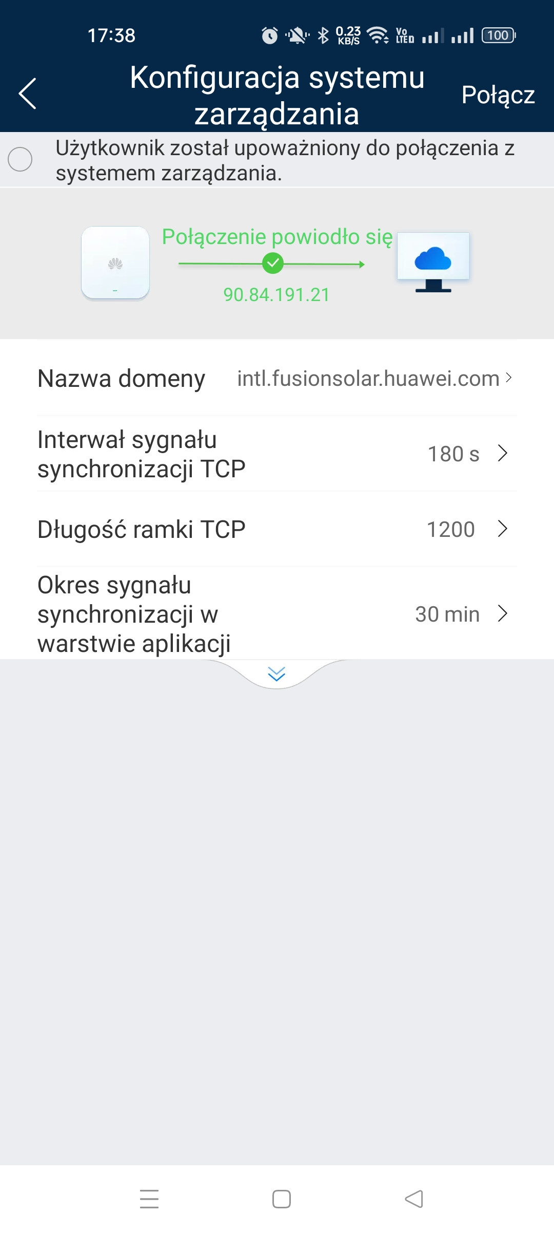

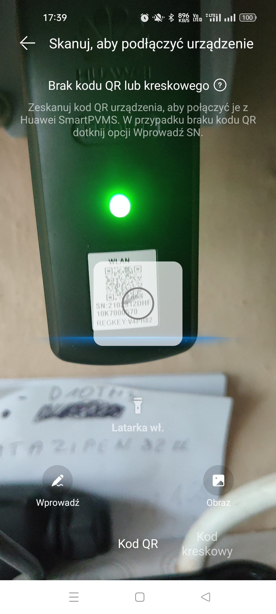

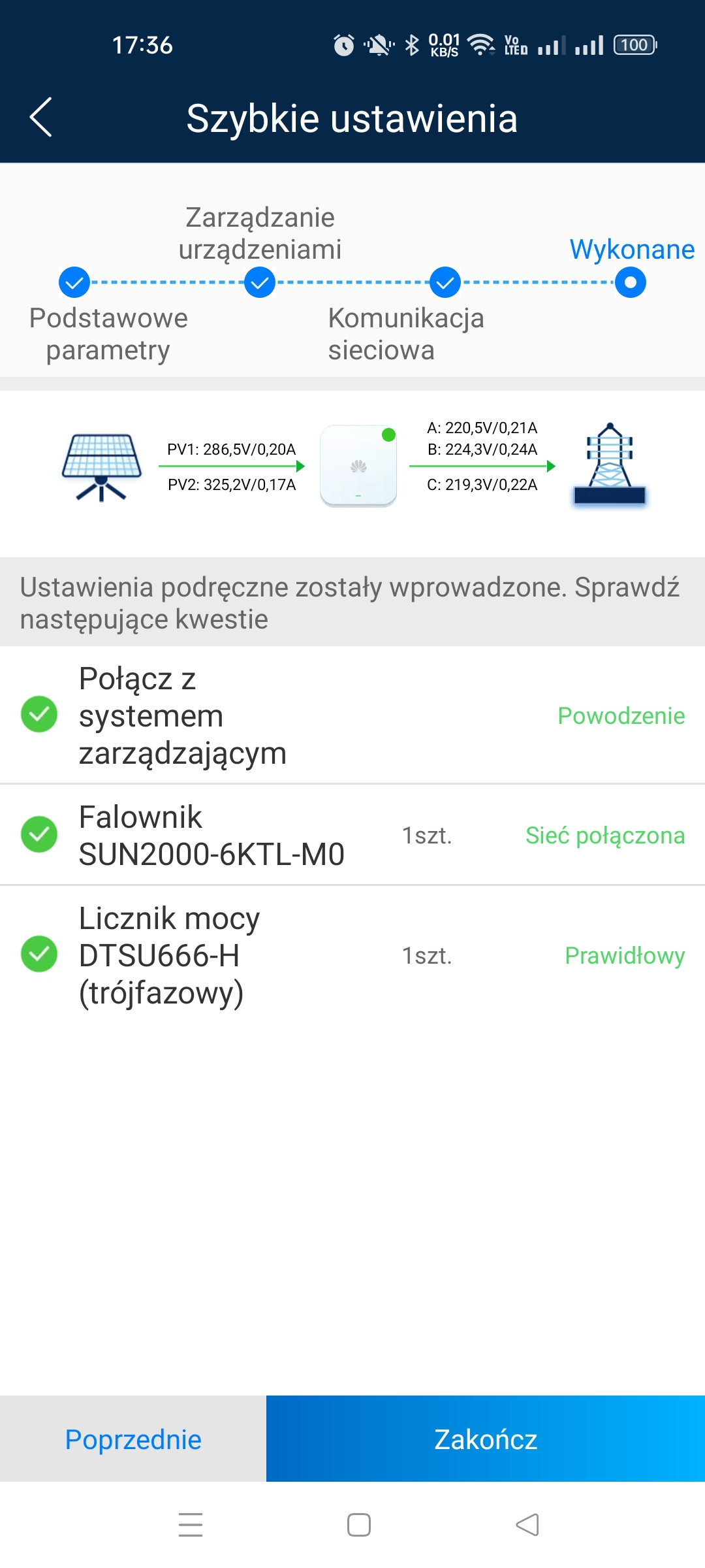

    #1163 20684957
    michalb5100
    Posts: 112
    Rate: 26
    @velkhor sorry it actually came out chaotic.
    So I start the scanner, scan the QR code, I'm asked for WLAN, etc. location, (I'll send a screen from the phone), except that my device is visible in FS connected via WLAN directly ... I don't know if you understand ...
    I know that most added the device through the device transfer to operation, but it doesn't mean anything ...
    Entering FS as an installer, I see that DONGLE is connected, I see an online connection.
