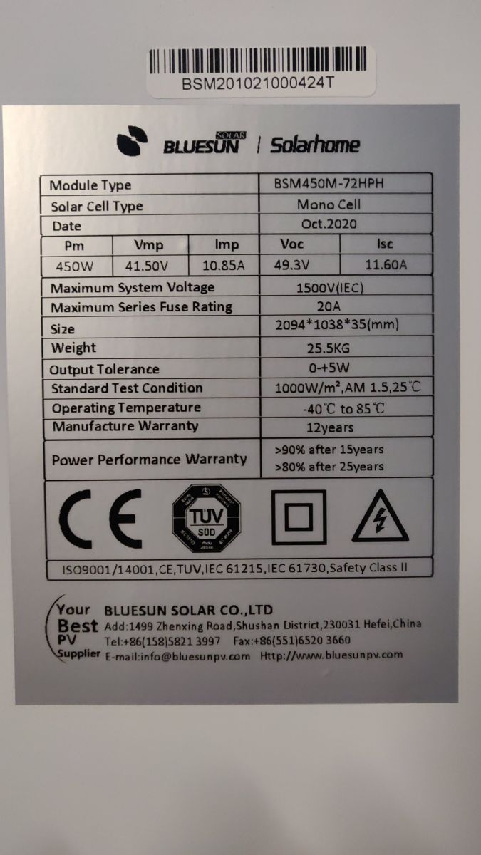

    It works very nicely to operate the inverter via RS485. I once asked about this here. I have a 10kW inverter in the Chinese version from a private import and it was normally possible to access it in its wifi with the password a00000 and there are no locks on anything inside. I set all the parameters according to the PDF of the manual and programmed myself the RS485. No internet communication is required. The firmware can be uploaded from a file via an app that connects via wifi. You only need to come within range of the inverter. Everything is available via RS485, including the correction of reactive power according to demand. If you have the skills and the desire, I recommend buying an ETH/RS485 converter and writing your own programme. There is nothing better.
    As for strings and how to connect them. You have a Voc voltage written on the panels, e.g. 49V and you have a short circuit current of e.g. 10A. The inverter has a max input voltage and max input current. You cannot exceed this. You need to leave a voltage reserve for the type of protectors you use. For example, you give them 1000V, the inverter has a max Vin of 1100 or 1200, and the panels only go up to 800V, well maybe a bit more up to 900V. But if you have panels giving 10A short-circuit, you must not connect them in parallel to an input which has 15A Imax. You have to plan your installation and buy such panels to use the inverter so that the voltage is as high as possible within the range specified in the technical documentation.

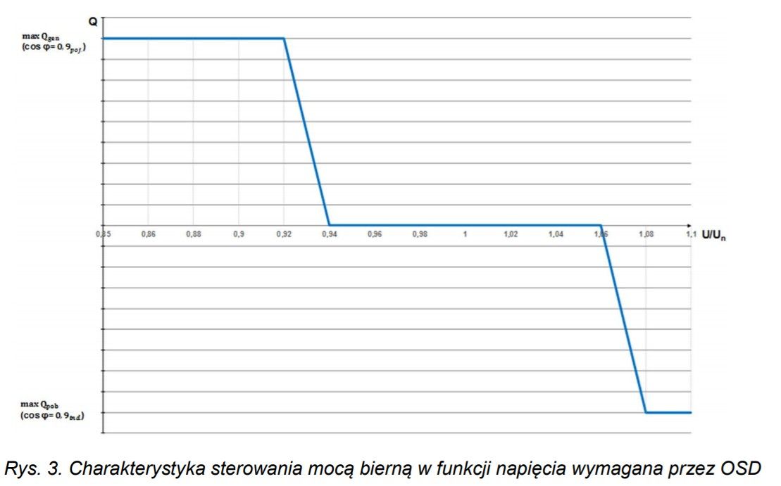

    I am asking for exact parameters for this characteristic. In my Chinese, I had to type everything by hand to comply with the norm, and it's hard to read from a drawing.

    I didn't set it up, I don't even know where it is. I chose only international power or something like that, the app in English and it was 50Hz 253V and I only chose where PID repair is set, panel type and that's it. I left the rest at default. I checked the registers with the manual and it looks like you don't need to set anything else. Works well. The voltage does not go more than 245V on the inverter, so there is a reserve. There is 3V less on the connector as it lights up to the maximum due to the voltage drop on the cable from the inverter to the connector, with a total of 100m, maybe less.
    The choice of the types of electric networks was not there. We are talking about the M0 version the Chinese version.

    kravat3 wrote:
    I am asking for precise parameters for this characteristic. In my Chinese, I had to type everything by hand to comply with the norm, and it's hard to read from a drawing.
    For example, according to Tauron, it should look like this: Huawei SUN2000 Inverter: WIFI Dongle Connection, Firmware Update & FusionSolar
    The Q / S value is the value of sin (phi) - 0.45 corresponds to a shift angle of about 26/27 degrees - cos (phi) for 26/27 - that's 0.9 in your case, you only need to change the U / Un values

    Ha, you see a person learns all his life :-) I also corrected it and it is wider for cosine = 1.

    domelek wrote:
    Well, I'm just under the Tauron, and I also got the parameters from the settings for the German network, and it's set up completely different there. The second thing that worries me is yesterday the inverter showed the current on the western string over 11A, where for my 375W longs the current at maximum power is 10.84A, and the short-circuit current is 11.6A. Can electricity also be limited in the settings?

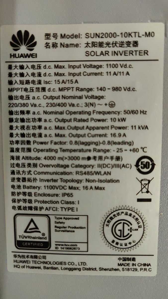

    There is probably no need, this inverter has Isc 15A, and these plus or minus a few% from the nominal value of 11A can be left. It is with me Huawei SUN2000 Inverter: WIFI Dongle Connection, Firmware Update & FusionSolar
    You will not exceed the Isc 15A, give the 11A fuse on the DC side and even if the supernova illuminates it, it will blow the fuse at most, but I doubt it. If they burn out, give 1A more, e.g. 12A.
    Secondly, if the panels are new, it may be so, but they will weaken in 2 months and the problem will disappear by itself. When buying panels, you must always choose the inverter so that the current is a bit lower than the inverter input, but on the other hand, that there is a relatively high voltage. You have to strive for the Voc to be at least 600V, I have more. Protection for 1000V and 1100V input
    This total Voc of the panels is important because when the panels are lit with full sun and produce as much as the factory gave and suddenly 400V disappears from the grid, the panels will suddenly supply full Voc voltage to the input of the inverter. And the point is not to break through.
    In our inverters we have inputs for 1100V, so we give protection lower to 1000V, and strings with a voltage of no more than 900V Voc, but you also need to count the total power of the panels, their voltages, and so on.
