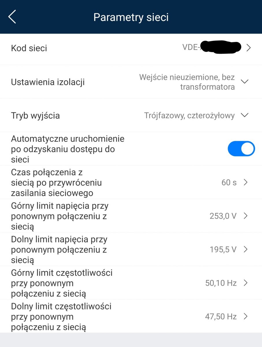

    @szczukot @rokbok update done. And now a few interesting facts for the future:
    - the update file for the inverter was already in the application (at least in FusionSolar - it was enough to log in to the application using the network, then disconnect the mobile network and completely cut off the Internet and go to the "Me" tab -> "Putting the device into operation" -> we connect to the inverter WiFi AP + QR code -> update), it will probably be exactly the same in the SUN2000 application, i.e. the update file will already be in the application,
    - another point that you can update the inverter being completely cut off from the internet, I'm a bit shocked that you don't need any connection (I thought it was downloading from the network), but it's on +,
    - going further, you can experience an unpleasant "surprise" (? ;) - when updating the inverter at approx. 80%, the inverter probably restarts, which results in breaking the WiFi connection with the inverter and this will result in a message that the connection has been broken, some may get scared that something went "wrong", it did not reach 100% and the inverter is damaged - but none of these things, it turns out that it's normal (it's a pity that I didn't know about it ? ;) ,
    - the update takes more than 10 minutes, as if the file is flying via WiFi, weighs about 3MB, but it updates slowly and you have to be patient.
    Now I am wondering how to update the dongle here, because here I have no idea how to connect to it :) I tried to connect to the same router as the dongle, but it does not detect.
    PS. In the application I found a setting regarding "High voltage limit when reconnecting to the grid" with a setting of 253V and is this value responsible for when the inverter will turn off when the grid voltage is high? What would happen if I changed this value to a higher one (some problem with the distributor or the distributor of the network would have a problem with it)? Huawei SUN2000 Inverter: WIFI Dongle Connection, Firmware Update & FusionSolar

    MisiekDPx wrote:
    PS. In the application I found a setting regarding "Upper voltage limit when reconnecting to the grid" with a setting of 253V and whether this value is responsible for when the inverter is to turn off when the grid voltage is high
    I do not advise to touch it, you can burn yourself and other equipment in the house, this is the limit value, change only at your own risk with all related consequences.

    It was all about updating the inverter :) I always download the latest apps ;) But in general, I recommend the SUN2000 to update the inverter, or if someone has the ability to do FusionSolar (you only need to log in using the network at the beginning (SUN2000 will work from the beginning without internet)).
    And FusionHome I don't know if it's a good choice, because this app is no longer updated. As far as I remember, this is an old version of today's FusionSolar application, so there is also a risk that FusionHome will already have old inverter software in it, and FusionSolar or SUN2000 much newer :)
    rokbok wrote:
    I thought so too. I asked out of curiosity and curiosity, as some people write that their inverters turn off because their network is so clogged.
    PS. In Germany, this value is supposedly higher (probably something around 264V) :)

    If people have unblocked inverters, they can win against their neighbors by setting 1-2V more :-) This is the voltage on the inverter, on its terminals, and in the cable connector it will be lower by these 1-2V.
