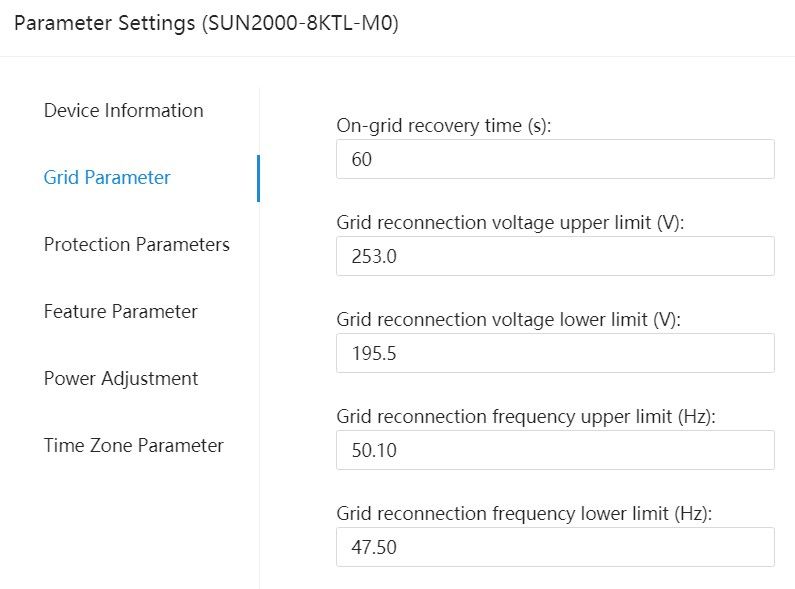

  • #230 19529383
    kravat3

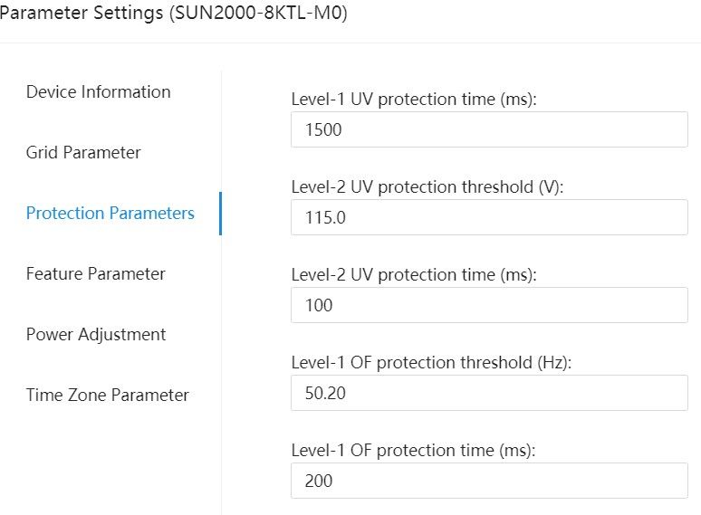

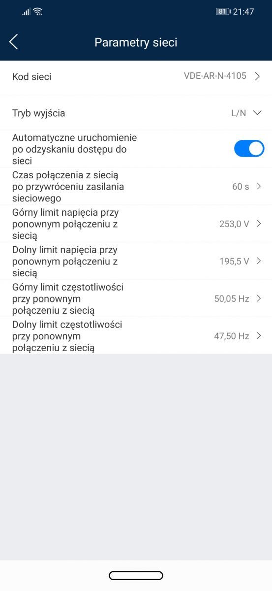

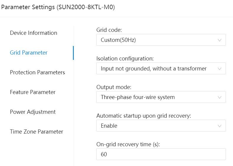

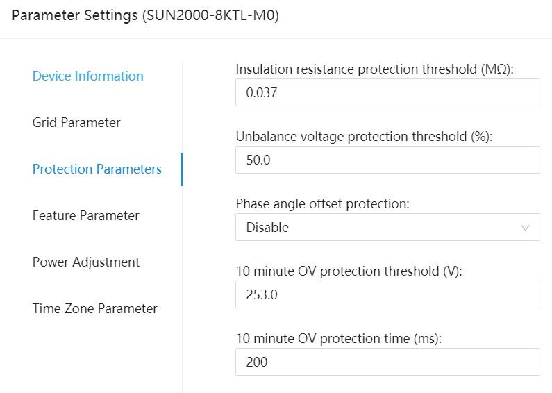

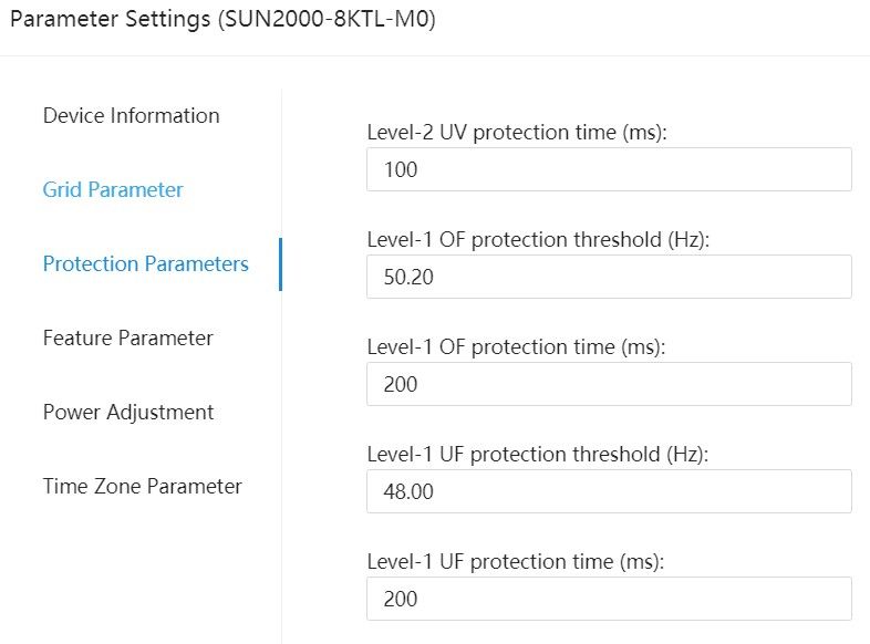

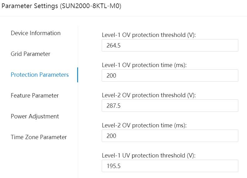

    Hello, it fell on me. I purchased a Sun2000 inverter from an auction site. Now it turns out to be a version straight from China. I can only choose from 3 types of networks. Two Chinese and one Custom (50Hz). Can someone throw screenshots with the inverter settings for Poland or Germany? I saw on this thread that someone had already had the same problem. I would like to compare the settings with those in the inverter.
  • #231 19529425
    rokbok
    Huawei SUN2000 Inverter: WIFI Dongle Connection, Firmware Update & FusionSolar
  • #232 19529531
    domelek
    here are my settings - according to PGE guidelines Huawei SUN2000 Inverter: WIFI Dongle Connection, Firmware Update & FusionSolar Huawei SUN2000 Inverter: WIFI Dongle Connection, Firmware Update & FusionSolar Huawei SUN2000 Inverter: WIFI Dongle Connection, Firmware Update & FusionSolar Huawei SUN2000 Inverter: WIFI Dongle Connection, Firmware Update & FusionSolar Huawei SUN2000 Inverter: WIFI Dongle Connection, Firmware Update & FusionSolar Huawei SUN2000 Inverter: WIFI Dongle Connection, Firmware Update & FusionSolar :
