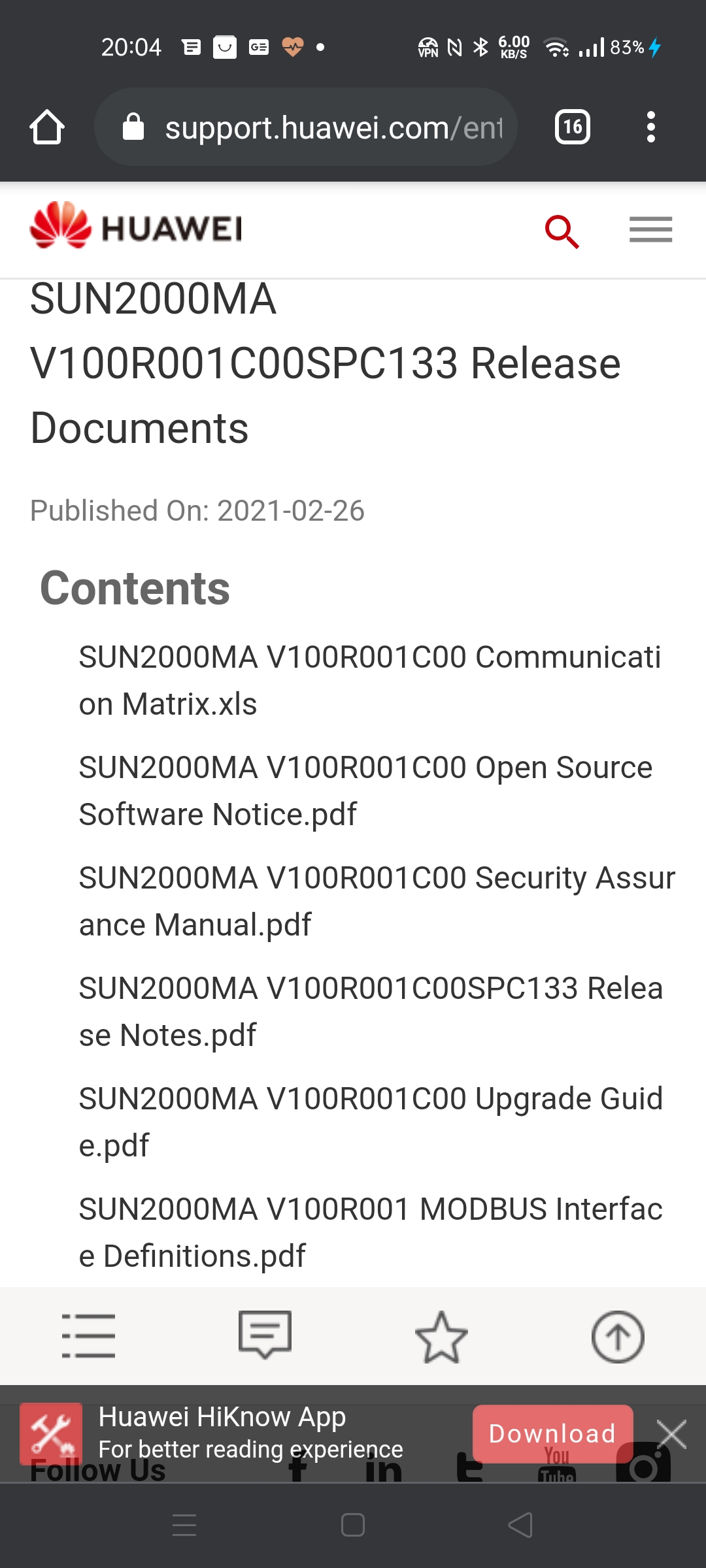

    release documents is a generic name of about 6-7 files.
    I suspect that you are interested in "release notes" and I am including one until the last version
    • SUN2000MA V100R001C00SPC133 Release Notes.pdf (120.77 KB) You must be logged in to download this attachment.
    • Huawei SUN2000 Inverter: WIFI Dongle Connection, Firmware Update & FusionSolar Screenshot_2021-04-07-20-04-51-72.jpg (431.24 KB) You must be logged in to download this attachment.

    Yes, it's about release notes, especially "what's new". And not to the last version, but all between 122 and 133, because in individual notes it is written what in a given version they added / changed.
    Today I updated mine from 122 to 133. The update works via Fusion Home. By SUN 2000, if you choose the file you attached earlier, it crashes with an incorrect version.
