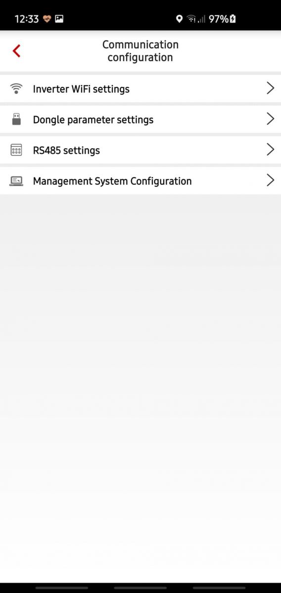

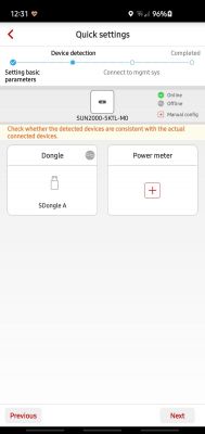

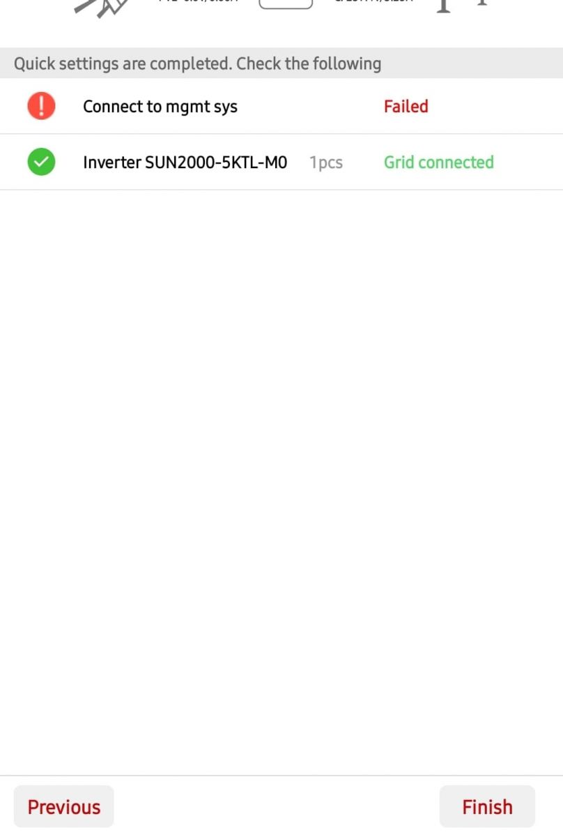

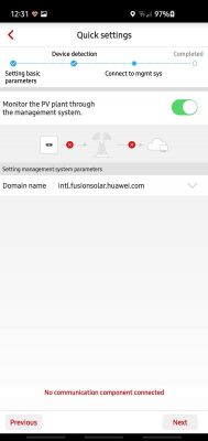

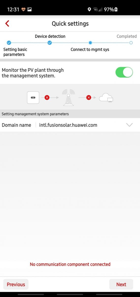

    Huawei SUN2000 Inverter: WIFI Dongle Connection, Firmware Update & FusionSolar
  • #189 19386137
    maneks
    Posts: 58
    Rate: 32
    Welcome
    Did you manage to get the subject?
    In my case, after a whole day of fighting - because he theoretically detected the dongle, but he saw all networks as open and it was impossible to connect to any network - only the open one. Only installing the latest version of FusionSolar solved the problem.
    At the same time, I have a "fresh" SUN2000-8KTL-M1 inverter with a warranty up to 09/14/2031 !!! Theoretically, the warranty starts only in six months
    best regards
    m.
    kazkyy wrote:
    Hi!
    He has been trying to connect to the dongle in the inverter for a long time. The inverter model is sun2000-5ktl-m0 and for the gingerbread house I can't get the connection ...
    I have an insight into how many panels are produced for me, but this USB dongle for the inverter is flashing red all the time and I have no idea how to connect to it, I think I've tried everything ... it's not the fault of the router ...
    I connect to the application using my phone. As I wrote, I connect to the inverter normally, I already have my password for the installer and the user. I am asking for help, because my hands are dropping, how should I make the dongle online and the quick configuration will be successful with the working dongle.
    Huawei SUN2000 Inverter: WIFI Dongle Connection, Firmware Update & FusionSolar Huawei SUN2000 Inverter: WIFI Dongle Connection, Firmware Update & FusionSolar Huawei SUN2000 Inverter: WIFI Dongle Connection, Firmware Update & FusionSolar Huawei SUN2000 Inverter: WIFI Dongle Connection, Firmware Update & FusionSolar

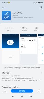

    No need to install Huawei store, just download the SUN2000 apk from this link: https://solar.huawei.com/~/media/Solar/APP/SUN2000.apk

    Try to log in to Fusion Solar now, the old "yellow" or the new "blue", you will find out why you should have SUN 2000, this will be the best case until 8:00 April 26, 2021, and maybe the end of April ;) .
    decklen wrote:
    Sun2000 is implemented in FusionSolar
    Yes, in the newer "blue" version, and we used the "yellow" version all the time, its latest version is 2.6.6, which was not there and logging into the inverter was a bit of a pain, now after updating the Huawei cloud / server there will be an app "blue" and possibly SUN 2000 will become redundant, but time will tell.

    I will not "kick with the horse", if you read what I wrote earlier and not only in this topic, maybe you would come to the right conclusions.
    Logging into the inverter from the "yellow" app was so annoying and not convenient that the alternative was SUN 2000 or Fusion Home, so much for the topic.
    For example, this entry.
    rokbok wrote:
    dprzyb wrote:
    Where are the inverter options?
    Go to the inverter and try like this:
    1. Log out of FusionSolar
    2. Turn off data transmission on your smartphone
    3. Find the inverter WiFi network on your smartphone and connect to it (you have the SSID on the side of the inverter)
    4. Click in the top right corner of the FusionSolar login screen (three dots)
    5. Select "Putting the device into operation"
    6. Scan the QR code on the side of the inverter
    7 Enter the password: 00000a and you are in the settings.
    If the fitter has changed the password to the inverter, you will do nothing if he does not give you the current one.
    Maybe also write how you can read your production these days without needing SUN 2000 or Fusion Home?

  • #207 19398195
    decklen
    Posts: 56
    Rate: 16
    rokbok wrote:
    decklen wrote:
    Using Sun2000 with Blue FusionSolar
    And that's the point, FS "blue" is not widely available, it is an app that will replace the old one after the server update by Huawei, it is not there, neither in the Huawei appGalery, nor in Google Play, although the insiders managed to do it.
    Until now, FS was "yellow" and logging in to the inverter with it was, to put it mildly speaking, very cumbersome, so the alternative was SUN 2000 or Fusion Home and I think that we should end the discussion here.
    Why do you think so, after all, it is done in the same way with blue and yellow. There is no difference. Have you ever had a problem with the yellow entry from the installer level?
  • #208 19398350
    rokbok
    Posts: 4251
    Help: 622
    Rate: 992
    I do not know how it worked on the yellow one, but I had to be within the WiFi range of the inverter to connect to it, you had to be logged out from the FS so that the option to put the device into use appeared, in SUN 2000 and Fusion Home it is enough to be within the range of home WiFi and that is a big difference.
    It was like that before SUN 2000 was added to the "yellow" app, logging in looked completely different than now, now it is enough to be within the range of home WiFi, and not within the WiFi range of the inverter, the description of what it looked like is in post # 32 on the second page of this thread.
    No, I didn't, but it's about the annoyance of logging into the inverter from the "yellow" FS level and I'm trying to tell you all the time, so with "yellow", and so far it was the basic app to monitor and the only better solution was SUN 2000 or Fusion Home, see post # 32 on the second page of this thread.
  • #209 19398676
    decklen
    Posts: 56
    Rate: 16
    rokbok wrote:
    OKAY :)

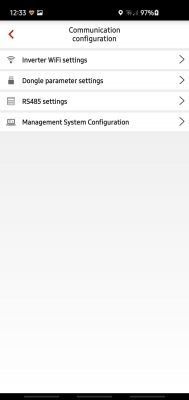

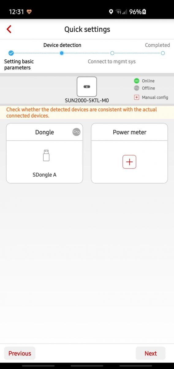

  • #210 19401544
    wydmy
    Posts: 8
    Rate: 7
    Could you describe how to connect to the inverter via home WiFi? Both the SUN2000 and Fusion Home want to connect only through the inverter access point. I can only connect to the dongler via home WiFi.
