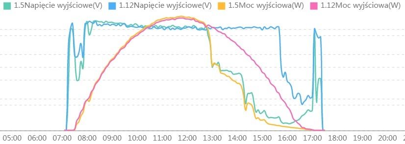

    jsw wrote:
    mariusz.lubicz wrote:
    After all, the optimizers only go around the shaded panels so that the current flows through it instead of through the diodes,
    This is not the case with Huawei optimizers. The shaded ones still produce and are not "bypassed", below are the output power graphs of two topologically distant panels. Green shaded still produces although less and less, blue is not shaded.
    The optimizer is a DC / DC converter controlled by an inverter, which communicates with it via a protocol on DC cables.
    Huawei SUN2000 Inverter: WIFI Dongle Connection, Firmware Update & FusionSolar
    Can you send us what the voltage graph looks like for a shaded module and one in full sun?

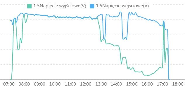

    Please, yesterday, 1.5 first shaded by a tree from the west, 1.12 more or less in the middle.
    This is the output voltage of the panel optimizers.
    For comparison only for the shaded panel, the input voltage of the optimizer, i.e. the voltage
    the output of the panel versus the output voltage of its optimizer - a DC / DC converter controlled by an inverter.
    You can see how the optimizer lowers the output voltage to keep the output current at the level of the entire chain.

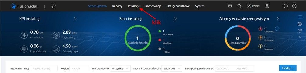

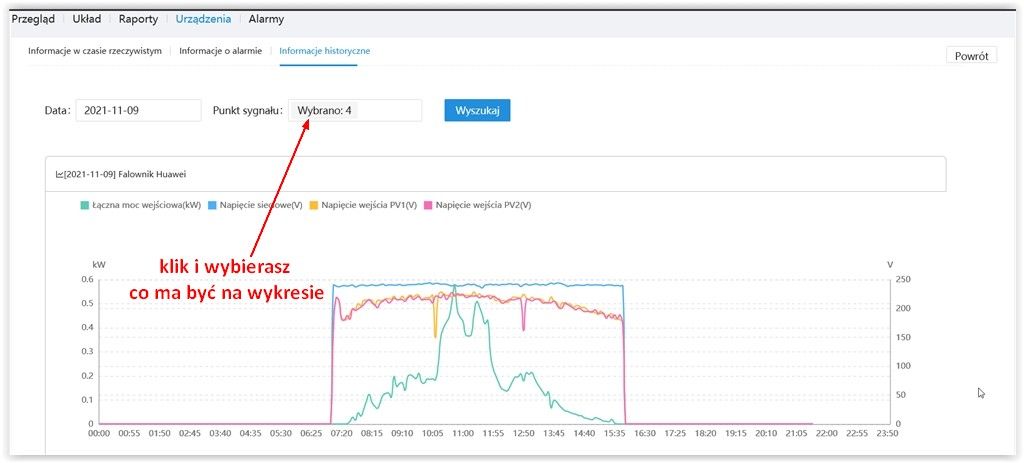

    szczukot wrote:
    @jsw where exactly is this done? Is it via the www or is there any windows app?

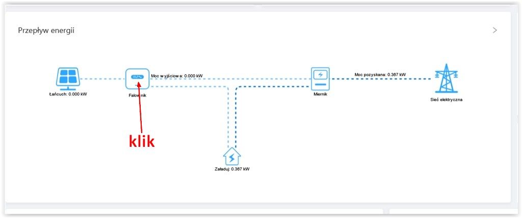

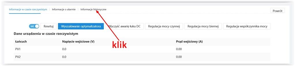

    Normally in the phone app: Fusion Solar.
    1) You indicate the installation (when you have several)
    2) "Devices" icon at the bottom
    3) You select "Inverter in a string"
    4) "History - info" icon at the bottom
    5) You choose charts according to your preferences. ;-)

    I was blind - I have never seen this link "historical information" :(

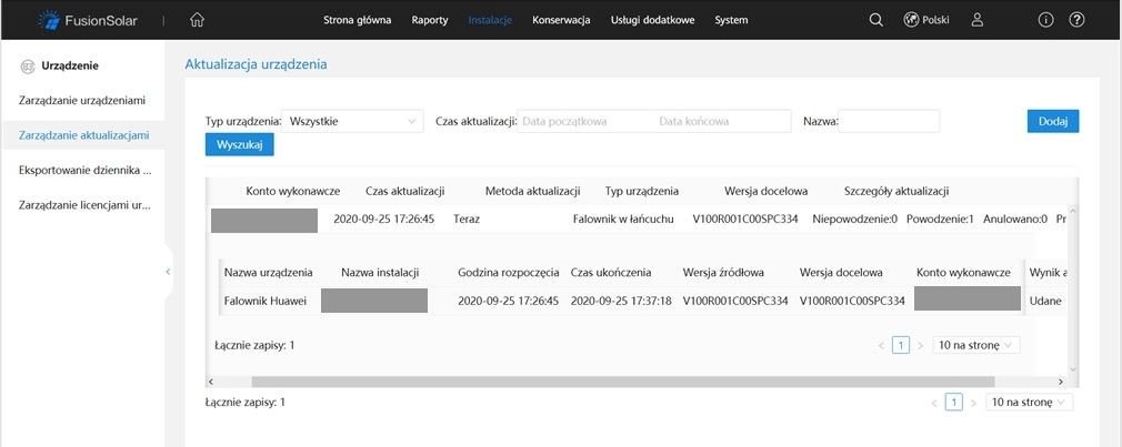

    Yesterday I got this message:
    Dear customers:
    In order to provide you a better experience,
    Firmware1: SUN2000L V200R001C00SPC115 is released for the SUN2000L1 series inverters.
    Firmware2: SUN2000MA V100R001C00SPC139 is released for the SUN2000M1 / M2 series inverters.
    Firmware3: SUN2000MA V100R001C20SPC111 is released for the SUN2000M3 series inverters.
    Firmware4: FusionSolarDG V100R002C00SPC106 is released for the LUNA2000 battery.
    Firmware5: SDongle V100R001C00SPC124 is released for the Sdonge device.

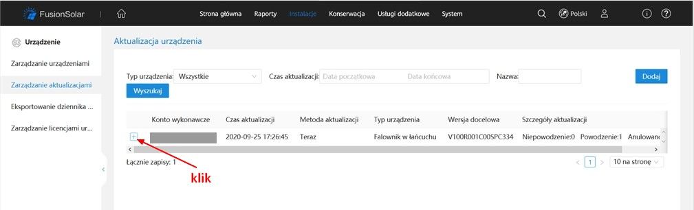

    You can find the software on this page: Plants => Upgrade Management => Device Upgrade. If you have any questions, please contact: eu_inverter_support(_at_)huawei.com.

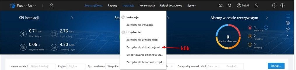

    @rokbok - can you paste what the menu looks like in this place for you?
    And do you also need an installer account to see this "Device upgrade" function or is the owner enough but with higher privileges than mine?
    For me, the update path is as below, if you do not have these options, they must be the installer's permission.

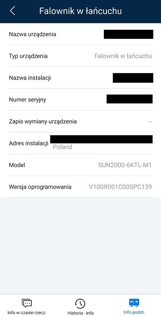

    I wrote to the bottom bracket and they sent me sofas 139 and dongle 124.
    Tomorrow is an update.

    I have had the update without any problems, despite one dongle and a cascade connection of 2 inverters. I also updated both the success and the dongle.
