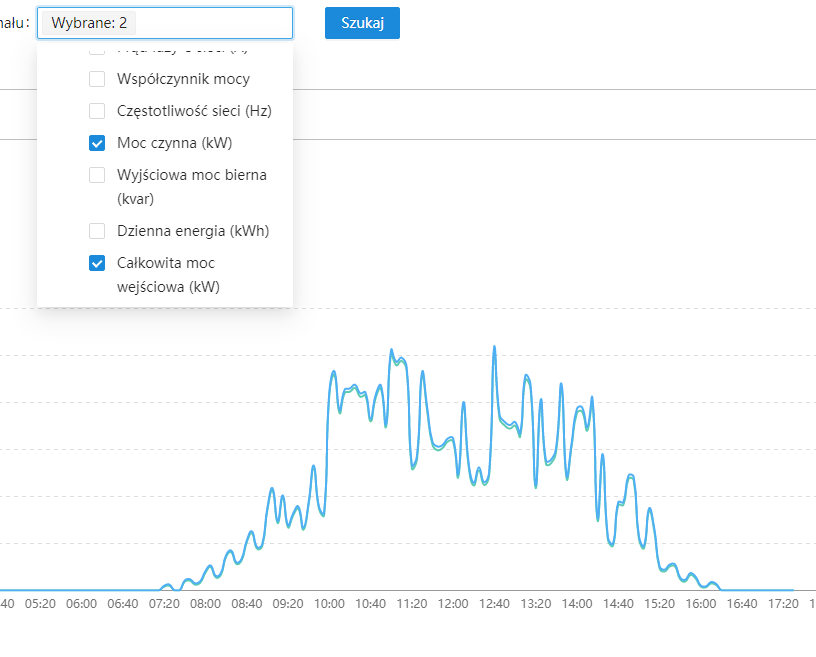

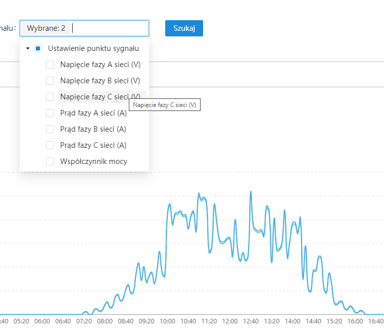

    vlad1947
    I scroll down the window, there is nothing about strings - it certainly was because I check it every day.
    It was from a different position, could the installer turn off the preview?
    The point is that one string is most likely oversized, the date of correction is approaching
    and suddenly I have no view of his work

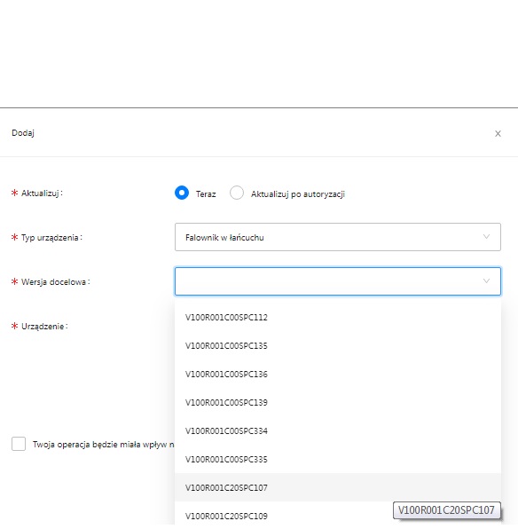

    Hello, I can't figure out these updates on the fusionsolar site.
    In September, I switched from V100R001C00SPC133 to V100R001C00SPC135, my inverter is SUN2000-6KTL-M0
    The list of available updates is attached
    Should I upload with the highest number V100R001C00SPC335?
    upload ... 139 this is the latest.

    Thanks for the quick reply, which inverters is the upgrade with the higher number ending in 335 for? I am looking for some logic for these updates I do not see anything meaningful for m0, m1, m2. My model is M0

    And even more interesting is that the last available version of 602 is 136. And there is no visible one at all 139

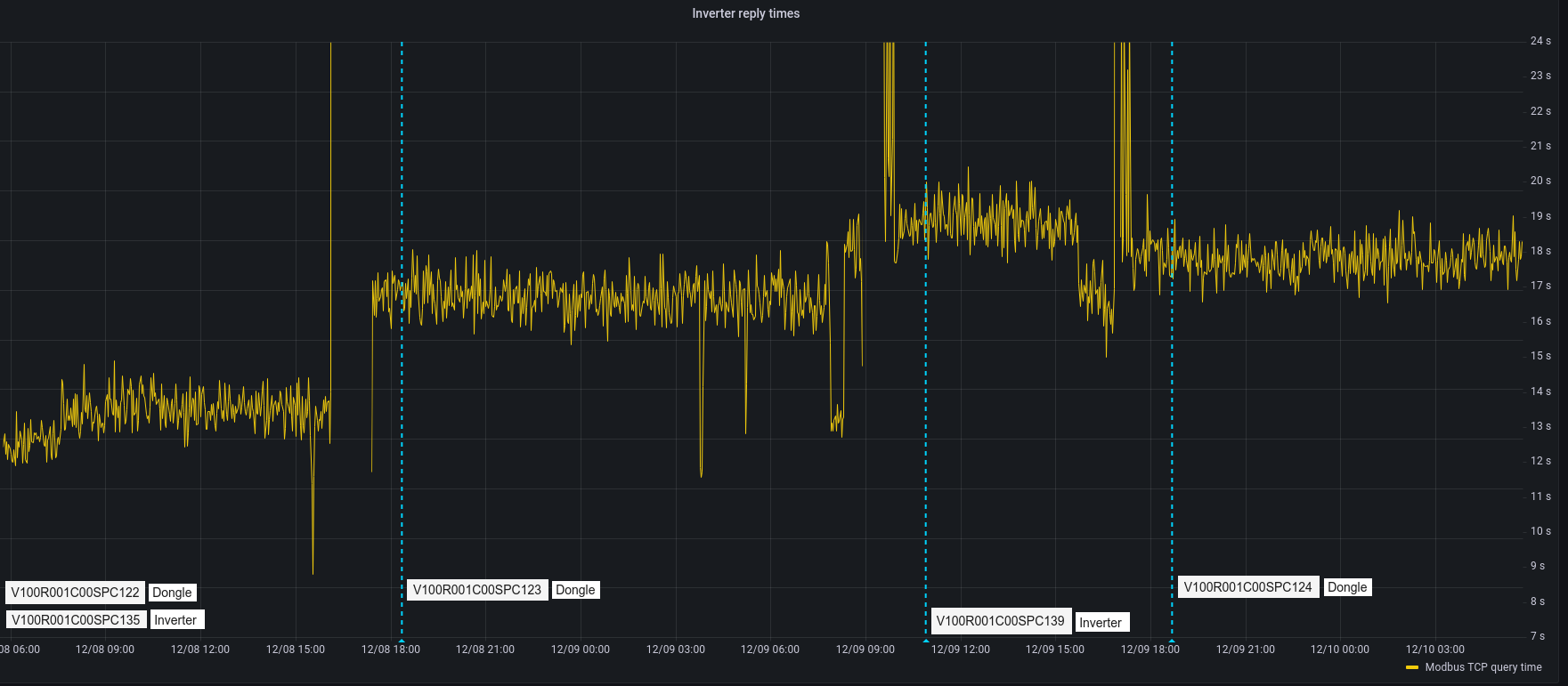

    I just wanted to confirm that I was able to successfully update the SUN2000-6KTL-M0 model with the portal to:
    V100R001C00SPC139 (inverter)
    V100R001C00SPC124 (dongle)
    Of course, I had to enable the Modbus-TCP settings in the inverter settings (using the fusion solar app for Android). Generally, these settings are in the inverter itself (they are configured via the internal wifi of the inverter itself). I even set it up before I even uploaded a newer soft to the dongle itself.
    Unfortunately, what I expected to improve (response times) are even about 5 seconds worse for my set of downloaded parameters after modbus-tcp :(
    It is not sick that the connection via wifi gives this set of data a flash (as I remember correctly 3-4 seconds) and the same set of downloaded via LAN (sic!) Takes almost 20 seconds with this method?
    Sick !!!
    But what to say - this is our Chinese technology.
    Anyone using a hardware modbus? I suppose it goes there too (and probably the fastest).
    I made a simple graph to illustrate the problem. I put at the bottom what I was updating and how it influenced the response times - of course, we do not take the pins into account ...
    Huawei SUN2000 Inverter: WIFI Dongle Connection, Firmware Update & FusionSolar
    Just a little info about the inverter update itself - they recommend doing it with the panels in the sun - my cousin did the same and did the update early in the morning and in addition the panels under the snow - it went without problems ...
