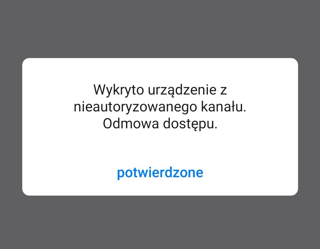

    Have any of you encountered the message in Fusion Solar "Device detected from unauthorized channel. Access denied"?
    I bought a Sun2000 8ktl M0 inverter from an importer - a Polish warehouse, Chinese version, connected with Fusion Solar, there was a prompt to update, I updated, set up Internet access via LAN - everything ok (despite the Chinese stamps). Then I wanted to add the inverter to the created installation in Fusion Solar and then this access denied message started to appear. Does anyone have any idea?
    I would like to refresh the topic. It's been a long time fought with this and I still can't add this inverter to Fusion Solar because of the message below. I am asking for some help or hint. Is it currently possible to add a Chinese version for installation in Fusion Solar or any other remote viewing option outside of HomeAssistant? Huawei SUN2000 Inverter: WIFI Dongle Connection, Firmware Update & FusionSolar

    wyimag11 wrote:
    I would like to refresh the topic. It has been fought for a long time and I still cannot add this inverter to Fusion Solar because of the message below. I am asking for some help or hint. Is it currently possible to add a Chinese version for installation in Fusion Solar or any other remote viewing option outside of HomeAssistant? Huawei SUN2000 Inverter: WIFI Dongle Connection, Firmware Update & FusionSolar
    Maybe try to call / write to the Polish support, I had no such problems a year ago, but in the meantime I contacted them for a different reason and they did not have any problems with the answer (I also have an import).

    wyimag11
    Rate: 7
    I contacted them, but unfortunately they did not want to help me when they realized that it was the Chinese version.

    akir19
    Posts: 38
    Check out the fusion home application

    wyimag11
    Rate: 7
    I checked Fusion Home but it only works locally on the inverter wifi. I am still wondering if Fusion Home would work if I put a VPN in place and then tried to connect. Could someone be doing something like that?

    akir19
    Posts: 38
    I was more wondering if you can upload the European firmware to him

    rokbok
    Posts: 4251
    Help: 622
    Rate: 992
    Not true, it also works over home WiFi, but you need to set your WiFi on the inverter, and the SUN2000 app also works.

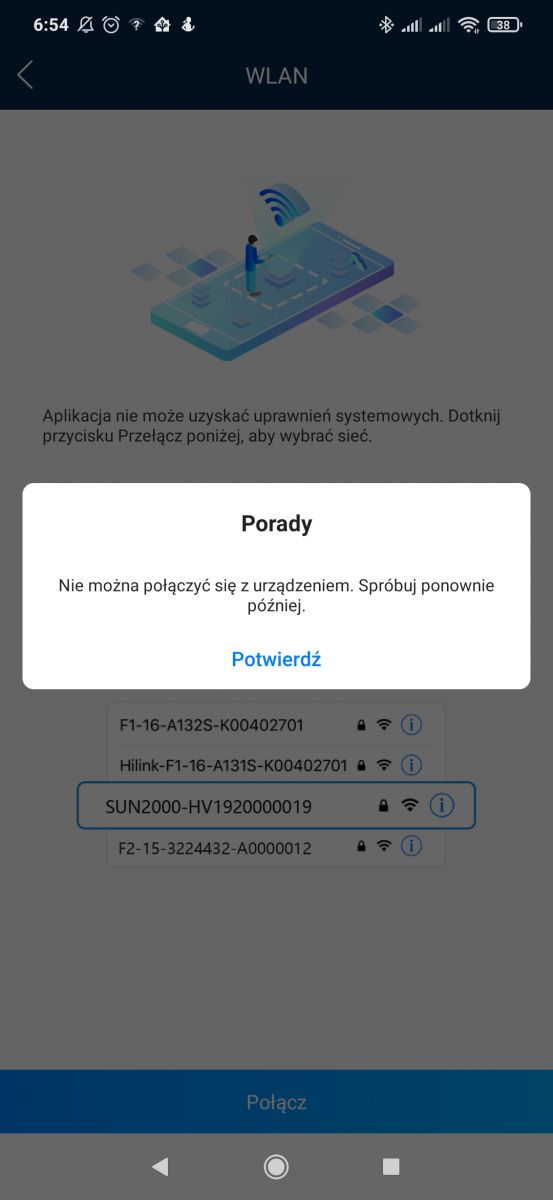

    I have such a problem, I wanted to change the WiFi network in the inverter, I logged in to the admin panel via the SUN2000-HV19 inverter network .... etc. There was information that the software needs to be changed, the update went without a problem, the inverter fired again. It spreads its WiFi network to which the phone connects. Unfortunately, it is not possible to log into the inverter.
    The application on the phone was updated - the problem persisted. I would like to add that before this procedure, Home Assistant connected with the inverter without any problems, now there is no connection with HA.
  • #619 19963123

    As it was an update to 140, you can change from the administrator account to a newer or older version through the fusionsolar portal. The port for HA has changed to 6607, but in version 140 the communication is completely blocked.
  • #620 19963140
    andrzejewskikam
    So only this way? I understand that it will not be possible without a phone to the installer?
  • #621 19963169

    You can also write to the huawei support, provide the serial numbers of the inverter and ask for the update to 141 or apparently already 142. You will not do anything alone without an installer account on the fusionsolar portal.

    andrzejewskikam
    lizak1983 wrote:
    You can also write to the Huawei support, provide the serial numbers of the inverter and ask for the update to 141 or apparently already 142. You will not do anything alone without an installer account on the fusionsolar portal.
    Support helped, they downloaded new software remotely and there is no problem

    andrzejewskikam
    TomiF19 wrote:
    Have they uploaded the firmware with the 141 or 142 ending?
    141

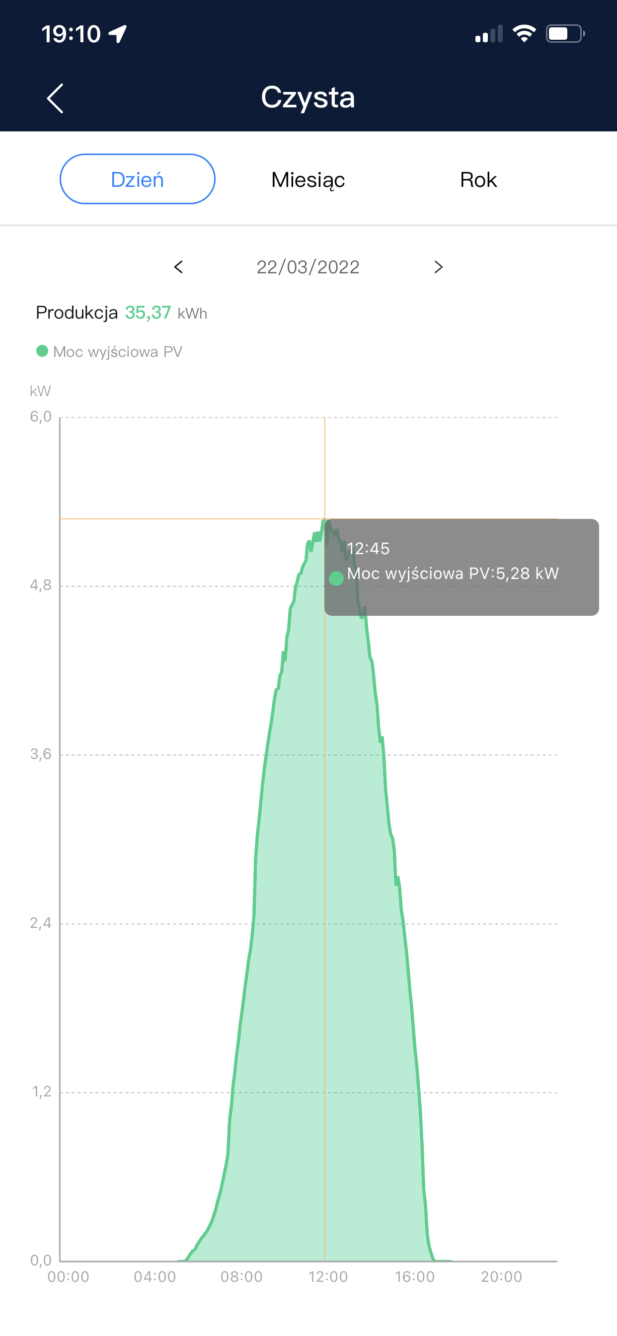

    Such a question: I have a 7.1 kW installation.
    On days like today (i.e. generally sunny) in the app via the website, it shows me that I achieve as much as 8kW.
    Panels located around 40 degrees, south, but is it not an exaggeration? Why is it showing so much?
