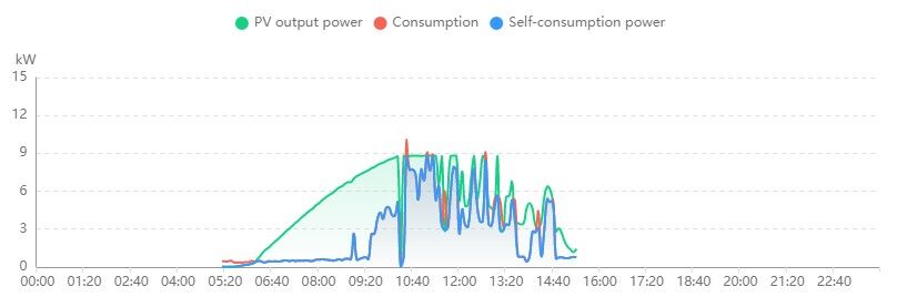

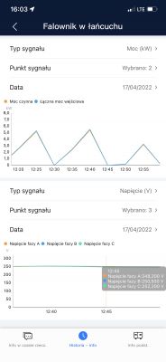

    Hi,
    next to the chart:
    Huawei SUN2000 Inverter: WIFI Dongle Connection, Firmware Update & FusionSolar

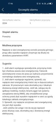

    on the FusionSolar page in the alarms tab, I only see two overvoltage fault alarms.
    You can try to correlate the lows with what the inverter sees on each of the phases in the application, but the problem is that the report is in intervals of 5 minutes: - /
    I have a tasmote on one of the vases and you can clearly see on the chart that I'm reaching 253:
    I generally focus on the weather, cool with a strong sun, additional installations in the area and burying Tauron by the transformer. I have already written a letter to them on this matter.
    But the topic of this software is interesting. In March I had bigger productions and even the pickups were better and the inverter didn't shut down. From April 6, I have an average of a few shutdowns per day and today, in mega weather, there are more of them. [/ Img]

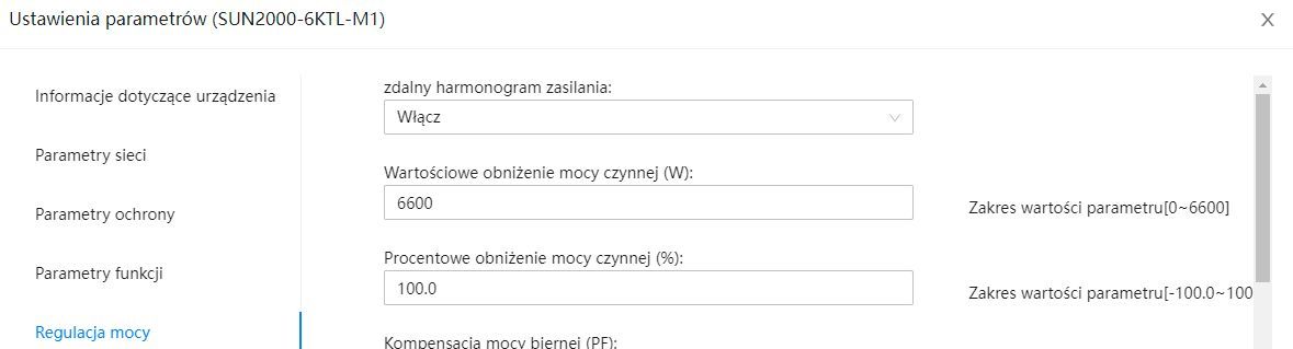

    In the application, the "Device management" section at the bottom> Select the inverter> "History - info" then in the lower half you select the Signal type and signal points on V and add 3 phases.
    It looks like:

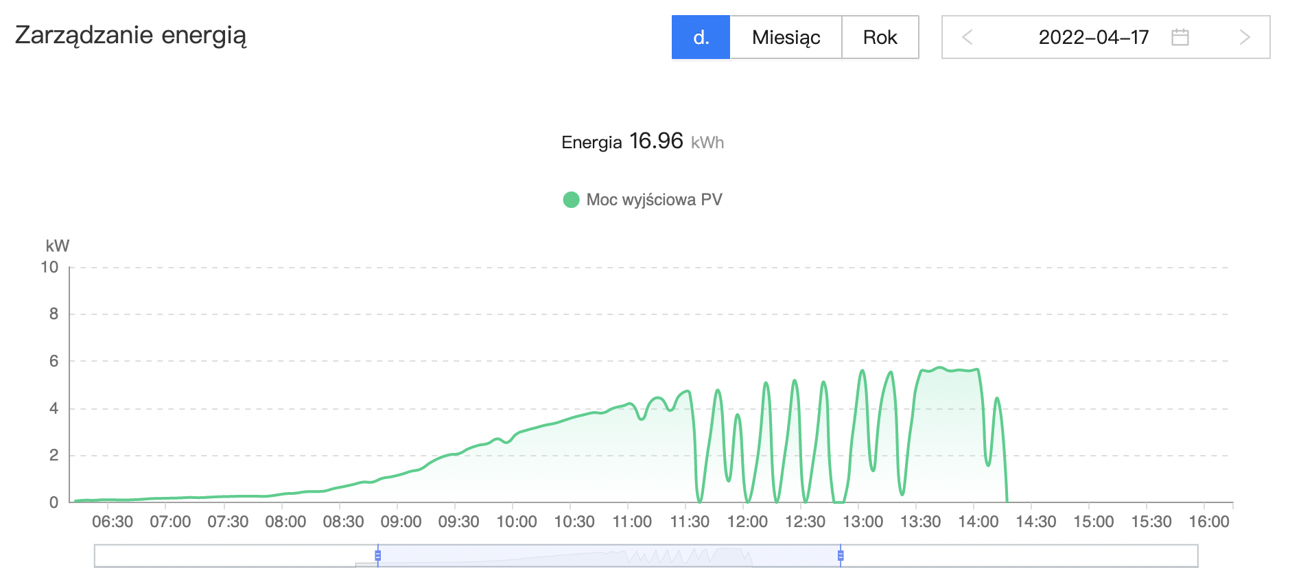

    However, the day of April 14, 2022 was specific. (I also noted a lot of inverter shutdowns)
    Tests the settings of Q (U) voltage increase suppression (P) ... (the above exclusions just with the Q (U) function did not help much)
    Software Version: V100R001C00SPC141

    @domelek and how was it possible to test 141 in Sieradz yesterday?
    What I noticed from 142 is that not every drop in output generates an overvoltage error. Those that generate usually cut production for 1-3 minutes. You can see it on the inverter because the yellow and red LEDs are blinking. Yesterday I had 5 drops in production and not one of them generated blinking LEDs.

    It is definitely better, but there has not been a cloudless day yet and it's hard to say something 100%, so far I'm improving the algorithm for turning on the heaters, which are to compensate for the increase in voltage in the network, unfortunately the neighbors evidently have their installations turned up ...
    Huawei SUN2000 Inverter: WIFI Dongle Connection, Firmware Update & FusionSolar Huawei SUN2000 Inverter: WIFI Dongle Connection, Firmware Update & FusionSolar Huawei SUN2000 Inverter: WIFI Dongle Connection, Firmware Update & FusionSolar
    There are much less drops to zero (only), but this is also thanks to the heaters.
    And I added additional cooling, we will see what impact it has on the efficiency of the inverter, I will test, because I can make a temp vs efficiency graph ...

    What are these settings for active power reduction in the inverter?
