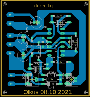

    #57 19646480
    Olkus
    Level 32  
    Posts: 3922
    Help: 132
    Rate: 919
    elektronik.b wrote:
    bratHanki wrote:
    This is good, I would also need a mosaic pattern of paths.
    The plate below in the attachments :)
    Give at least a plus for your time drawing this :P
    @elektronik.b print first on a regular sheet to check if the dimensions suit you and if the elements you have fit.
    Regards,
    AND.
    • TL084 termotransfer.pdf (39.11 KB) You must be logged in to download this attachment.
    • Using LM358 IC for Dual VU-Dial Indicator System in Plastic Housing: Tips & Tricks wzkaznik TL084.png (13.01 KB) You must be logged in to download this attachment.
  • #59 19649328
    Sanjose
    Level 32  
    Posts: 1945
    Help: 181
    Rate: 229
    Why can't you use symmetrical tension?
