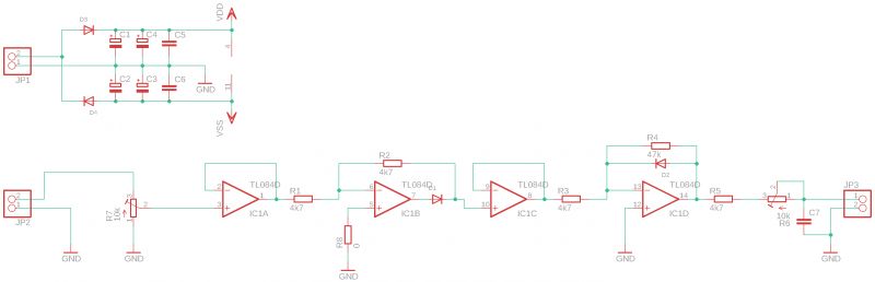

  • D2 inversion makes the last stage linear, not logarithmic
    #99 21570029
    pcichomski
    Posts: 579
    Help: 32
    Rate: 96
    zgierzman wrote:
    398216 Usunięty wrote:
    You can see why?
    And does toto have logarithmic characteristics? "I don't think so", but I'm not concentrating on that, it's bedtime, after all the weekend is for rest. Maybe the diodes in the feedback break it down a bit to make the nodding of the cues look more believable?
    Electronic schematic with power supply, four TL084D op-amps, several resistors, capacitors, and diodes.
    There is no logarithmic characteristic because diode D2 inverted and the last amplifier works as a simple linear inverting rather than logarithmic.
