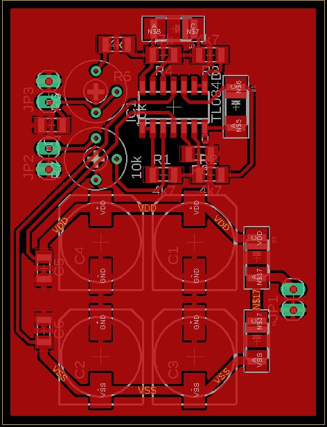

  • TL084 pcb layout with onboard power supply
    #68 19670089
    elektronik.b
    Level 4  
    Posts: 384
    Rate: 80
    The layout on TL084 is done. I made the schematic and design of the pcb in a kicad. I immediately used the power supply on the board, so it is enough to connect the 12v alternating voltage to the first terminal from the left. I think that now, when he puts these tiles in his indicators, they will indicate what is needed.

  • Potentiometer purpose and PCB layout critique
    #69 19670266
    398216 Usunięty
    Posts: 34326
    Help: 3925
    Rate: 9453
    Using LM358 IC for Dual VU-Dial Indicator System in Plastic Housing: Tips & Tricks And this potentiometer is for what purpose?
    As for the PCB design - you still need to work on the neat placement of the components. Many elements could only be positioned slightly differently, and the connections would be less "broken" and (most importantly!) A lot shorter.
    Not that I want to fault - don't take it that way. I started with more or less the same errors, but I would like to point out the errors that, with a little commitment, you could easily correct. By the way, the PCB itself would be even smaller ...
  • #70 19670602
    elektronik.b
    Level 4  
    Posts: 384
    Rate: 80
    I will take this into account well in future projects. And this potentiometer was already in this diagram from practical electronics, so I put it.

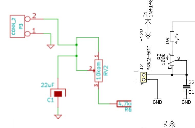

  • #71 19670706
    398216 Usunięty
    Posts: 34326
    Help: 3925
    Rate: 9453
    elektronik.b wrote:
    this potentiometer was already in this diagram from practical electronics so I put it.
    It's just that in such a connection as in the marked diagram it makes no sense - whether it is or not, the effect will be the same. Can you see why?

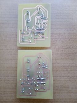

  • Redrawn PCB and questioned pot value change
    #72 19671193
    zgierzman
    Posts: 1787
    Help: 108
    Rate: 1573
    398216 Usunięty wrote:
    Can you see why?
    Exactly why?
    The diagram is illegible, but it looks to me to adjust the output impedance - from 4k7 to 14k7 ... Or 104k7, because in the original EP this potentiometer has 100k
    On Saturday night I redrawn it humanly and made a plate. 4 x 5 cm, but so big, because huge electrolytes take the surface ... 16 mils tracks, easily done with an iron ...
    And as I can see it is the fourth version, after the original from the EP, Olkus's version and the author of the thread :-)
    And does toto have a logarithmic characteristic? "I don't seem to", but I don't focus on it, it's time to sleep, after all, the weekend is there to rest. Maybe the feedback diodes break it a bit to make the nodding of the hands look more believable?
    Electronic schematic with power supply, four TL084D op-amps, several resistors, capacitors, and diodes.
    PCB design showing traces, electronic component markings, and connection points.

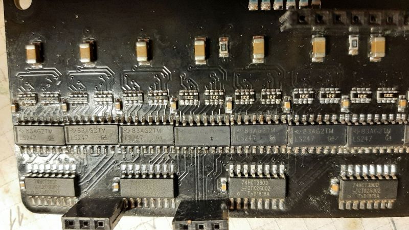

  • SMD layout shrinks tube-style meter circuit
    #78 19671291
    zgierzman
    Posts: 1787
    Help: 108
    Rate: 1573
    This is a fragment of my last DIY (I wonder if I should post it on the forum) ... And do it in THT - how much space do you want? I fit in the 10 x 10 cm format, but if I did in THT, probably 20 x 20 would not be enough ... Note that the resistors in the photo are 58 (say: fifty-eight) pieces. Apart from the six, which are not fully visible, at the very top of the photo. In addition, 19 capacitors and 11 integrated circuits. And the fragment shown is about 4 cm x 7 cm ...
    After the description "vacuum tubes, retro electronics" I guess you know what you see. In the 1980s, the Polish industry produced instruments on comparable elements and comparable functionality, which had dimensions of 35 cm x 25 cm x 10 cm, mine is 10 cm x 10 cm x 3 cm. The difference is in the THT / SMD technology.
    PS: I was about to go to sleep, and I pat on the forum, although midnight is past ...
  • SMD enables much smaller PCB dimensions

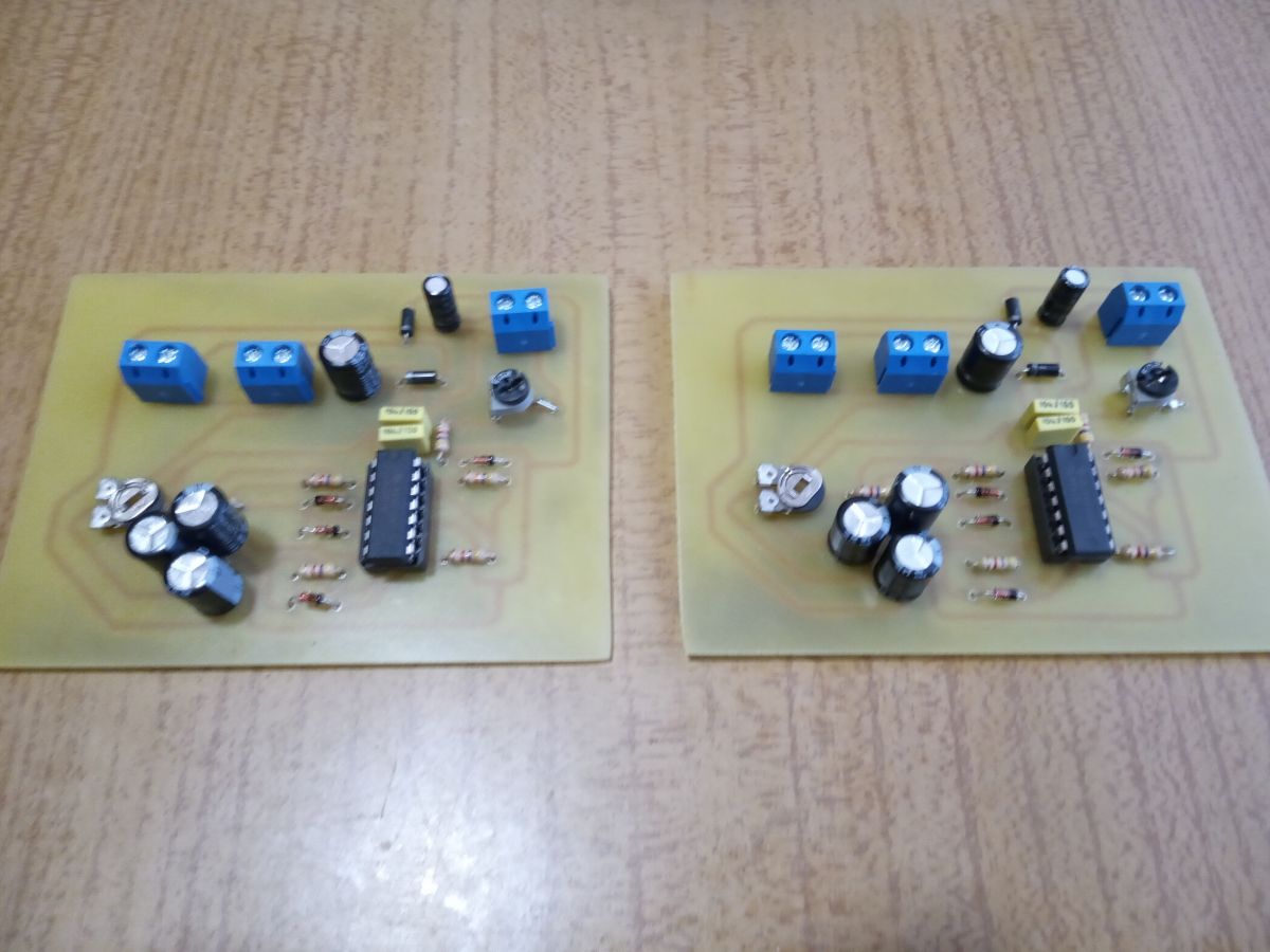

  • Potentiometer changes indicator sensitivity as expected
    #81 19671682
    elektronik.b
    Level 4  
    Posts: 384
    Rate: 80
    Zgierzman cool You, this board came out when it comes to soldering smd elements, I just have no patience for that in my life, I soldered only two systems with smd elements, such as this one: https://www.gotronik.pl/equalizer-analizator-widma-akustycznego-8x8- led-p-4942.html and I was sitting on it for about 4 hours and the system worked, fortunately, and probably some impulse counter from the avt offer or something like that on attiny2313 but it did not work for me before starting the system, I made a short circuit on two legs scalaka and burned.
    As for the potentiometer, when I turn it, the sensitivity of the indicator changes, as well as in the case of the potentiometer inserted between the system and the audio signal supplied. And I redrawn it the same as in the original diagram, so there is probably no error.

    zgierzman wrote:
    Exactly why?
    And what does the dot mean in the diagram? Connection. So why is the red oval drawn fragment drawn so senselessly?
    A potentiometer is needed - this is not a problem. The only thing that worries me is the Author's answer:
    Copying a layout without thinking what is in it and what for. Another example - power supply. The diagram on which the Author was based was drawn (which is quite logical), but why copy it to the second tile? Wouldn't it be enough to route the power supply from one PCB, where the power supply is, to the other, where it is not? And why two tiles instead of one? Ultimately, it is intended for a specific application, application to a stereo indicator.
    Once again - I am not here to mock the ignorance of the slaughter = or the author of the topic - God forbid! Rather, it is about "forcing" (once again ...) independent THINKING.
    Because what, like what, but thinking (preferably logical) in the case of electronics is a matter of priority.

  • #83 19671940
    elektronik.b
    Level 4  
    Posts: 384
    Rate: 80
    Thanks for the good advice.
    Added after 4 [minutes]:
    I also made the second one after the first one. Using LM358 IC for Dual VU-Dial Indicator System in Plastic Housing: Tips & Tricks

    zgierzman wrote:
    No, note that there are BCD to 7-segment decoders. In addition, there are 7 in the picture, in fact 10. But you're right, it has something to do with timing
    Hmm ... Then I have a problem for the afternoon to find out what kind of device it is :)
    Regards,
    AND.

  • Potentiometer is electrically unnecessary here
    You see, reread what you wrote earlier:
    You wrote that it will not work, or maybe it is even unnecessary. And he's just plain ugly, but correct. Electrically, I don't see any difference between the author's version and what was in the EP.

  • Manual PCB layout tips for tighter component packing
    #88 19672415
    olaf x
    Posts: 2499
    Help: 257
    Rate: 363
    Such a small note regarding the design of the tile, sometimes it is more convenient to make one or two jumpers, instead you can pack the elements tighter and you do not have to "detour" half the tile along some paths. Even on the factory plates, there are jumpers, sometimes even quite a lot. Obviously, you shouldn't overuse it, but sometimes it is a simpler solution.
    And the elements themselves, such as the traditional resistor - if we do not care about the low height of the elements - it is sometimes worth installing not "flat", but vertically, so that the resistor on the board will take up less space. When there are more of them next to each other, it is worth threading a section of insulation on a longer leg, torn from a thicker cable with a stripper, then there will be no risk of shorting the elements together.
    I would like to add that even with a rather complicated board, I do not use any "programs" to draw a tile, but when I see a pile of collected elements and see their dimensions, I draw paths "by eye", according to the diagram, and then next versions with greater compaction of elements, until it can't be more tightened. Then this is the final version to be made. It does not take a long time, but the pleasure itself :)
  • Vertical component placement and jumper routing tips
    #89 19672580
    398216 Usunięty
    Posts: 34326
    Help: 3925
    Rate: 9453
    olaf x wrote:
    if you do not care about the low height of the elements - sometimes it is worth installing not "flat", but vertically, so that the resistor on the board will take up less space.
    This is exactly what I meant with R5. After switching the R5 and D4 vertically, we get much shorter and less bent paths. There would be a few more such places.
    olaf x wrote:
    sometimes it is more convenient to make one or two jumpers, instead you can pack the elements tighter and you do not have to "detour" half a tile along some paths.
    Agreement. Condition - the jumper must be placed so that it does not run under any element and it is best if it runs parallel to the edge of the board.
    Well, that's what I meant in post 82.
    In fact, I got a bit confused; and that's exactly what I meant in the case of board design - the diagram must be drawn CLEARLY. Some loops, leading paths only to stick them together later, not only that they make a mess, but also make it difficult to "read" such a sloppyly drawn diagram. But - cool ... This also has to be learned ... ;)
