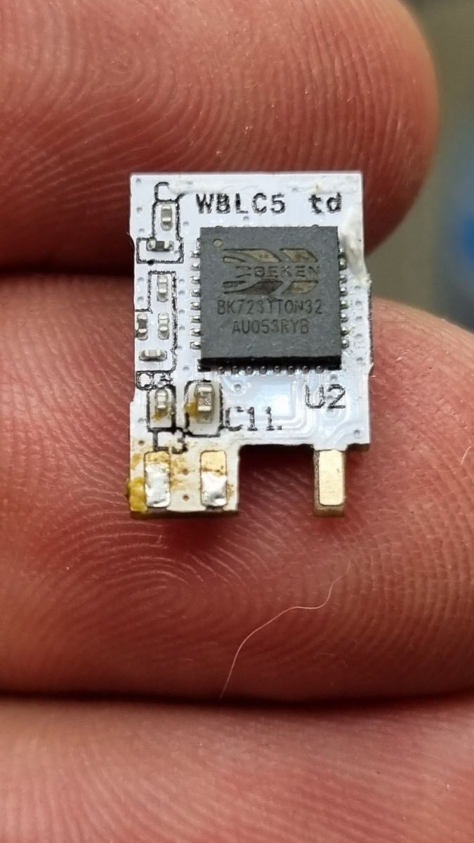

  • Flash ID reads 0x00000000 during BK7231T upload

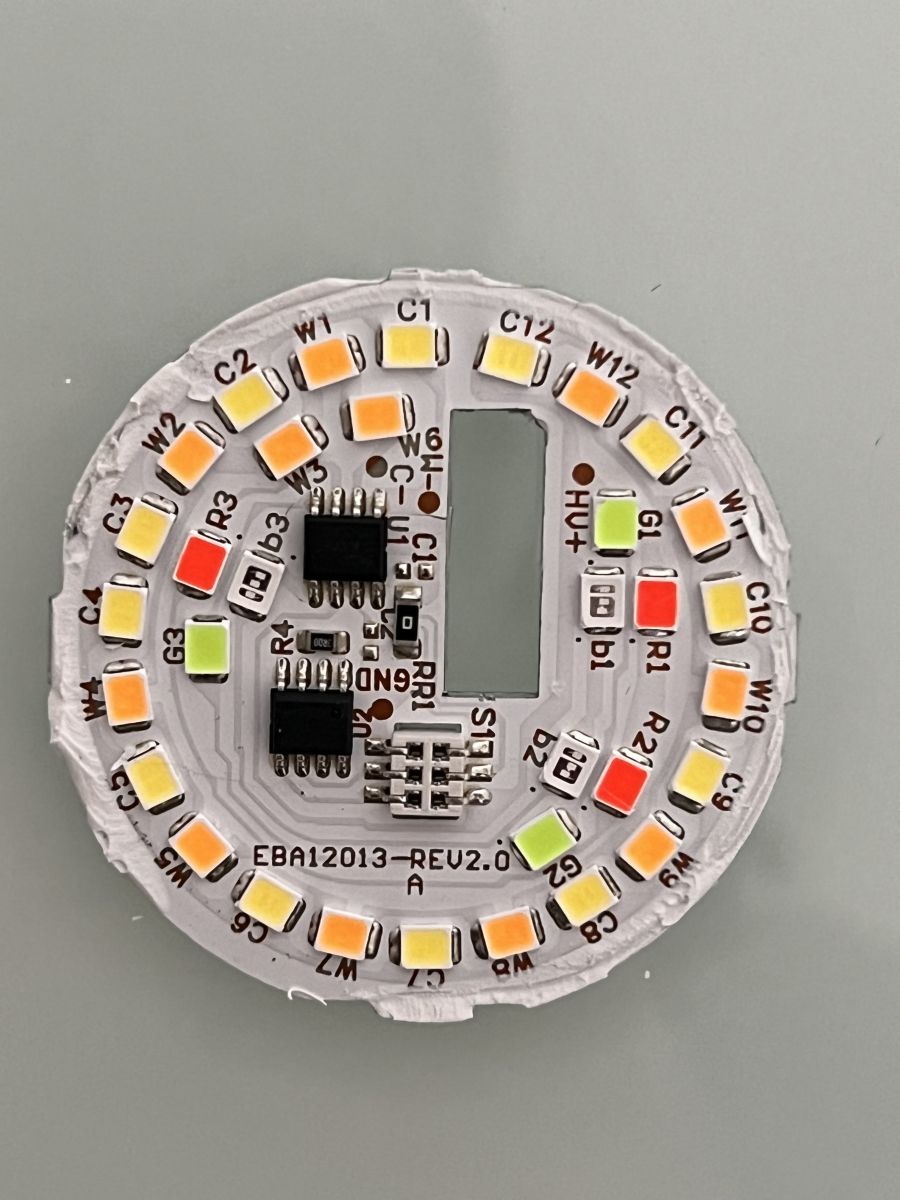

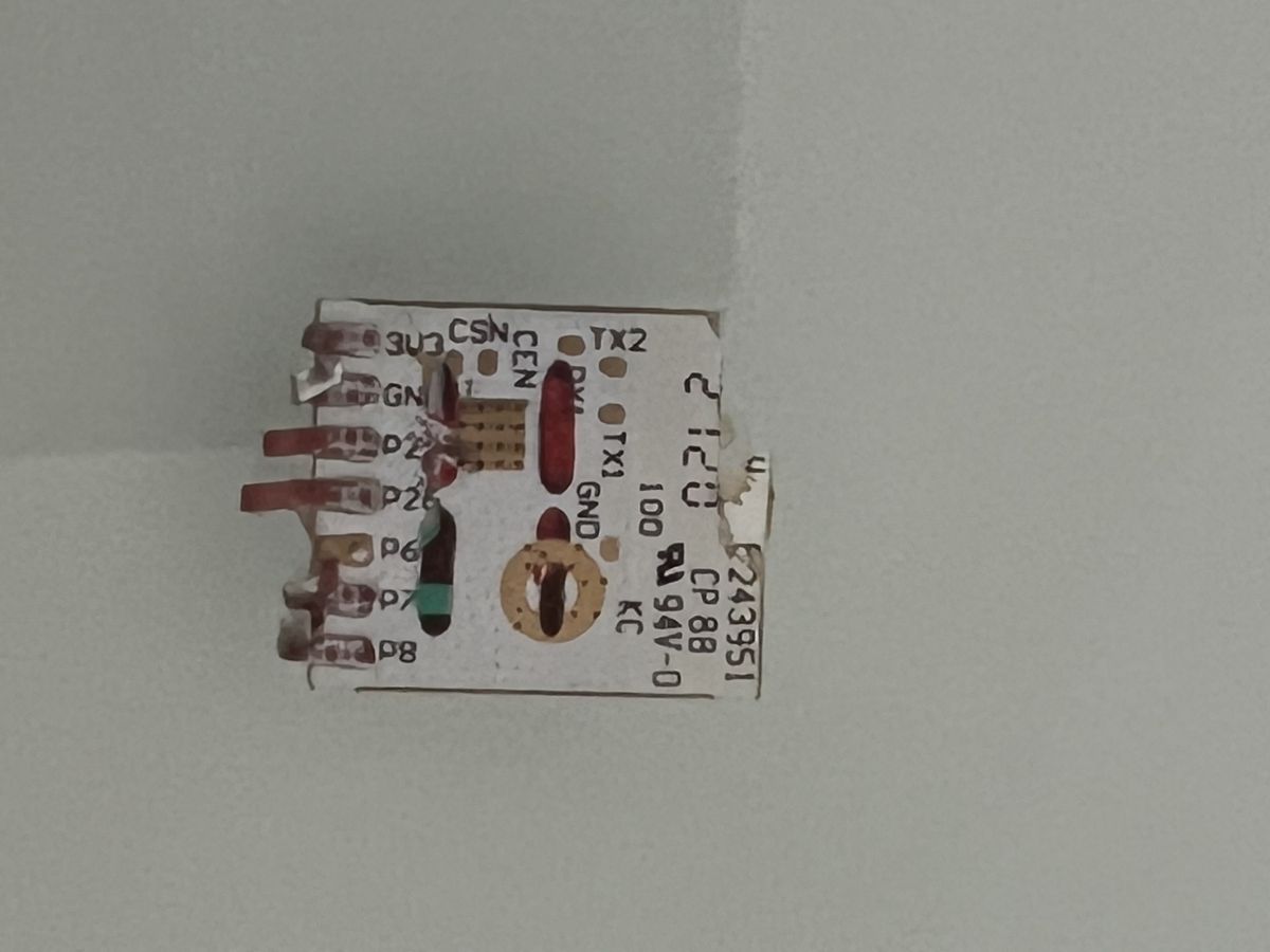

    #1063 20305000
    Dark Man
    Posts: 74
    Rate: 20
    He is preparing a teardown from a decorative LSC 970729 bulb (for which there is no cloudcutter profile) in which all electronics sit in an E27 socket.
    I managed to extract the electronics, desolder the WBL5C module, rip the 2MB batch using CH340 and BKwriter, but I can't upload anything for nothing.
    I tried:
    - normally using RX1, TX1
    - with external 3.3V power supply
    - by soldering to RX2 TX2
    - desoldering RX1
    - using different speeds
    - using NodeMCU v3 with ESP disabled
    I thought that maybe something from the TX1 pad was damaged, but by desoldering from it, the ripping of the batch did not go.
    Each time BKwriter immediately after connecting the WBL5C power supply spits out the error:
    Flash ID:0x00000000
    Time:2.827s
    Speed of Programm:115200bps
    erasing flash:0x00011000...FAILED
    I also installed everything for ripping/uploading via python, but even the ripping wouldn't start there.

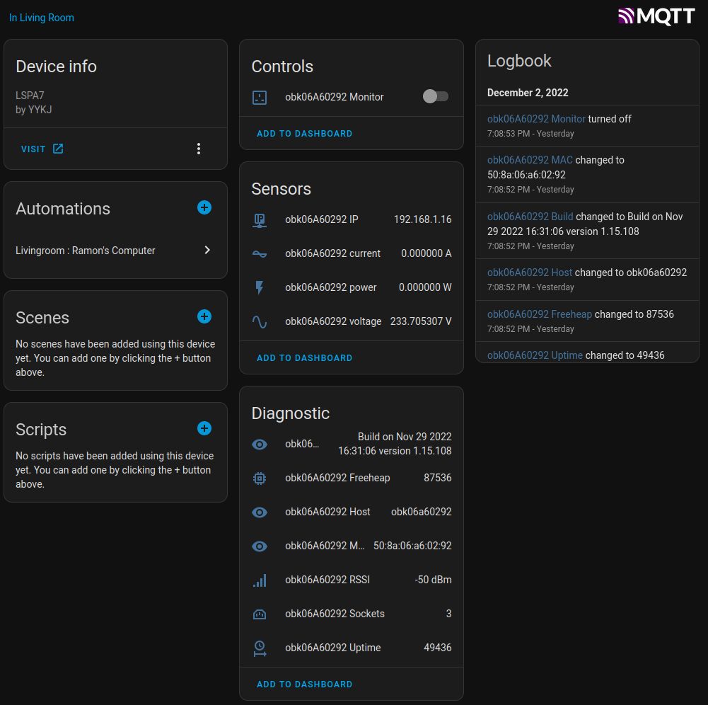

  • #1073 20315742
    Posts: 14771
    Rate: 12914
    @marioalmeida if Home Assistant Discovery protocol supports that kind of values, there is no problem. I can look into it if you want, but it might be faster to ask our contributor @iprak who wrote the HA discovery support for OBK.
  • #1074 20316414
    marioalmeida
    Posts: 47
    Rate: 24
    @p.kaczmarek2 , yes that is possible, check this image which is configured with manual MQTT.
    @iprak, appreciate if you can add that as I can avoid to configure it manually.
