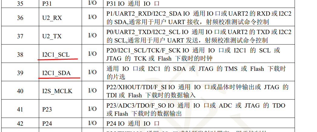

    EDIT: datasheet of some bk7231 module with information which pin is hardware I2C:
    • BK7231_chinese_datasheet.pdf (607.69 KB) You must be logged in to download this attachment.

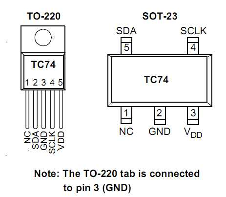

  • Working hardware I2C demo on BK7231T
    #333 19926050
    Posts: 14724
    Rate: 12806

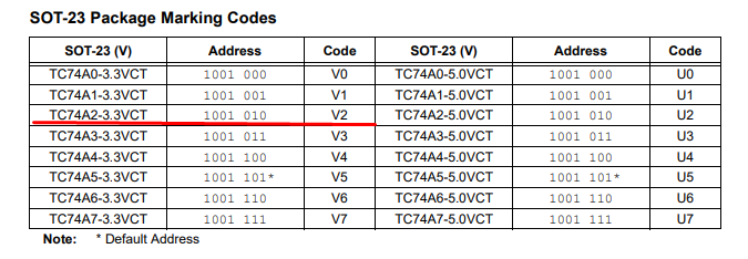

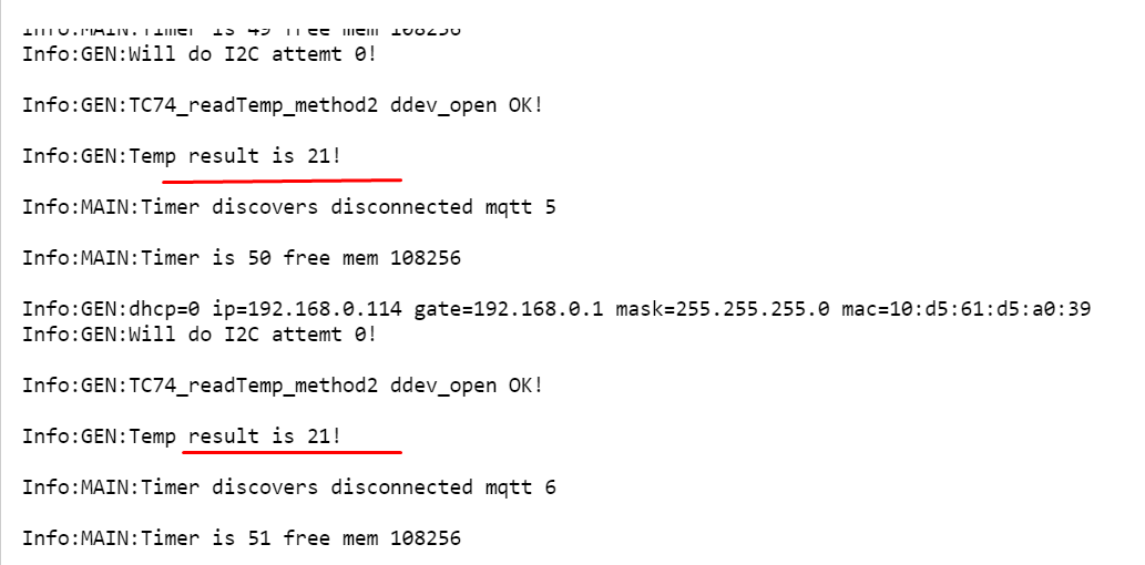

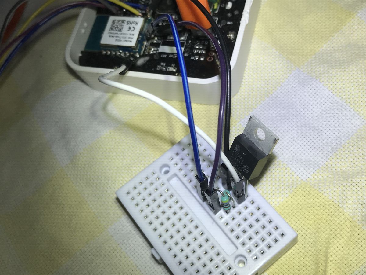

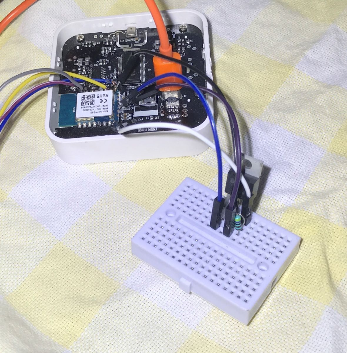

    After half a day, we have a working hardware I2C demo!
    Here is my setup:
    This is a TC74A2, an example I2C device (simple temperature sensor) which I had at had, used only for testing.
    Code snippet:
    Code: C / C++
    The hardware I2C 1 module is accessed via DD interface. The "camera_intf_sccb_write" functions are not really needed, it's just that I've been basing of the camera sample from the SDK, code will be simplified.
    The I2C device address for A2 version was taken from datasheet:
    Results:
    NOTE: this is just an example, the whole per-device I2C support is still TODO, including the configuration and frontend systems.
    Do anyone know which I2C devices would be useful to implement?
    NOTE2: Hardware I2C 1 is bound to pins P20 (I2C1_SCL, TCK, SCL) and P21 (I2C1_SDA, TMS, CS)

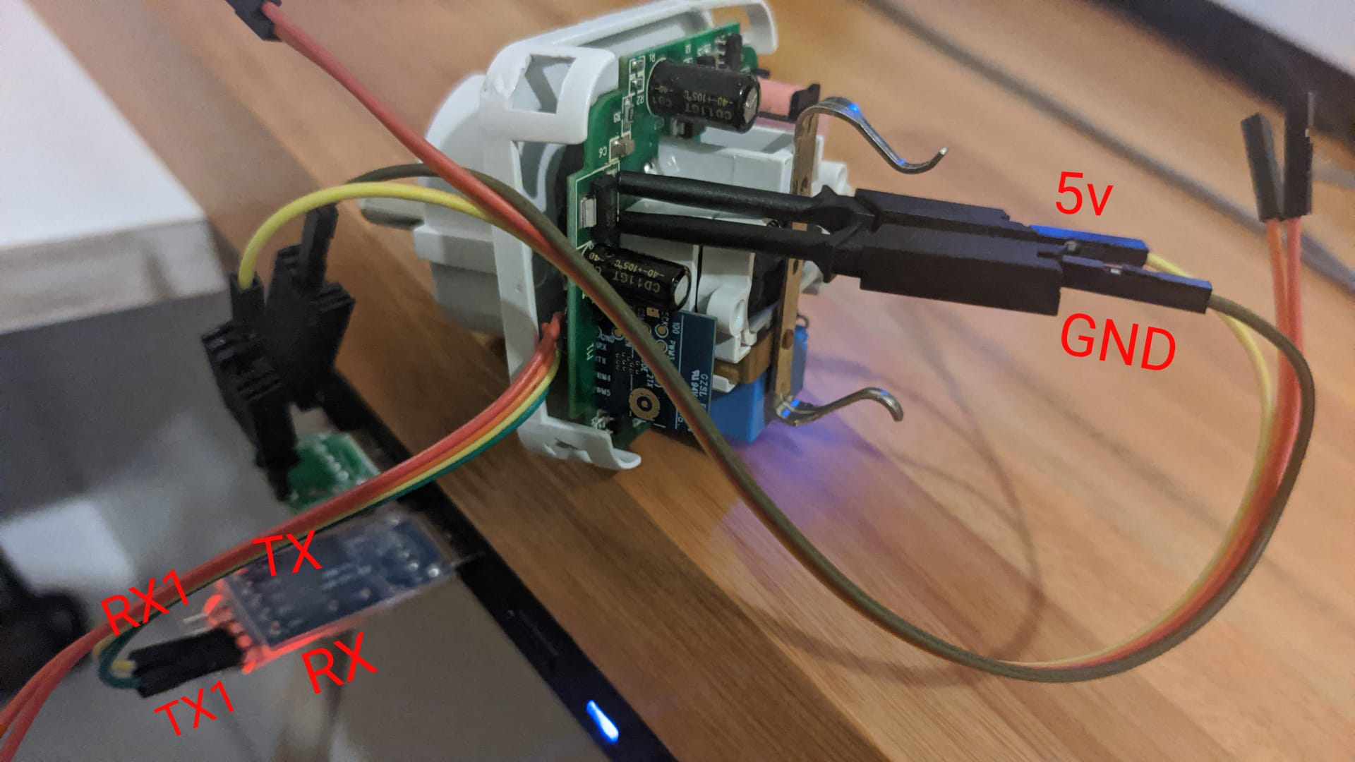

  • Suggesting serial console test on RX1 and R3 check
    #336 19928890
    pepesuriano
    Posts: 33
    ExploWare wrote:
    I fail to see a question. I thought it was reporting a success story.
    Can you rephrase your question?
    So it's working or is it not?
    Apologies, must be some difference in our native languages of handling questions and it's translation to english :P
    In my previous posts, when I said "no luck" it was meaning that I tried that and it didn't worked. I got the same behaviour the relay clicks, but bkwriter don't detect anything and python neither.
    Do you have a device to test if you plug RX1 and open the serial console, do you see anything there? I think it must show up somethin (I know this is just for programming, but in my case I don't see anything). Also, the question of R3 from my previous post is to see if that there is something electrically blocking RX1/TX1

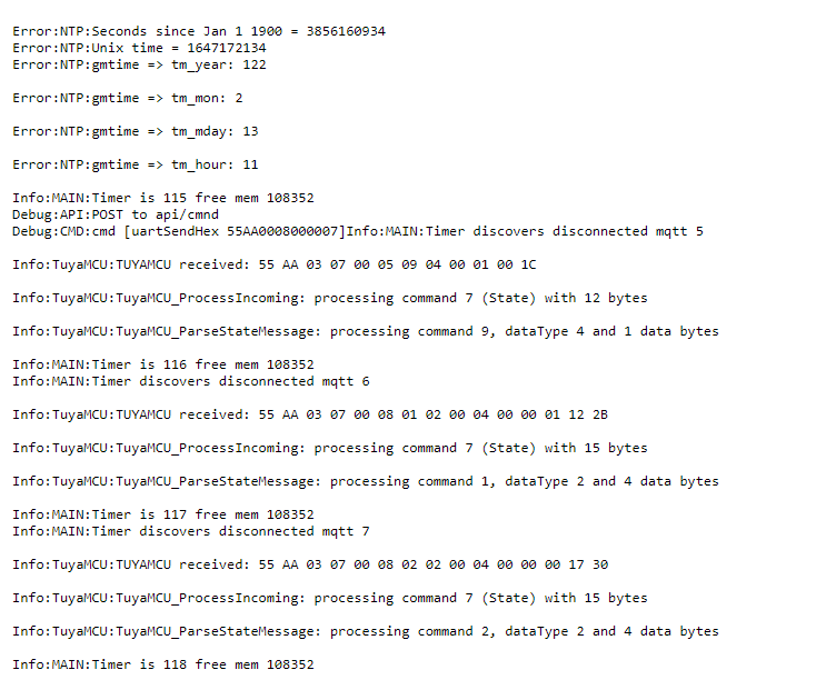

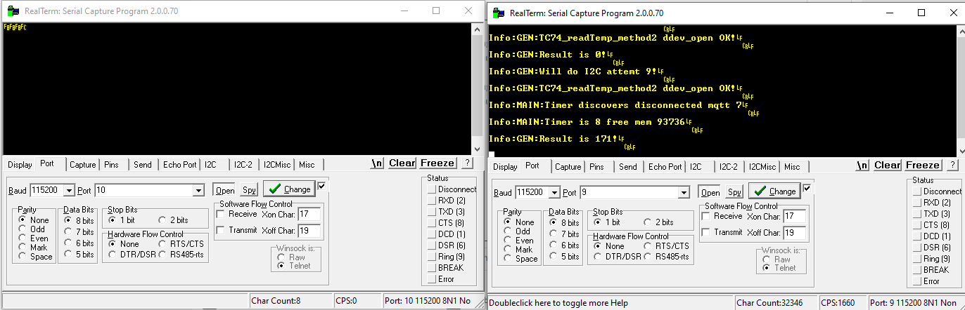

    #337 19928942
    Posts: 14724
    Rate: 12806

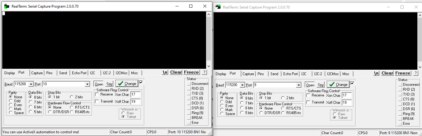

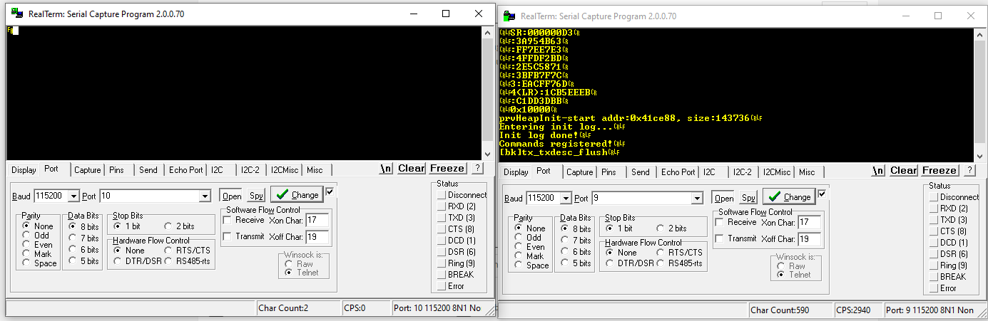

    Ok let's see (power off state):
    after power on:
    After 4 power off and power on cycles:
    So it seems to be receiving something, but you would have to look into uart python flasher source to see if it's really something or just a noise...
    Btw, I have a progress with TuyaMCU:
    Screenshot of a log console displaying error and connection information.
    A fragment of a log with debugging messages and TuyaMCU state information.
    230 and 24.... or, rather, 23.0 and 24:
    Digital clock display showing temperature 23.3°C, humidity 24%, day of the week WEDNESDAY, time 8:08 AM, and date July 15, 2012.
    The temperature has changed by 0.3 degrees before I took the photo, but you can clearly see that we can receive device state data from TuyaMCU right now!

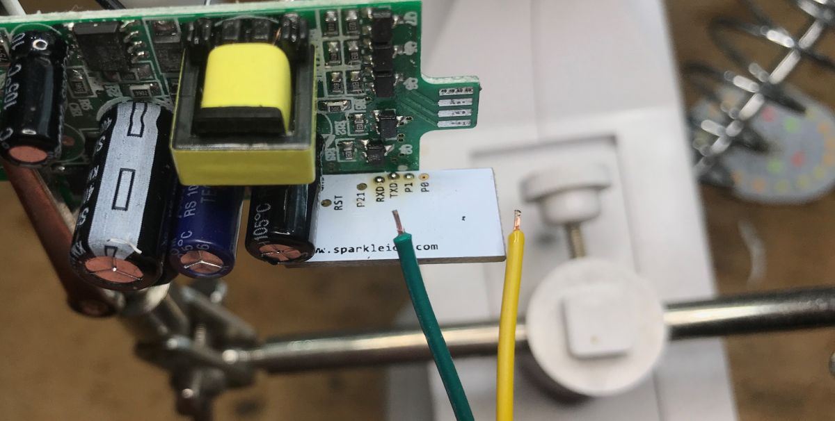

  • 1RX/1TX is silent; 2RX/2TX is debug pair

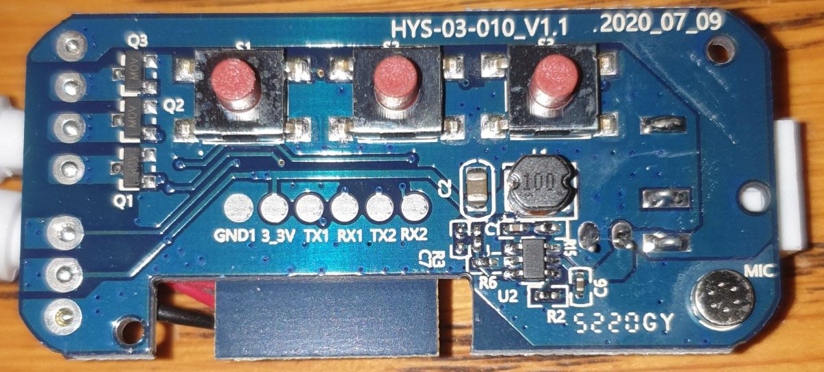

    #338 19928962
    ExploWare
    Posts: 48
    [url=https://obrazki.elektroda.pl/1253291800_1647181419.png][img]
    Just to be sure, left is 1RX/1TX and right is 2RX/2TX, correct?
    And it shows 1RX is as good as silent, that is my experience also. It is treating the 2RX/2TX pair as the real log/debug connection.
    Makes sense since the 1RX/1TX can be connected to peripherals and if that device would receive the debug garbage it would mess that up. (Imagine an LED connected to the TX1, it would just randomly blink for the user)
    You will only know whether the 1RX/1TX pair is connected correctly, if you can initiate a read connection, for example with the bkwriter tool.

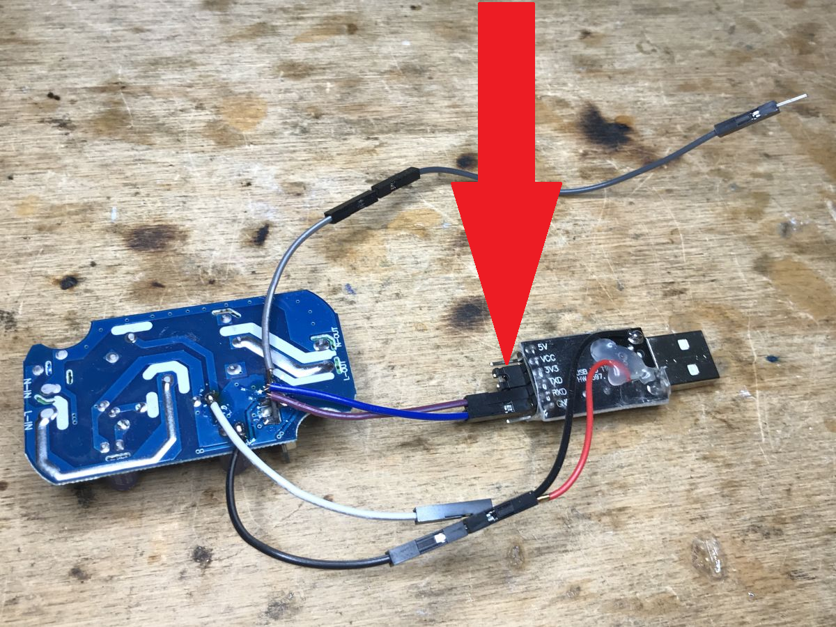

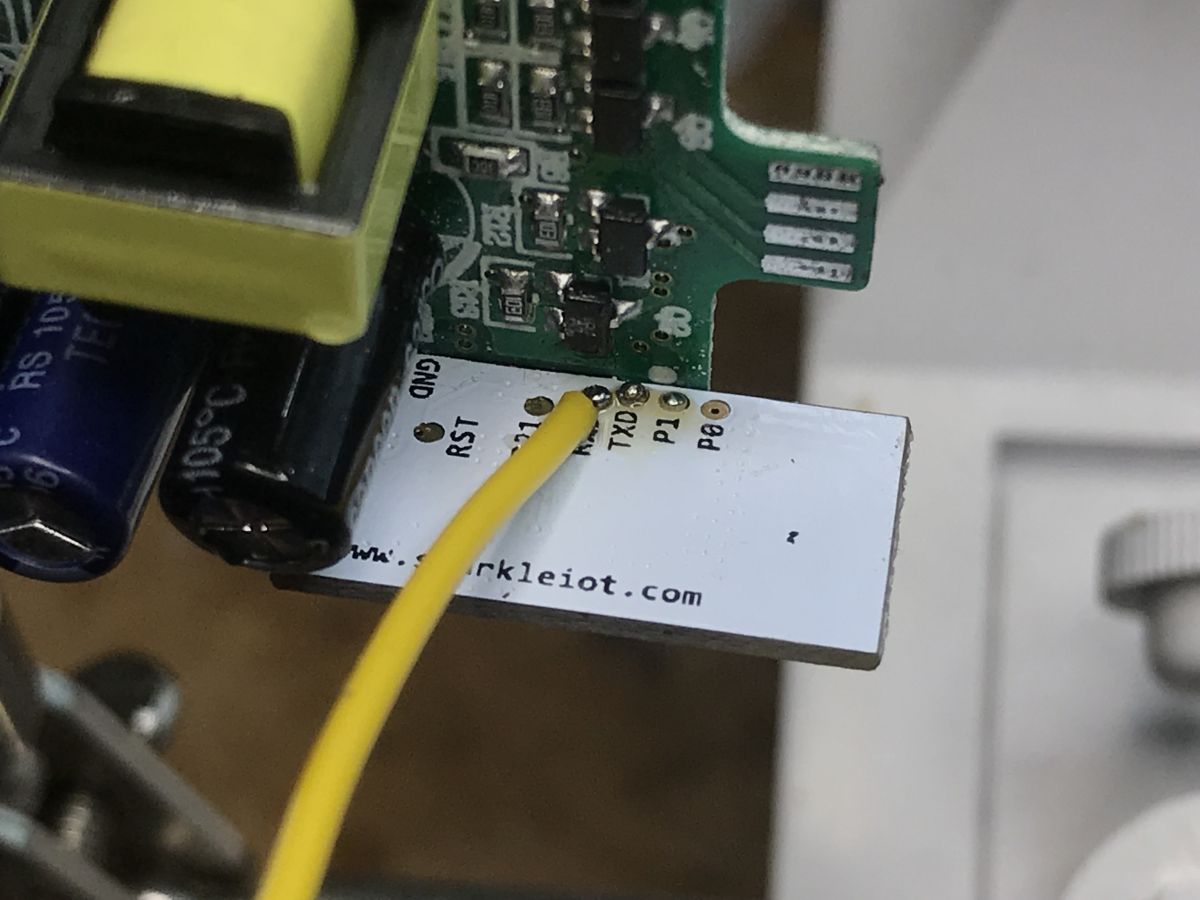

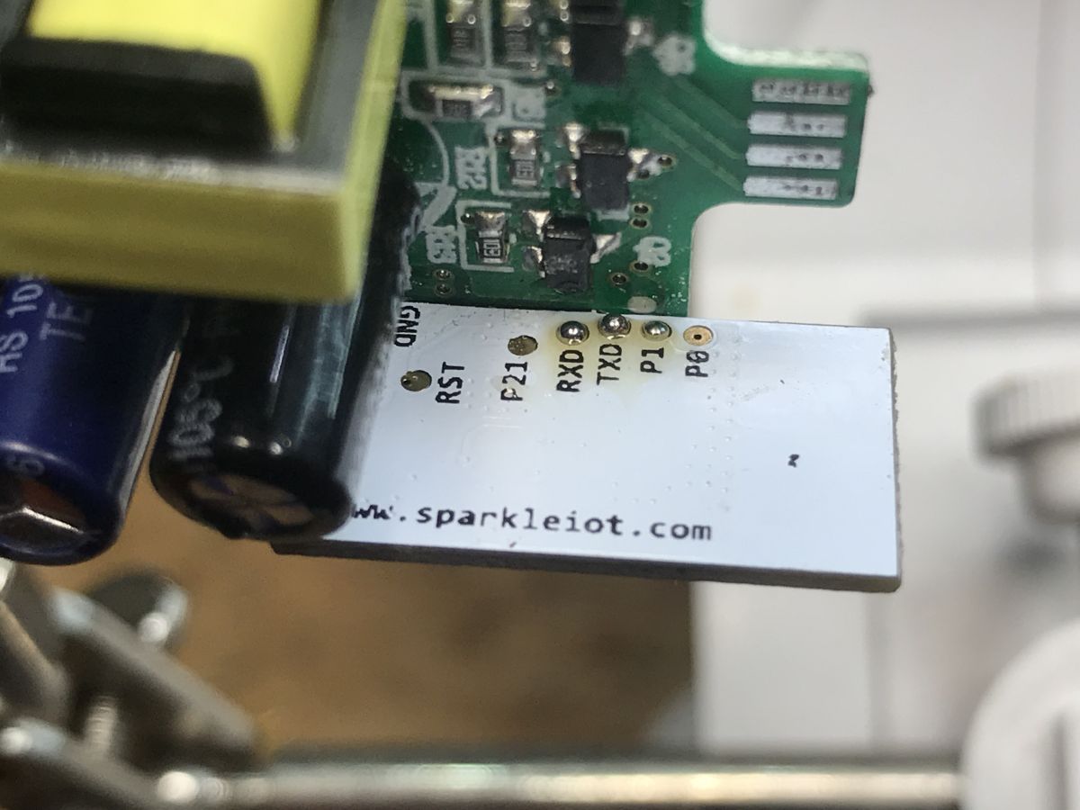

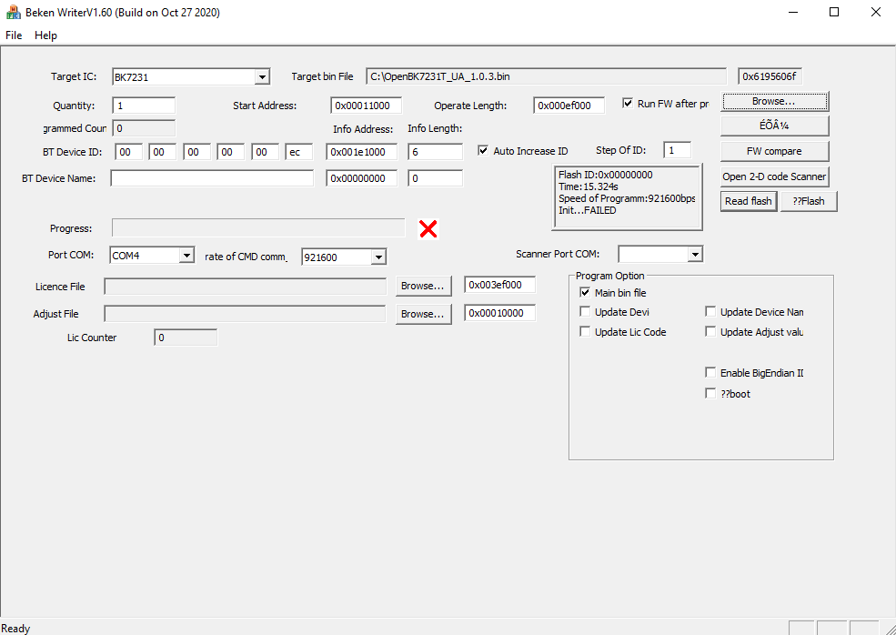

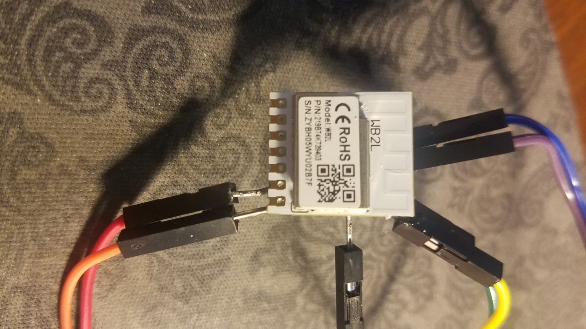

  • UART downloader cannot get bus on BK7231T
    #339 19930002
    pepesuriano
    Posts: 33
    Ok I will share what I see with bkwriter and python:
    (Tested 115200 and 1500000 also in bkwriter)
    python:
    python3 uartprogram -d /dev/ttyUSB0 -r dump.bin
    UartDownloader....
    Read Getting Bus...
    Cannot get bus.
    Traceback (most recent call last):
    File "/tmp/hid_download_py/uartprogram", line 56, in <module>
    downloader.read(args.filename, args.startaddr, args.length)
    File "/tmp/hid_download_py/bkutils/uart_downloader.py", line 83, in read
    self.pbar.close()
    AttributeError: 'NoneType' object has no attribute 'close'
    On both cases, I started reading flash, and then cut power/plug again and also tried with CEN to GND reset. I never get a measure...
    For the moment the plug is fine, I can manage it in tuya app so it's not fried.

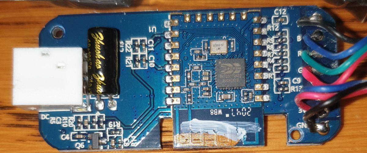

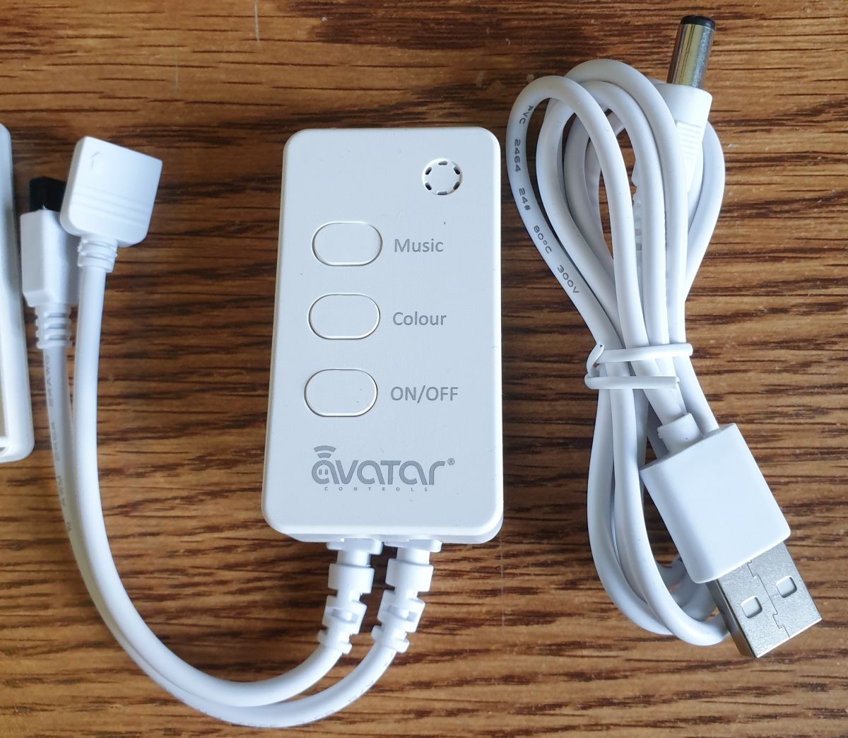

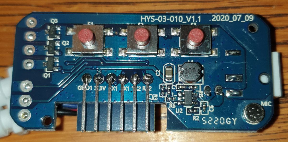

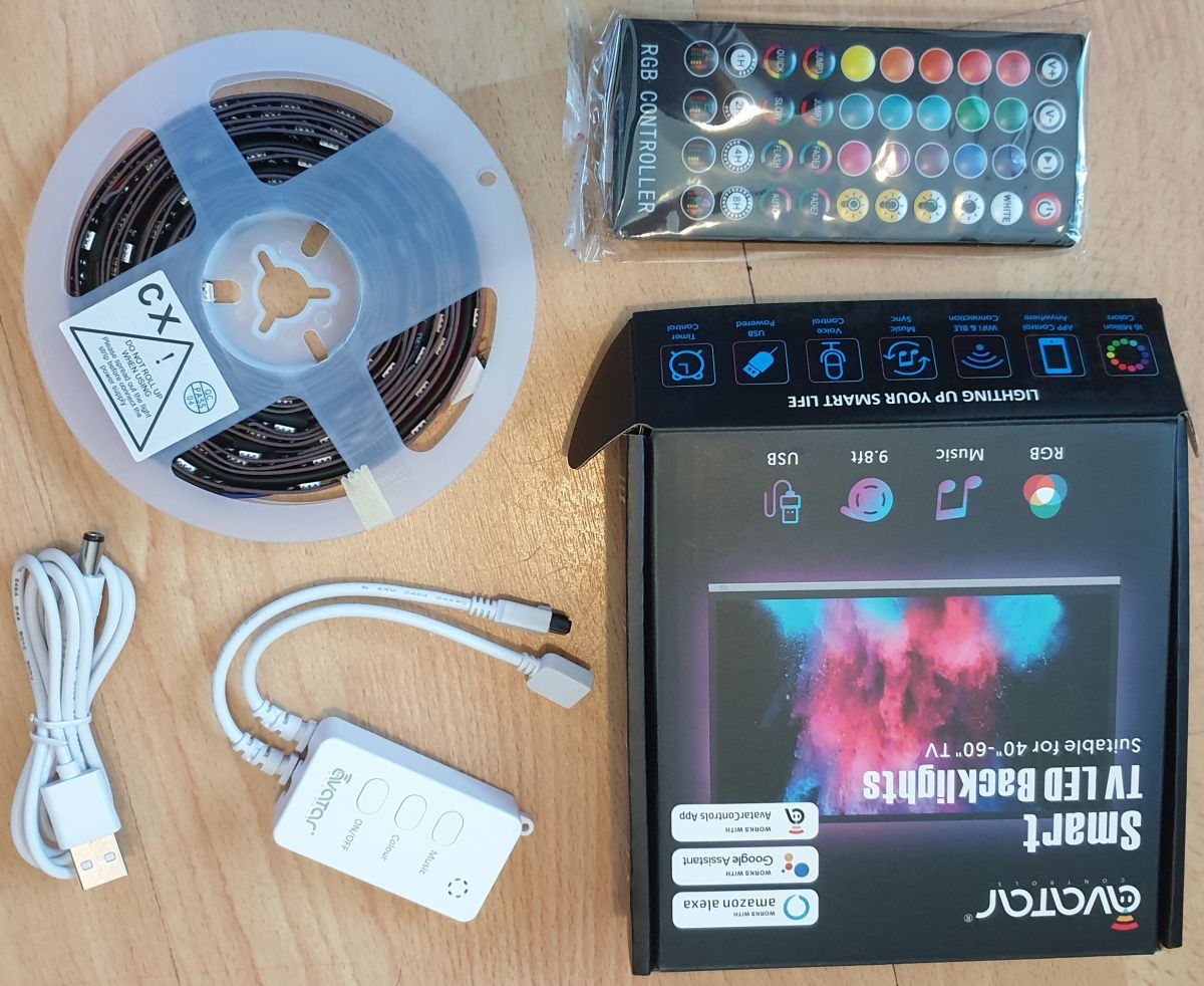

  • BK7231T pinout for Avatar ASL04 LED strip conversion
    #340 19932845
    btsimonh
    Posts: 66
    Rate: 14
    Another successful conversion.
    Avatar ASL04 5v LED strip (TV backlight).
    It comes with a multi-segment RGB strip, about £12 from Amazon delivered in the UK.
    avatar.bin is the flash dump (0x11000 onwards).
    bootlog.txt the original boot log.
    Beken based WB8 module (not documented by Tuya, but similar toWB3L in form factor).
    The unit I received has an issue with the power lead (does not always make a good connection), but apart from that, build quality is good.
    pins:
    P24 -> PWM (red)
    P6 -> PWM (green)
    P8 -> PWM (blue)
    P7 -> btn - music
    P9 -> btn - colour
    P14 -> btn - on/off
    P16 -> IR?
    Images:
    [BK7231T] My HTTP server, configurator, MQTT support from Home Assistant [BK7231T] My HTTP server, configurator, MQTT support from Home Assistant [BK7231T] My HTTP server, configurator, MQTT support from Home Assistant [BK7231T] My HTTP server, configurator, MQTT support from Home Assistant [BK7231T] My HTTP server, configurator, MQTT support from Home Assistant
    With latest OBK firmware, it performs well for command color #rrggbb
    Buttons can be configured as individual control of red, green, blue....
    The unit has a microphone on it for 'sound to light' - yet to implement or determine pin, but the beken SDK comes with an audio driver, and also with an FFT driver (and hardware?), so let's see....
    br, btsimonh :).

  • BK7231T flash read failing despite baud and reset attempts
    #341 19934013
    pepesuriano
    Posts: 33
    python:
    UartDownloader....
    Read Getting Bus...
    Cannot get bus.
    self.pbar.close()
    Any suggestions on why I have these messages in BK writer and Python? It's still not working to read or program

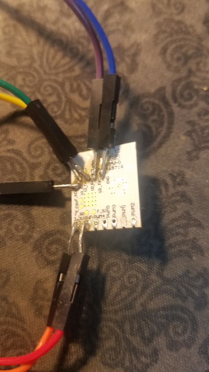

  • 3.2 V on TX1 but bk writer still fails
    #344 19934898
    pepesuriano
    Posts: 33
    btsimonh wrote:
    Hi pepesuriano,
    1/ pls confirm you have seen debug logs on the other port.
    2/ re-check your connections - GND, TX & RX.
    3/ try reversing TX & RX.
    4/ sometimes it takes me two or three power-restarts to get a read (sometimes having to restart python in between if it has already timed out).
    The error from uartprogram is just it trying to close the non-existent progress bar (me being lazy, PRs welcome). The failure is that the programmer is not getting a response.
    Basically, it continually sends bytes at startup for 5(?) seconds, and only if it gets a response, then changes the baud rate from 115200 to the selected rate by sending a command to the device. So your failure is at the start phase, not after baud rate change. i.e. as long as it has the same bootloader (not guaranteed, but probable?), then your issue is one of basic serial communication or an electrical problem (incorrect GND, RX/TX line short to ground/somewhere, etc?).
    let us know how you get on,
    br, Simon
    I will answer point by point:
    1- Yes, I confirm I can see debug logs on RX2/TX2
    2- Done, GND is ok and RX1 goes to TX of UART adapter and TX1 goes to RX of UART adapter
    3- Already checked, and I also tried different UART adapters
    4- Yes I read about that, but I tried almost 10 times (each time before posting here was 10 tries, and there are multiple posts :P) and it always shows as my previous pictures
    5- Tested with multimeter and RX1/TX1 are not shorted to ground
    Also, when I put CEN to GND I see some symbols on RX1/TX1 serial console, but it is not possible to read flash anyway... and I can see how it reboots on logs of debug port (RX2/TX2) but still bk writer says "Init... FAILED" or "AttributeError: 'NoneType' object has no attribute 'close'
    " on python
    P.D.: one more test, I had put a multimeter and I have 3.2x volts between TX1 and GND
  • Requesting first 20 debug log lines and chip type
    #345 19934959
    btsimonh
    Posts: 66
    Rate: 14
    How close are these logs (at least in the first few lines) to the log I posted from another device above?
    pls. post the first 20 lines of the log....
    (I'm not saying it will help! but if it is a different bootloader, then maybe it will show something.....)
    Which Beken chip is it? (n or t/s)?
    If you can't get serial to go, then there is the option of SPI... it's much more complicated and you do need a raspberry pi, access to the 4 SPI pins on the wifi module, etc :(.
    Else we have a few more weeks for the wifi OTA hack to come through - just make sure it does not receive a firmware update from Tuya (unlikely).
    :( simon
  • Suspect FTDI power issue; try Raspberry Pi UART port
    #346 19935590
    absinth84
    Posts: 7
    pepesuriano wrote:
    btsimonh wrote:
    Hi pepesuriano,
    br, Simon
    " on python
    Can you try with raspberry and its uart port.
    I have had many problems for not enough power from FTDI.

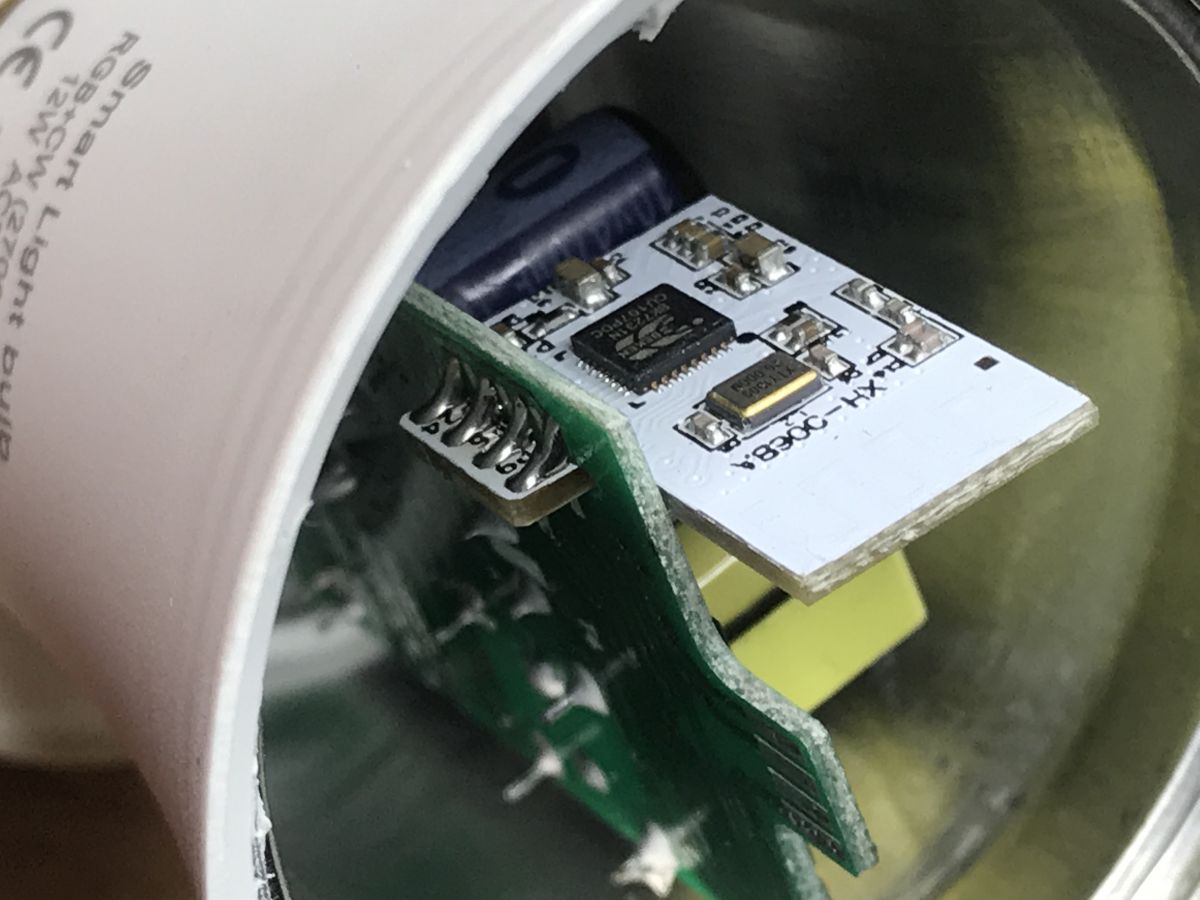

  • BK7231S boot log suggests unsupported chip variant
    #347 19936485
    eakeyson
    Posts: 8
    eakeyson wrote:
    I am trying to flash a WB2L module with OpenBK7231T firmware. Relatively new here but have successfully flashed several ESPs with Tasmota.
    I can successfully flash with python CLI and 1st time, I did get AP and successfully configured WiFi and MQTT using OpenBK7231T_App_UA_1.0.0.bin. At first reboot after successful flash, all went away and now I can't get AP again despite flashing again several times. I have tried all of the pre-compiled binaries in the repo with no success. I have also double checked all the connections and confirmed absence of pull-up or pull-down resistors on pins.
    Here is the log output after boot:
    V:BK7231S_1.0.5
    CPSR:000000D3
    R0:77EDF0F6
    R1:2331136B
    R2:EED6FE63
    R3:5DB35B52
    R4:DF4B6338
    R13:732CE97F
    R14(LR):BCFF93B7
    ST:D1662661
    J 0x10000
    prvHeapInit-start addr:0x41ca60, size:144800
    [bk]tx_txdesc_flush
    Entering init log...
    Init log done!
    bk_pwm_stop:98
    Any suggestions on what to do next? Is this a BK7231S chip and not supported? Was the first time a fluke?
    Anybody have any suggestions for me on this? I seem to be stuck...
  • UART power issues suspected; SPI flashing may be needed
    #348 19936488
    pepesuriano
    Posts: 33
    :( simon
    It seems quite similar, here you have it:
    V:BK7231S_1.0.5
    CPSR:000000D3
    R0:D7EFFAFA
    R1:FE587B37
    R2:D2DCB351
    R3:BE6D65DF
    R4:3E0A3E9E
    R13:FFD5775F
    R14(LR):76F6F99D
    ST:04870CAC
    J 0x10000
    prvHeapInit-start addr:0x420030, size:131024
    [01-01 18:12:15 TUYA Info][mqc_app.c:175] mqc app init ...
    [01-01 18:12:15 TUYA Info][sf_mqc_cb.c:42] register mqc app callback
    [01-01 18:12:15 TUYA Debug][mqc_app.c:118] mq_pro:5 mqc_handler_cnt:1
    [01-01 18:12:15 TUYA Debug][mqc_app.c:118] mq_pro:31 mqc_handler_cnt:2
    [01-01 18:12:15 TUYA Debug][uni_thread.c:215] Thread:sys_timer Exec Start. Set to Running Status
    [01-01 18:12:15 TUYA Debug][log_seq.c:732] read from uf. max:1 first:1 last:0
    [01-01 18:12:15 TUYA Debug][svc_online_log.c:288] svc online log init success
    [01-01 18:12:15 TUYA Err][tuya_ws_db.c:314] kvs_read fails gw_bi -1
    [01-01 18:12:15 TUYA Err][ws_db_gw.c:111] gw base read fails -935
    [01-01 18:12:15 TUYA Debug][tuya_bt_sdk.c:89] ty bt cmmod register finish 1
    [01-01 18:12:15 TUYA Debug][tuya_ble_api.c:301] ble sdk inited
    !!!!!!!!!!tuya_bt_port_init
    I have a bus pirate and a SOIC8 clip if you want to try SPI, is there any documentation for it?
    I don't have a RPI, but I tried with and arduino UNO, and it's not working just like with the PL2303...

    @pepesuriano this is getting very strange. I'd recommend again trying the USB to TTL HW597 which I trust. If it still not working, then I'd bet that you still have some trivial mistake or error or something on RX or TX pin. The next thing i'd try (but I don't recommend it) would be desoldering whole chip (WB2S module?) with hot air and checking if it works outside the board.
  • Suggesting USB-TTL adapter and checking RX/TX wiring
    #350 19936523
    pepesuriano
    Posts: 33
    Ok I will show a picture to explain the best as I can:
    I guess that this is very clear (TX1 to RX on UART adapter, RX1 to TX on UART adapter, and 5v/gnd to AMS1117 direct from USB port.
    Cheers

    eakeyson
    Posts: 8
    Nope. Still doesn't work for me.
    Compiled new app and wrote flash with new OpenBK7231T_App_UA_1.0.0.bin file. Output log is the same. Reprinted here:
    V:BK7231S_1.0.5
    CPSR:000000D3
    R0:77EDF0F6
    R1:2331136B
    R2:EED6FF63
    R3:5DB35B52
    R4:DF4B6338
    R13:F32BE97F
    R14(LR):BC7F93B7
    ST:D1662661
    J 0x10000
    prvHeapInit-start addr:0x41ce90, size:143728
    Init log done!
    Commands registered!
    [bk]tx_txdesc_flush
    bk_pwm_stop:98
    Then it hangs. No AP is started. Any further suggestions?
    Thanks for the help...
    Cheers
    Where did you get those clips to attach the Dupont cables to the PCB?

    ExploWare
    Posts: 48
    @pepesuriano my only advice is to link the GND from UART and USB powerline you feed into the AMS. The regulator on the serial might have a floating gnd (good from a safety perspective)

    @eakeyson would it be possible that your SSID or pass was longer than 64 characters?
    Are those demos working for you?
    https://github.com/openshwprojects/OpenBK7231T/tree/master/apps/obk_demo_openAccessPoint
    https://github.com/openshwprojects/OpenBK7231T/tree/master/apps/obk_demo_scanNetworks
    pepesuriano wrote:
    Where is the 3.3V logic levels selection jumper (assuming that's the USB to TTL converter similiar to the one I am using)?

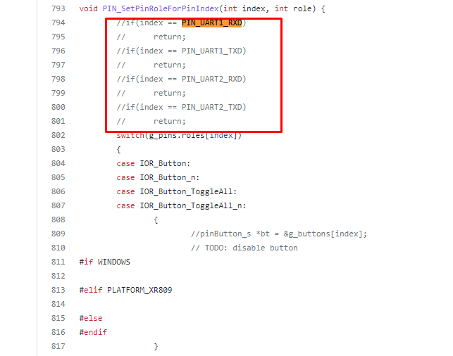

  • UART log stops after pin load, suggesting TX pin reassignment
    #358 19941264
    eakeyson
    Posts: 8
    eakeyson wrote:

    Latest version of the app with recent repository changes hangs as before. I made the changes to logging.h with
    "#define DEFAULT_DIRECT_SERIAL_LOG 1" as you suggested and got the log:
    V:BK7231S_1.0.5
    CPSR:000000D3
    R0:77EDF0F6
    R1:2331136B
    R2:EED6FF63
    R3:5DB35B52
    R4:DF4B6338
    R13:B329E97F
    R14(LR):BCFF93B7
    ST:D1662661
    J 0x10000
    Init log done!
    Debug:CMD:Adding command loglevel
    Debug:CMD:Adding command logfeature
    Debug:CMD:Adding command logtype
    Debug:CMD:Adding command logdelay
    Debug:CFG:flash vars not initialised - reading
    Debug:CFG:new offset after read 540, boot_count 66, success count 0
    Info:CFG:####### Boot Count 67 #######
    Debug:CFG:new offset 548, boot_count 67, success count 0
    Debug:CFG:new offset after read 548, boot_count 67, success count 0
    Debug:CFG:re-read - offset 548, boot count 67, boot success 0, bootfailures 67
    [bk]tx_txdesc_flush
    Info:GEN:PIN_LoadFromFlash called - going to load pins.
    Info:GEN:UART log breaking after that means that you changed the role of TX pin to digital IO or smth else.
    bk_pwm_stop:98
    It still hangs but I think it's something like @btsimonh said above. Now how to fix...

  • Comment out UART pin role changes to prevent boot failure
    #359 19941314
    Posts: 14724
    Rate: 12806
    eakeyson wrote:
    Yes, when I did get it to boot the first time I did try to configure some pins. It acts like it still sets that configuration which prevents it from booting.
    There is a simple check that prevents config from disabling UART pins, that is commented out right now.
    https://github.com/openshwprojects/OpenBK7231T_App/blob/main/src/new_pins.c
    if you uncomment those lines, config and web page won't be able to change roles of pin P0, P1, P10 and P11:
    Of course, everything here is under assumption that you're getting silence because you've set UART pin role to something else...
    but try, uncomment shown lines, recompile, flash and give us full log.
    In the past, there was also a real boot crash/hang issue but I think it's fixed since several days (I hope)
  • UART pin reassignment should not block access point mode
