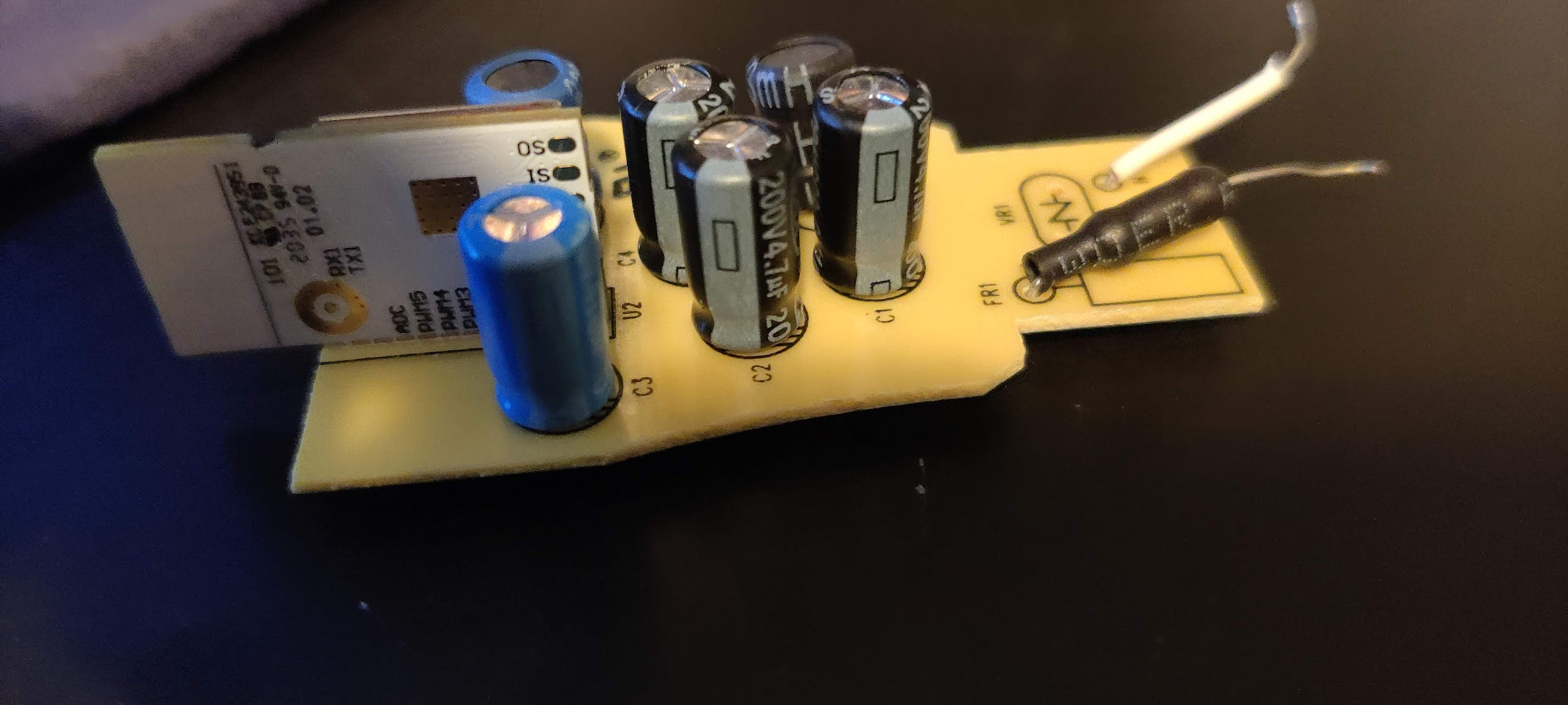

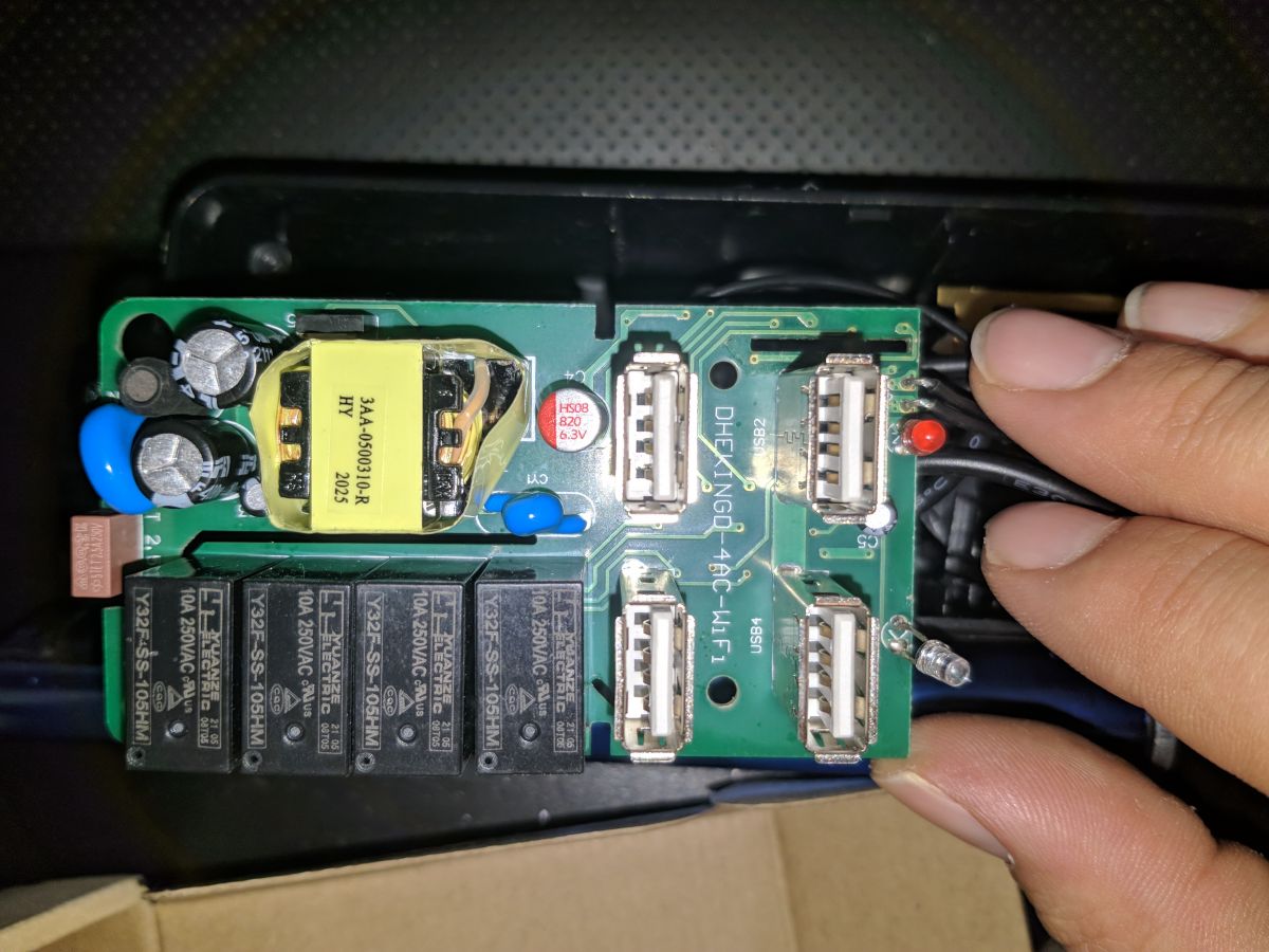

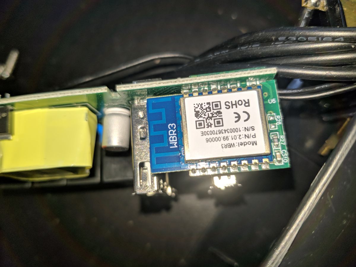

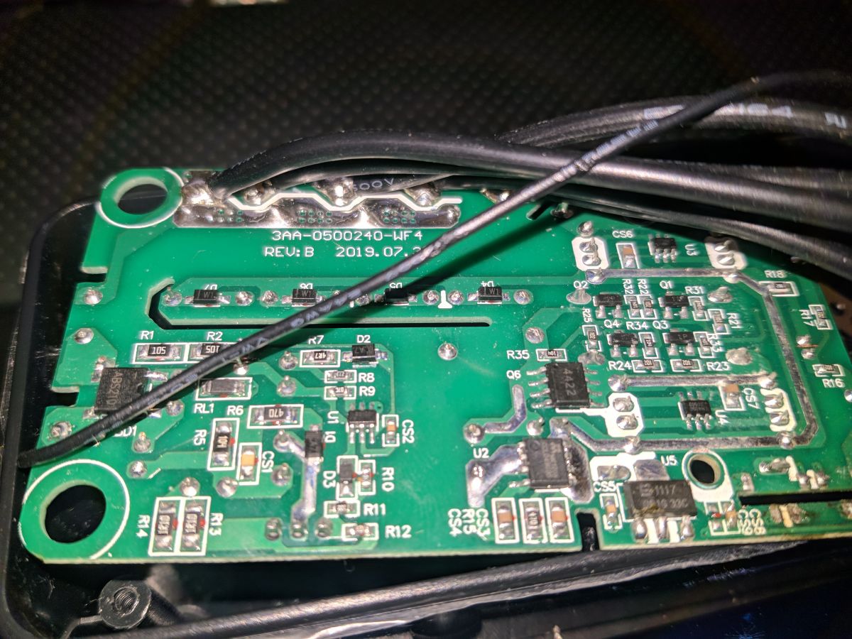

  • WBR3-based power strip may be OpenBeken port candidate
    #486 19993614
    opfer15
    Posts: 8
    Hi,

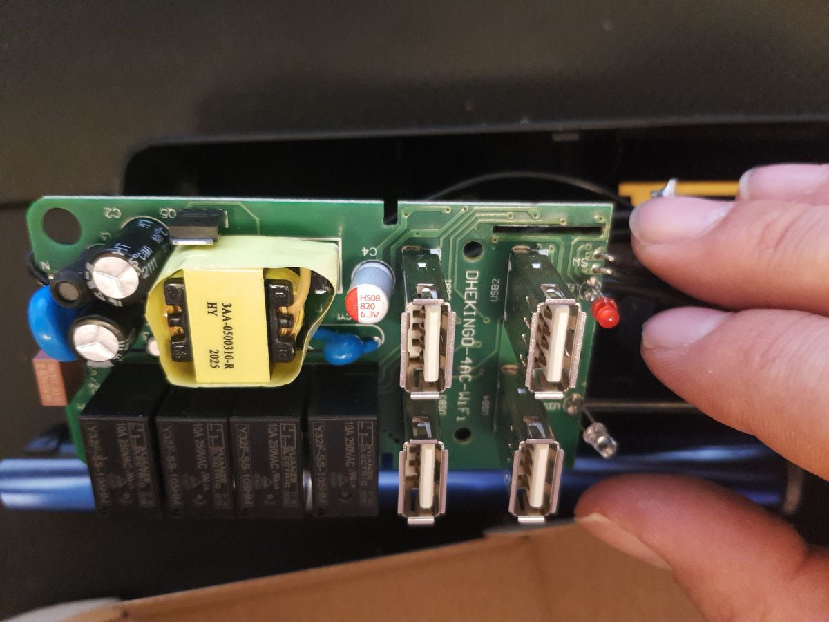

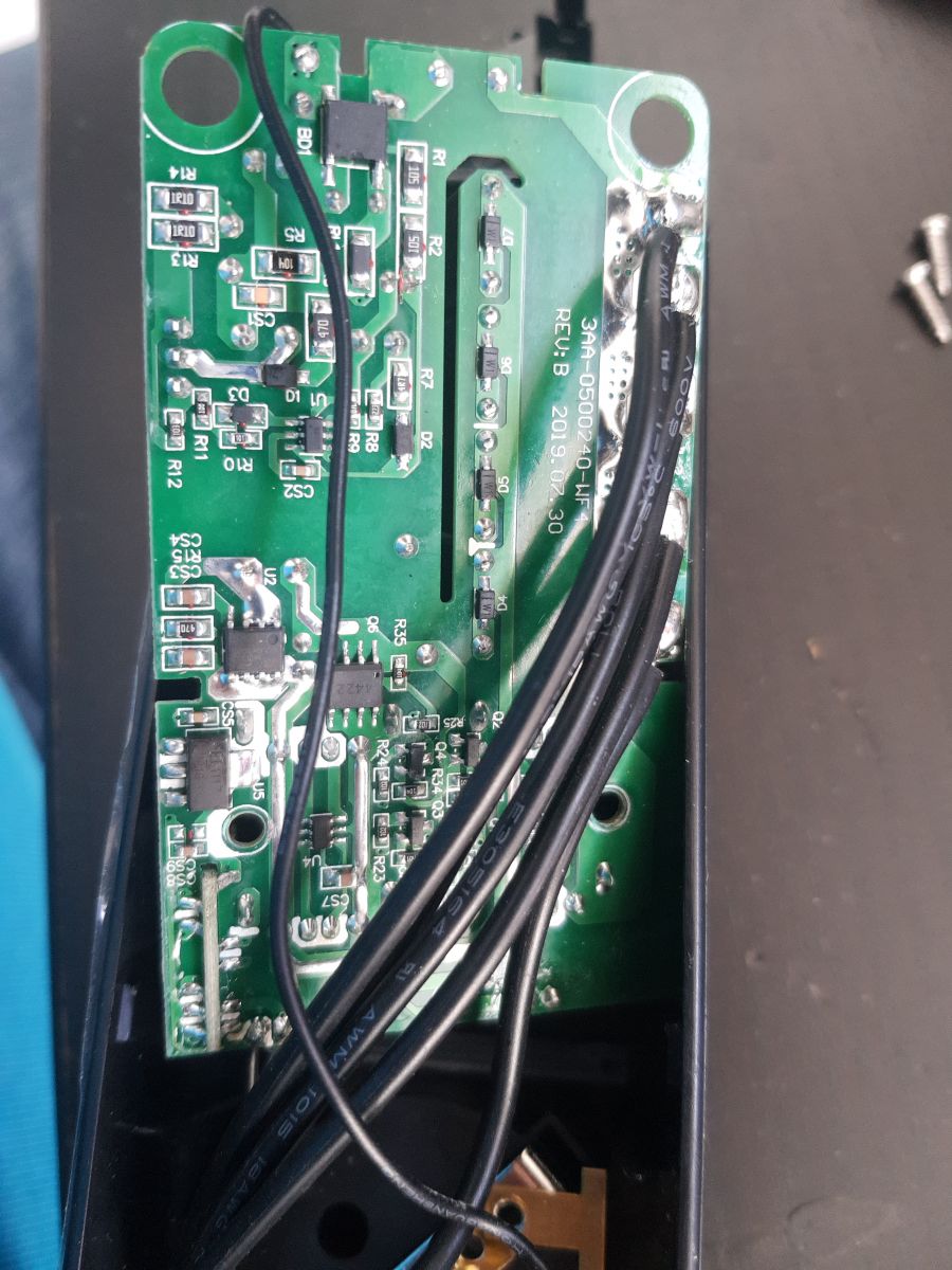

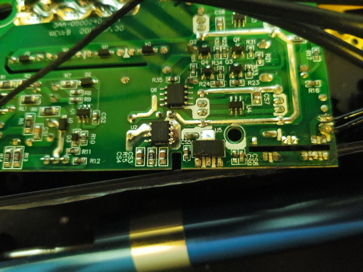

    bought YITOM Smart Power Strip on aliexpress. Turns out the power strip uses a WBR3 to control the sockets. WBR3 is using an RTL 8720cf which is hopefully similar to the RTL8710 so we could maybe have an easy port of OpenBeken to integrate these devices into HA :)
    It doesnt use the connectors on the bottom of the WBR3 PCB so it also could be easily replaced with an esp 12f
    PCB serials for google indexer:
    Main PCB Serials: 3AA-0500240-WF4 REV:B 2019.07.30
    PCB WBR Daughter Board 3AA-WF4AC-WF Rev B 2019.07.30
    hope this is the right thread for this post. Sry for the links. but the system insistet to trick it :')
    Power Strip: aliexpress com/item/1005002454805802.html
    GCC SDK: amebaiot. com/en/amebad-bw16-arduino-getting-started
    Arduino Lib: github. com/ambiot/ambd_arduino
    SDK: github com/ambiot/ambz2_sdk
    WBR3 Modul: developer. tuya. com/en/docs/iot/device-development/module/wifibt-dual-mode-module/wbr-series-module/wbr3-module-datasheet?id=K9dujs2k5nriy

    @opfer15 that's a useful information, I would like to support this platform, but the whole strip costs a lot. Did you do a transplant for ESP12F? Do you still have WB3R left? I don't have any Realtek chips at hand so my Realtek development has come to halt.
  • AmebaZ2 needs separate SDK support

    @opfer15
    This chip is AmebaZ2. Other SDKs like ambd_sdk are not compatible and will not work. I'm preparing to better support these chips in my project.

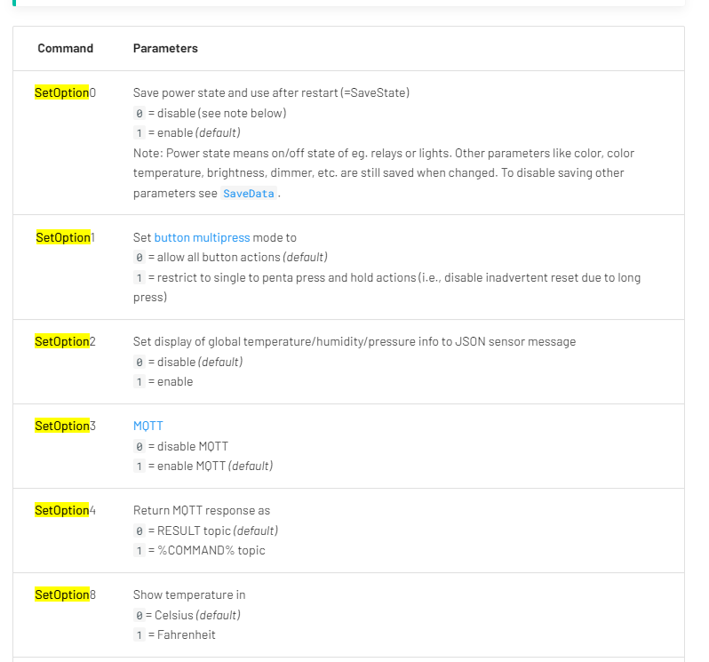

    I'm sorry but programming doesn't work by copying file named "tasmota.ui" and getting the same interface as Tasmota. It's not that simple. Futhermore, I am actively designing project to meet the current needs of devices that are popular and adding features according to the requests of the users. I have two donation boxes of smart devices on way to me in order to support them. Copying stuff directly from Tasmota would just break things, as I have much better ideas how to handle certain things.
    For example:
    Do you really think that "SetOption12" is an intuitive name for console command and end users are able to easily remember what they have to type in order to, let's say, get their buttons working?
    Or their TuyaMCU implementation... it's a mess.
    I have a very clear path for OpenBeken in mind, along with multiple useful and flexible scripting features that will cover most of the use cases.
    @bole5 have you ever heard that one of the most common mistakes in software projects is to maintain a design that is obsolete, convoluted and spending lots of time to debug "spaghetti code" instead of doing a clear rewrite? It's not that I have to reverse enginer things from scratch, I can still use other projects as reference.
    It's better to understand the functionality and implement it clearly, instead of copying it blindly like some high school student.

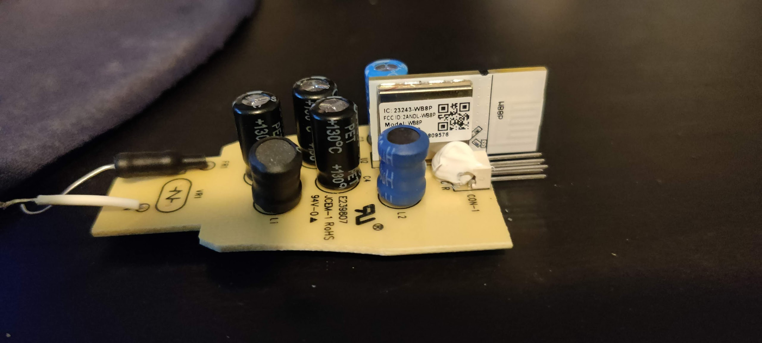

  • WB3R modules offered for testing and support
    #491 19994064
    opfer15
    Posts: 8
    Still have the WBR3 Modules. As they're most likley not useable to any of us without a HA compatible FW i have to swap them at a given time and probably loose some of the feature set. There is also the possibility to swap it with an esp32-C3, which i just ordered 2 modules of. But as you statet (on github i think) it's a waste of a good mcu and i don't like the idea to waste them too :)
    If you wanna work on it, i'll send you a parcel with one or two WB3 modules. GER to PL is just 5€. Or if you want to support the strip in total, i'll send you 10 bucks so it ain't that expensive anymore.

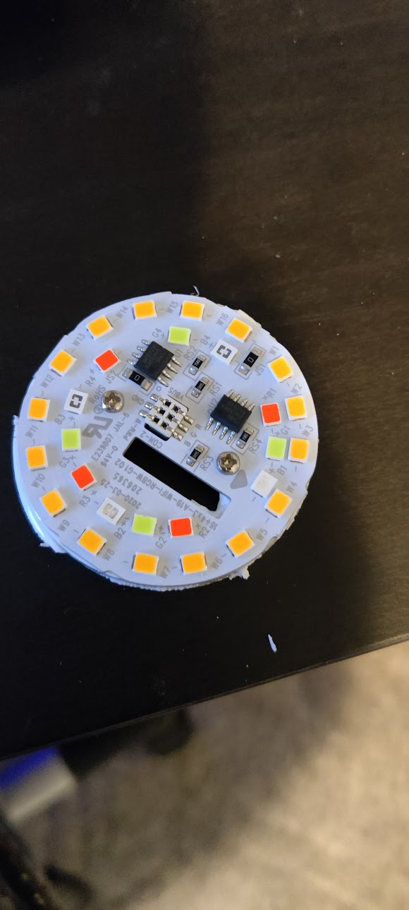

    I also have an ATCOMM LED bulb with a BL-200 Chip. Which has the formfactor of an ESP but definitly isn't (only 2 Pins connected) as i already ripped it out of its bulb case to check the chip and there is no google information out there for this chip, you could also take a look at it if you want to.
    ATCOMM CWWW (RGB) bulb: aliexpress .com /item/4000162934304.html
    ATCOMM led daughter board serial : LT-6335 - RGBCW XLD-W60-2.2
    Main PCB XLD-QFLWP-BP-3.2.1

    opfer15
    Posts: 8
    It would be better to get modules, as you don't have a use of them anyway. I also don't trust aliexpress much because in last year it started having more common tax issues. I am not sure if "over 20$ has no customs" rule still applies, I am not up to speed with the import tax duties. I buy my stuff on Bg with shipping from Czech.
    Banggood and Aliexpress take care of tax and customs since 1.6.2021 (eu e-commerce policy) it's calculated in the price you pay on ali. atleast its for germany but that should count for every other EU country.
    send you a PM. Yeah ESP-12F/ESP32-3C-12F are Pin compatible to WBR3

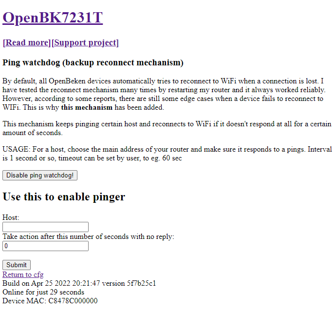

  • Ping watchdog added to force WiFi reconnect
    #499 19995470
    Posts: 14724
    Rate: 12806

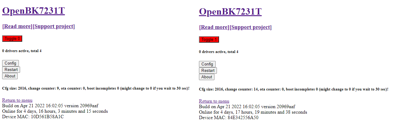

    sebastian48 wrote:
    - On the same day I power cycle the other device (which then hooks up to the system, both devices working) the first one crashes and stops responding. Physical button still working.
    The devices are listening to network events and automatically reconnects to WiFi when disconnected. I have tested it many times by turning off the power of my router and/or by restarting it and it worked every time reliably.
    Still, I am unable to test all possible scenarios and I suspect that the "crash" (or should you rather say, the disconnection from WiFI, because button is still working) is related to some WiFi bugs, maybe caused by overlapped WiFI channels, so I have decided to add extra failsafe just for you.
    This is always DISABLED by default, you have to enable it per device.
    It's called "ping watchdog", it pings a certain IP (preferrably your router IP) and if it fails to ping it for a given number of seconds, it forces a reconnect.
    Also, did I mention that English BL602 guide has been released?
    https://www.elektroda.com/rtvforum/topic3889041.html
    Btw, my test devices are reaching 5 days uptime:
    it would be even longer if I wasnt updating their firmware (OTA forces a restart)

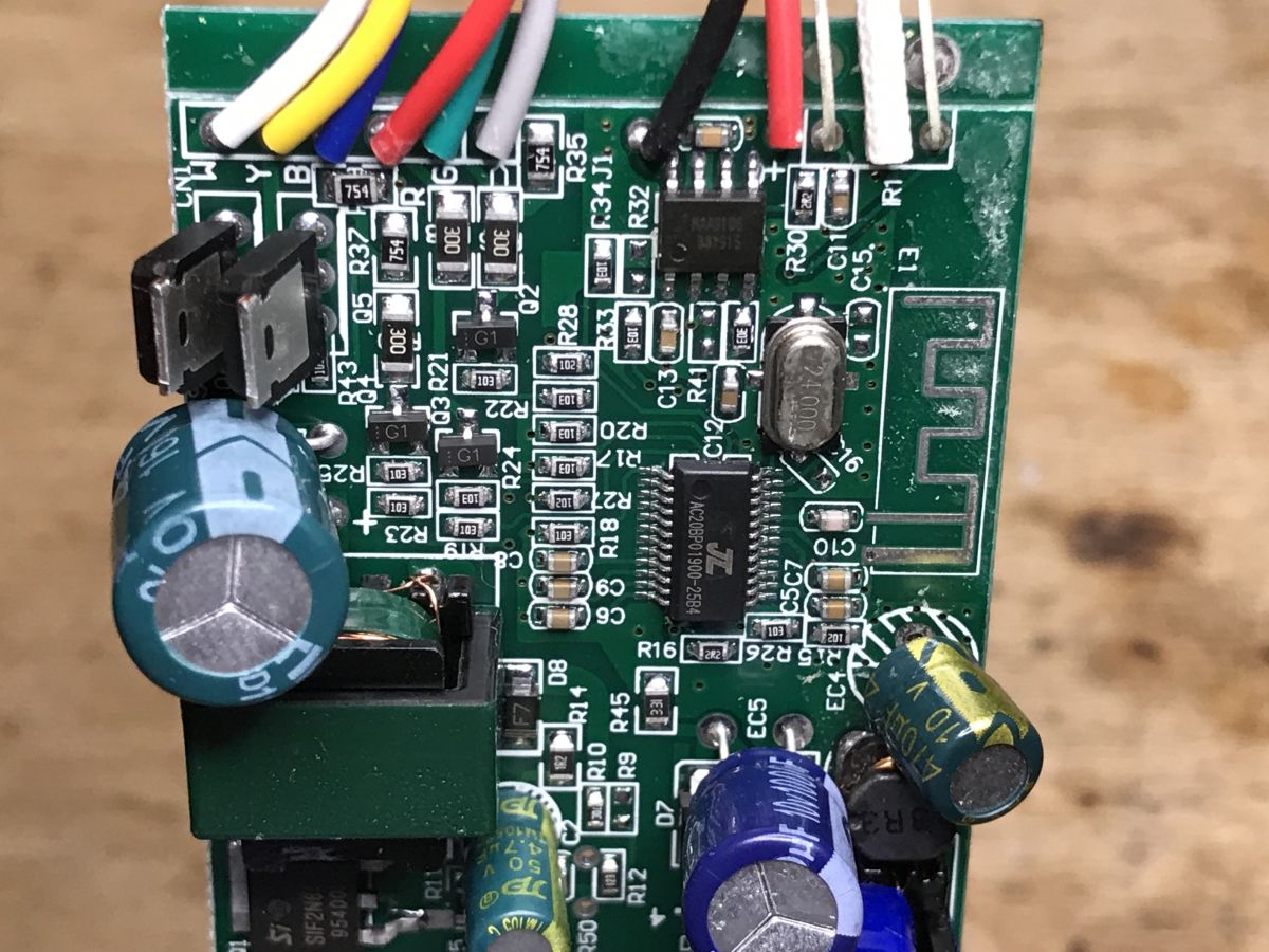

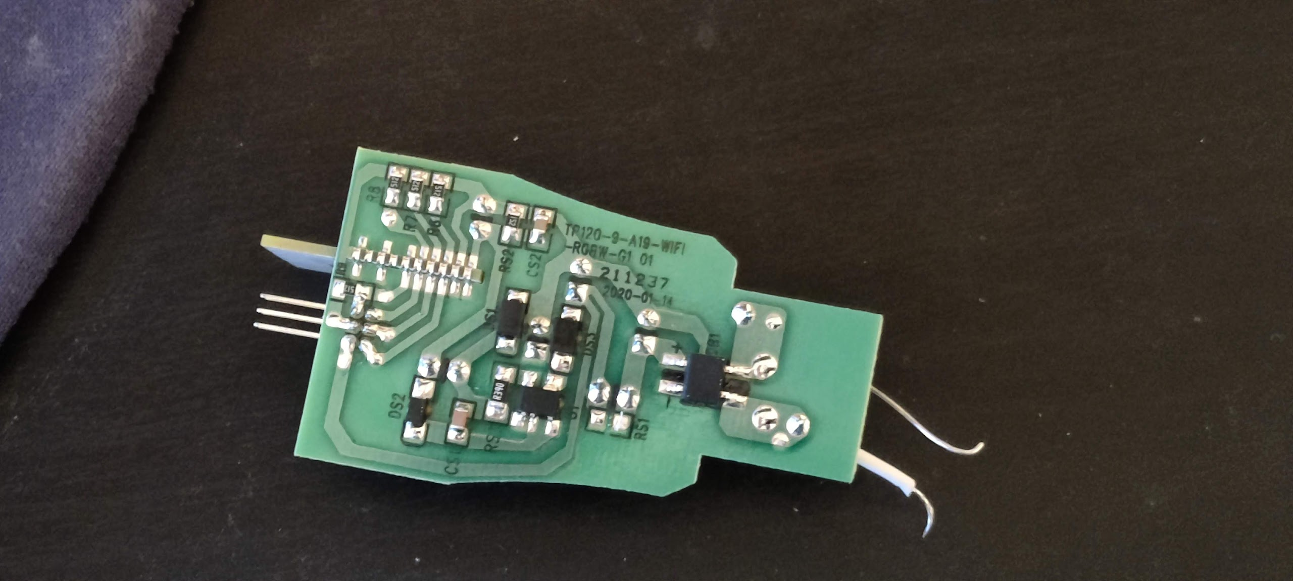

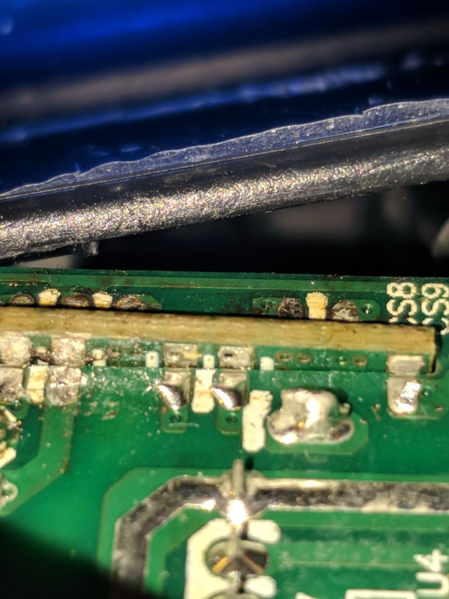

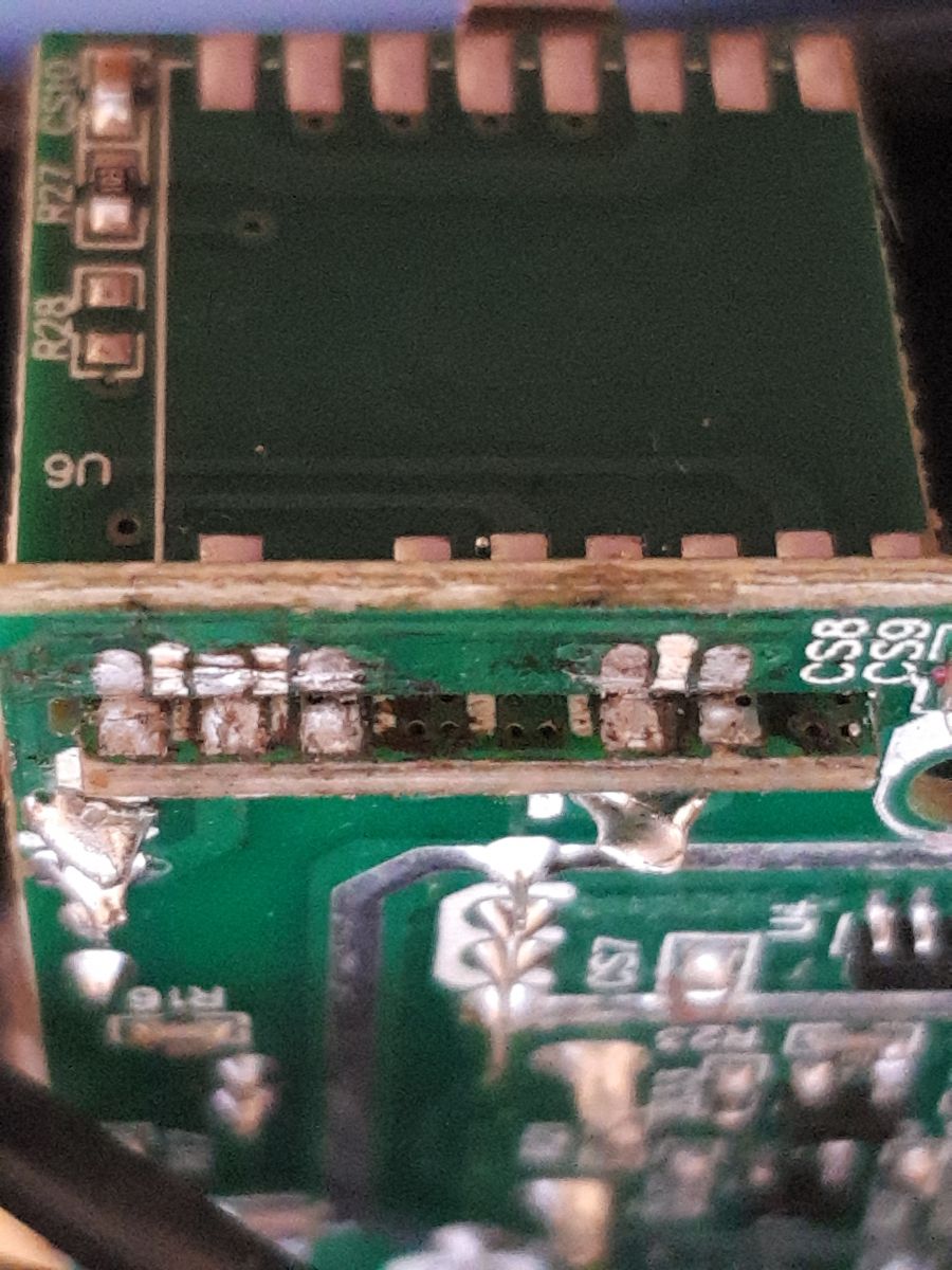

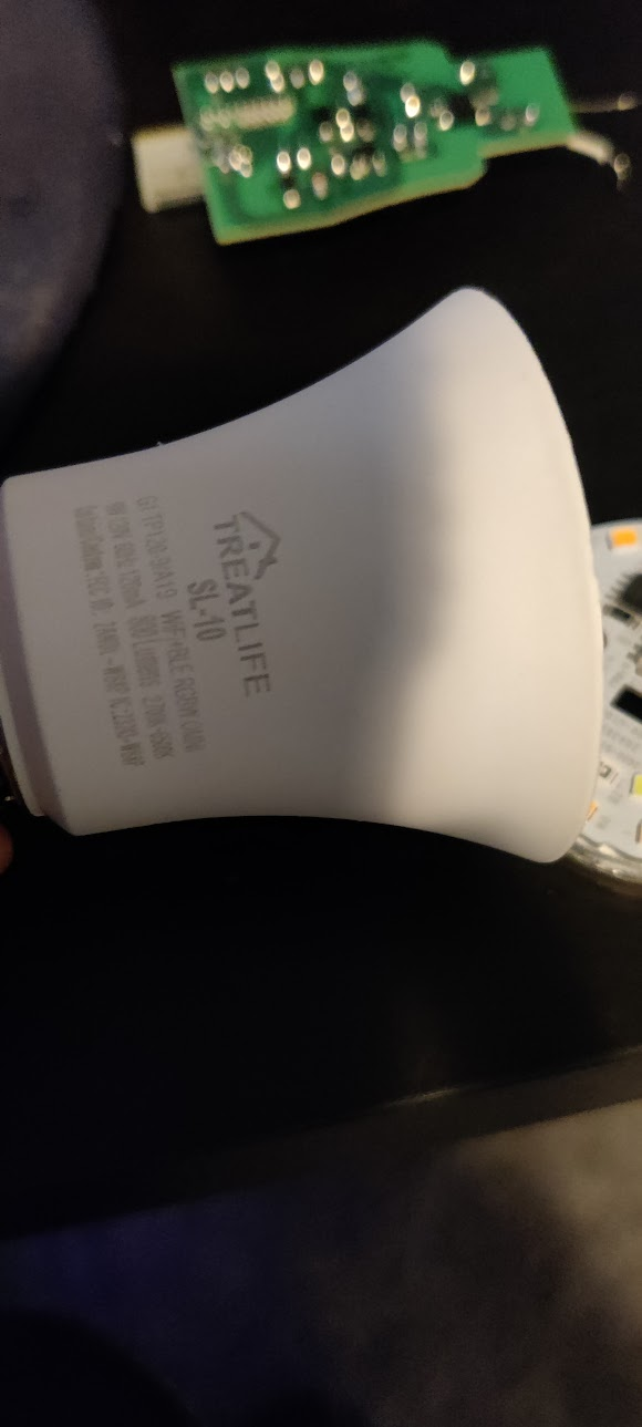

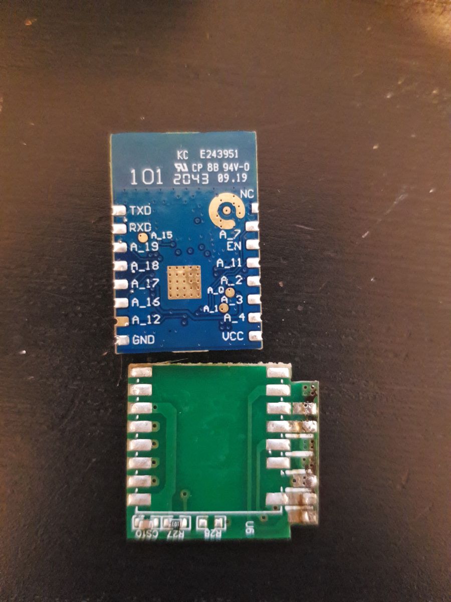

    #500 19995851
    gamerayers
    Here's some images of the Treatlife SL10 I have (I actually have 8 of these). They can be torn down non-destructively. I'm a little concerned about the TXD/RXD and the power pins due to the location of the capacitor if I need to reach the TXD/RXD2, the TXD/RXD1 is weirdly shaped.
    Chip is a WB8P.
    Guessing because this has the extra MCU on the top board, it isn't supported yet.
    [BK7231T] My HTTP server, configurator, MQTT support from Home Assistant [BK7231T] My HTTP server, configurator, MQTT support from Home Assistant [BK7231T] My HTTP server, configurator, MQTT support from Home Assistant [BK7231T] My HTTP server, configurator, MQTT support from Home Assistant [BK7231T] My HTTP server, configurator, MQTT support from Home Assistant [BK7231T] My HTTP server, configurator, MQTT support from Home Assistant
  • #501 19995900
    Posts: 14724
    Rate: 12806
    What is written on those "extra MCUs", are they by any chance I2C controlled?
    I just need to get my hands on one of such bulbs, and I will add support for that. I am trying to find where can I buy single piece of such bulb with good cheap shipping to Poland, but no luck so far...
  • PWM-controlled high-power drivers likely used on the bulbs
    #502 19995911
    kuba2k2
    Posts: 120
    Rate: 13
    I would say these are probably PWM controllers, or rather PWM-controlled high power drivers. I have two bulbs with chips like these, they are connected to PWM outputs of the CPU. As these bulbs drive LEDs in series, with a high voltage like 120V, that controller is needed.
    As for obtaining them, you can get one for example here:
    mediamarkt pl /sport-i-rekreacja/zarowka-led-hama-wifi-e27-rgb - this one is probably based on BK7231T with WB2L
    correct me if posting links here is not allowed

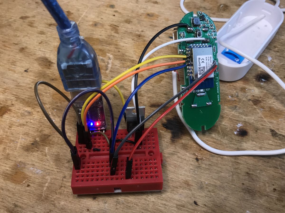

    #504 19996043
    gamerayers
    Wonderful. It will be a little before I can get to pulling the data off of it, but will send it along when I get it.
    Thanks for the info.
    Added after 1 [hours] 51 [minutes]:
    So I've tried to connect directly to the USB, and after reading more, it seems that may not work due to the size of the capacitor, so I will work a little at finding a good method to power it.
    2 questions:
    1. You said you use a 5V power supply, but I'm not entirely sure I should do that since the chip is 3.3v for this. Is there a different area you attach that? Or just use a high current 3.3V power supply separate of the USB?
    2. I am not sure which is send and receive. It is a bullseye style pattern and I might assume RX1 is the center, but there isn't much which identifies which is RX and which is TX. Since it appears this is common, which did you find is RX and which is TX on other chips?
  • Need chip markings and external 3.3V supply
    #505 19996365
    Posts: 14724
    Rate: 12806
    First of all, you haven't replied what is written on the SOIC-8 chips that are alongside the LEDs. It would be good to know, because @kuba2k2 could be wrong and if that's a I2C driver, then it still needs to be implemented. I would do I2C driver for those chips quickly, but I don't have such bulb at hand.
    For programming, you should follow one of the guides from the Teardowns sections.
    Never connect 5V directly to WB modules. I used to connect 5V to AMS1117-3.3V input (this LDO is often present alongside WB/Beken chips on boards), but in case of your bulb, I can't see where is the source of 3.3V so maybe it makes sense to use external 3.3V LDO to get external 3.3V. As for external LDO, I use TC1264-3.3V, but there many many low dropout regulators with 3.3V output. You could even take 3.3V from Arduino and it would work.
    If you are worried about big capacitor resetting USB, you can either get 3.3V from other port or source than the one used for programming, or use CEN method for resetting instead of repowering the chip.
    As per bullseye pattern... I haven't tested this module yet so I don't know. Still, there are only two possible options. None of the other chips had such a strange pad pattern for RX and TX. WB8P is unique in that manner.
