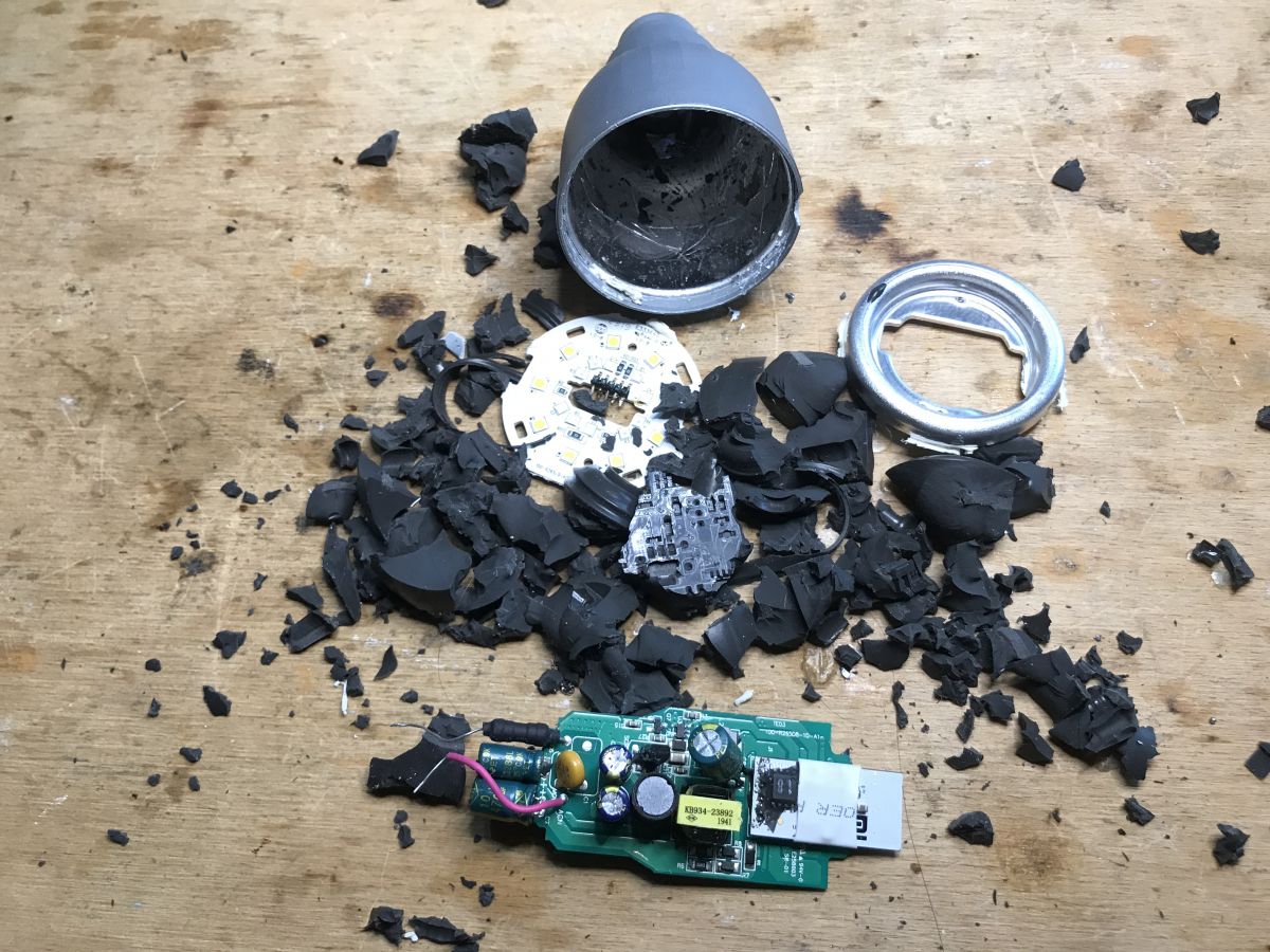

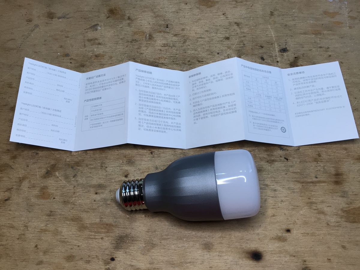

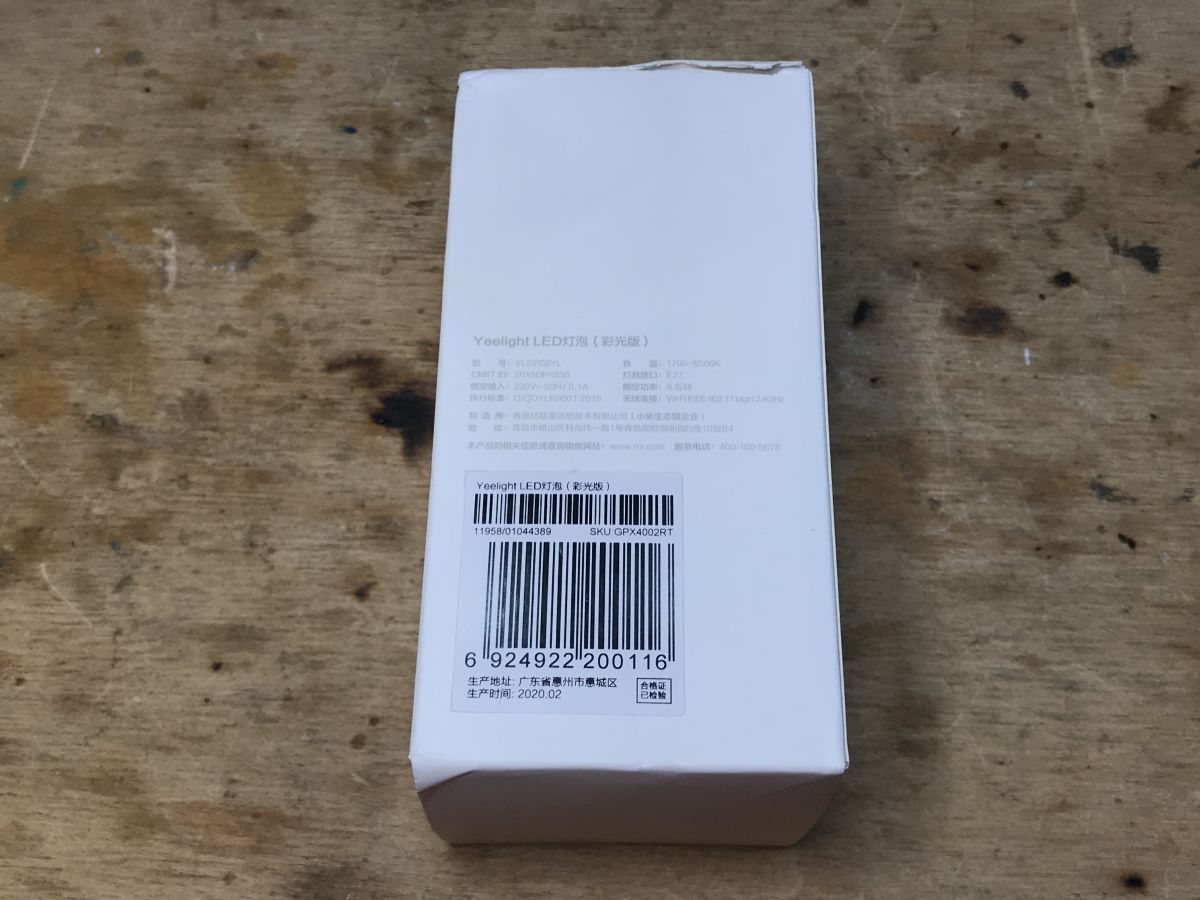

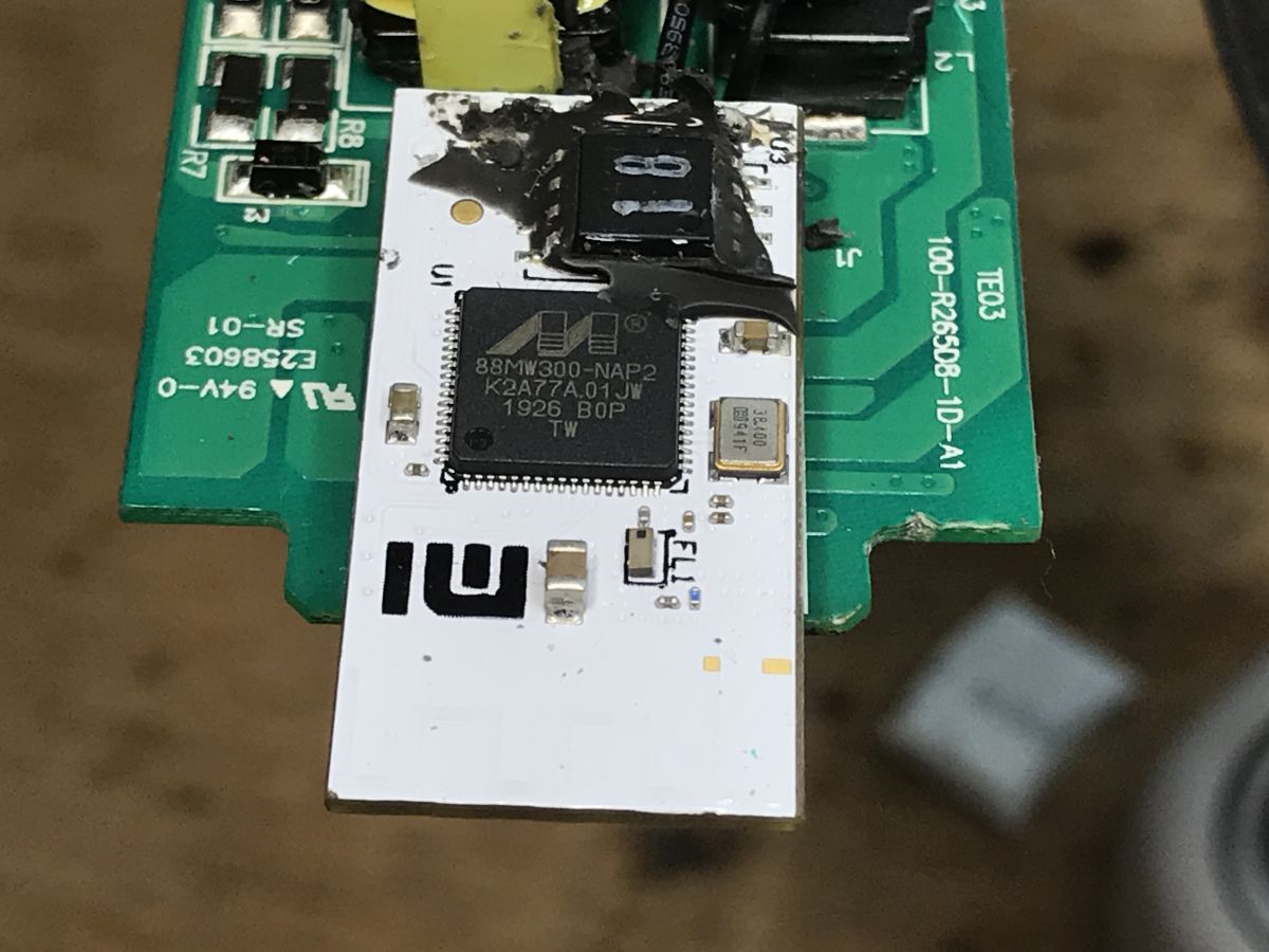

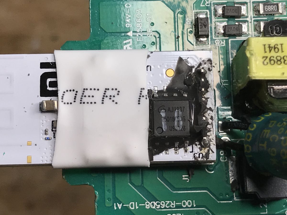

    The situation has already changed. With the tests I performed on my RTL setup, and with the futher confirmation from @kuba2k2 I am already confident that I will support RTL8710BN as well.
    Today I found yet another chip, but at this point of time I haven't just had time to research it. It just takes really much of time to do that (remember: you can support at https://www.paypal.com/paypalme/openshwprojects ), so that one will have to wait:
    [BK7231T] My HTTP server, configurator, MQTT support from Home Assistant [BK7231T] My HTTP server, configurator, MQTT support from Home Assistant
    The chip above is 88MW300-NAP2 and comes from YEELIGHT YLDP02YL. That was the worst bulb ever I disassembled and it might not come back in one piece:
    At this point I would say "don't buy Yeelight YLDP02YL", but again, I might be wrong, I didn't take my time researching this particular bulb.

    Wait what's this "Mi" logo doing there... This module isn't Tuya manufactured? Is it even tuya compatible?
    What about these other chips, like XR809? Are these always on tuya modules, like WB2 or something?

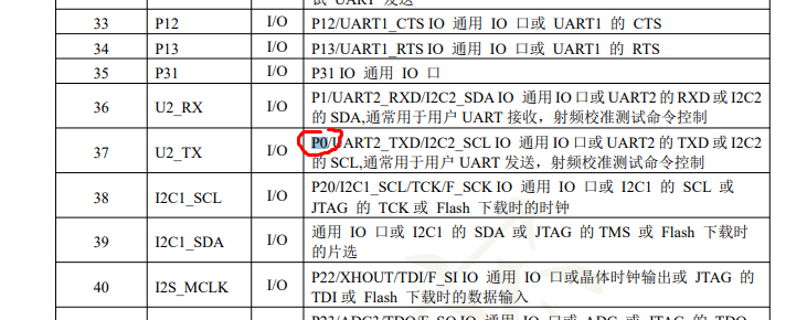

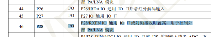

  • Fix pin count loop to use PLATFORM_GPIO_MAX
    #455 19986712
    theosoft
    Posts: 37

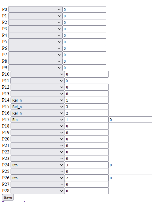

    Fix number of pins rtesults in "out of index in WEBAPP. FIX below
    diff --git a/src/httpserver/rest_interface.c b/src/httpserver/rest_interface.c
    index a768040..327d59d 100644
    --- a/src/httpserver/rest_interface.c
    +++ b/src/httpserver/rest_interface.c

    @@ -544,7 +544,7 @@ static int http_rest_get_pins(http_request_t *request){
         poststr(request, "],\"roles\":[");
    -    for (i = 0; i < 32; i++){
    +    for (i = 0; i < PLATFORM_GPIO_MAX; i++){
             if (i){
                            hprintf128(request, ",%d", g_cfg.pins.roles[i]);
             } else {
    @@ -552,7 +552,7 @@ static int http_rest_get_pins(http_request_t *request){
         poststr(request, "],\"channels\":[");
             if (i){
                 hprintf128(request, ",%d", g_cfg.pins.channels[i]);
             } else {
    Change from FIX Number of Pins...
    BUT: Questions...
    1. Does portnumbering starts with P0 or P1 ??
    2. I have seen P28 as MAX??
    3. This has to be cleaned up :-)
    My opject :-)
    [BK7231T] My HTTP server, configurator, MQTT support from Home Assistant[/i][/i]
  • Beken pin numbering starts at P0, not P1
    #456 19986918
    Posts: 14771
    Rate: 12914
    Good catch, @theosoft , fix added. Thanks
    It seems you are correct
    @kuba2k2 it's a Mi-home compatible light. It didn't pair with Tuya app. Product SKU code SKU411889 / GPX4002RT. Here is the attached manual:
    [BK7231T] My HTTP server, configurator, MQTT support from Home Assistant [BK7231T] My HTTP server, configurator, MQTT support from Home Assistant [BK7231T] My HTTP server, configurator, MQTT support from Home Assistant [BK7231T] My HTTP server, configurator, MQTT support from Home Assistant [BK7231T] My HTTP server, configurator, MQTT support from Home Assistant [BK7231T] My HTTP server, configurator, MQTT support from Home Assistant [BK7231T] My HTTP server, configurator, MQTT support from Home Assistant
    I am creating Beken-only environment in my room. From now on, all my devices will be tested in real life usage environment. Both N and T OTA and "safe boot mode" are reliable enough that I think there is a very low chance of me bricking device remotely and being forced to attach wires again.
  • #457 19986957
    theosoft
    Posts: 37
    OK, then there are 29 GPIO for BK7231N ...

  • #458 19987565
    Posts: 14771
    Rate: 12914
    I know, I already corrected it when I read your previous post, but thanks. I based the max value on WB2S/WB3S pins and not the chip itself.

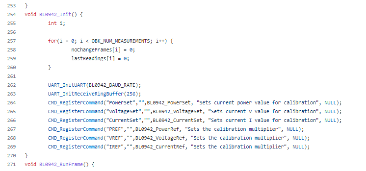

    LSPA9 (CB2S + BL0942 version) English guide released:
    https://www.elektroda.com/rtvforum/topic3887748.html
    Learn how to flash OpenBK, calibrate BL0942 power/voltage/current sensor and how to pair with Home Assistant!

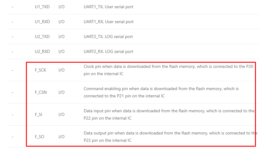

  • QIO flash image and Bluetooth support questions
    #459 19987672
    pepesuriano
    Posts: 33
    What are you trying to achieve? It's encrypted.
    QIO is for N, and UA is for T.
    https://github.com/tuya/tuya-iotos-embeded-sd..._os/beken378/func/user_driver/BkDriverFlash.c
    By the way, I will rewrite a flash vars save method soon. It has to be done to support multiple platforms smoothly. This will result in configuration loss for all users - so you will all have to reconfigure WiFi pass etc on all devices (they will become open access point if you OTA them with newer binary).
    Because UART did not work for me (after several tries and questions here), I am taking the SPI writing way now.
    Since my programmer is very bare metal (it asks me from which offset I start and end), I ran binwalk to see the binary structure.
    Is it ok to suppose then that I can flash this (after previous backup) to my whole flash? https://github.com/openshwprojects/OpenBK7231...es/download/1.0.16/OpenBK7231N_QIO_1.0.16.bin
    Apart from that, I see that you mention BL602 is supported, it means that BK7231 is capable of bluetooth pairing now or I am confusing stuff? I am interested in BK7231 bluetooth for presence detection.

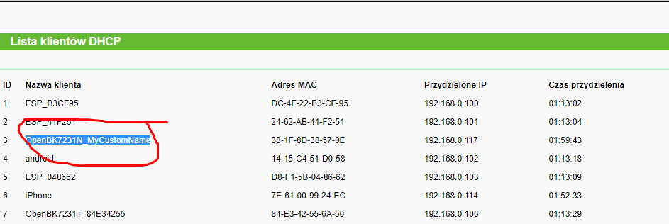

  • Web panel now supports changing device names
    #461 19987814
    Posts: 14771
    Rate: 12914
    I think so, but I have never done a direct SPI flash write myself for Beken chips. @btsimonh did that at least once, he might know more about it.
    BL602 is a just a microcontroller like BK7231N and BK7231T. So far it works only in WiFI mode. It is useful for me because I have a RGB LED strip with BL602 and now I can pair it with my home assistant easily. As for Bluetooth, it's capable of that but there is no Bluetooth features in our app yet.

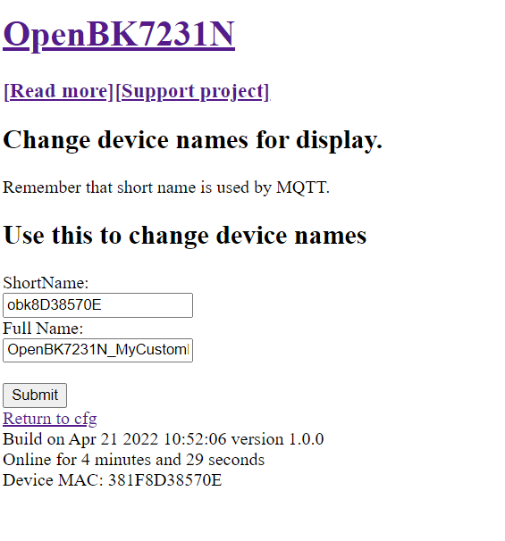

    @theosoft there is at least one serious issue with your changes. The flash config structure size is not supposed to be changed. It is set to be below 2048 (if I remember correctly) to fit a certain sector on Beken and XR809 memory. I have added unused, dummy fields for future use and they can be reused, but.... but in general, more rarely used settings should be set by commands (text commands from autoexec.bat or short startup command).
    Also, is one NTP url always enough or should we have a backup one?
    What is the purpose of flash read? Debugging?
    @theosoft take a look:
    This is how most of the "rarely used" things will be configured. I am still not sure about NTP, I might include it in flash memory as you suggest, but still, the above will be most common approach.
    Now you can change device names in web control panel:

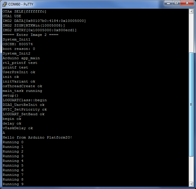

    Rate: 14
    Meanwhile, I think I'm getting close to running a full RTL8710BN Arduino core for PlatformIO:
    For now, I tested building and running code without Arduino libs (just the SDK+PlatformIO). The resulting binaries were about 26KB in size, which is surprisingly small. I will soon test out the Arduino code, some libraries (like Wi-Fi) and maybe try to debloat the SDK (from stuff like built-in "console). This should hopefully provide a small, working system for building code for this MCU.
    Sooner or later, I'm also planning to include BK7231T support in my PIO platform (mainly for myself). This could provide a (finally) usable build system for these Tuya-compatible modules, totally independent from Tuya's ugly makefiles, and buildable on any platform - meaning not having to use Cygwin anymore. As my platform uses vanilla SDKs (excl. the build system), even porting OpenBeken wouldn't require porting at all :D Add to this the Arduino core, and we have a cross-platform HAL environment for running whatever one might want...
    EDIT: I got the core to compile, and I'm currently trying to get UART working because of some "hard fault"...

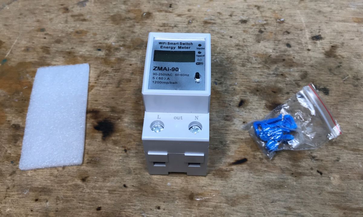

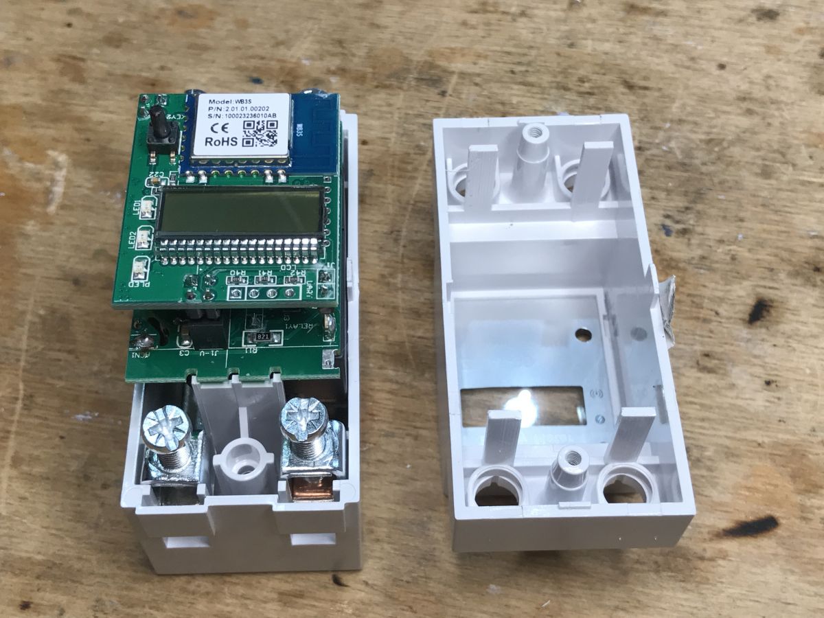

    I've found another WB3S device - ZMAi-90:
    I am also starting a serious testing regime (24h a day uptime expected) for all my Beken devices.

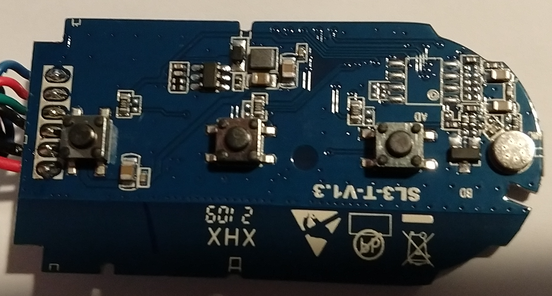

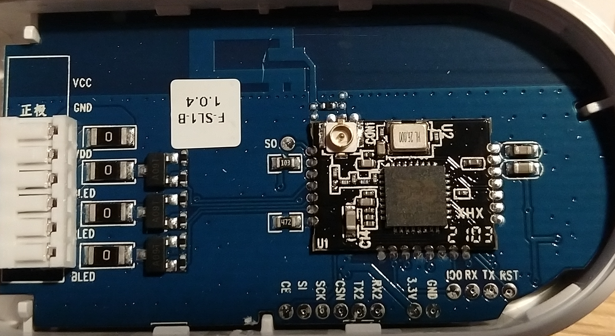

  • Asking whether OpenBK7231T supports non-Tuya devices
    #467 19989815
    jimbolaya
    I just stumbled on to OpenBK7231T from your Reddit post and got a little excited as I have a Nitebird SL1-B where the esp chip was replaced by the bk7231tqn32. (SL1 vs SL1-B)
    Browsing through this post it looks like there plans to support things like this that aren't from Tuya?
    The board I have does have serial pins, so I could potentially solder leads on to it and watch what's going on. I'll try to go through this post more thoroughly and see what I can do myself, but if there are any suggestions on the best path to take, that would be cool.

    #468 19989889
    Posts: 14771
    Rate: 12914
    Hey, hello @jimbolaya , welcome to Elektroda. I will do my best to ensure that your device is supported by OpenBK!
    What do you mean by non-Tuya, are you saying that Nitebird SL1-B is not a Tuya device?
    I don't think that this is a problem. bk7231t should be supported in any form.
    Please try to do the flashing with bkWriter, but please read the original firmware first and send it to tuya-cloudcutter guys so they can create OTA hack profile for your device (it's important so other users don't have to open the case and solder wires) https://github.com/tuya-cloudcutter/tuya-cloudcutter and remember to post here photos from the inside.
    For the T version, BK7231T, you use bkWriter, here are my guides for both N and T versions:

    Also, @p.kaczmarek2 here's the complete setup that I'm trying to get to work now. I'm not that experienced with embedded C++, so I guess I'm probably missing something obvious, like compilation flags or linker script directives. Apparently, all public SDKs for this specific MCU are made for C, so they don't really support C++. And these SDKs that do, are for a different MCU (like RTL8710**A**); yes, the numbering of these parts is completely messed up.
  • Asking whether flashing needs TTL or SPI cables
    #470 19990213
    jimbolaya
    Yes, I meant that Nitebird SL1-B is not a Tuya device
    Excellent!
    Please try to do the flashing with bkWriter, but please read the original firmware first and send it to tuya-cloudcutter guys so they can create OTA hack profile for your device (it's important so other users don't have to open the case and solder wires) <URL redacted> and remember to post here photos from the inside.
    So, for the following pictures, it looks like I should be able to set it up from your posts. To be clear, I'll need two 3.3v TTL serial cables? Or do I need an SPI module of some sort?
    [BK7231T] My HTTP server, configurator, MQTT support from Home Assistant[BK7231T] My HTTP server, configurator, MQTT support from Home Assistant

    @jimbolaya you should be using bkWriter 1.60 and single USB to UART converter with 3.3V logic levels.
    You also must be able to power off and power on board in order to reboot it with UART to USB converter running. This will not work if you power your board directly from the same USB port, because large electrolytic capacitors takes too much current when connected to power and exceed USB specifications.
    So, the suggested setup is:
    - USB to UART converter with 3.3V logic levels connected to programming RX TX port
    - extra 5V power supply (maybe from second USB port if they dont reset together) connected to 3.3V LDO connected to board (Beken chips are 3.3V only).
    (in the past, I used slightly different method - i removed electrolityc capacitors from boards for the programming time and used 5V from the same usb port as programming, and it worked well, but only with bulk capacitor removed. Of course I soldered them back after flashing)
    Procedure is:
    1. start bkwriter read (first read flash to backup it)
    2. power off and power on board
    3. the bkwriter will do whole read after reboot of the board
    The second option you have is to reboot beken with RST pin and not by power on/power off but it seems to be less reliable....
    Remember to backup flash! Tuya-cloudcutter guys needs it.
    WARNING: there is a small chance that flashing will not work for you at first, it happens if your board is using the RX or TX pin for button or something else. Don't worry! You can still flash it, we will just need to disconnect the button etc etc

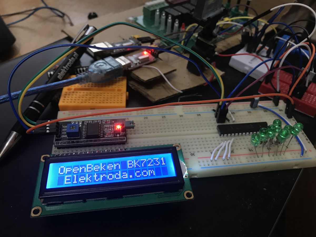

    PS: My BK7231T now controls an LCD, which is scriptable by commands:

    [RTL8710]
    IT WORKS!
    I can't believe how stupid this problem was.
    Just like I suspected, the linker script was the culprit.
    The thing is, I was trying out the correct solution multiple times. And it never worked.
    Why?
    Because I was only modifying the linker script. The program didn't change, so PlatformIO never recompiled and relinked it. The resulting binary was always the same, no matter what I changed.
    It just occured right now, that I changed something in the main program AND added correct lines to the linker at the same time. Otherwise I would be stuck with this for many more hours.

    About the tables... for now, I think, I would prefer to first get my project to a working state. You can, of course, list which modules you support in OpenBeken, but IMO it would be better to have a single, self-contained "database" about all Tuya modules, 3-rd party clones, available SDK options and hacking them in general - that's my general idea of my project. This page could then point to your app, for example, or even describe flashing instructions etc. Who knows, maybe at some point we'll integrate OpenBeken with PlatformIO to create a portable environment. No pressure though, just thinking.
    EDIT: tested stuff like GPIO, UART, flash ID&size, working correctly now. Tomorrow I'll try to compile libs and test Wi-Fi.

    I am adding simple events system with incoming scripting features. Examples:
    setPinRole 10 Btn
    setPinChannel 10 0
    setPinRole 11 Btn
    setPinChannel 11 0
    setPinRole 26 PWM
    setPinChannel 26 1
    setEventHandler OnClick 10 setChannel 1 100
    setEventHandler OnHold 10 addChannel 1 10
    setEventHandler OnClick 11 setChannel 1 0
    setEventHandler OnHold 11 addChannel 1 -10
    backlog startDriver I2C; addI2CDevice_LCD_PCF8574 I2C1 0x23 0 0 0
    addChangeHandler Channel1 != 0 backlog lcd_clearAndGoto I2C1 0x23 1 1; lcd_print I2C1 0x23 Enabled
    addChangeHandler Channel1 == 0 backlog lcd_clearAndGoto I2C1 0x23 1 1; lcd_print I2C1 0x23 Disabled

    My modules don't have SPI flash. Are you sure you mean BK7231T and not N or other?
    From all my experience, the linker is not even linking the function that is not called.
    I know. But the console is somehow always there, and always running, and always useless.
  • ATcmd thread causes always-running console
    #479 19992063
    Posts: 14771
    Rate: 12914

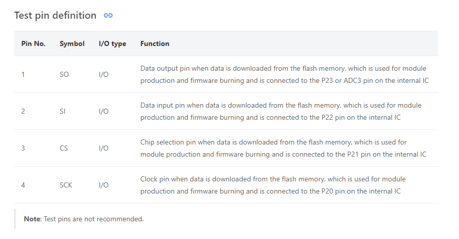

    You are confusing the meaning of SPI. SPI is just a protocol, like I2C or UART. Saying SPI does not imply that chip must have an external flash. It's just a port, see SPI flasher readme for details:
    https://github.com/OpenBekenIOT/hid_download_py/blob/master/SPIFlash.md
    You can program Beken chip by the SPI port of this chip.
    From WB2S docs:
    From WB2L docs (see, there is both 2x UART port and SPI port):
    @btsimonh certainly did that at least once. You just connect to SPI pins of BK7231 chip (and NOT of the external flash, because there is no external flash) and it works even if UART bootloader is not present
    It sounds like you had the ATcmd thread running in the background. It has indeed references to all the useless stuff in the SDK. The solution is simply not to start the ATcmd thread and that's it.
  • BK7231T may expose internal SPI flash on test pins
    #480 19992084
    kuba2k2
    Posts: 120
    Rate: 14
    I know what SPI is. I thought you meant writing to SPI Flash directly, hence the confusion. I didn't know that it can be flashed by SPI. Thanks for the explanation.
    I'm not sure, but doesn't the BK contain an internal SPI Flash? I mean, I remember something about reading the flash ID etc, which are kind of specific to common SPI chips. Maybe it's just the internal SPI flash that's brought out in these test pins?
