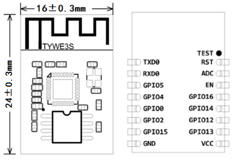

    TYWE3S (ESP12F):

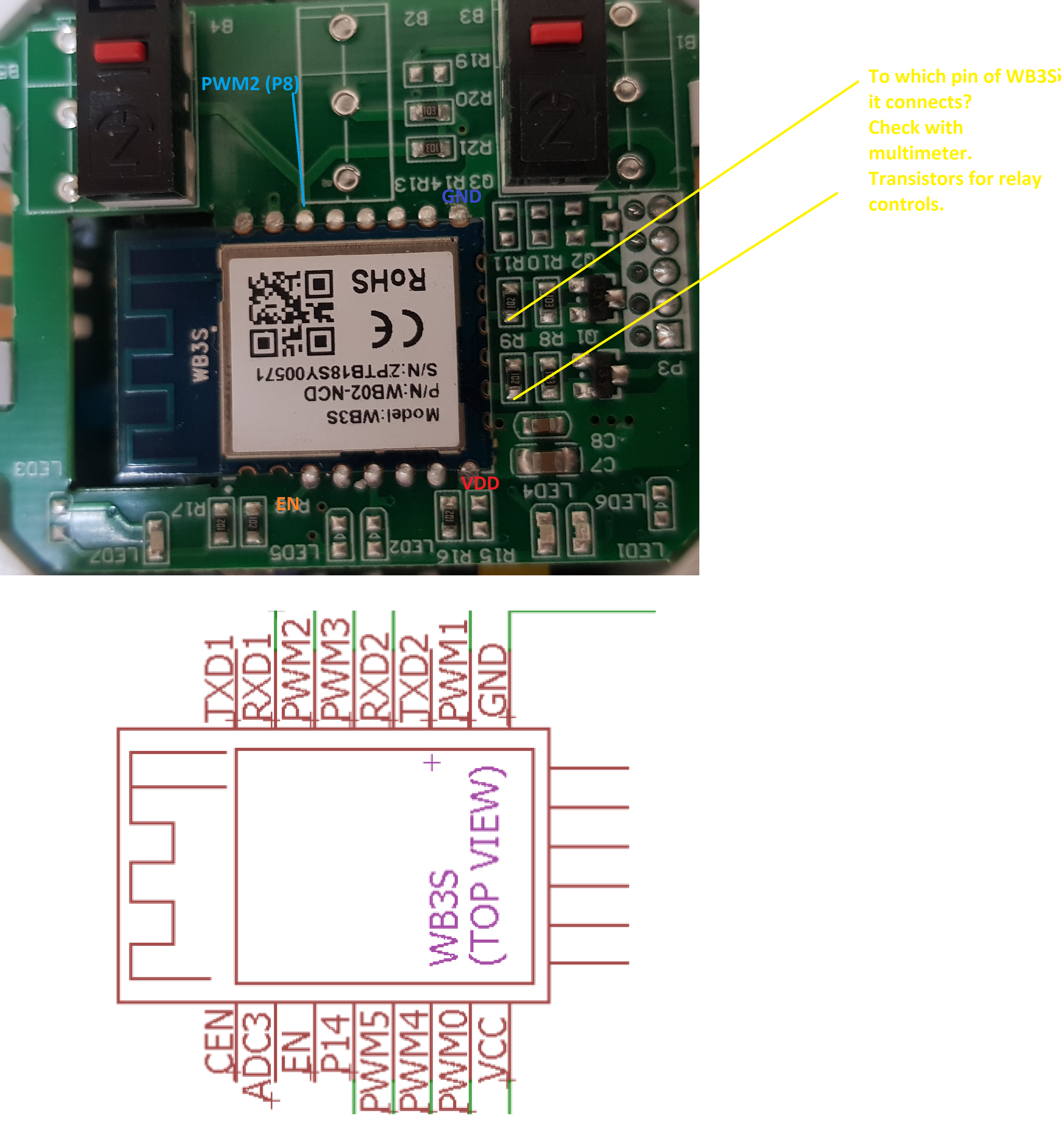

    In the configurator, the indices are the referring to "P26", "P10", etc, nomenclature
  • Topside PCB photo identifies P8, P26, and EN connections

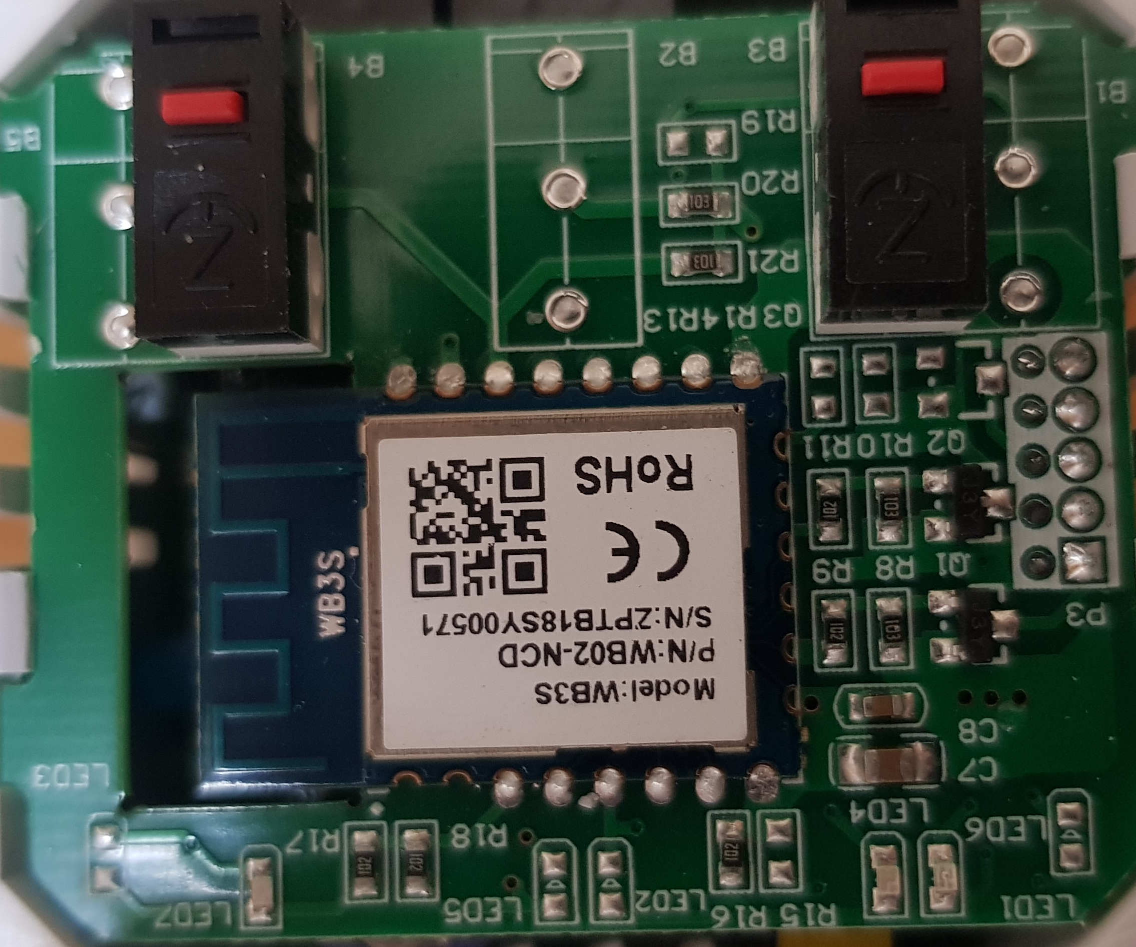

    leecher1337
    Posts: 11
    Here is an image of the top view of the switch. I don't know if I can unscrew the PCB from the bottom of the switch without destroying it, so I'd first like to ask if the photo of the topside of the PCB may be enough to get the necessary information (maybe it's the same profile as a switch you possibly already integrated):
    So I have connections to P8 presumably for the switches, P26 (LEDs..?), and EN (possibly irrelevant, as internal pull-up)?

    Was there ESP12F (TYWE3S) before? If so, then it's easy, just map the pins.
    still, here is a hint for you:
    Also... quick question - do you know that you can just try out each configuration? You won't break anything, I think.
    Just set P26 or something to Relay (or LED, as you wish), set it for channel 0, and toggle it from the www panel. Does the LED blinks or relay clicks? If so, that's the pin you're looking for.
    You can set multiple pins and test them at once. For example, set P1 to channel 0 LED, P2 to channel 1 LED, P3 to channel 2 LED, etc and on main site you get multiple buttons - each for each channel. Note down which one works (which pin).
    You can do the same with button. Have already a working LED or relay with channel 0. Set cetain pin to be a button with channel 0. Does clicking the button irl toggles the LED? IF so, that's the button pin.
    NOTE: Relays will not be working if you power module from your 3.3V supply. This is because relays require 5V rail or 12V (depending on device). Do all testing with module DISCONNECTED from your UART converter and your power supply, and with already connected to mains. NEVER connect module to both mains and your wires - it's very dangerous.
    NOTE2: There is a chance that you disable debug log UART output on the module pins if you set the role of UART TX to anything (this overrides logging and you can use debug log UART TX pin as relay control etc)

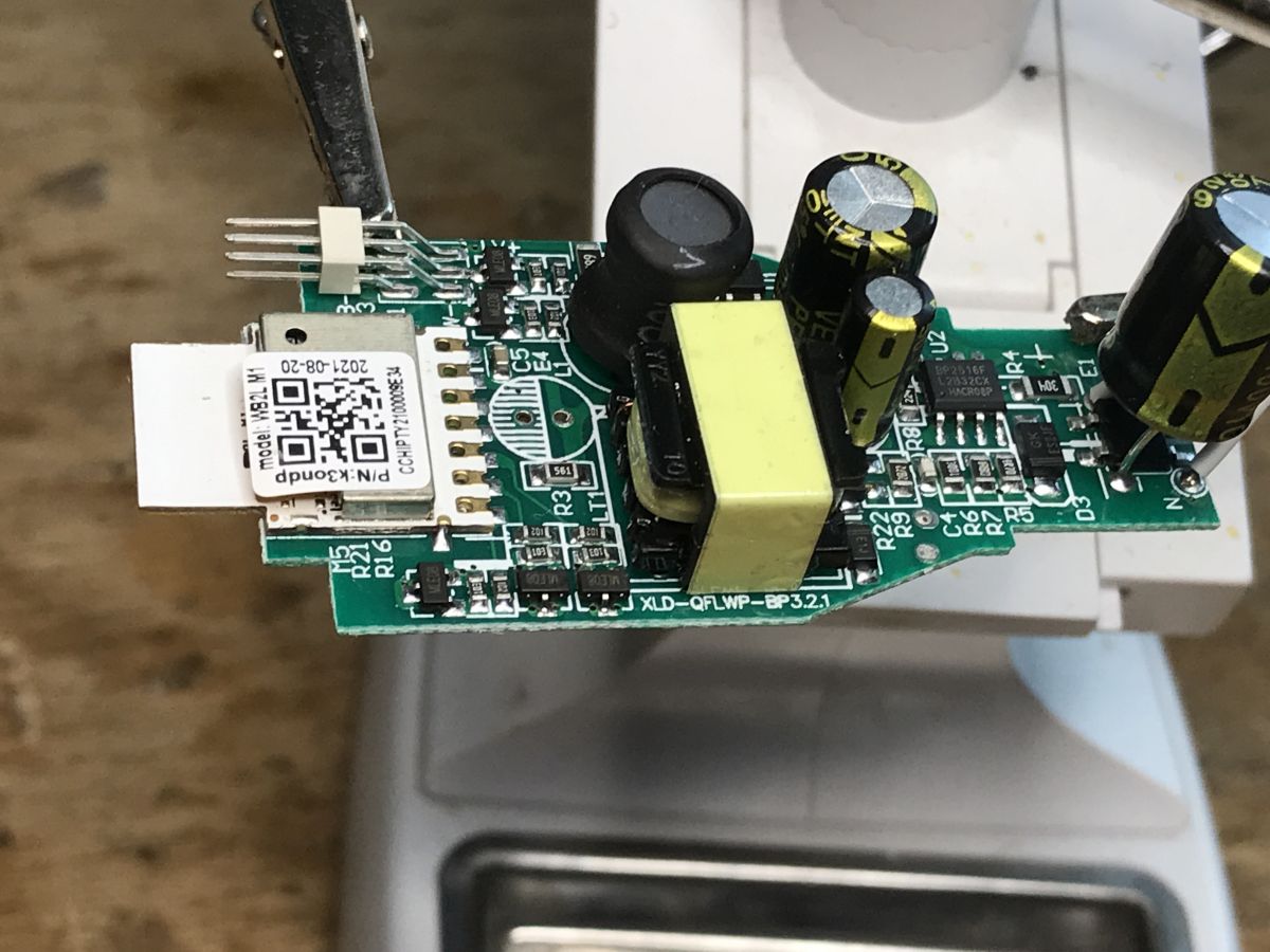

  • #544 20003276
    leecher1337
    Posts: 11
    Hi,
    Thanks for you help, I now got the following mapping:
    6 - Rel - 1
    8 - Btn - 2
    9 - Rel - 2
    10 - Btn - 1
    11 - LED - 2
    26 - LED - 1
    Now how to find WiFi Led?

    #545 20003292
    Posts: 14724
    Rate: 12806
    The same method as before, but the real question is... is there a WiFi LED in this product?
    Is there any LED on the board that you are not yet able to control? Maybe use multimeter to find out where is it connected (try probing also not on the led itself, but on the LED resistor, you might find that one by following PCB tracks).
    Not all products seems to have WiFi LED.

    leecher1337
    Posts: 11
    The left LED can flash orange or blue, there is LED4 and LED6 on the PCB.. I didn't manage to find it yet, tried different configurations, will try to find corresponding resistor. But no idea if I can do anything useful with the orange LED besides maybe showing WIFI connection status anyway...

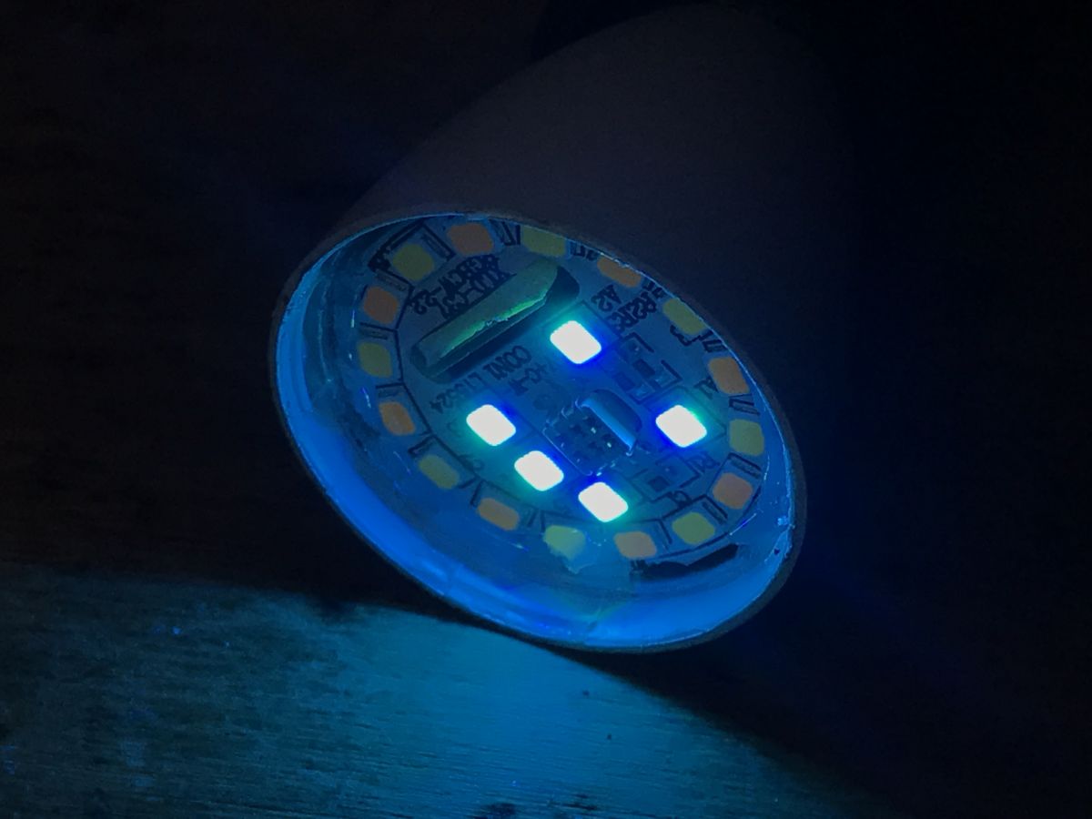

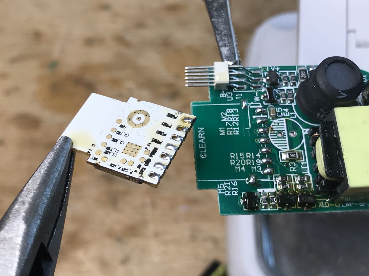

  • LSC bulb PWM mapping and OTA findings
    #552 20007319

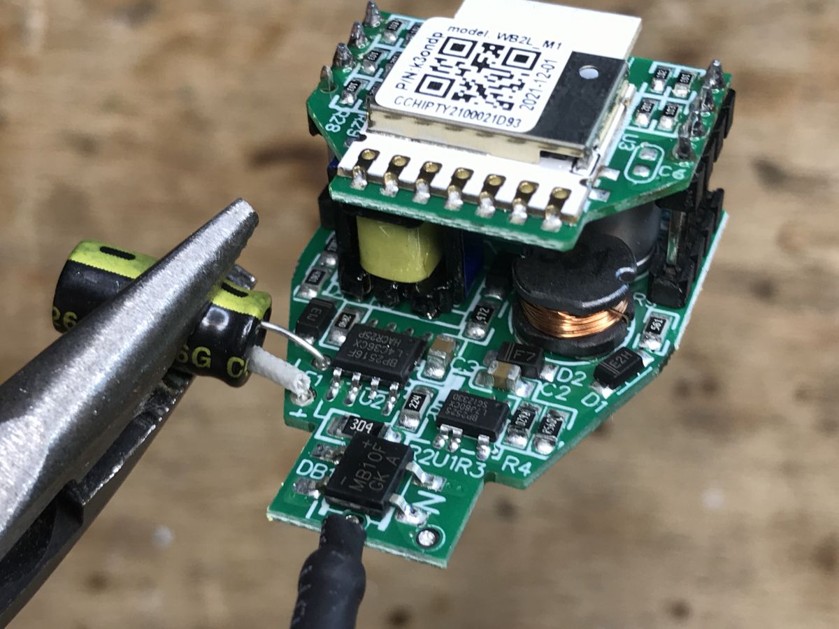

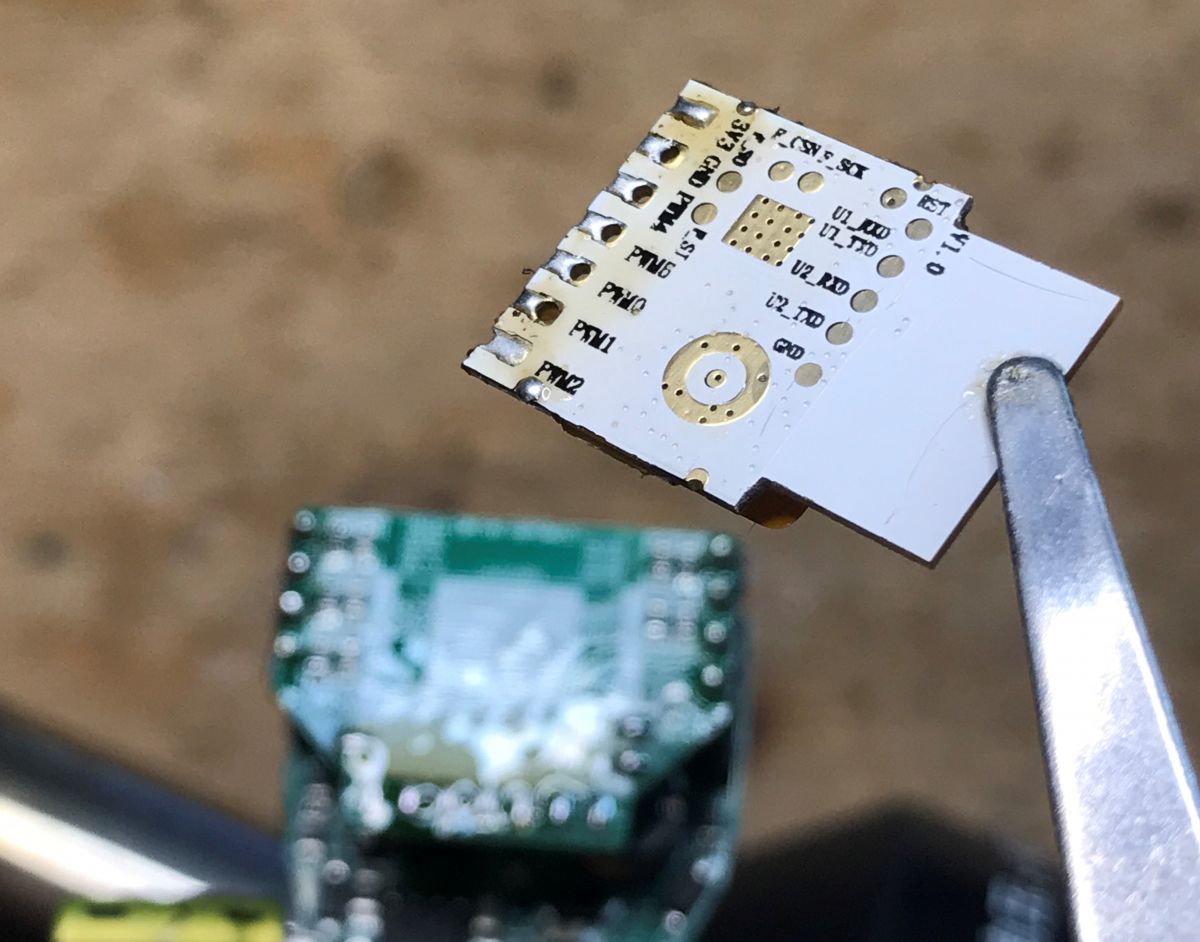

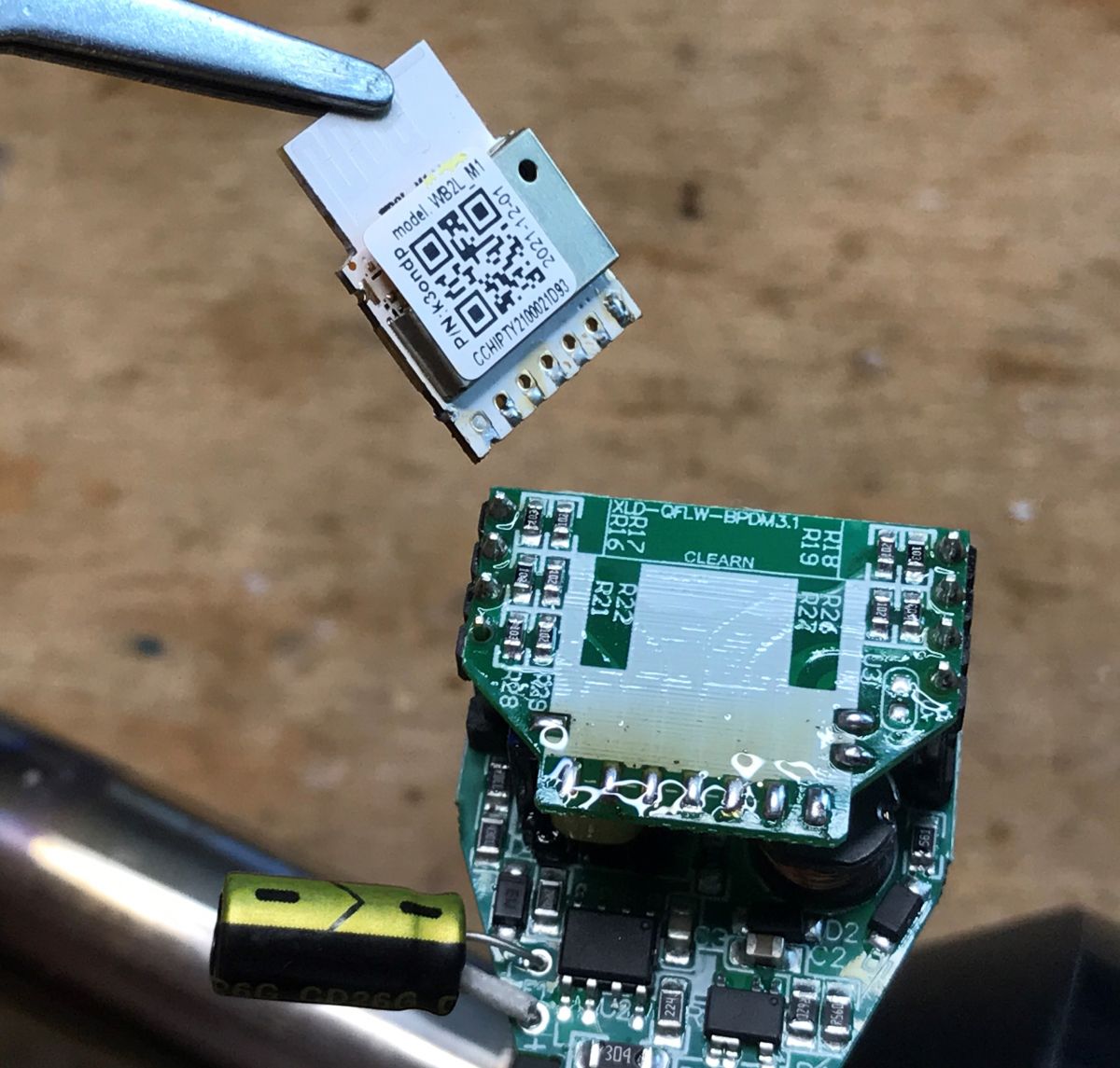

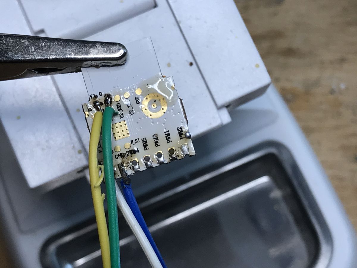

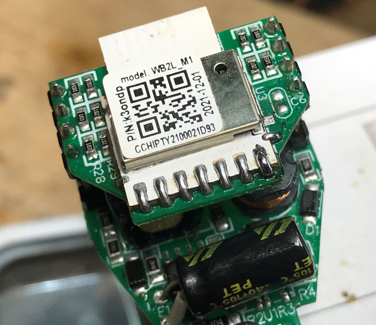

    Dark Man
    Posts: 74
    Rate: 20
    Dark Man wrote:
    The bulb is:
    The intelligent LSC Smart Connect LED bulb
    10 watts | 806 lumens
    Art. number 970715.1 v1.1
    WB2L chip
    https://www.action.com/pl-pl/p/inteligentna-arowka-led-lsc-smart-connect/
    I soldered the module back to the bulb and found its configuration:
    P7 - PWM - 2
    P8 - PWM - 1
    It works very nicely, only the minimum PWM setting is missing (or I haven't found it), because for about 15% of the channel brightness, the LEDs do not shine at all.
    It may not be a big problem, but still :)
    At that time, it would also be worth including QuickConfig in the configuration and ultimately in Template in the form of Tasmot.
    By the way, I also tested OTA - it only worked from the App OTA level, and not from the default config.
    The next step is to test the cloudcutter script.

  • PWM brightness scaling and low-level flicker issues

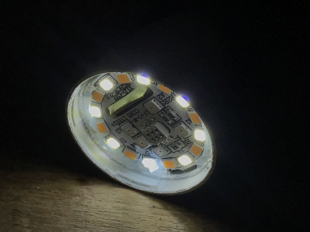

    #555 20008221
    Dark Man
    Posts: 74
    Rate: 20
    I have a few more problems.
    I have two PWM channels configured as cold white and warm white.
    The slider of their brightness works strangely - no matter if from the default menu or App menu or from Home Assistant through MQTT.
    For COLD WHITE at my P8:
    - The LEDs only light up from setting 6 on the slider
    - at the level of 99 the LEDs shine 50% of their brightness, but just move the slider to 100 and they already shine at 100%
    For WARM WHITE at my P7:
    - The LEDs only light up from setting 21 on the slider
    - at the initial brightness, i.e. from 0% to about 30%, the LEDs blink, maybe not significantly, but I can see it (I am sensitive to a low refresh rate). in ESP32 you can set the PWM frequency and in Beken?
    Another thing is the default generated configuration for Home Assistant provides for the "Optimistic: true" mode, which causes no actual actual state to be visible. I tried to change it to False, but then the lack of the ability to turn on / off (switching does not change the state), although the slider seems to work as in the native OpenBK menu as described above.
    Another thing :)
    In YAML in HA I tried to build one light entity that supports cold white and warm white, i.e. an entity with two sliders (brightness and temperature), but it does not work out at all and I do not know how to do it.
    As for adding a template as a pull request, I will try to add it myself, come on it for the first time (it must always be the first time :-) )
    I have not seen anything like that. In my case, both the bulbs and the LED strip are already shining at a few% and the dimming value goes smoothly.
    I bought a bulb from Action for PLN 18, in a few days I will test it and maybe I'll see what you mean ...
    It's stiff in my 1kHz code (if I remember correctly), in hal_pins_bk7231.c
    It may actually be a bug. How do you turn it on, do you mean via MQTT / get / / set / or via led driver with enable?
    I haven't had the CW bulb itself, but in my opinion it will work if you set channel 3 for C and channel 4 for W (R, G, B will be skipped by default)
    https://www.elektroda.pl/rtvforum/topic3880540.html
    Yaml from the topic, but you will remove the commands on RGB ....

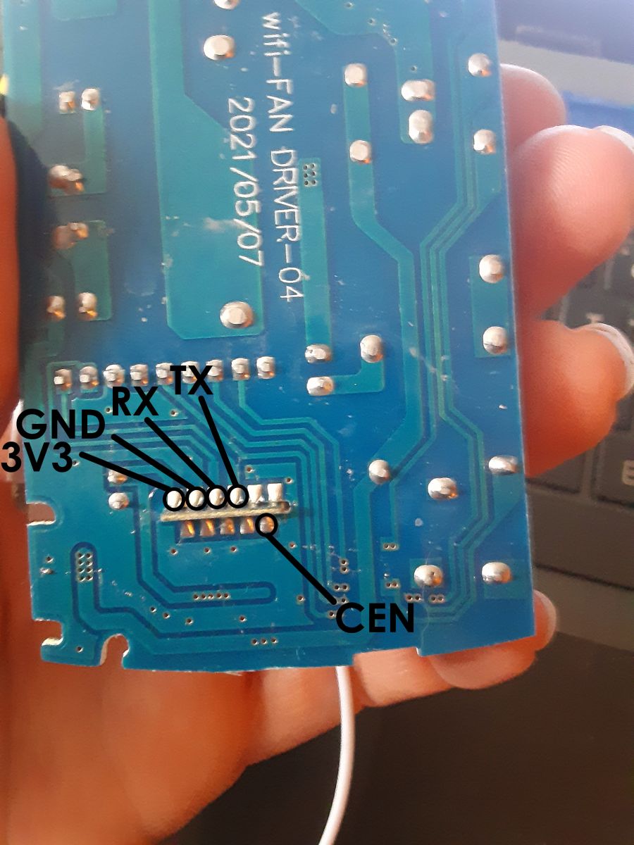

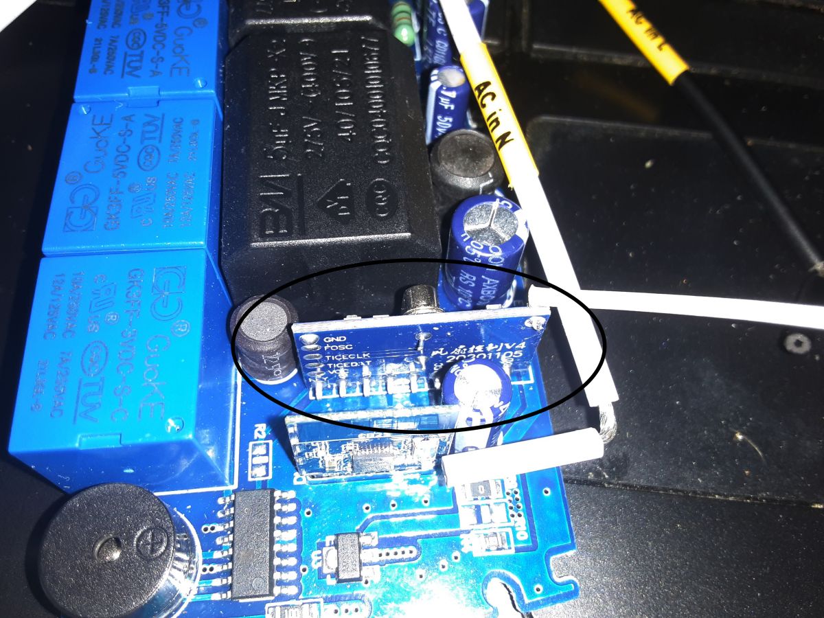

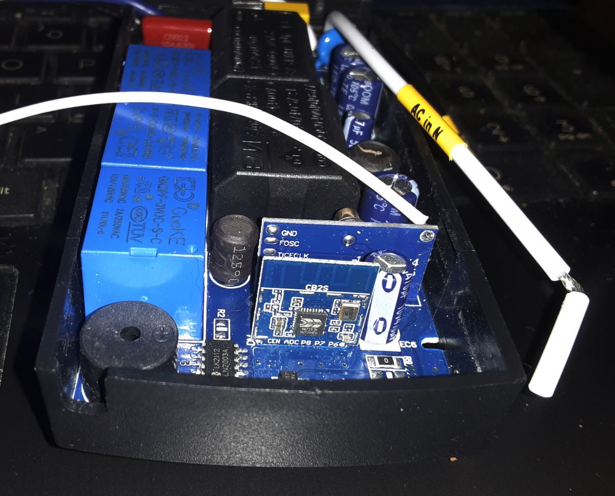

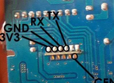

  • #557 20008412
    pepesuriano
    Posts: 33
    Hi, I have been unable to contact @btsimonh since it seems that last connection was a while ago.
    Does somebody have any guidance on how can I flash a WB2S with SPI? UART has been impossible to me and I cannot find info on how to flash with SPI.
    Thanks

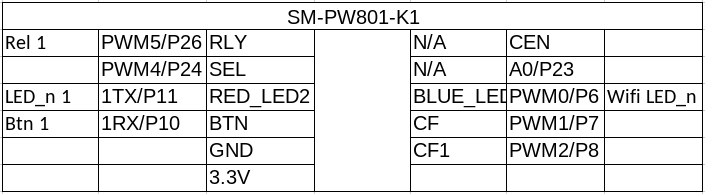

  • #559 20009346
    marioalmeida
    Posts: 47
    Rate: 24
    I have SM-PW801-K1 with BK7231T, how can I get bl0937 working?

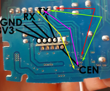

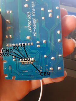

    I'll be flashing this ceiling fan controller over the weekend. It has the CB2S module (BK7231N).
    [BK7231T] My HTTP server, configurator, MQTT support from Home Assistant [BK7231T] My HTTP server, configurator, MQTT support from Home Assistant [BK7231T] My HTTP server, configurator, MQTT support from Home Assistant
  • BK7231N flashing blocked by RX/TX traces
    #561 20009398
    Posts: 14724
    Rate: 12806
    BL0937 is not implemented yet, only BL0942.
    Can you please provide more information about that board? I see there is a ULN2003 on the board, most likely for driving relays, and AMS1117 3.3V as well, but what is the second daughter board in the background? Is this RF433? That's something new, I wonder how it works.
    Are relays connected directly to CB2S pins or by TuyaMCU?
    If relays are directly connected to CB2S UART lines (TX and RX), please be aware that flashing might fail. In that case, you can either temporary cut tracks (or desolder blocking parts from RX TX lines) or wait for OTA support for this chip.
    EDIT:
    it seems so, the RX TX tracks are used, so in this case the flashing might be slightly harder than usual. What is on the second board?
    Initial OTA is done by tuya-cloudcutter, but tuya-cloudcutter can only support devices that have been cracked first, and in order to crack device someone must read BK7231 memory by wires and send it to tuya-cloudcutter guys here:

    EDIT2: Some progress on my side:
    And yet another device, unlucky bulb with a strange WB2L_M1 module which is like WB2L but on BK7231N (not T!), where you have to desolder module to reach RX/TX pads:
    [BK7231T] My HTTP server, configurator, MQTT support from Home Assistant [BK7231T] My HTTP server, configurator, MQTT support from Home Assistant [BK7231T] My HTTP server, configurator, MQTT support from Home Assistant [BK7231T] My HTTP server, configurator, MQTT support from Home Assistant
    And soldered back:
    No problem, tuya-cloudcutter guys will get firmware from me and prepare OTA hack for this device so you dont have to solder wires to flash. [BK7231T] My HTTP server, configurator, MQTT support from Home Assistant [BK7231T] My HTTP server, configurator, MQTT support from Home Assistant
  • Identifies the second daughter board as RF433 remote control

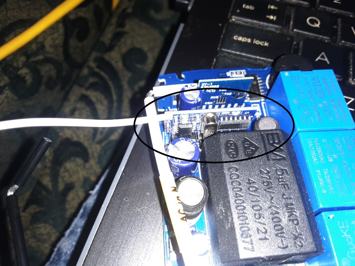

    #562 20009473
    echojjj
    Posts: 20
    Rate: 13
    Yes, it is the RF433 for remote control. It has both features "smart" and "rf".
  • Requesting chip markings and RF board trace routing
    #563 20009495
    Posts: 14724
    Rate: 12806
    Would it be possible to read the markings from both chips on the RF board?
    I suspect it might be TuyaMCU, which would require more advanvced configuration and reverse engineering in order to support it.
    Can you check where those 4 tracks go? They start at RF board and go to... where?
    (I already suspect where they are going but let's check...)
  • RF board tracks go to ULN2003
    #564 20009520
    echojjj
    Posts: 20
    Rate: 13
    I would have to desolder it.
    It is TuyaMCU. I see that on the Tasmota Templates page for this device https://templates.blakadder.com/qiachip_FLC.html has already been done there. Is it same?
    Those go to the ULN2003

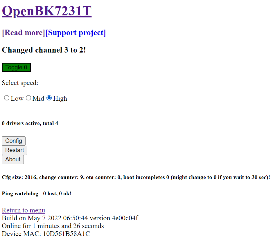

  • Fan speed channel type and timer value questions
    #567 20009602
    Posts: 14724
    Rate: 12806
    I will add fan speed (Low/Med/High) channel type and display on OpenBeken index page tomorrow for you. We shall get it fully supported with your help. First, try reading the original firmware and report progress here. For reading, even bkWriter 1.60 works for BK7231N (I think), but for writing, only Python flasher will do. Good luck!
    edit: by Python flasher I mean hid_download_py:
    https://github.com/OpenBekenIOT/hid_download_py
    Added after 8 [hours] 51 [minutes]:
    @echojjj as mentioned yesterday, I am adding a channel type for fan speed:
    dpid3 - fan speed (0 = low, 1 = med, 2 = hi)
    setChannelType 3 LowMidHigh
    Do you know if time can be any value or just one of these?
    dpid6 - self timer (0 = off, 1 = 1hr, 2 = 2hr, 4 = 4hr, 8 = 8hr)
    Can it be set to 5 as well? So 5h?

    Posts: 120
    Rate: 13
    Did you find Tuya datasheets for that module? I don't see it on their page.
  • Tuya modules now ship with covered programming pins
    #569 20010056
    Posts: 14724
    Rate: 12806
    No, but Tuya is dropping that module in new devices like crazy.
    And so far it always came with covered programming pins!
    Luckily for you, I am sending flash dumps to cloudcutter guys so you will not have to go through the process I go.
    Look, two bulbs, E14 and E27.
    E27:
    E14:
    I have to desolder module with hot air every time.
