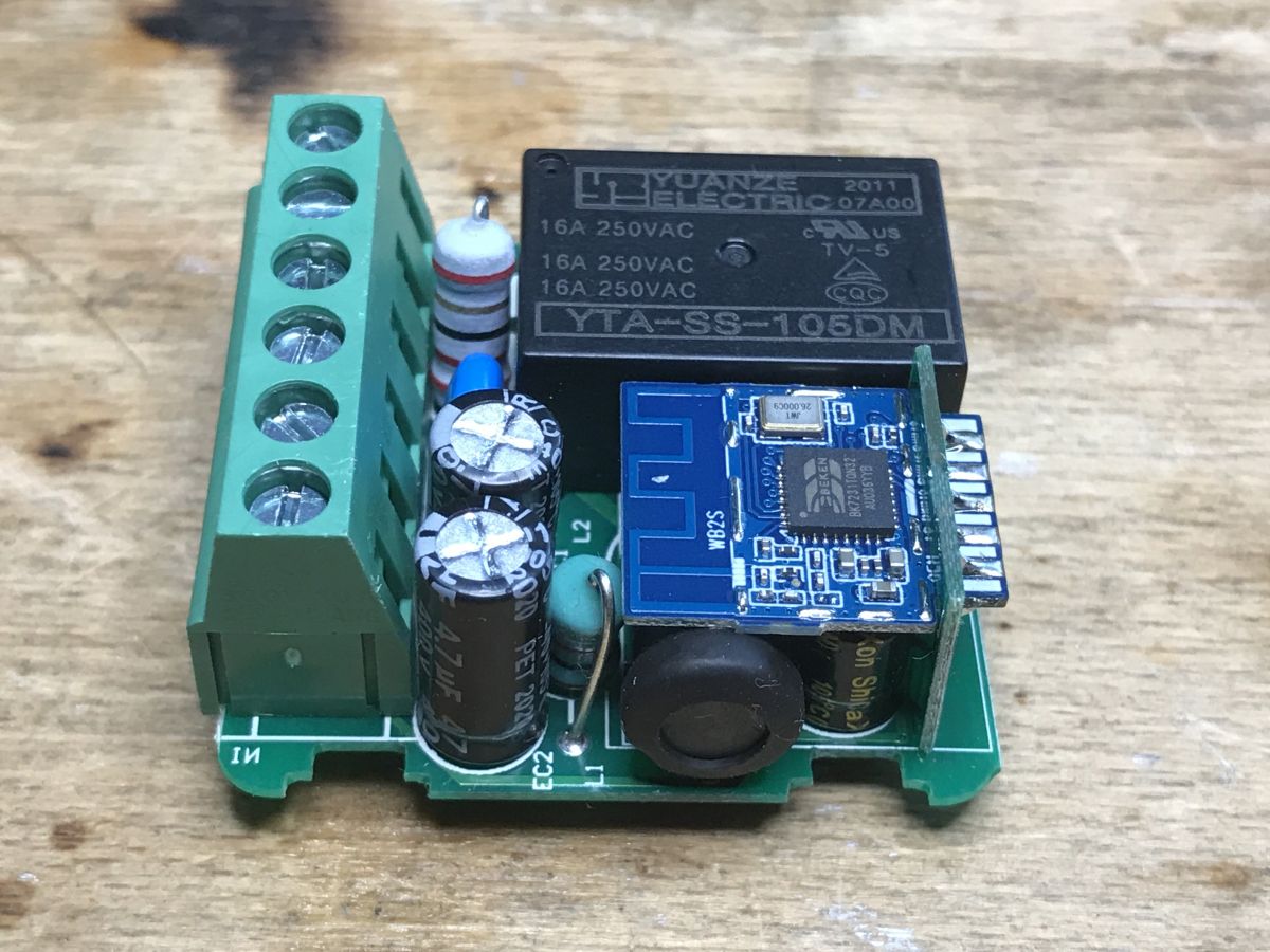

  • Airam Smart A60 bulb pinout and flashing steps
    #422 19977811

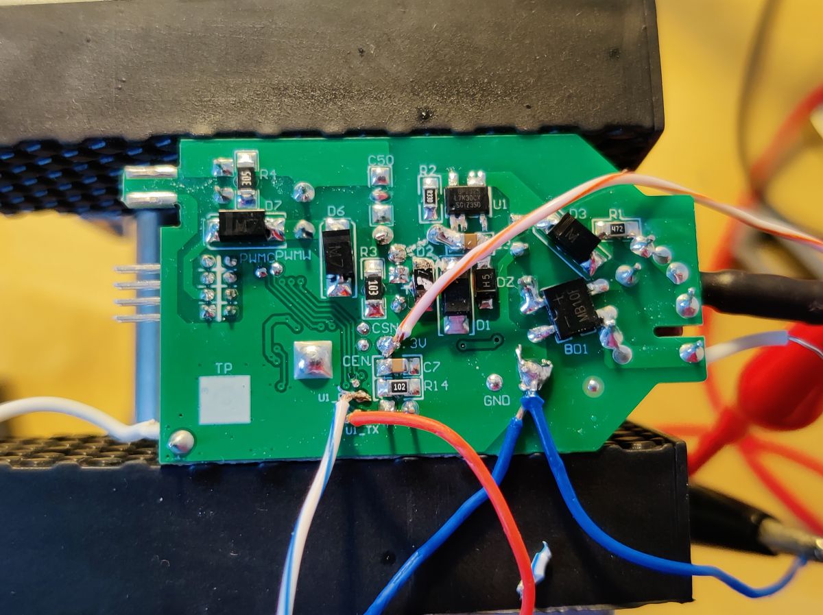

    faster_harder_coder

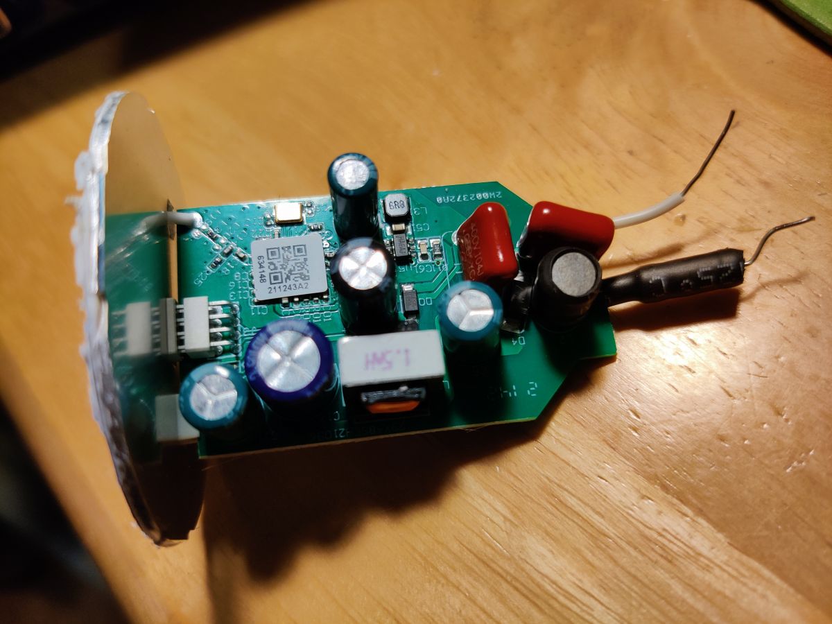

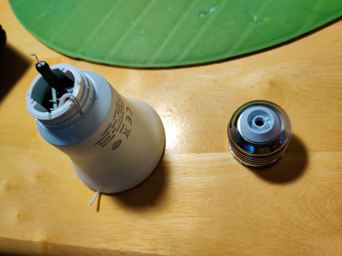

    Thank you @p.kaczmarek2 for this firmware!
    Here's another lightbulb that is compatible:
    Name: Airam Smart A60 827-865 RGB 806lm E27 OP.
    Specs: 9W 2700-6500K RGB E27 806lm
    Chip: BK7231N (plus 8P5772? and 8P1638? which seems to be controlled with just PWM signal)
    Text on PCB: 46.4LH21095
    Disassembly:
    1. Remove rivet on end of the bulb with knife or screwdriver. There are no threads on it.
    2. Metal screw part is screwed in place and pressed into place. Loosen metal gently with a knife/screwdriver and unscrew metal part from plastic.
    3. Ball part is glued in place. Gently run a knife or screwdriver around grove and remove it
    4. There is a metal plate with leds visible which is also glued. Remove glue with knife or a screwdriver
    5. You should now be able to remove LED PCB and microcontroller PCB.
    Programming:
    Backup chip before programming!
    Pinouts are marked on PCB.
    1. Solder 1 wire to 3.3v and 2 wires to GND
    2. Solder wires to U1_RX and U1_TX
    3. Connect your serial adapter to U1_RX, U1_TX, and GND
    4. Connect a power supply to 3.3v and GND
    5. Start programming command: uartprogram -w -s 0 -d /dev/ttyUSB0 -u -b 115200 OpenBK7231N_QIO_1.0.8.bin
    6. Connect CEN to ground briefly, programming should start. This needs to be done quickly, there is a timeout. Restart programming command if timeout was reached.
    Confirmed working with firmware version 1.0.8
    Configuration:
    Set the following pins as PWM
    P6 - GREEN COLOR
    P7 - RED COLOR
    P8 - BLUE COLOR
    P24 - COLD WHITE COLOR
    P26 - WARM WHITE COLOR
    Images:

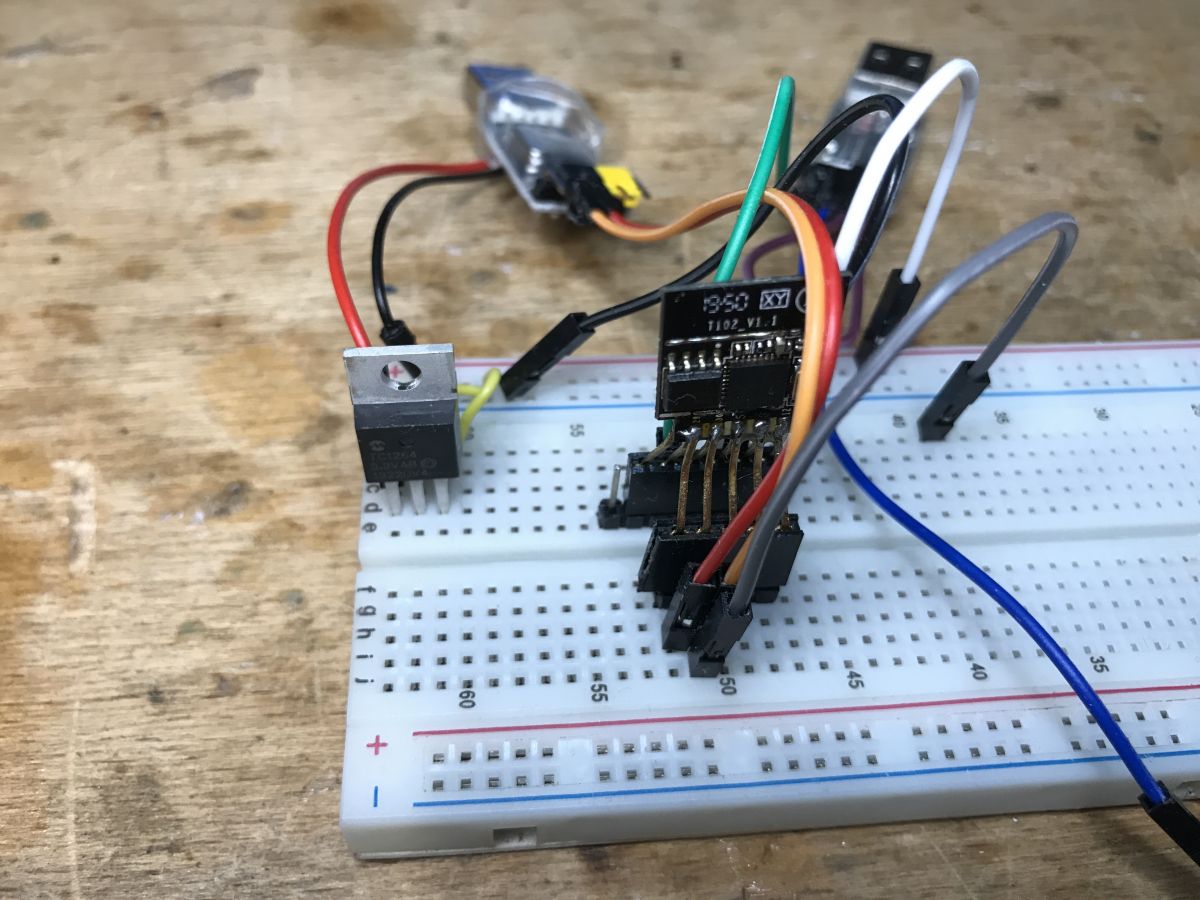

    [BK7231T] My HTTP server, configurator, MQTT support from Home Assistant [BK7231T] My HTTP server, configurator, MQTT support from Home Assistant [BK7231T] My HTTP server, configurator, MQTT support from Home Assistant
  • Suggest checking the board LDO before wiring
    #423 19977888
    Posts: 14724
    Rate: 12806
    theosoft wrote:
    if(g_connectToWiFi){
    	g_connectToWiFi --;
    	if(0 == g_connectToWiFi && 0 == g_bHasWiFiConnected) {
    		const char *wifi_ssid, *wifi_pass;
    		wifi_ssid = CFG_GetWiFiSSID();
    Was that necessary? From a quick glance at code, not, but it's late here in Poland.
    @faster_harder_coder - great news and description, altough I'd first look for LDO on the board because using 5V from USB is easier.
    By the way, there is supposedly a tuya-cloudcutter that supports BK chips, so wiring might not be needed and first upload could be done with OTA.

    Disassembly:
    Do you mind sharing a video for this? Just to avoid completely damaging the bulb case
    Also, for tuya-cloudcutter you can dump your firmware here so it gets added to list of devices. Should be able to flash openbkt via ota method
    https://github.com/tuya-cloudcutter/tuya-cloudcutter/issues

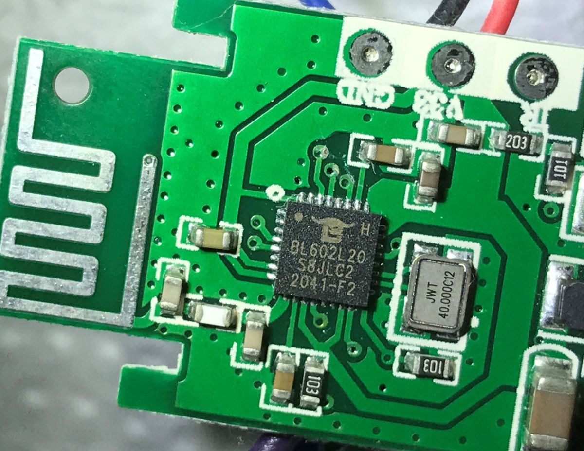

    EDIT: BL602 update - GPIO testing:
    [BK7231T] My HTTP server, configurator, MQTT support from Home Assistant Electronic prototype with a breadboard, wires, and a module.
    Electronic module with BL602C/E QFN32 pinout description
    My Tasmota replacement is starting to support BL602 as well.

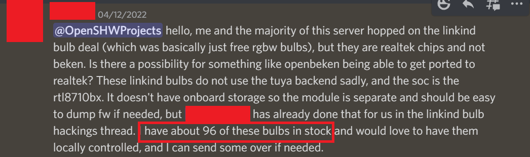

  • Need bkcdriverflash.c link and flash file clarification
    #431 19980980
    pepesuriano
    Posts: 33
    Here you go: https://circuitdigest.com/microcontroller-projects/ble-based-proximity-control-using-esp32
    And an example with Openwrt: https://github.com/devbis/ble2mqtt
    I think I can be reduced to 2 main steps:
    1- get Bluetooth working (being able to pair a device with the bk7231), and with that have values like distance to report to HA
    2- send previous mentioned data to mqtt, so it would be auto discovered in HA having mqtt
    btsimonh wrote:
    pepesuriano wrote:
    if you know the offsets
    look in bkcdriverflash.c for the partition table.
    app starts at 0x11000, boot loader before that.
    I tried SPI via ESP32 first, and was unsuccessful. RPi worked after some coaxing...
    Theoretically, you should only need SPI if the bootloader is broken - in your case the serial flashing is not working, correct?
    So if your serial connections are ok, you could try first putting the std bootloader in from 0x0 - 0x11000, and then retry serial flashing.
    I had to SPI because I overwrote the bootloader whilst developing the OTA flashing :).
    If you do get SPI working, be sure to read all 2Mbyte as a backup first!!!
    And don't overwrite the RF partition... I don't think we have calibration yet.
    Sorry, I looked around the repositories of https://github.com/openshwprojects and I didn't found bkcdriverflash.c, can you provide me the link to give it a look?
    I also tried to run binwalk on file "OpenBK7231N_QIO_1.0.9.bin" of https://github.com/openshwprojects/OpenBK7231T_App/releases/tag/1.0.9 but nothing show, it's encrypted? This is the correct file for flashing bk7231 right? I want to know if it is the file that I should use with my programmer and the bootloader must be extracted from there.
  • Encrypted flash and QIO/UA mode clarification
    #432 19981547
    Posts: 14724
    Rate: 12806
    What are you trying to achieve? It's encrypted.
    QIO is for N, and UA is for T.
    https://github.com/tuya/tuya-iotos-embeded-sd..._os/beken378/func/user_driver/BkDriverFlash.c
    By the way, I will rewrite a flash vars save method soon. It has to be done to support multiple platforms smoothly. This will result in configuration loss for all users - so you will all have to reconfigure WiFi pass etc on all devices (they will become open access point if you OTA them with newer binary).

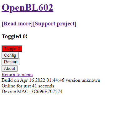

  • BL602 support added with RGB control and MQTT
    #434 19982257
    Posts: 14724
    Rate: 12806
    Thanks, I will buy this module and make sure it's supported.
    Right now I am not even sure, what is this big SOIC chip, is this TuyaMCU? Doesn't seem required in this case. A step up converter? I see no inductor and no schottky diodes here....
    For reference, see sensor described here:
    https://www.elektroda.com/rtvforum/topic3806769.html

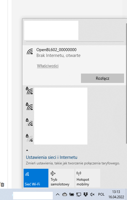

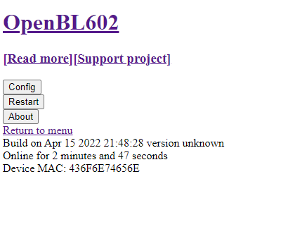

    BL602 support (with GPIO, MQTT, PWM, flash save config, etc) has been added to the firmware.
    So now I support 4 platforms: BK7231T, BK7231N, XR809 and BL602.
    I have added support for this device (MWIR-RGB Magic Home Pro RGB):
    https://www.elektroda.pl/rtvforum/topic3881416.html#19944184
    See photos:
    Tablet with an app for controlling RGB LEDs and an LED strip on a table. Tablet with an app for controlling the colors of LED lights connected to a microcontroller. Tablet with an app for controlling LED colors, showing a color and brightness selection window. Cables and a red-lit LED strip are connected nearby. Tablet with a lighting control application, LED strip, and electronic components.
    Screenshot of the Bouffalo Lab Dev Cube application with a success message.
    You can control color, brightness and turn device on or off (turned off device does not forget the color and brightness settings)
    The only missing part is that HA is not yet able to read back the brightness.

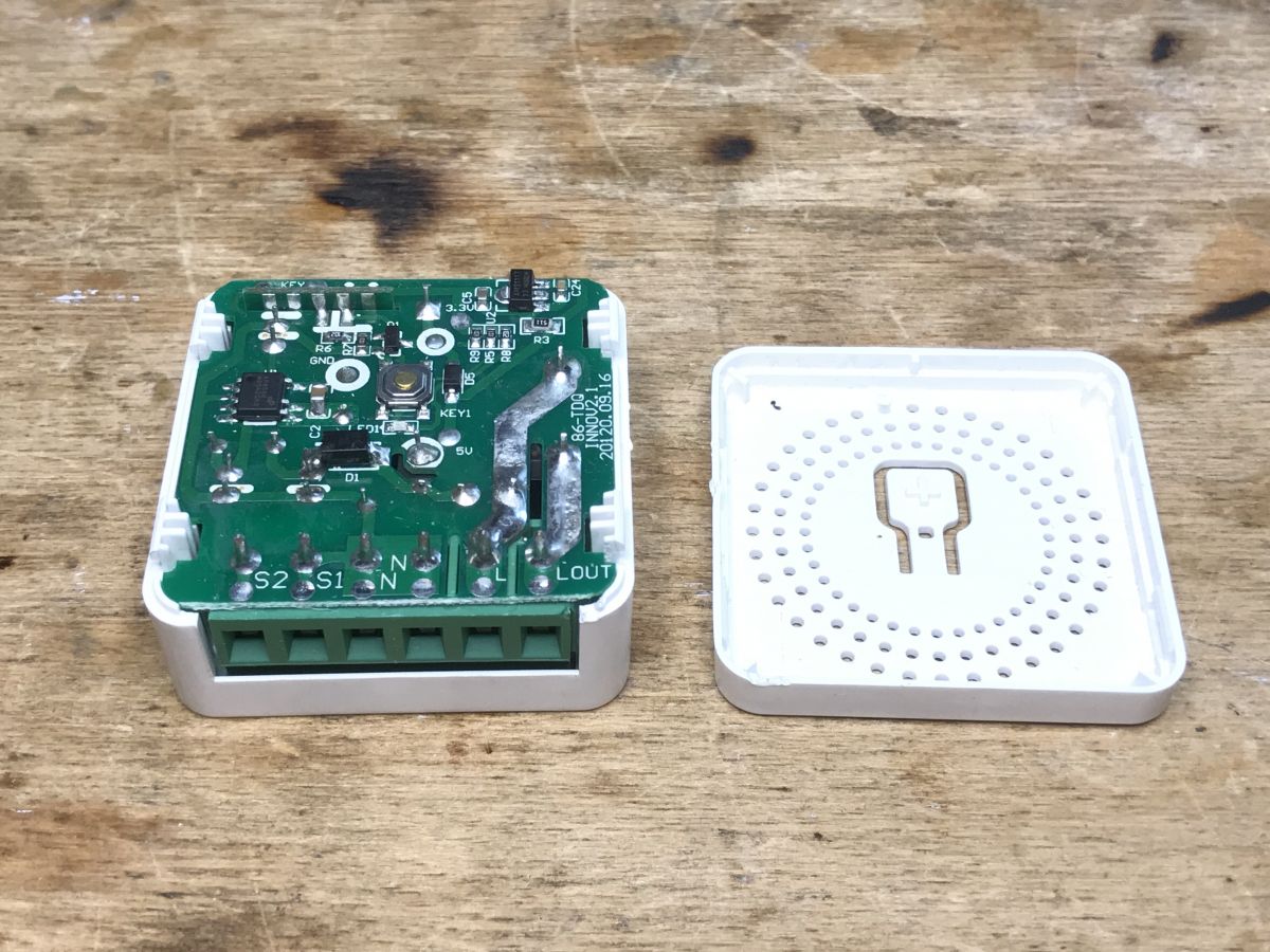

    #435 19983749
    Posts: 14724
    Rate: 12806

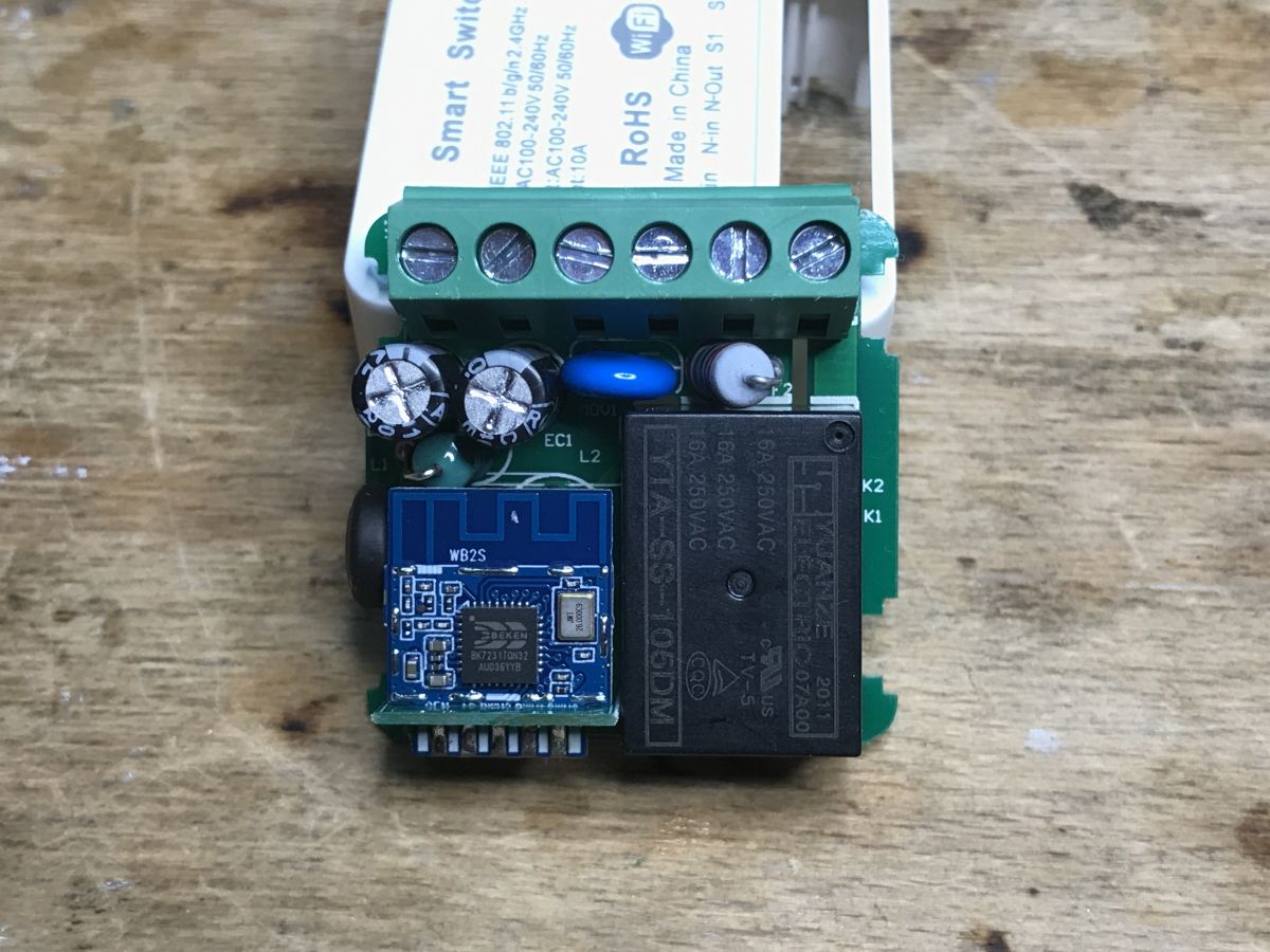

    UPDATE - ZN268131 is using WB2S. Guide and support is on the way:
    [BK7231T] My HTTP server, configurator, MQTT support from Home Assistant [BK7231T] My HTTP server, configurator, MQTT support from Home Assistant [BK7231T] My HTTP server, configurator, MQTT support from Home Assistant [BK7231T] My HTTP server, configurator, MQTT support from Home Assistant [BK7231T] My HTTP server, configurator, MQTT support from Home Assistant [BK7231T] My HTTP server, configurator, MQTT support from Home Assistant [BK7231T] My HTTP server, configurator, MQTT support from Home Assistant [BK7231T] My HTTP server, configurator, MQTT support from Home Assistant [BK7231T] My HTTP server, configurator, MQTT support from Home Assistant [BK7231T] My HTTP server, configurator, MQTT support from Home Assistant [BK7231T] My HTTP server, configurator, MQTT support from Home Assistant [BK7231T] My HTTP server, configurator, MQTT support from Home Assistant
    It's hard to flash because you have to cut the RX trace.
    Firmware backup (gotta send this to cloudcutter guys, along with photos so they can update their OTA list):
    ZN268131_..2s.zip (4.65 MB)You must be logged in to download this attachment.
    EDIT:
    @ferbulous are you here? I think I solved your problem. Your color range was 0-255 instead of expected 0-100. I added automatic scalling, I will commit changes soon. Can you retest?
  • #436 19984434

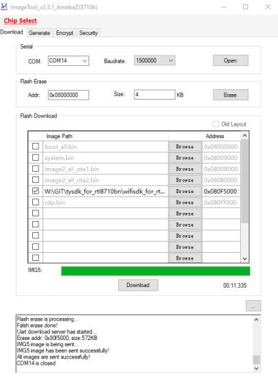

    Hello again,
    @p.kaczmarek2

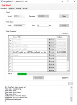

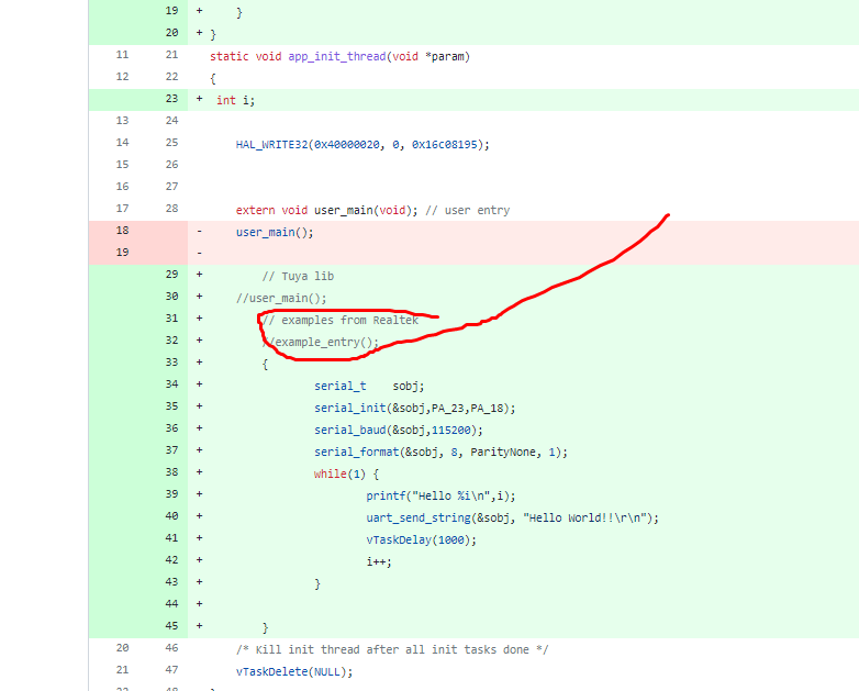

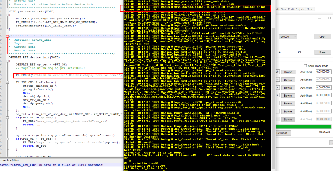

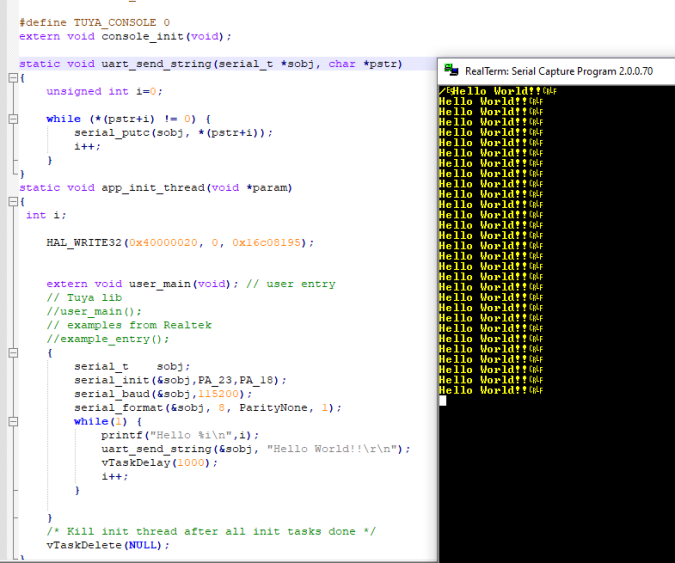

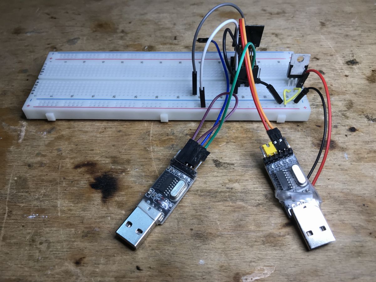

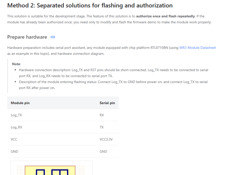

    By any chance, do you know how to flash the RTL8710BN? I've noticed you created a fork of tuya SDK for this module. Were you able to do this yet?
  • RTL8710BN flashing test and bootloader brick
    #437 19984465
    Posts: 14724
    Rate: 12806

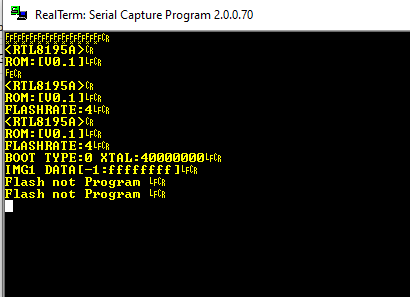

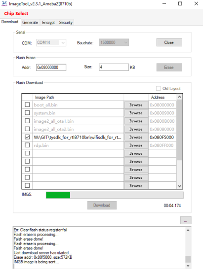

    @kuba2k2 Yes I know how to flash RTL8710BN. At first I considered it a dead case, but then a crazy guy with 96 bulbs showed up:
    and we struck a deal that I will do my best to support this chip, while he will send me a small donation of bulbs for testing.
    I already did a basic flashing test and managed to run "Hello world" on my single RTL that I had in my stock already:
    https://www.elektroda.pl/rtvforum/topic3815120.html
    NOTE: this is really this chip (uart log shows strange name):
    The test configuration:

    #439 19984498
    Posts: 14724
    Rate: 12806
    Where did you get WR3 from? Which RTL chip exactly is inside?
    It would be great if you wanted to help me with RTL firmware, at least check if it compiles correctly and try to get threads and pins and stuff running (without even porting OpenBeken).
    Run the "access point demo", etc.
    I will help you to get this programming, feel free to ask any questions in this thread and report your progress here. This is the main topic.
    https://developer.tuya.com/en/docs/iot/burn-and-authorize-wr-series-modules?id=Ka789pjc581u8
    the documentation above is a mess but all you should know is this:
    1. build with my SDK
    2. power chip with 3.3V
    3. ground RX , power off, power on (i. e. reboot with RX grounded)
    4. disconnect RX from ground
    5. rx and tx to USB to UART converter
    6. use https://github.com/openshwprojects/OpenRTL871...sdk_for_rtk_871x/tools/amebaz-image-tool-v2.2 to flash
    7. to run firwmare, reboot chip again
    As far as I know I am the first one to even flash this Tuya-flavoured chip so if you need help, ask here. But I've send you a PM.

    Okay, I have managed to flash this realtek. With your code I got "Hello world" on the other UART line, and with another code I actually got a working AT-like command shell.
    If you do a dedicated thread for the Realtek modules (not to pollute this thread too much), I can post a way of flashing it, because tuya's methods suck and don't work anyway.

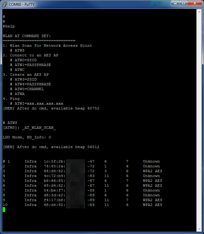

    #445 19985169
    Posts: 14724
    Rate: 12806
    Are AT commands able to create access point or join another WiFi network?
    I assume you just launched one of Realtek examples from this SDK:
    https://github.com/openshwprojects/OpenRTL8710BN
    There are #define like CONFIG_EXAMPLE_UART_ATCMD to select examples.
    And here you call example entry:
    See commit:
    https://github.com/openshwprojects/OpenRTL871...mmit/defd90389c455dc58f710d26941d391128463c3c
    Feel free to post information here. It will be closely related to OpenBK because I will port OpenBK to this platform as soon as I get RTL module. In any case, I can move posts, split topics, etc later
    No. I launched realtek's official SDK:
    https://github.com/ambiot/amb1_sdk
    It doesn't have ugly Tuya makefiles, tuya_iot.a libs, weird OTA images, and simply works. I would highly recommend you to base your following work on this SDK instead of the Tuya one. This amb1 is even documented; has PDF files and C API documentation. If you look closely, you can even find an Arduino core in ambiot.

    using ImageTool_v2.3.1, with Log_TX to GND during startup, flashing image2_all_ota1.bin to offset 0x0800B000.
    EDIT: I created a firmware dump of the stock bootloader and everything else, except for ota1 region. Will post it somewhere when I clean it up and split into appropriate files.
