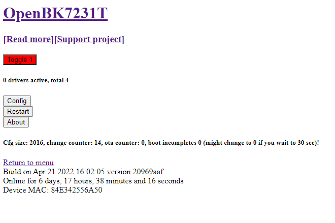

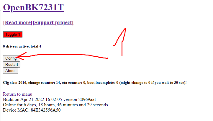

    @kuba2k2 I am sure that it stopped working just after I tried flashing image to different sector of memory by accident. I checked several times. Are you saying that should not happen?
    I have added a HTTP GET send command. It's now possible to simple script one device to trigger other device. More to come soon.
    XR809 water sensor demo is also on the way.

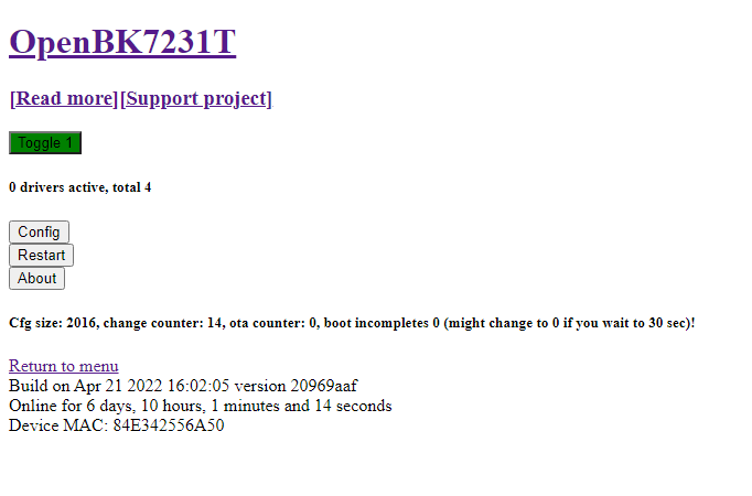

    Also, have you seen that? Almost a week uptime!

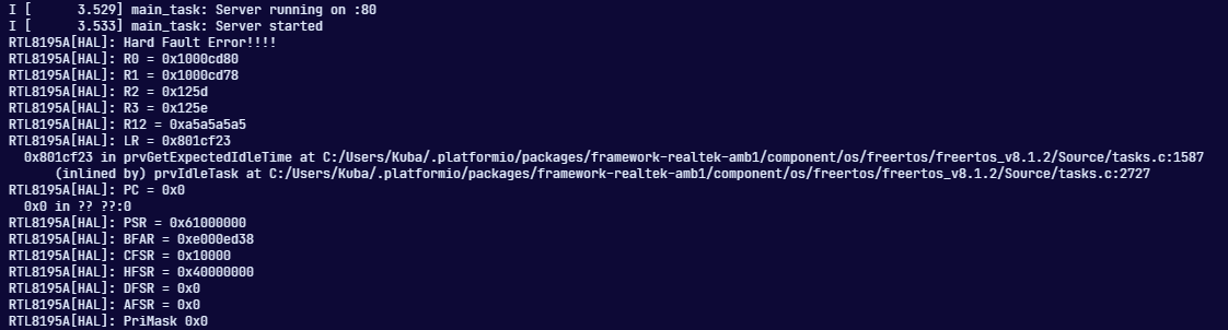

    Still, I am unable to test all possible scenarios and I suspect that the "crash" (or should you rather say, the disconnection from WiFI, because button is still working) is related to some WiFi bugs, maybe caused by overlapped WiFI channels, so I have decided to add extra failsafe just for you.
    This is always DISABLED by default, you have to enable it per device.
    It's called "ping watchdog", it pings a certain IP (preferrably your router IP) and if it fails to ping it for a given number of seconds, it forces a reconnect.
    Nice workaround. I too suspect a lower level issue. Since rebooting the "crashed" device it "took over" and the first one started to become unresponsive instead. Initially it seemed like same hardware MAC could have been the same but that would not render the "take over" scenario (or my router has serious security issues). My router shows different MAC nevertheless. The quest will go on.

    almost 7 days uptime here

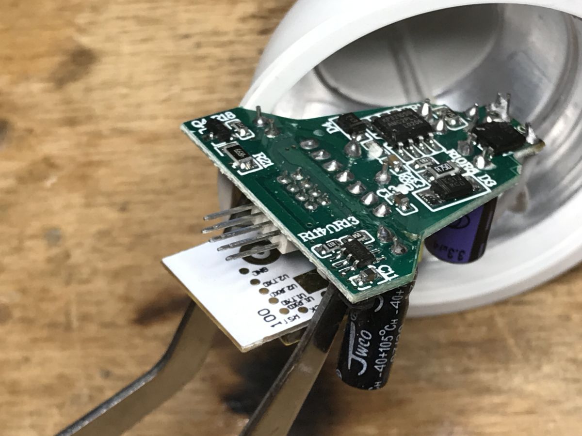

  • BK7231T bulb boots normally but BKwriter gets no response

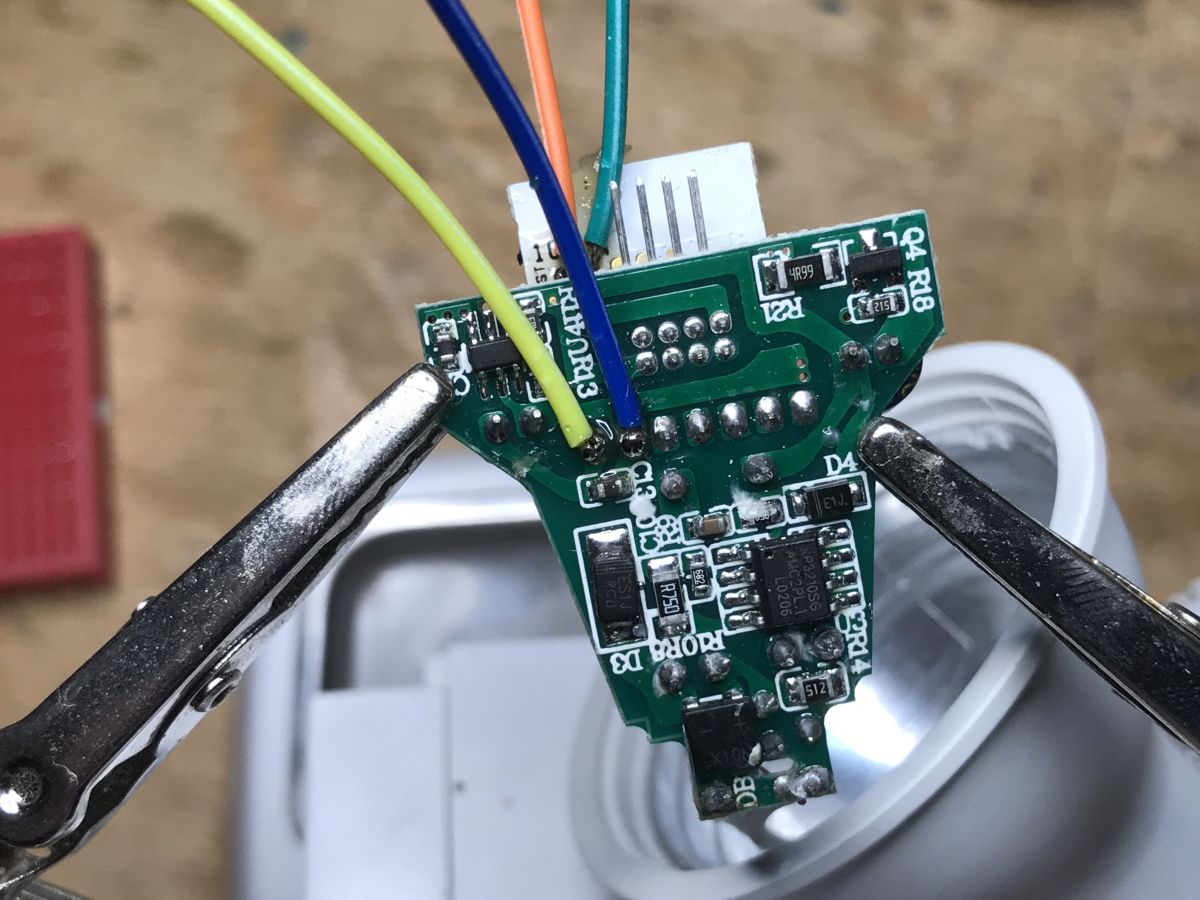

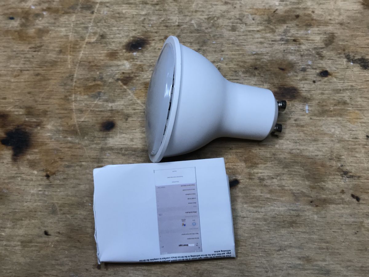

    #521 19998781

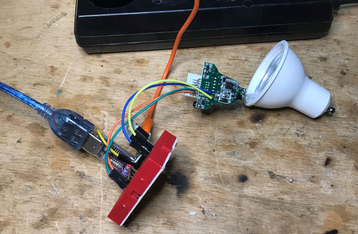

    Dark Man
    Posts: 74
    Rate: 20
    Hi

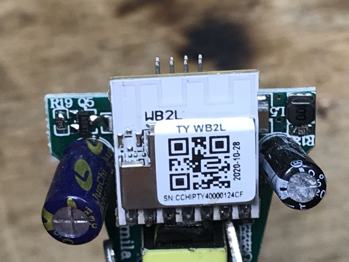

    Some time ago I bought a few bulbs from the Action promotion from the LSC Smart brand, more precisely the model (out of the box) 970 715.1 v1.1 (806 lumens E27 CCW)
    Unfortunately, but the ESP chip is not there either, and the WB2L is there (according to the BK7231T documentation)
    I knew that something was going on in the subject of alternative chips, so I did not regret the money spent :)

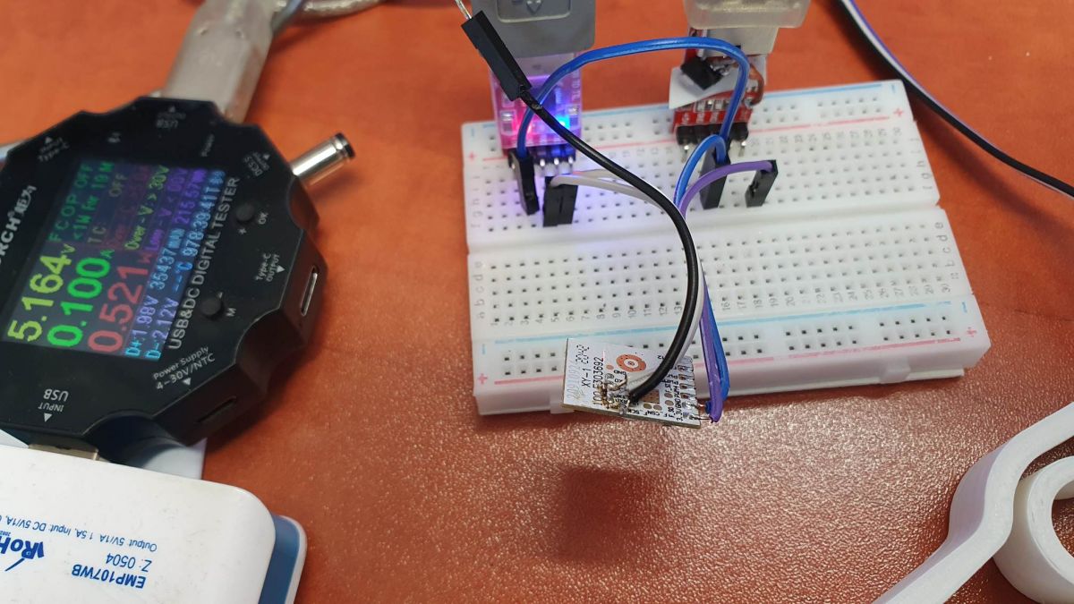

    - I mixed an adapter in the form of a clip for it [BK7231T] My HTTP server, configurator, MQTT support from Home Assistant
    - I desoldered this WB2L chip (stuck with some silicone glue)
    - I powered it from USB => AMS1117 3.3V => WB2L
    - connected to USB CP2102: RX to U1_TXD, TX to U1_RXD
    - I tried to download the firmware by BKwriter in ways that first connected the UART, then the power supply or the UART connected with the power supply and the RST field to ground per second
    No response from BKwriter.
    I also tried the same by connecting to the U2_TXD, U2_RXD pads - it did not do anything, except that I read the COM port monitor at startup:
    V:BK7231S_1.0.5

    It is not going to rip or upload the new firmware.
    Any advice?
    How many and how many pieces?
    Maybe try to do this:
    1. USB converter in 3.3V mode, ground to ground, RX to TX and TX to RX
    2. Power supply from LDO 3.3V from a separate, proven power supply
    3. in bkwriter, turn on read (we need the original batch for tuya-cloudcutter to be able to remotely program such products without opening the case - on the tuya-cloudcutter github you have to send them this batch and information from which specific product they would prepare an OTA hack)
    4. disconnect the power and reconnect for a while
    5. It should read
    If not, change the baud to the smaller or the second of the smallest (it never works on the slowest)
    An external power supply (or powerbank) because perhaps disconnecting and connecting the power supply results in too high current consumption (through the capacitors on the board), which resets the USB port at the moment when it should work.

  • BKWriter read still fails after power and reset tests
    #524 19999633
    Dark Man
    Posts: 74
    Rate: 20
    I bought bulbs, probably PLN 12 5 pcs.
    their regular price is PLN 18
    Regarding what to do:
    Ad.1 this converter only works in 3.3V logic. I have programmed all ESPs with it so far.
    As I wrote earlier, I connected CP2102 RX to U1_TXD, CP2102 TX to U1_RXD
    Ad.2 WB2L module as I wrote earlier - I power it from a separate USB port, also the voltage stabilizer AMS1117 3.3V with a capacity of 1A and then to the WB2L module
    Ad.3 and Ad.4 I tried to do Read - the time is 15s, at this time I tried to connect the power supply from the stabilizer again, as well as I tried to short the RST contact from the WB2L module to ground - BKwriter still ends with the FAILED message when it reaches 15s
    Ad.5 I tried to do at each of the three available speeds - with no results
    Now I also tried to power it from the powerbank => AMS1117 3.3V => WB2L
    [BK7231T] My HTTP server, configurator, MQTT support from Home Assistant [/ img]
    Just in case, I gave up the clip and soldered everything to rule out no contact with the fields on WB2L.
    WB2L module

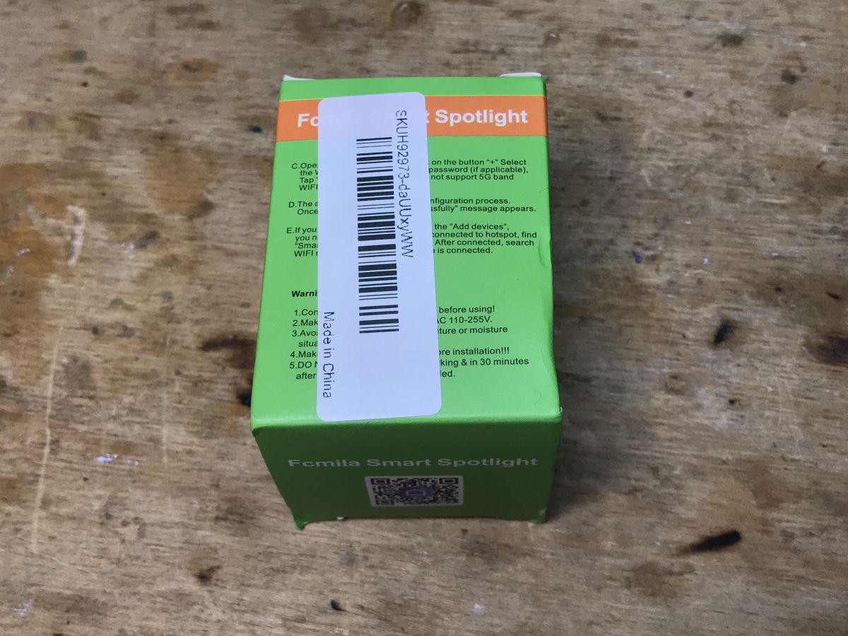

    #525 19999812
    Posts: 14724
    Rate: 12806

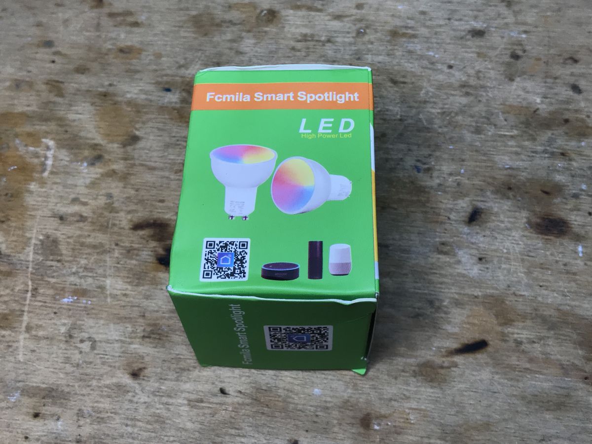

    @ darkman1 can be powered from a separate power supply [although how do you write that the power bank is the same ...]? Maybe another USB to UART converter? Why not try a Python programming tool? But I always have bkWriter 1.60 working and I program a lot of these modules
    It's hard for me to believe that you are definitely doing everything correctly. Take a look:
    [BK7231T] My HTTP server, configurator, MQTT support from Home Assistant [BK7231T] My HTTP server, configurator, MQTT support from Home Assistant [BK7231T] My HTTP server, configurator, MQTT support from Home Assistant [BK7231T] My HTTP server, configurator, MQTT support from Home Assistant [BK7231T] My HTTP server, configurator, MQTT support from Home Assistant [BK7231T] My HTTP server, configurator, MQTT support from Home Assistant [BK7231T] My HTTP server, configurator, MQTT support from Home Assistant [BK7231T] My HTTP server, configurator, MQTT support from Home Assistant

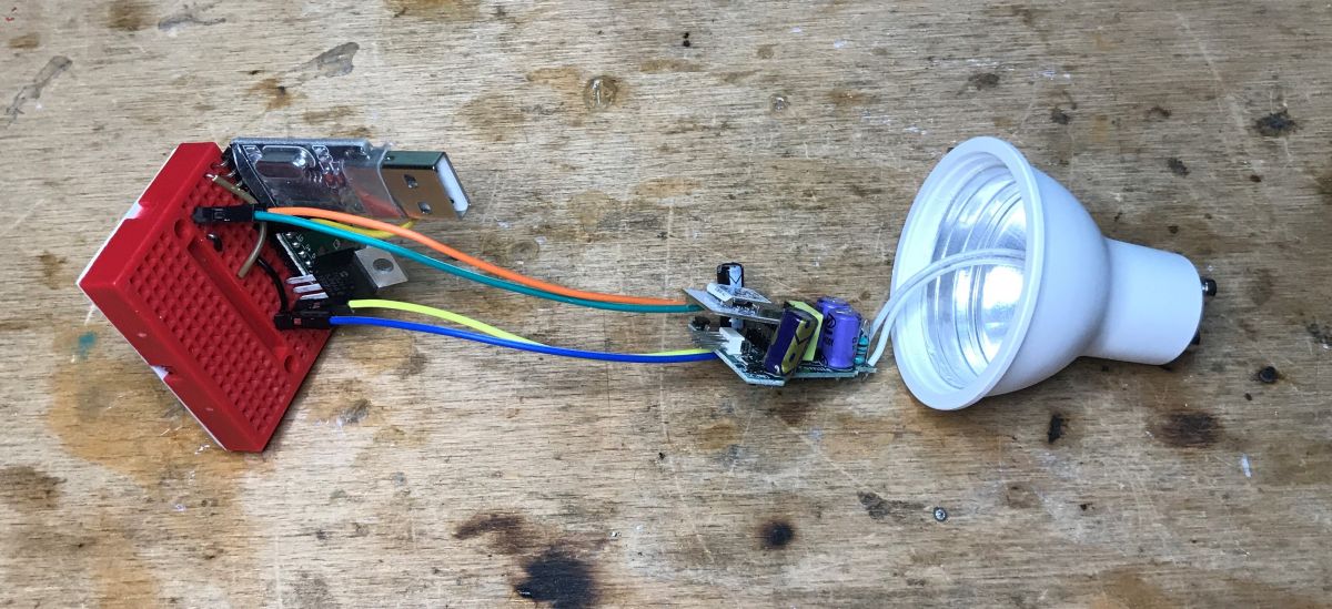

    FCmila smart spotlight. WB2L, the same module as you have. TC1264 LDO 3.3V powered from USB charger and USB to UART in 3.3V mode. BKwriter 1.60. Zero fun with CEN / RST, only by unplugging the power supply I do a reboot. It went without problems, for the 1st time.
    We even managed to rip the batch and send the men from tuya-cloudcutter, here:
    https://github.com/tuya-cloudcutter/tuya-cloudcutter/issues/76
    I think I will go to this Action and I will also try to buy something there for a trial ... then I would have a tuya-cloudcutter profile and you would already program remotely (i.e. I would send the input to people from tuya-cloudcutter).

    Sorry, I have been very busy. I may try to get to the external power supply version today to see if that will work. The SOIC-8s are both BP5778 so they are PWM.
    First of all, you haven't replied what is written on the SOIC-8 chips that are alongside the LEDs. It would be good to know, because @kuba2k2 could be wrong and if that's a I2C driver, then it still needs to be implemented. I would do I2C driver for those chips quickly, but I don't have such bulb at hand.
    For programming, you should follow one of the guides from the Teardowns sections.
    Never connect 5V directly to WB modules. I used to connect 5V to AMS1117-3.3V input (this LDO is often present alongside WB/Beken chips on boards), but in case of your bulb, I can't see where is the source of 3.3V so maybe it makes sense to use external 3.3V LDO to get external 3.3V. As for external LDO, I use TC1264-3.3V, but there many many low dropout regulators with 3.3V output. You could even take 3.3V from Arduino and it would work.
    If you are worried about big capacitor resetting USB, you can either get 3.3V from other port or source than the one used for programming, or use CEN method for resetting instead of repowering the chip.
    As per bullseye pattern... I haven't tested this module yet so I don't know. Still, there are only two possible options. None of the other chips had such a strange pad pattern for RX and TX. WB8P is unique in that manner.
  • #527 20000005
    Dark Man
    Posts: 74
    Rate: 20
    Managed to :)
    There were 2 problems.
    - my USB to CP2102 adapter did not work
    - I found the same one you have, i.e. on the CH340 chip
    - my powerbank disconnected the power supply because it detected too little power consumption
    THX
    Now it's time to re-solder the chip and reconfigure it.
    Enclosed is my dump - WB2L chip never paired with any network or application
    • bk7231s_dump-2022- 4-29-14-26-25.bin (956 KB) You must be logged in to download this attachment.

    Can you give me some pictures of the packaging or the model name of the bulb with the charge?
    The point is that in tuya-cloudcutter you choose what to flash and depending on this you need a different key or something (pulled from the batch), so the authors need to know what the batch is from.
  • 3000272-970715 profile likely fits LSC bulb

    By the way, yesterday I was in the Action store and it turns out that they have already changed the same bulbs again.
    Now there are new models on the front (same price), although I managed to get the model from the end of the shelf that I have :)
    Attached is a photo of both models - boxes from the front and the bottom.
  • UART download mode can recover bricked Realtek chips
    #536 20000859
    kuba2k2
    Posts: 120
    Rate: 13
    I have Banana Pi and Raspberry Pi Zero (the tiny one with only WiFi and no Ethernet port).
    Pi Zero should do. I posted debugging instructions in my docs here:
    https://kuba2k2.github.io/libretuya/docs/platform/realtek/debugging/
    So with this, you should be able to connect to your Realtek chip (even if it's bricked and appears dead) and force the uart download mode. If not, that can mean it's hardware bricked i.e. fried.
