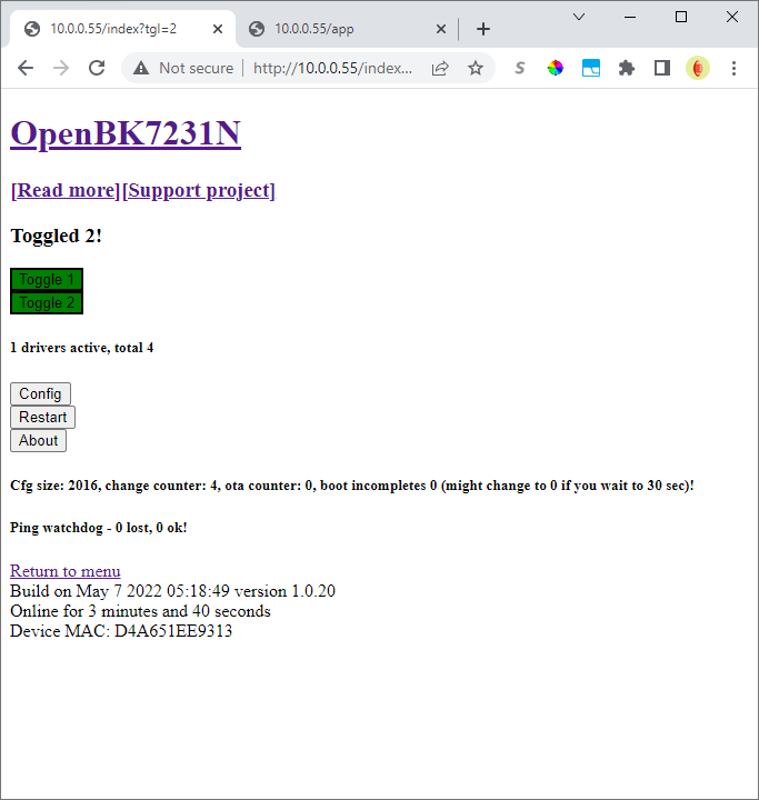

    Here is the basic draft of what has to be done:
    1. Cut the RX and TX tracks (between TuyaMCU and CB2S)
    2. Read the flash memory of CB2S (to be sure, do it several times) and send flash bin to tuya-cloudcutter guys so futher devices can be programmed remotely
    3. Flash OpenBK
    4. Connect tracks again
    5. Try the dpIDs from Tasmota page.
    See this: https://github.com/openshwprojects/OpenBK7231T_App/pull/75 for reference
    OpenBK script:
    // start MCU driver
    startDriver TuyaMCU
    // let's say that channel 1 is dpid1 - fan on/off
    setChannelType 1 toggle
    // map dpid1 to channel1, var type 1 (boolean)
    linkTuyaMCUOutputToChannel 1 1 1
    Check if it works, you can also do the same for light:
    // let's say that channel 2 is dpid9 - light on/off
    setChannelType 2 toggle
    // map dpid2 to channel2, var type 1 (boolean)
    linkTuyaMCUOutputToChannel 2 1 2
    Check if it works.
    [BK7231T] My HTTP server, configurator, MQTT support from Home Assistant [BK7231T] My HTTP server, configurator, MQTT support from Home Assistant
    It works. Got two relays toggling on/off. Click Click! Wahoo!!! Now I'll have to find a fan and light to connect to for further testing.

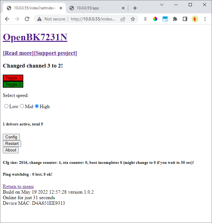

    Did I do this fan speed correctly? I really need to hook this thing up to my ceiling fan for testing, but I'm only one person, and I'm afraid I'd need 2 people to do it! I have a 3-speed portable fan in the back room I will try to hook it up to that for now.
    I added to my script:
    //channel 3 is dpid3 - fan speed
    setChannelType 3 LowMidHigh
    // map dpid3 to channel3, var type 4 (enum)
    linkTuyaMCUOutputToChannel 3 4 3
    And now I have fan speed control in the UI

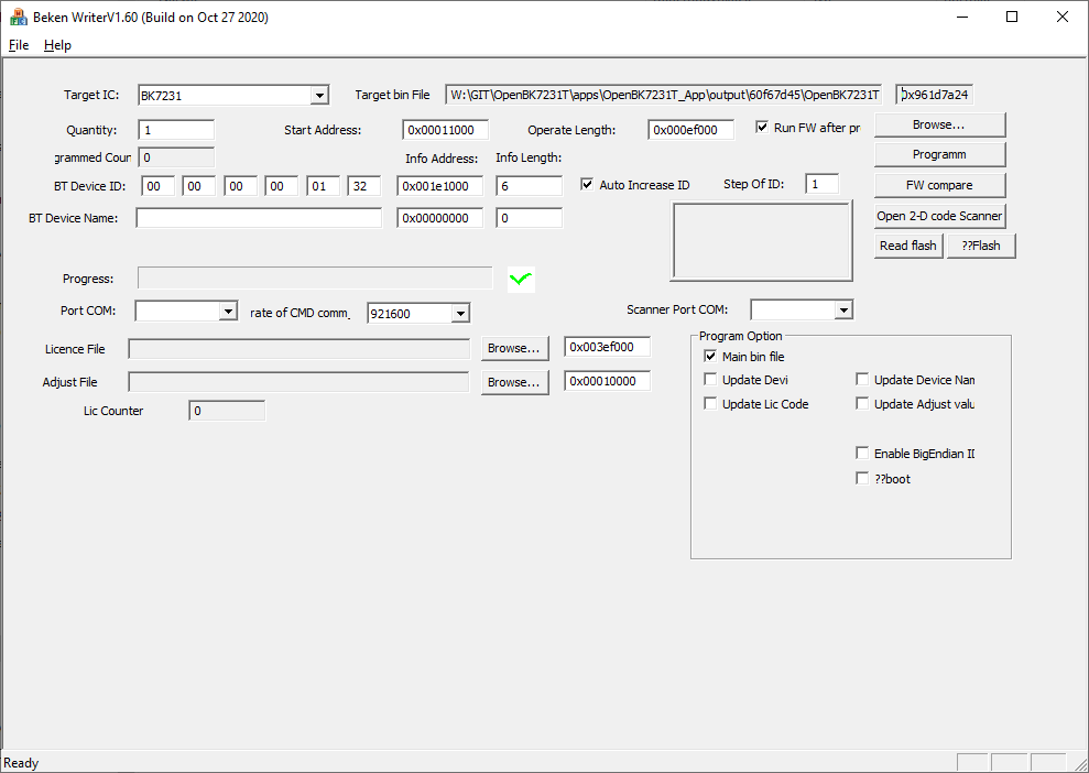

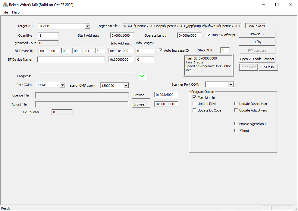

    The flash procedure is following:
    1. connect UART to PC , start bkwriter
    2. select UART in bkWriter, press Read (it should start trying to connect), also better set full 2mb read
    3. connect the second cable for power, the bkWriter should start actively reading
    [No screenshot, but you will see the read progress on the UI and a progress bar filling with green bars]

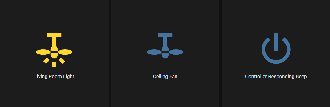

    Well I got up on the ladder and put the fan controller in the fan. Fan on/off works. Light on/off works. Fan speed Lo/Mid/High also works.
    I found dpid17 = beep on/off so I added to the script:
    //dpId 17 = beep on/off
    setChannelType 6 toggle
    linkTuyaMCUOutputToChannel 17 1 6

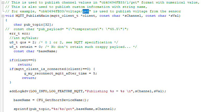

    Btw, @echojjj , I am not sure if you already got this, but if you map, for example, the beeper to to channel 6, you can easily control it from MQTT. Home assistant Yaml:
    switch:
      - platform: mqtt
        state_topic: "obk61B58A1C/6/get"
        command_topic: "obk61B58A1C/6/set"
        qos: 1
        payload_on: 0
        payload_off: 1
        retain: true
    this should work for relays as well, of course...
    basically, the way to access channels is by :

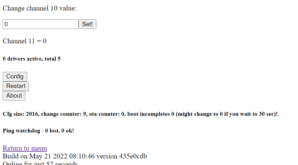

    Ok @echojjj , now regarding the timer....
    What do we know?
    dpid6 - self timer (0 = off, 1 = 1hr, 2 = 2hr, 4 = 4hr, 8 = 8hr)
    dpid7 - timer remaining

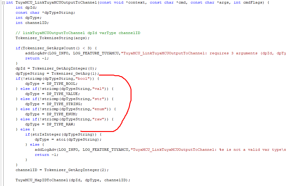

    Do we know, from Tasmota docs, what is the type here for dpid6 and 7? Are they enums? Or raws?
    The dpid6 is to set and dpid7 is read only? Is that correct?
    I added two debug channel field types, let's test how it works.
    // here you will be able to enter value
    setChannelType 10 TextField
    // this will only display value
    setChannelType 11 ReadOnly
    channel numbers can be any value (that is not used yet)
    // linkTuyaMCUOutputToChannel dpId varType channelID
    // dpId  6 is for setting, link to text field
    linkTuyaMCUOutputToChannel 6 enum 10
    // dpId  7 is for reading, link to display field
    linkTuyaMCUOutputToChannel 7 val 11
    I am not sure if "enum" and "val" are correct here, you must try if it works and if not then try different modes...
    so add the scripts command i shown (for example, from console without restarting, if you dont want to change your config, or by config and then restart)
    you will get smth like this:
    Test it by entering, for example, 1 to text field, press "Set" (this will send 1h delay),
    then click "Return to menu" to refresh page, and check if value frm field 11 (timer remaining) changes...
    of course those channels types are for testing only, we will create a better UI later

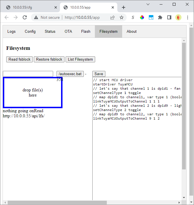

    #606 20027910
    echojjj
    Posts: 20
    Rate: 13

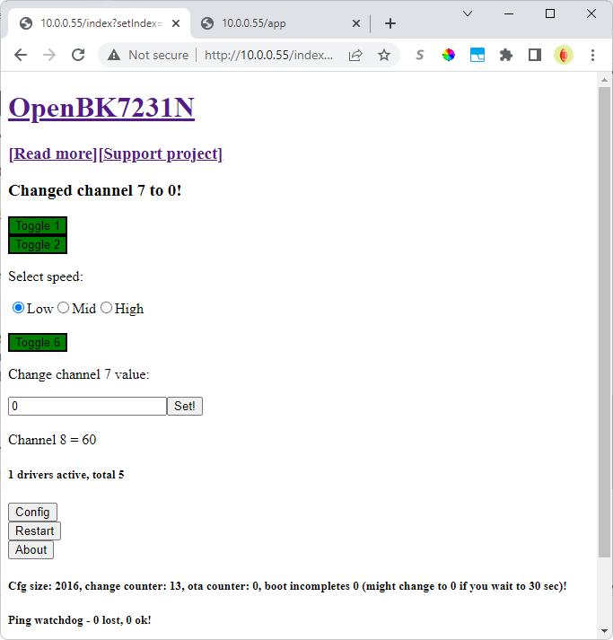

    Got it! I have actually had to OTA a few times now because if I change my config and press SAVE button it doesn't always save correctly. Like if I have made the file smaller, it keeps some that I have deleted at the end of the file. Like this, this is the last line after I pressed SAVE (and after reloading the file in the editor):
    linkTuyaMCUOutputToChannel 7 2 8nnel 17 1 6
    Here's my config. I think it's correct.
    // start MCU driver
    startDriver TuyaMCU
    // map dpid9 to channel2, var type 1 (boolean)
    linkTuyaMCUOutputToChannel 9 1 2
    //dpId 6, dataType 4-DP_TYPE_ENUM = set timer
    setChannelType 7 TextField
    linkTuyaMCUOutputToChannel 6 4 7
    //dpId 7, dataType 2-DP_TYPE_VALUE = timer remaining
    setChannelType 8 ReadOnly
    But something's a little off. I'll test more and try to find out what exactly is happening.
    It's like if I set 1 and refresh time remaining = 60. Then, if I set 2 and refresh timer remaining = 60. Then, if I set 1 and refresh timer remaining = 120. I haven't quite figured that out.
    Also setting the timer to 0 doesn't do anything. There's no way to cancel the timer on the RF remote either. Maybe just turn fan off I guess.

    Yes! I have already added to Home Assistant and already have voice control for my fan and light using Alexa via Node-RED!
    Really? It must be a bug, I will check this out. It seems that our LittleFS contributor didn't test it well enough before submiting a pull request.
    Great find.
    First of all: are you aware that if you set a timer to certain number of hours, and refresh by browser "refresh" button, it will resend the 'set the timer' command? This is because the command is a get request to http server. You should refresh by "return to menu" button.
    I will improve the html page later, maybe make it autorefreshing with Ajax.
    I will add soon ability to set better names for channels so you can create labels like "Fan speed", "Set timeout [h]", "Remaining minutes", etc. What is also left to do?

  • MQTT state topic missing in current version
    #613 20028689
    echojjj
    Posts: 20
    Rate: 13
    What if you wait few seconds between refreshes, maybe TuyaMCU needs to send back a reply?
    Aside from that, are there any other problems or issues?
    You're right... I didn't check logs on this initially but it's true I have to wait.
    echojjj wrote:
    MQTT publish
    topic: ceiling-fan/7/set
    payload: x
    x = 0/1/2
    it should be working, try it from Home Assistant MQTT publish tool (the one used to ease the development)
    I don't think it works. Do I need to recompile?
    Both would be major improvements! Looking forward to it!
    Also, I have no mqtt topic "get" with this version. It would be helpful to follow state.
  • MQTT fan speed channel uses topic 3
    #614 20028736
    Posts: 14724
    Rate: 12806
    @xabean good work, which JTAG programmer do you use with that? Would ST-Link V2 work?
    From a quick glance at opencd documentation it seems yet:
    Interface Driver: st-link
    This is a driver that supports STMicroelectronics adapters ST-LINK/V2 (from firmware V2J24) and STLINK-V3, thanks to a new API that provides directly access the arm ADIv5 DAP.
    The new API provide access to multiple AP on the same DAP, but the maximum number of the AP port is limited by the specific firmware version (e.g. firmware V2J29 has 3 as maximum AP number, while V2J32 has 8). An error is returned for any AP number above the maximum allowed value.
    Note: Either these same ad
    @xabean which platform have you used for SPI flashing? I have one locked device and will need to unlock it someday. @btsimonh managed to flash by SPI on Raspberry, but reported problems with Arduino
    echojjj wrote:
    echojjj wrote:
    MQTT publish
    payload: x
    x = 0/1/2
    it should work. Also, judging from your config here:
    the Fan Speed channel has assigned number 3, not 7. Maybe you are just using wrong number?
    Yes you're right... tired eyes and sevens taking over the brain - I apologize.

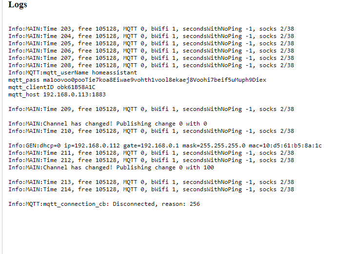

    #622 20029509
    theosoft
    Posts: 37
    Three remarks / Bugs ??
    1. OTA directly from Github failes. HTTP vs. HTTPS. Device log says: "not found"
    2. Webapp server down ? Git is also empty... Any change i missed? I host webapp from my server and just tested it today with the official source
    Update: Effect is related to Pi-hole :-) ... somehow
    Added after 11 [minutes]:
    3.
    What is the right value for "switch" ??
    This is in the log, when i use the buttons on the device ...
    Info:MQTT:Publishing 1 = 0
    Info:MQTT:Publishing 1 = 100
    here is the log, when homeassistant is used for switching ...
    Info:MQTT:MQTT client in mqtt_incoming_publish_cb topic br-ks-811-3-001/1/set
    Info:MQTT:MQTT in topic br-ks-811-3-001/1/set
    Info:MQTT:channelSet topic 4205788
    Info:MQTT:channelSet part topic 1/set
    Info:MQTT:channelSet channel 1
    Info:MQTT:MQTT client in mqtt_incoming_data_cb data is 1 for ch 1
    Info:MQTT:MQTT client in mqtt_incoming_data_cb data is 0 for ch 1
    0,1 vs 0,100
    There is a missmatch in the channel value. I think 100 is wrong .... (Dimmer max value?)
    regards
  • Switch channel value should not be 100
    #623 20029555
    Posts: 14724
    Rate: 12806
    Are you sure about that?
    App works for me.
    Let's check...
    Hm it seems you are correct. But does it affect the Home Assistant in any negative way?
    The 100 is here because the Toggle code was changed to also work with dimmers, but maybe it should be smart enough to detect how is the channel used.

    Added after 4 [minutes]:
    Ok, is this what you needed?
    https://github.com/openshwprojects/OpenBK7231...mmit/de813f9d73270aec7b88a2b81223f867d592ab00
    Please double check and report any futher issues, I will try to fix them ASAP
    Quick check ....
    Hmmm, why not inside of the loop? "Find right value" per channel? What happens in mixed configs?
    Quick check 2:
    A single query... so may work ...
    Real check. flashing 1.2.2 solved it. Now the value toogles between 0 and 1. HA is updated correct.
    Thank you :-)
    regards...

  • #629 20029865
    theosoft
    Posts: 37
    Regarding value's...
    Webapp is also sending 100 :-( --> update issue for HA. Value fix has to be made also for webapp.
    regards
  • #630 20029870
    Posts: 14724
    Rate: 12806
    @theosoft webapp is maintained mostly by @btsimonh , so I will have to look where is this value set. I will try to do it tomorrow. If you happen to find it earlier, make a pull request, I will merge it as I have a full access to app repo.
    EDIT: most likely here: https://github.com/OpenBekenIOT/webapp/blob/gh-pages/vue/control.vue
