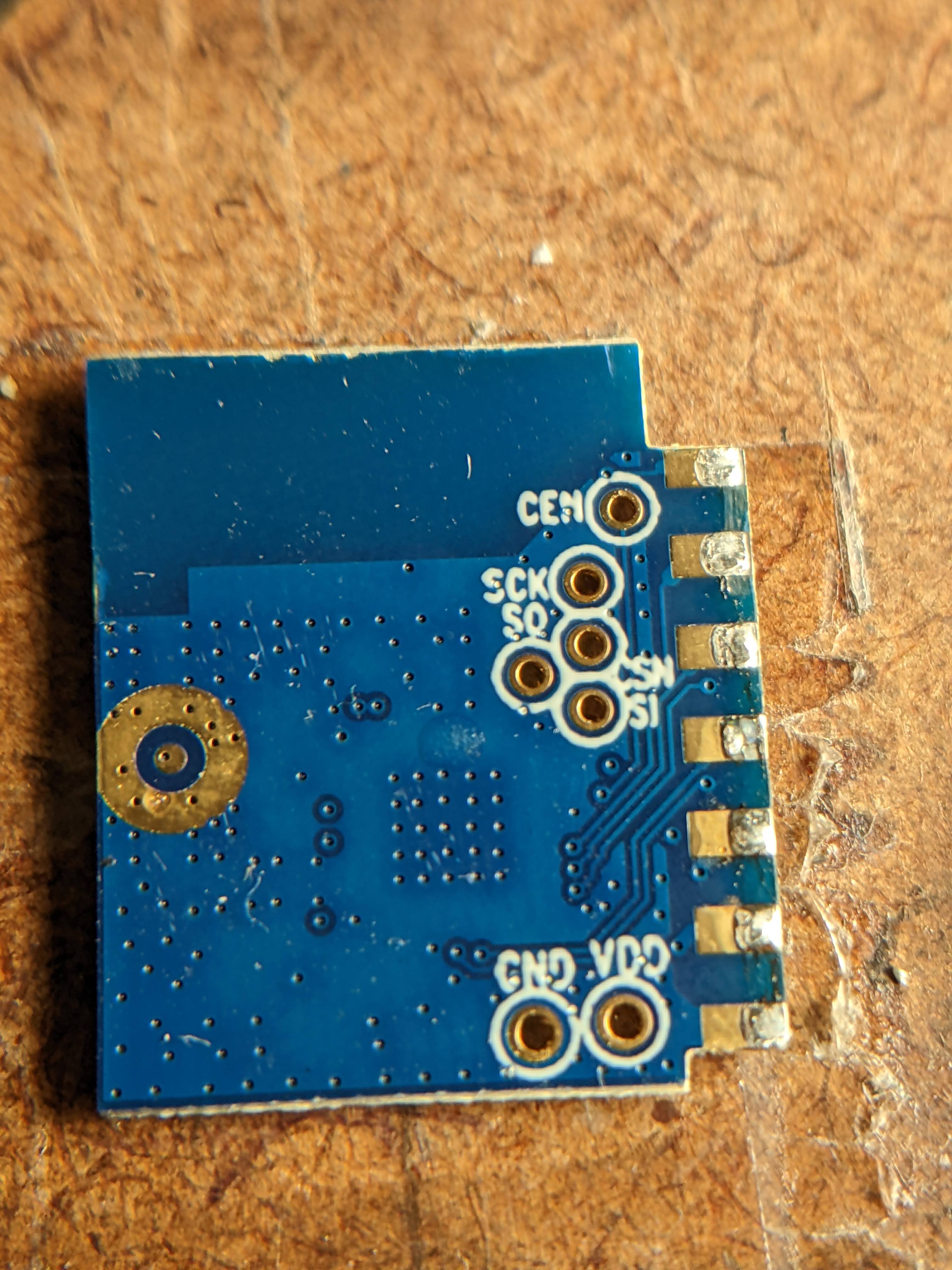

    xabean
    Posts: 13
    Hello! I am trying to flash OpenBK7231T_UA_1.0.20.bin via SPI to a WB3 module with a BK7231T microcontroller -- I've successfully dumped the factory firmware, but nothing I flash seems to bring up a new WIFI access point? I don't yet have 3.3v TTL serial connected to the WB3 module, I still need to figure out where the UART pins are on the edge of the module.
    OpenBekenIOT/hid_download_py/SPIFlash.md mentions that writing firmware directly to flash requires "executable partitions must be encrypted and packaged (32->34 bytes with CRC)." -- are the releases of .bin files at openshwprojects/OpenBK7231T_App/releases/tag/1.0.20 not encrypted or missing CRC?
  • Requesting full flash dump for OTA hack support
    #579 20011734
    Posts: 14724
    Rate: 12806
    @xabean please send device model name + photos + flash dump (full 2mb if possible) to tuya cloudcutter guys, or send it here, I will forward it to them, so they can do OTA hack for your device.
    Regarding your question... I don't understand you.
    1. If you have no 3.3V UART connected, then how did you managed to read the firmware dump?
    2. Why SPIFlash.md ? It has nothing to do with UA, you just use bkWriter 1.60 and that's it. UA is a correct file to write with Beken Writer or python tool by UART.
    3. WB3 = WB3S?
    Look at my guide:
    https://www.elektroda.com/rtvforum/topic3875654.html
    @echojjj can you dump whole 2MB with bk7231tools?
  • SPI flash dump and WB3 module identification
    #580 20011844
    xabean
    Posts: 13
    (I couldn't make this post without breaking all the links, 5th try is the charm?)
    It's the same smart outlet as Glaedr304 over in post #28. Aoycocr model X5P, or FCC ID 2AKBP-X5.
    I have my raspberry pi connected as a SPI flash programmer/reader, with the spiprogram tool from OpenBekenIOT/hid_download_py
    It works great! I saw the RBL, bootloader, and app regions in the firmware. I know you prefer using the UART programming method, but I appreciate having a _full_ and _complete_ dump of the firmware, in case I brick it. Either I'm doing something wrong, or there isn't yet a process for flashing OpenBkenIOT over SPI written yet. I'm interested in figuring that out, and will make a github pull request to document it when I get it working :)
    3. WB3 = WB3S?
    Look at my guide:
    (removed)
    WB3, according to the silkscreen on the PCB. Here are some close ups. The WB3 module edge is right up against the plastic and I haven't yet ohm'd out where the RX/TX/VCC/GND pins are on the edge. I have easier access to the SPI pins without having to unsolder the module:
    Here's close ups of the WB3 module from one XP5 I completely tore apart:
    I've attached the firmware dump, this was before ever plugging it in. I hope these help!
    $ sha1sum Aoycocr_X5P_0x000000-0x1fffff.bin
    95797fedac634e18b65d261ebf37e718a3b692b3  Aoycocr_X5P_0x000000-0x1fffff.bin

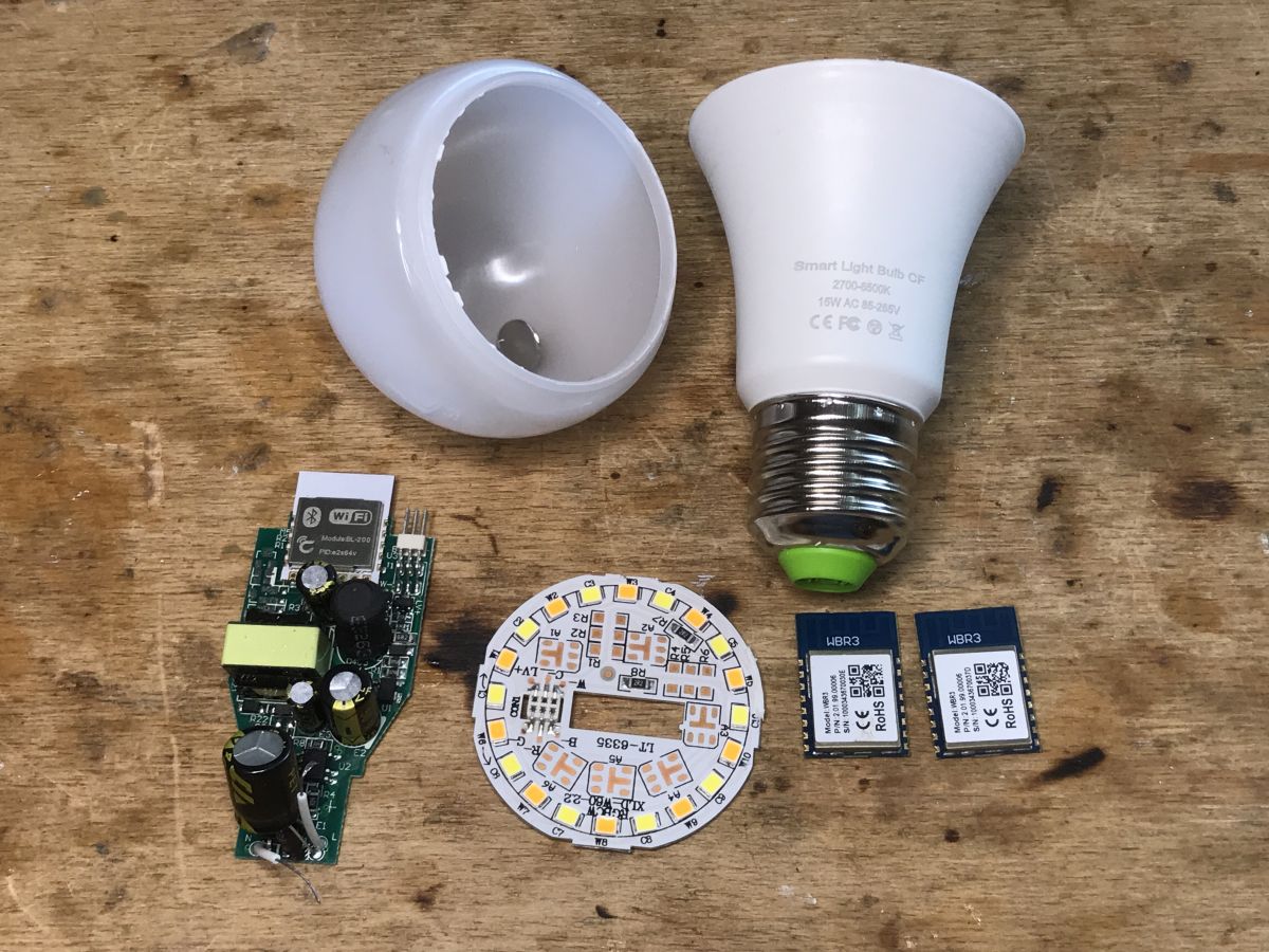

  • BK7231T footprint photographed after desoldering module
    #588 20012377
    Posts: 14724
    Rate: 12806
    @echojjj I am finalizing the work on your donation. That was really a new BK7231T module! I have never seen such a thing before. I desoldered it with hot air to make a photo of pins footprint.
    Desoldering:
    Done:
    Footprint:
    Cleared pads:
    Soldering back:
    I also had to remove button, because otherwise hot air would burn it. But don't worry, I put it together and it still works!
    @sharathbk1912 please wait patiently or help me testing. I think that my led driver, described here:
    https://www.elektroda.com/rtvforum/topic3880540.html#19938487
    can work in all modes, RGB, CW, you just skip rgb or cw syntax part of Yaml for Home Assistant, and when numbering channel, keep R = 1, G = 2 , B = 3, C = 4, W = 5 numbering (if no RGB, then leave channels 1 2 3 empty).
    As for single channel, that's easy, just use autogenerated yaml... I think.

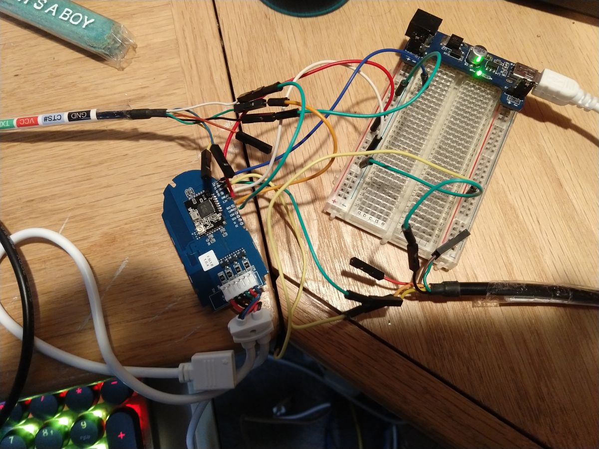

  • UART access via Raspberry Pi 3.3 V TTL adapter
    #589 20012757
    xabean
    Posts: 13
    kuba2k2 wrote:
    Did you erase the flash chip prior to writing? Also try using flashrom (on raspberry pi) after putting BK into SPI flash mode.
    No, but wouldn't that erase the wifi calibration data at [offset I remember seeing someone identify]?
    I can successfully restore the factory firmware (all 2Mbit of it) and see it work immediately after flashing with spiprogram because it broadcasts via bluetooth a "TY" bluetooth device. I didn't even have to connect CEN to ground to reboot it! It just immediately came to life. I don't think I need to use flashrom just yet. :)

    If you have issues with bk7231utils, then try this back in hid_download_py:
    Code: sudo python3 uartprogram firmware.bin -r -b 115200 -s 0x0 -length 0x200000
    FTDI kept disconnecting mid-dump, had to switch to windows machine.
    python uartprogram firmware.bin -r -d com3 -b 115200 -s 0x0 -l 0x200000
    • firmware.zip (1.03 MB) You must be logged in to download this attachment.

    is what I get after flashing OpenBK7231T_App_QIO_4e00c04f.bin via SPI. Does that sound like it's getting stuck jumping to 0x10000?
    V:BK7231S_1.0.5

    is what I get from putting the factory firmware back.
    Added after 2 [hours] 56 [minutes]:
    Ok, lesson learned: don't try to uartprogram dump from offset 0x0, it doesn't like that.
    I successfully managed to flash Obk with uartdownload, and have it bring up a wifi access point -- I'm dumping the firmware over SPI now to see what the difference is.

  • Bkwriter flash read failing on BK7231T setup
    #600 20025730
    jimbolaya
    So, the suggested setup is:
    - USB to UART converter with 3.3V logic levels connected to programming RX TX port
    - extra 5V power supply (maybe from second USB port if they dont reset together) connected to 3.3V LDO connected to board (Beken chips are 3.3V only).
    I've got the UART connected and I've powered the chip through a 3.3v breadboard power supply. I have TX2/RX2 connected to a second TTY to see if I can see anything and I'm getting messages. It appears to be a standard tuya load. Here's the screen log:
    screenl...txt (5.67 kB)You must be logged in to download this attachment.
    Procedure is:
    1. start bkwriter read (first read flash to backup it)
    2. power off and power on board
    3. the bkwriter will do whole read after reboot of the board
    Unfortunately, reading the flash fails. I'm not sure if I should wait to write the flash before I can read it. In the Beken Writer app, the "Scanner Port COM" is blank, even if I plug both TX/RX and TX2/RX2 in.
    I can also provide 5v either by plugging in the USB (which wasn't advised) or using the 5v from my breadboard power supply into the USB VCC, but I'm not sure that's necessary. I tried reading the flash either way and was unsuccessful.
    Let me know what you think the best next steps are.
    Here's my setup:
