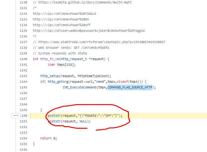

    Posts: 37
    In control.vue line 188 ff ....
         channelclick(channel){
            if (this.channels[channel]) {
              this.channels[channel] = 0;
            } else {
              this.channels[channel] = 100;
    But just change the value is to simple, isn't it??
    regards
  • #632 20030147
    Posts: 14724
    Rate: 12806
    If you change 100 to 1 then you will break the toggling on-off of PWM dimmer. App needs to know whether a channel is a dimmer or relay/led/something else binary.
  • Vue channelclick toggles relay outputs to 1 or 100
    #633 20030630
    theosoft
    Posts: 37
    In control.vue
            } else {
              if (this.outputchannelrolenames[channel] === 'Rel' || this.outputchannelrolenames[channel] === 'Rel_n'){
              this.channels[channel] = 1;
                      } else {
            this.channelchange(channel);
    Update: I successfully have done a pull request....

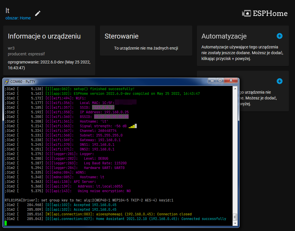

  • ESPHome core ported to RTL8710BN and LibreTuya
    #638 20034962
    kuba2k2
    Posts: 120
    Rate: 13
    Hello again,
    Today I was able to run ESPHome on RTL8710BN - I'm probably the first in the world to do this :D
    I've ported the core of ESPHome to work with LibreTuya, so WiFi and HomeAssistant API connection works. After I port other peripherals (such as I2C, SPI, GPIO, ADC, PWM) most sensors supported by ESPHome should work out of the box - without the need of writing new drivers by hand.
    As LibreTuya is made to be universally compatible with each platform (requiring minimal porting/HAL), it means that porting ESPHome to BK7231T/N or something else should now be a breeze...

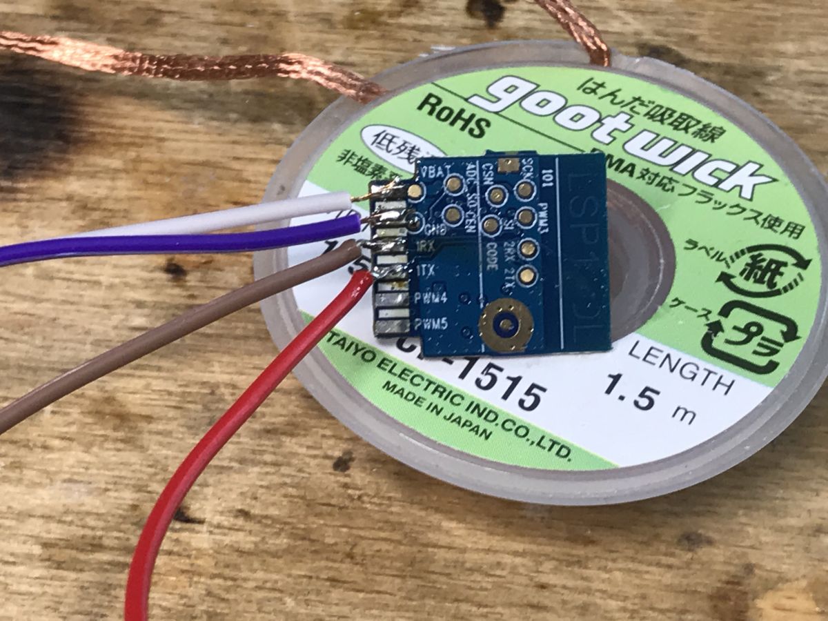

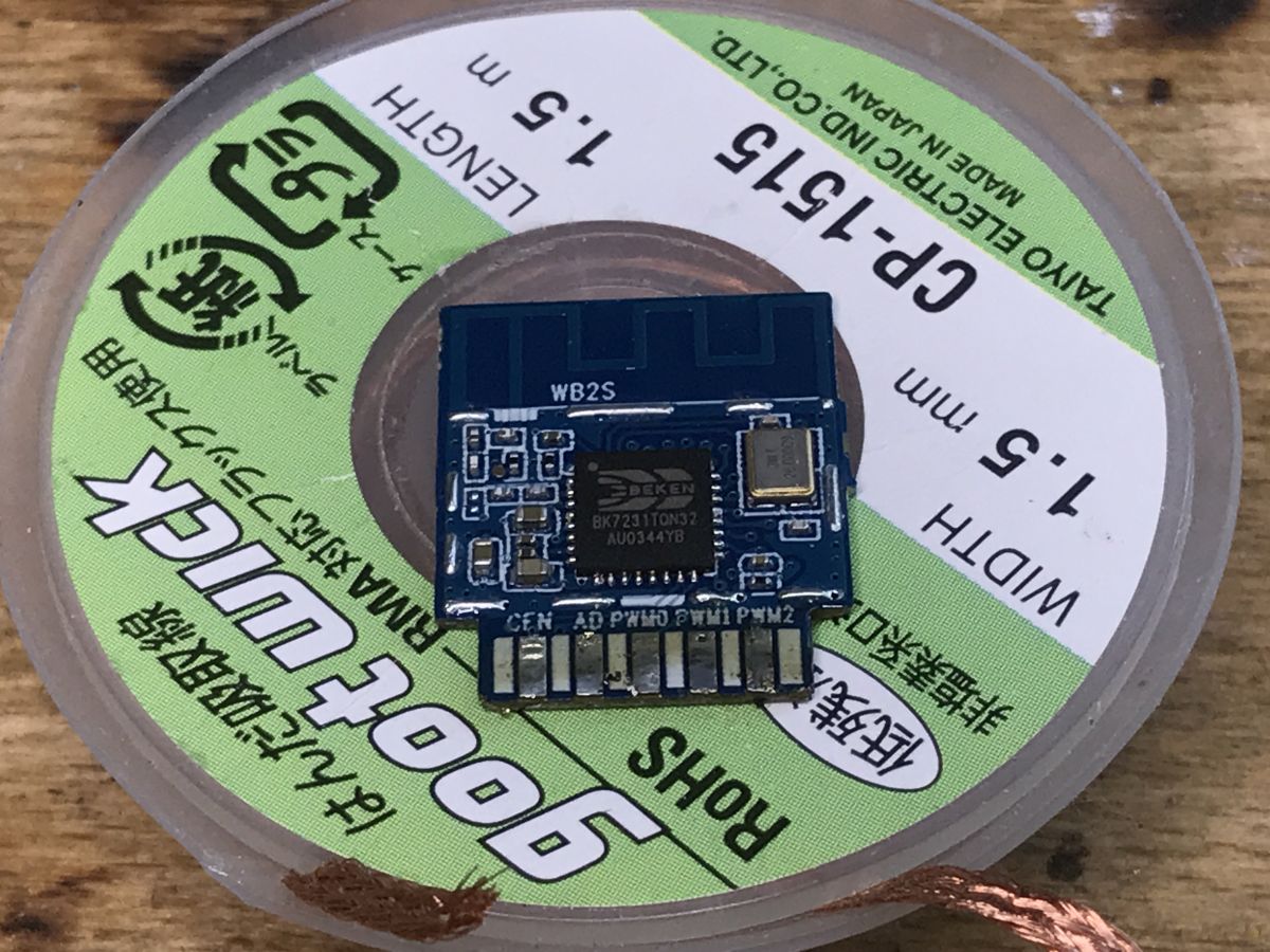

  • RX1 pad may be tied to the power button circuit

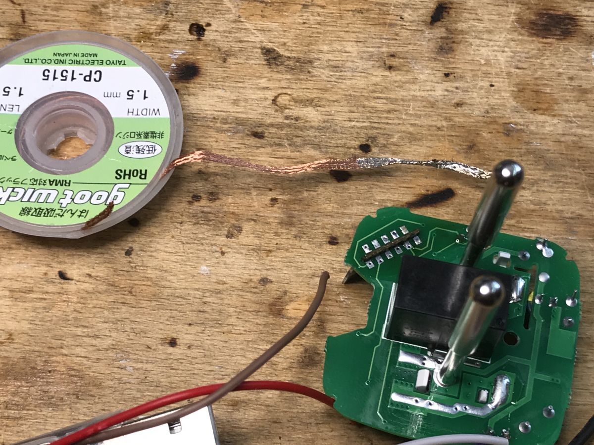

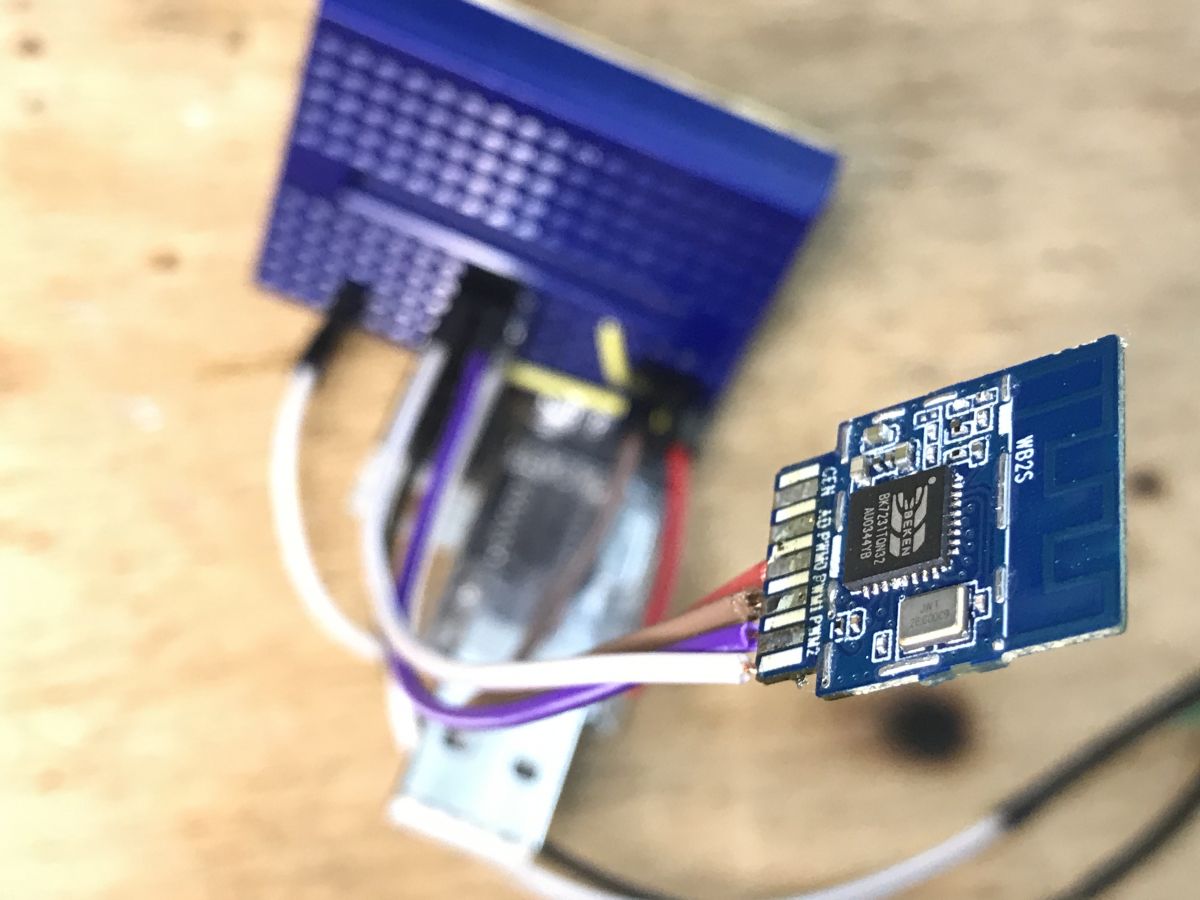

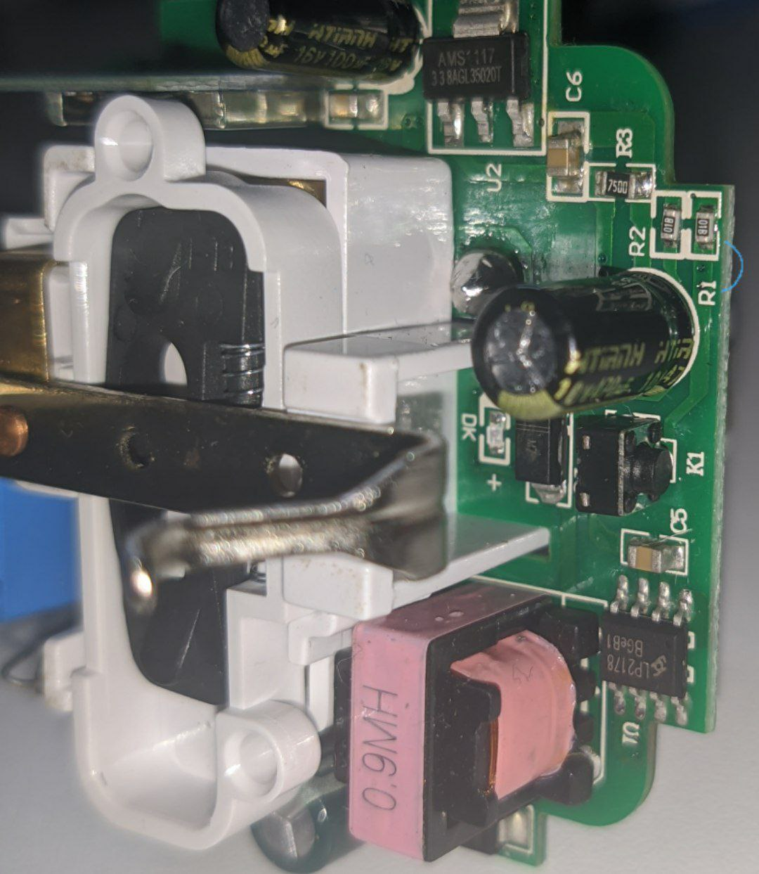

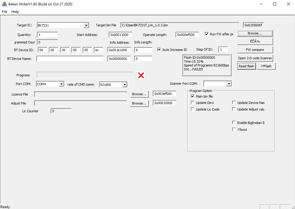

    #646 20038557
    pepesuriano
    Posts: 33
    pepesuriano wrote:
    UART has been impossible to me and I cannot find info on how to flash with SPI.
    did you read @DarkMan1 post? he had issues with CP2102 UART to USB converter but CH340 worked for him, maybe you need second usb to uart converter as well?
    I have flashed a lot of bk devices and all of them worked so far.
    Hi, I tried with an arduino UNO (which has CH340), it's still not working, here is what I tried:
    - Wired TX and RX to arduino UNO RX and TX (it seems to be ok since I can hear the relay clicking when I hit the "read flash" button on bkwriter, if I do nothing the relay stops clicking
    - wired 3v3 from arduino to VBAT on WB2S and GND as well
    - removed 3v3 and connected 5v from arduino to 5v input of AMS1117
    The result is always the same:
    As mentioned, I assume RX and TX is ok since the relay starts clicking when I hit "read flash", I tried all baudrates and BK7231/BK7231N modes, nothing works for the moment :(
    A new finding that can be useful, I found that RX1 pad is connected to R1 resistor and K1 (power button), can that be part of the issues?
    Here some pictures for guidance (look trace with yellow question mark):

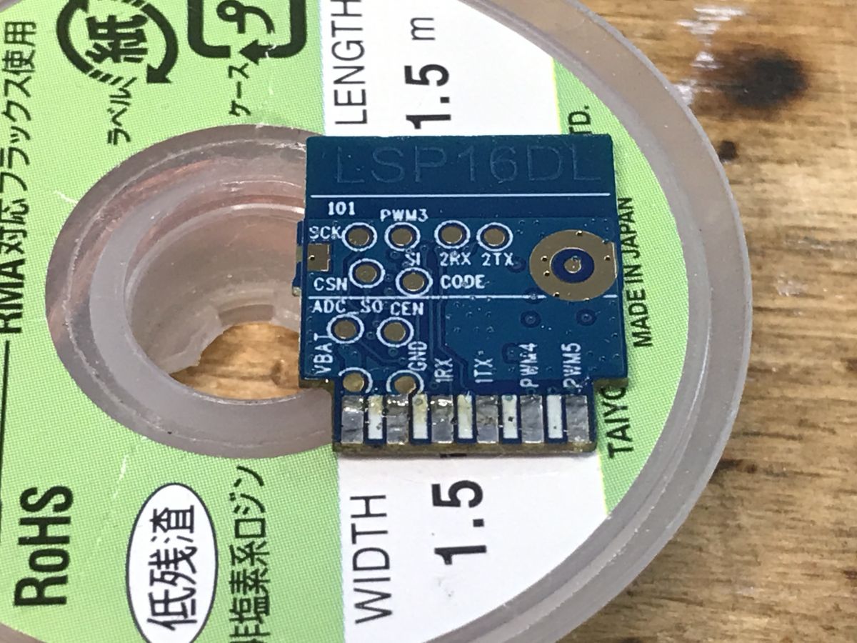

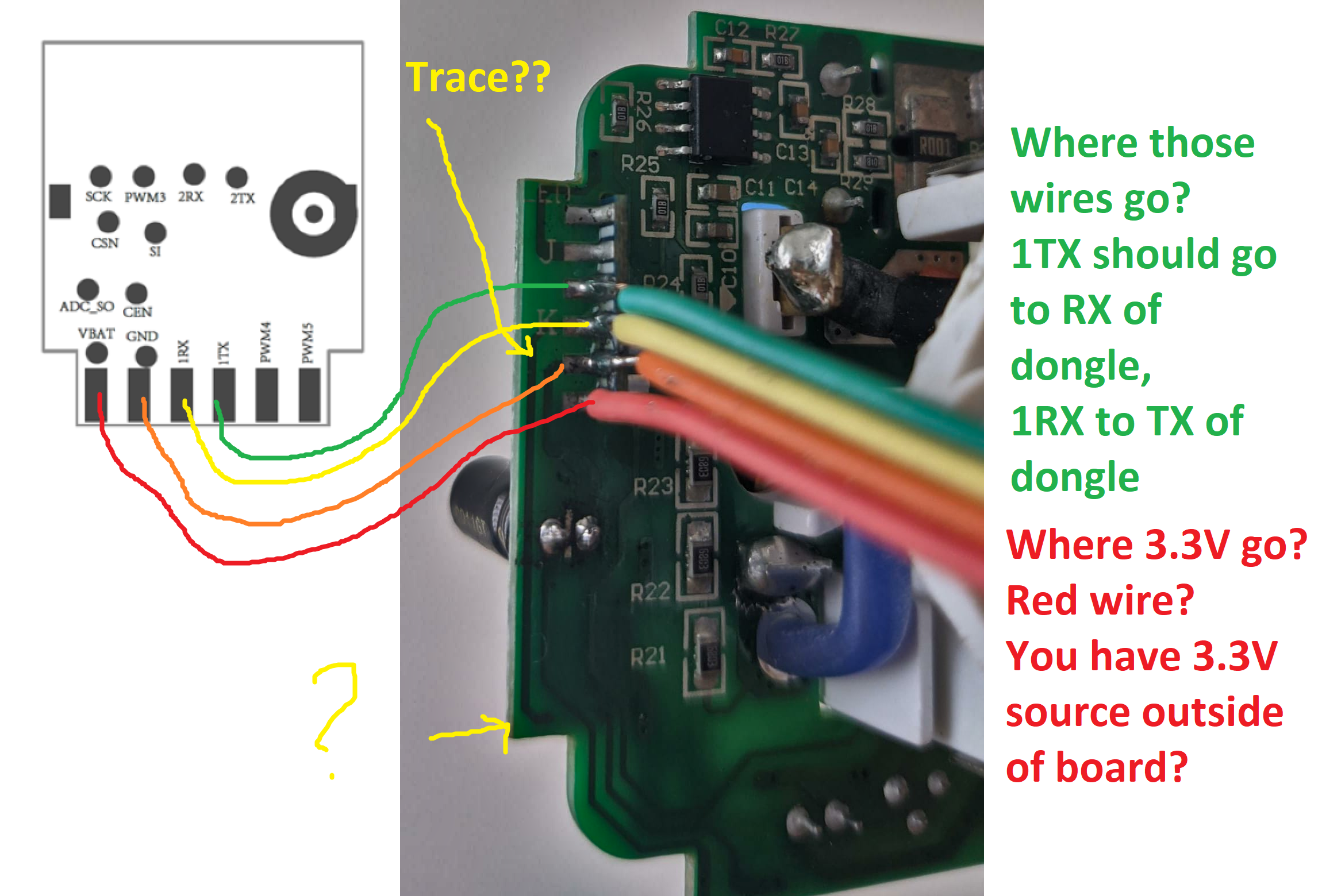

  • Recommend desoldering WB2S and flashing via 4 wires
    #647 20038565
    Posts: 14724
    Rate: 12806
    @xabean I am doing development on Windows in my old MSVC 2008, because I use newer MSVC for more commercial projects and it's easy for me to have two visual studios open and quickly navigate between them. Still, I will most likely add a VScode project soon as well.
    @pepesuriano this is taking too long and it's too complicated. I would suggest you a different approach. Get a soldering iron with clean tip, get flux and solder wick. Put some flux on WB2S module "legs", melt and remove the solder with the wire wick. Remove the WB2S module from board. Then program it, the same way I do it on my tutorials here on Elektroda. So just solder 4 wires to WB2S (3.3V, gnd, TX and RX). In this case you dont need CEN, just reboot by powering on and off. Remember, 3.3V, not 5V directly from USB.
    Do not be afraid of soldering. You can do it even with a cheapo few-bucks aliexpress soldering iron. Just keep tip clean, use flux and remove excell solder with wire wick.
    [BK7231T] My HTTP server, configurator, MQTT support from Home Assistant [BK7231T] My HTTP server, configurator, MQTT support from Home Assistant [BK7231T] My HTTP server, configurator, MQTT support from Home Assistant [BK7231T] My HTTP server, configurator, MQTT support from Home Assistant [BK7231T] My HTTP server, configurator, MQTT support from Home Assistant
    EDIT: of course second option would be to just cut RX trace and bridge it again after flashing.
    Remember to do a full flash memory read (whole 2MB) for tuya-cloudcutter guys to make OTA for similiar devices.

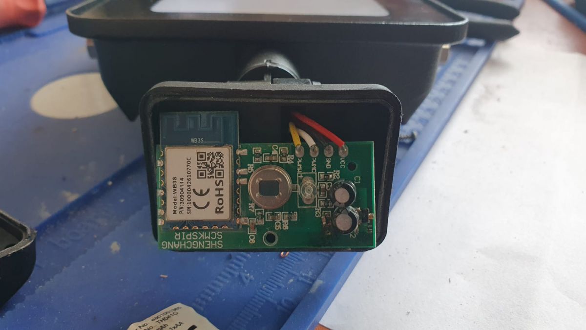

    #649 20041909
    Dark Man
    Posts: 74
    Rate: 20
    I bought a new lamp from ACTION for PLN 45 (regular price)
    LSC LED Flood Light with sensor (3003366)
    Art. 3003366
    970740 v1.0
    WB3S module
    i dumped it on cloudcutter
    https://github.com/tuya-cloudcutter/tuya-cloudcutter/issues/100
    Interestingly, my first approach was that the circuit is in the main lamp housing.
    I tried to disassemble it, but the housing is not unscrewed - the glass is glued in. Heating up did not help.
    The next day, I found a hint - open the PIR sensor :)
    The smarts put the WB3S module in the PIR sensor :) The sensor housing was welded.
    The setup for her is
    P8 PWM 4
    P9 PWM 5
    P6 PIR sensor digital In
    P23 ADC - light sensor
    While the PWMs work for me, I don't know how to configure:
    P6 to turn on both PWMs for a certain amount of time
    P23 how to read the brightness and send it to HA and how to connect with P6 so that the light is only switched on when the brightness is specified

    hey @p.kaczmarek2 - I'm trying to figure out how best to make this line of code in the HTTP server not always respond with "OFF" even after executing a "Power1+on" command.
    https://github.com/openshwprojects/OpenBK7231T_App/blob/main/src/httpserver/http_fns.c#L1150
    I'm trying to use the OpenBK app to control power on my 3d printer with Octoprint, and the Octoprint Tasmota plugin that talks directly to the HTTP interface, not over MQTT. It's _so close_ to working, I just need http_fn_cm to respond correctly with ON/OFF state.
    I noticed there's a variable called g_buttons that has all the expected pin states, which can get out-of-sync with the hardware state if you reconfigure a pin to be inverting or not (LED_N v.s. LED)
    Would a new function in HAL for "get GPIO configuration" that returns the pin direction (input, output) and state (high, low) that can be used in http_fns.c to ask the hardware what the current state of a specific GPIO pin is, after CMD_ExecuteCommand has executed? It could even reduce the need on having the current state (high, low) in g_buttons.
  • Tasmota HTTP replies should be generated per command
    #659 20043133
    Posts: 14724
    Rate: 12806
    @xabean Tasmota HTTP is on my TODO list, I know this protocol and I used it for example here:
    https://www.elektroda.com/rtvforum/topic3789324.html
    I also is required on for Tasmota-Control app from Google play compatibility
    My original idea for handling replies was to pass the COMMAND_FLAG_SOURCE_HTTP flag with command execution and generate JSON reply in the command itself. I chose this way because the reply content depends on the command you have sent. I have planned for this code to be only a placeholder and execute if command didnt produce any json string yet:
    I can look into it sooner, if you need it.
    Right now I am not sure why would your proposed change be required.
    And the On/Off state from Tasmota HTTP is obviously before inverting for "LED_N" and "Relay_N".

3. Writer stops at “Erasing 0×11000” – why?
The chip is protected. For BK7231N add --unprotect when using uartprogram, or choose BK7231N mode in BKWriter; baud 921 600 often succeeds after 115 200 fails [Elektroda, boozeman, post #19857804]
