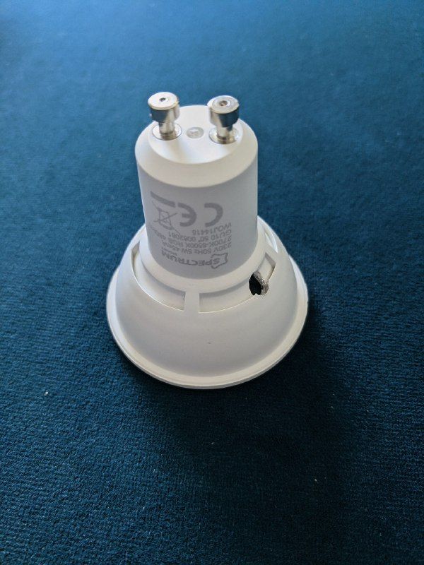

    @ p.kaczmarek2 it looks like the GU10 bulbs available in Poland woj14415 are based on WBLC5 + SM2135Eh - I2C communication. After dismantling, it turned out that the CLK line is connected to pin 26, date to pin24. Would you provide information on how to configure this bulb?
    I bought Woj14415 and WOJ14413 because I was not up to PLN 40 for free smart delivery.
    For now, I have checked WOJ14413.
    Read the teardown:
    https://www.elektroda.pl/rtvforum/topic3897466.html#20045382
    SM2123EG (PWM LED controller - without I2C!) And ESP8285 (TYLC5)
    woj14415 next in line. I'll test it in a few days.

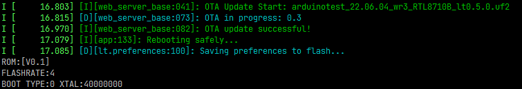

    Meanwhile, I've been working on a method for better flashing firmware and OTA updates at the same time - using Microsoft's open-source UF2 format. While this required a bit of work, I think the results are pretty satisfying - everything happens after just pressing "upload":
    Building in release mode
    Linking .pio\build\wr3\firmware.elf
    |-- Image 1: firmware.ota1.elf
    |   |-- image_0x00B000.ota1.bin
    |   |   |-- ota1.ram_2.r.bin
    |   |   |-- ota1.xip_image2.bin
    |   |   |-- ota1.rdp.bin
    |-- Image 2: firmware.ota2.elf
    |   |-- image_0x0D0000.ota2.bin
    |   |   |-- ota2.ram_2.r.bin
    |   |   |-- ota2.xip_image2.bin
    |   |   |-- ota2.rdp.bin
    Checking size .pio\build\wr3\firmware.elf
    Advanced Memory Usage is available via "PlatformIO Home > Project Inspect"
    RAM:   [          ]   1.4% (used 3688 bytes from 262144 bytes)
    Flash: [          ]   4.3% (used 34972 bytes from 806912 bytes)
    Building UF2 OTA image
    |-- arduinotest_22.06.02_wr3_RTL8710B_lt0.4.0.uf2
    Configuring upload protocol...
    AVAILABLE: uart
    CURRENT: upload_protocol = uart
    Looking for upload port...
    Auto-detected: COM60
    Uploading arduinotest_22.06.02_wr3_RTL8710B_lt0.4.0.uf2
    |-- arduinotest 22.06.02 @ 2022-06-02 22:45:00 -> wr3 via uart
    |   |-- Connecting...
    |   |-- Flashing image to OTA 2...
    |   |-- Writing 35036 bytes to 0x80d0000
    |-- Finished in 1.578 s
    The same .UF2 file can be flashed directly to device (using UART) or via OTA - because it has all the info about the SoC type, target partition names/offsets, etc. I think this is a very clean solution to OTA.
    Also, on Realtek we need to use dual-OTA schemes - OTA1 flashes OTA2 and OTA2 flashes OTA1 (AFAIK Beken doesn't work the same way). The UF2 image has both OTA images embedded, and the CPU just chooses what to flash, and where. And, of course, the file format is the same for every SoC that I'll implement.
    EDIT: OTA working in ESPHome over HTTP web server
    Screenshot of OTA update process.

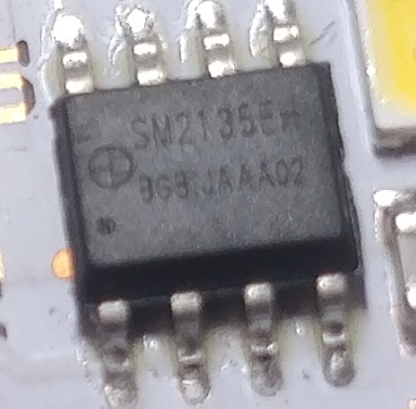

    It is possible that you came across an older search with an esp on board. All in all, you can easily check the wifi chip manufacturer by its mac address.
  • #665 20046144

    How I ordered after your post ....
    Well, there is war14415 in the queue to be checked and maybe Beken will be there. Then I will embrace you with I2C.
    But are you sure it is on I2C and not also SM2123EG or similar?

    Yes - there is the SM2135EH.
    And the wifi chip along with the rest of the trash - as you can see WBLC5 (described here ) has only 3 useful pins, so normal PWM control is omitted.

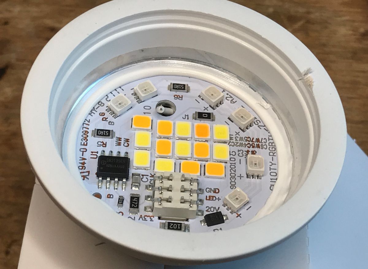

    Okay, @rawilson, so I open my GU10 and let me know what's in there.
    Did you rip a batch from this BK, preferably after pairing with the test wifi network (because then the SSID and password may leak)? It would be useful to do an OTA hack for tuya-cloudcutter to be able to program them remotely. The entire 2MB batch is ripped.

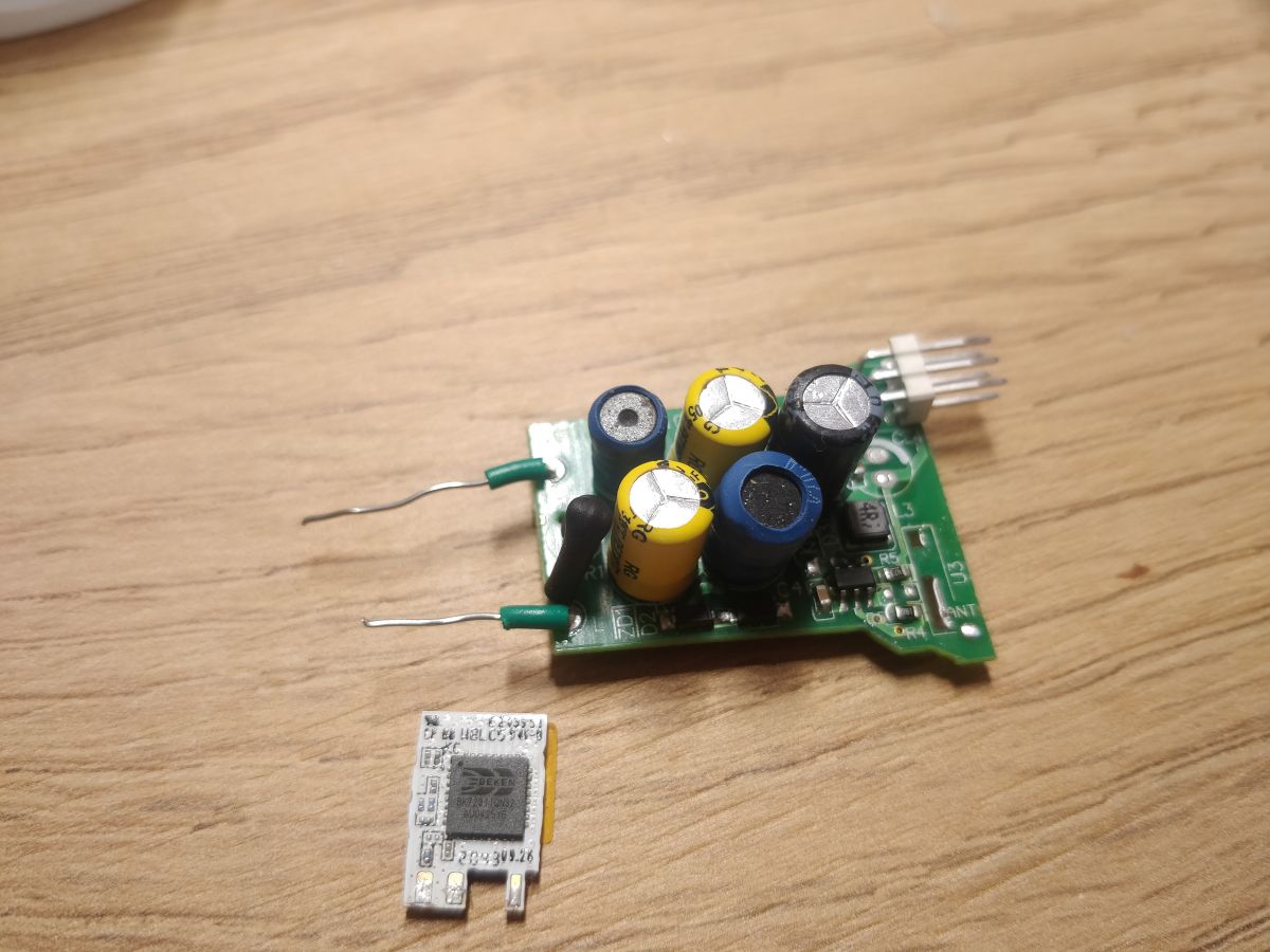

    For now, I took the glass off, hammered its edge with a watchmaker's screwdriver.
    There is an I2C chip. Rather it will be okay.
    Now it's time to remove the PCB with LEDs. I wonder how it will go.
    But I will pair it anyway and play the original batch, because you have to make a cloudcutter for them to program without opening the case.

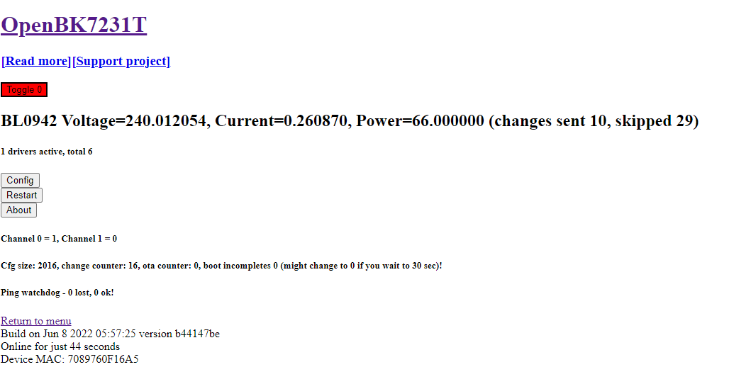

    Right now I have added configurator for BL0937 and I also fixed several bugs, including the non-working MQTT without user and pass.
    What has changed exactly in the HA yaml?
    PS: but you know that you can already do a power on state by autoexec.bat or by short startup command, right?
  • #674 20048435
    sharathbk1912
    Posts: 16
    Tats awesome news .

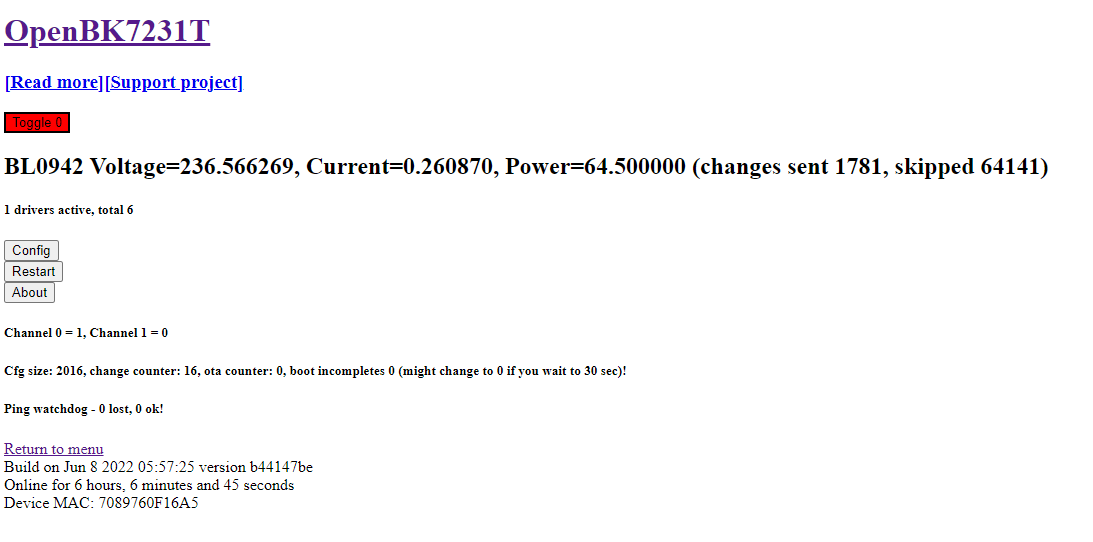

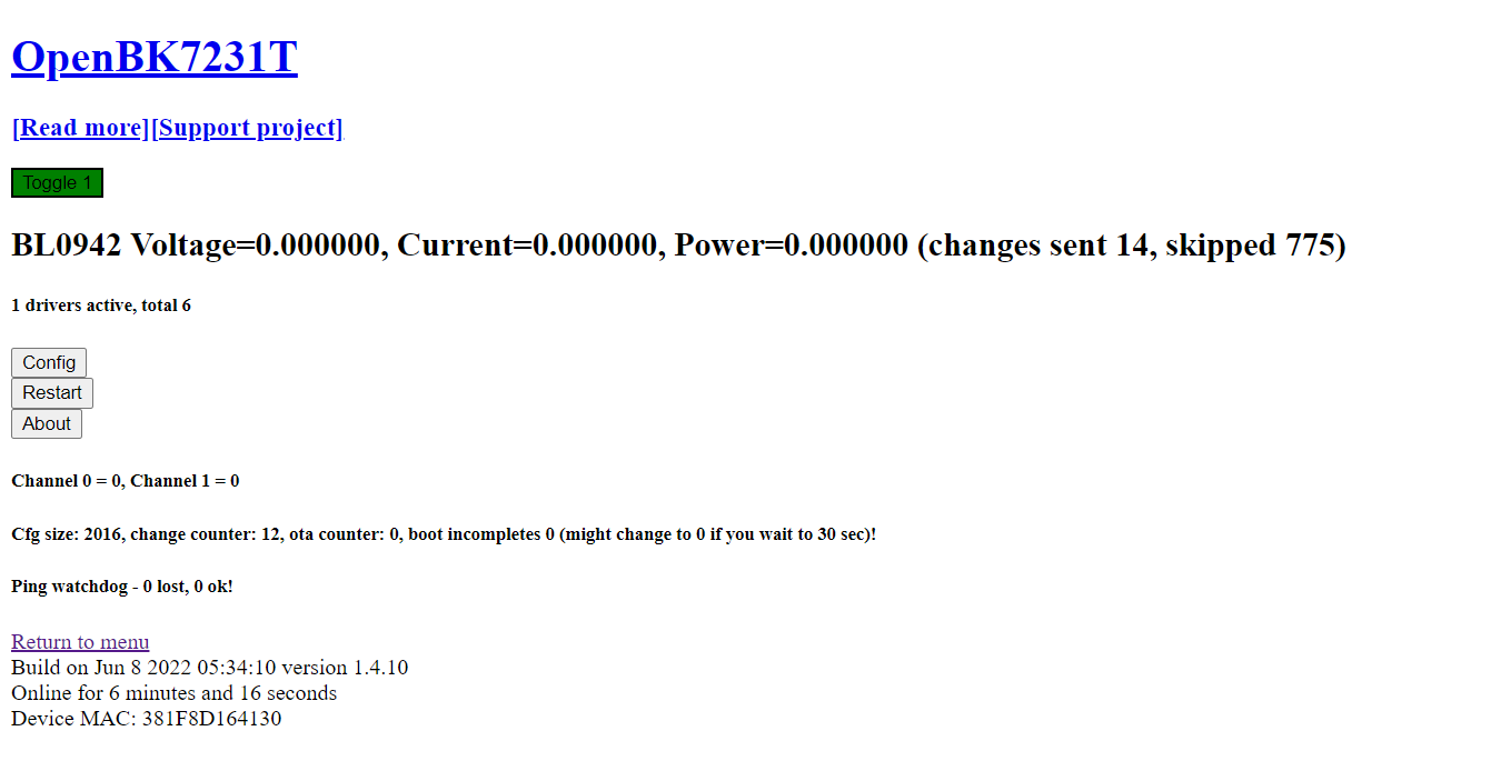

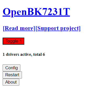

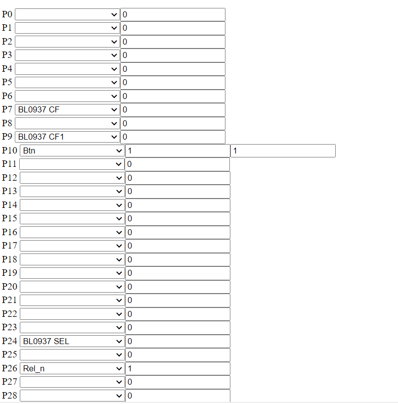

    Tried ith bl0937 . Just select the pins from the config and save. Next in the cmd section issue: startDriver BL0937
    So this started the driver and logs show the reporting
    Info:BL0942:Voltage 240.691650, current 0.000000, power 0.000000
    Info:MAIN:Time 365, free 105000, MQTT 1, bWifi 1, secondsWithNoPing -1, socks 2/38
    Info:BL0942:Voltage pulses 1740, current 0, power 0
    Calibration also works.
    However the main page/status page gives me only relay control option
    Also the homeassistant config generator does not generate the voltage/current/power related config entries .
    Can you please help what is to be done apart from the steps mentioned?

  • #675 20048551
    Posts: 14444
    Help: 650
    Rate: 12414
    You are indeed correct. A mere function call was missing. It is added now.
    Thank you for testing @sharathbk1912 , it is very valuable. Tell me if there any more bugs.
    PS: Remember that BL0937 measurement precision will be increased soon and then you will have to do calibration again (after updating openbk)

    Yes sure I will check .
    update: so i did try the version 1.4.1 . So I do see the update on main page . However with this version I am reading all values as 0 in the logs aswell.
    If i flash 1.3.2 the values are reported as expected. Can you please take a look ?

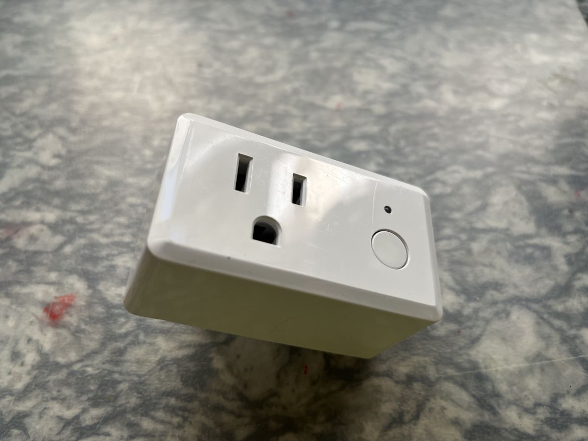

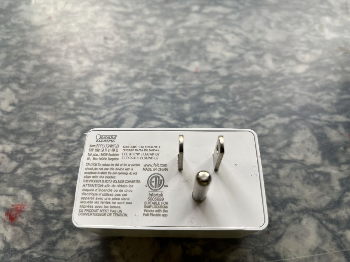

    I've flashed the Feit Smart plug from Costco marked as BPPLUG/WIFI/3 and it works great so far. It has WB2S module thats need to be de-soldered.
    The config is:
    P10 - LED_N
    P24 - REL
    P26 - Btn_Tgl_All

    Also i did test bl0937 with latest version however i see the below issue
    Is there any recommendation to try on new version to get bl0937 working ?

  • #684 20052191
    Posts: 14444
    Help: 650
    Rate: 12414
    Are you sure? I just tested, it works for me.
    Did you forget to start your driver? or to calibrate?

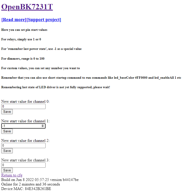

    Retain channel value configuration -> Go to config -> Startup,
    for each channel, set:
    - value 0 if you want it to be off at start
    - value 1 if you want it to be on at start
    - value 100 for PWM (full bright)
    - also can set 25 or anything for PWM
    - special value - -1 - if you want it to remember last state
    WARNING: the current version does not save/retain correctly the states of "newled" driver, the "led_basecolor", "led_dimmer", etc, this is all TODO

    sharathbk1912
    Posts: 16
    I just tried 1.4.10 also it doesnt seem to work
    THis is my config [BK7231T] My HTTP server, configurator, MQTT support from Home Assistant
    This is the main page:
    Also one strange thing i notice is that my relay_n is now reversed as compared to rel_n from 1.3.2.
    could this hint something ?
    ALso logs indicate no pulses
    Info:MAIN:Time 457, free 104864, MQTT 1, bWifi 1, secondsWithNoPing -1, socks 2/38
    Info:BL0942:Voltage pulses 0, current 0, power 0
    Info:BL0942:Voltage 0.000000, current 0.000000, power 0.000000
    Info:MAIN:Time 458, free 104864, MQTT 1, bWifi 1, secondsWithNoPing -1, socks 2/38
    Info:MAIN:Time 459, free 104864, MQTT 1, bWifi 1, secondsWithNoPing -1, socks 2/38
    Thanks and Regards
    Sharath b K
  • #686 20052606
    Posts: 14444
    Help: 650
    Rate: 12414
    There was a bug where Relay_N was not set to 1 on start (because default start channel value is 0, and 0 negated gives 1). It is fixed now. So it was incorrect before and now is OK.
    You can change initial channel values in Config->Startup.
    THis is my config
    Is the configuration correct?
    Did you restart after changing config?
    You have to restart in order to get interrupt handler and pulses counting.
    Why do you have different config than default one?
    Code: C / C++
    Is your device different and is using pin 9 for CF1 or maybe it's a mistake?
    It's still working for me.
  • #687 20052616
    sharathbk1912
    Posts: 16
    Yes this is a different device and the config seems right . Cause with 1.3.2 It just works fine.
    Yes i have saved and rebooted once the config was done.
    If i just ota the 1.3.2 rbl , it just starts working for me as the startup commands start the driver for me.
    OTA to 1.3.2 from 1.4.10
    Info:MAIN:Time 6593, free 104696, MQTT 1, bWifi 1, secondsWithNoPing -1, socks 2/38
    Info:BL0942:Consumed 255 unwanted non-header byte in BL0942 buffer
    Info:MAIN:Time 6595, free 104696, MQTT 1, bWifi 1, secondsWithNoPing -1, socks 2/38
    Info:OTA:134000
    Info:OTA:148000
    Info:MAIN:Time 6600, free 79392, MQTT 1, bWifi 1, secondsWithNoPing -1, socks 3/38
    Info:GEN:dhcp=0 ip=192.168.3.249 gate=192.168.3.1 mask=255.255.255.0 mac=38:1f:8d:16:41:30
    Info:OTA:14c000
    Info:OTA:150000
    Info:OTA:16c000
    Info:OTA:170000
    Info:OTA:174000
    Info:MAIN:Time 6601, free 103664, MQTT 1, bWifi 1, secondsWithNoPing -1, socks 2/38
    Info:MAIN:Module reboot in 2...
    Info:MAIN:Time 5, free 109656, MQTT 0, bWifi 0, secondsWithNoPing 0, socks 2/38
    Debug:MAIN:Registered for wifi changes
    Info:BL0942:Voltage pulses 1746, current 0, power 0
    Info:BL0942:Voltage 231.397598, current 0.000000, power 0.000000
    Info:MAIN:Time 6, free 105696, MQTT 0, bWifi 0, secondsWithNoPing 0, socks 2/38
    Info:BL0942:Voltage pulses 2, current 0, power 0
    Info:BL0942:Voltage 0.265060, current 0.000000, power 0.000000
    Info:MAIN:Time 7, free 105696, MQTT 0, bWifi 0, secondsWithNoPing 0, socks 2/38
    Info:MAIN:wl_status 3
    Info:MAIN:Main_OnWiFiStatusChange - WIFI_STA_CONNECTING
    Info:MAIN:Time 8, free 105520, MQTT 0, bWifi 0, secondsWithNoPing 0, socks 2/38
    Info:BL0942:Voltage pulses 1745, current 0, power 0
    Info:BL0942:Voltage 231.265060, current 0.000000, power 0.000000
    Info:MAIN:Time 9, free 105520, MQTT 0, bWifi 0, secondsWithNoPing 0, socks 2/38
    Info:BL0942:Voltage pulses 1745, current 1, power 0
    It just starts working fine with 1.3.2 so i assume all config are correct.
    Is it possible something else changed along with this ? may be new sdk isnt working for this device or something ?
    Thanks and Regards
    Sharath B K
  • #688 20052701
    Posts: 14444
    Help: 650
    Rate: 12414
    Before we proceed, can you try:
    channge P9 role to nothing and P8 to BL0937 CF1?
    Right now I suspect that you have chosen wrong pin for CF1 role and older version works for you because it always uses default pins.
    look, here a history bl0937 changes
    https://github.com/openshwprojects/OpenBK7231T_App/commits/main/src/driver/drv_bl0937.c
    not much have changed during last days
  • #689 20052734
    sharathbk1912
    Posts: 16
    I think you are right . i verified my images and feel Pwm2 is the pin looks like. Let me try that and update here .
    Update:
    It worked!! Thanks for the catch!!
    Also the power on state works well. I am using the high on poweron.
    Thanks
    Sharath b k
  • #690 20052841
    Posts: 14444
    Help: 650
    Rate: 12414
    I'm glad it worked out, sometimes it's just good to check the pin indexes twice because it's easy to confuse them.
    So, what is the next thing to be added now, in your opinion?
    I will fix the logging name/labels because it's using BL0942 for BL0937.... or just change it to BL09XX.
✨ The discussion centers on the development and testing of an open-source firmware project for the BK7231T microcontroller, focusing on creating a cross-platform mini HTTP server, web-based pin configuration, MQTT integration, and Home Assistant compatibility. The project includes a Visual Studio project for Windows and firmware flashing tools like Beken Writer and a Python-based uartprogram. Users report challenges with flashing devices, including issues with firmware size limits (956KB), UART converter compatibility, and power supply stability during flashing. Solutions include using specific UART adapters (e.g., FT232R, CP2102), resetting devices via the CEN pin instead of power cycling, and trimming firmware binaries. The firmware supports devices with BK7231T and BK7231N chips, with ongoing work to add PWM dimmer support, BLE, TuyaMCU protocol integration, and OTA updates. Various smart devices such as WB2S/WB3S modules, smart plugs, LED bulbs, and switches from brands like MOES, Nedis, Hama, and Calex are tested. Users share detailed hardware teardowns, pinouts, and flashing procedures. MQTT topic naming issues related to MAC address usage were identified and fixed. The project emphasizes community collaboration, with suggestions for a Discord server to enhance real-time communication. Additional tools and SDK improvements, including CMake support and BLE integration, are under development to facilitate firmware building and device support expansion.
