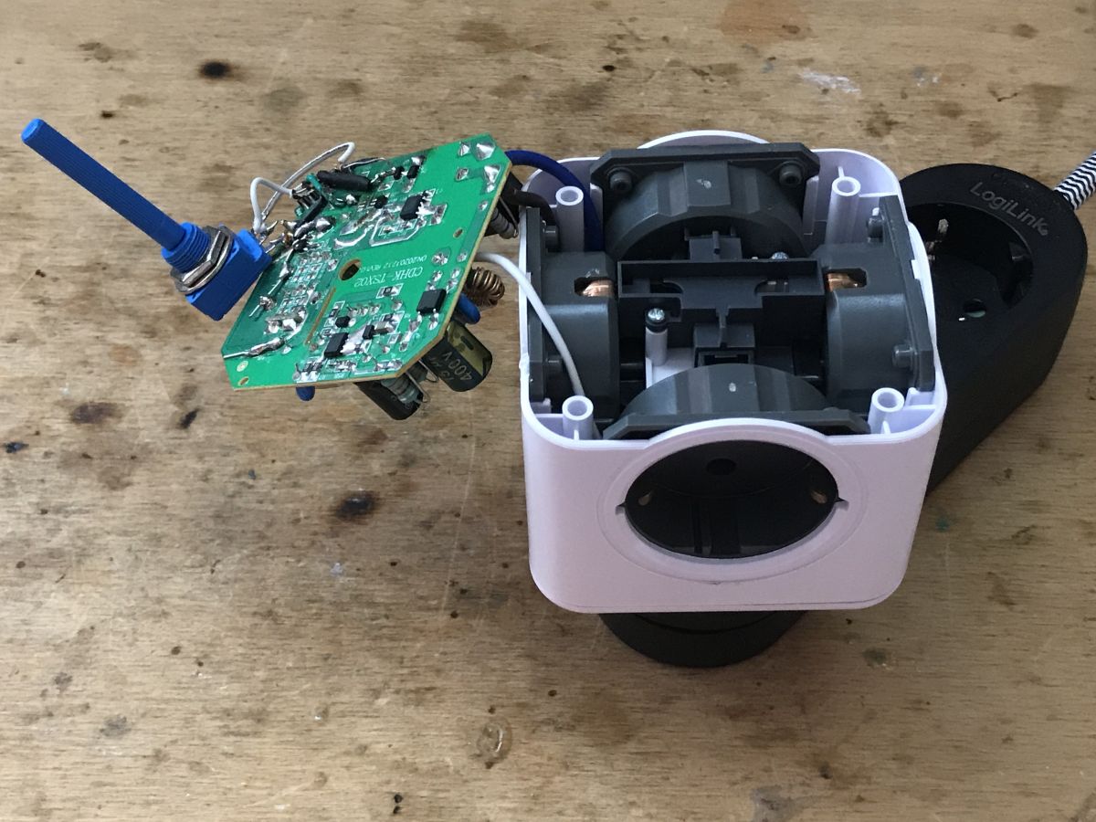

    Still, today I've did the ADC:
    Here is my test setup, I temporarily had no access to any other test devices so I used my power cube modified to work with WB2S and added a potentiometer:
    ADC readings seems to be correct.
    Is there still the user who needed ADC for light sensor?

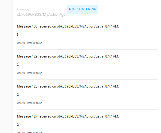

    And here is what I added today:
    Code: C / C++
    NOTE: 6 is a pin number
    NOTE: command syntax is publish topic value
    The full topic is following: obk0696FB33/MyAction/get , you enter only "MyAction"
    What would you like me to add next? Can you test those functionalities and make sure they are working ok?
