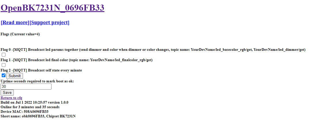

  • Minute broadcast added for raw channel values
    #722 20083502
    Posts: 14724
    Rate: 12806
    We will have it implemented as well, we already have a basic Tasmota command stubs.
    Broadcast every minute is ready, can you check?
    see how it looks in HA:
    it's not enabled by default, I am not sure if it's bug-free but let's start with this for now. It also broadcasts IP (but I might disable it and only broadcast IP on startup, IP broadcast was requested by BL602 user few weeks ago)
    Please check it well and report back here if there are any issues. Due to the scale of the project and the lack of free time, I am not able to test everything with each change.
    PS: it broadcasts raw channel values, OK for relays, but for LEDs it won't broadcast custom variables like "dimmer" or "color temperature"

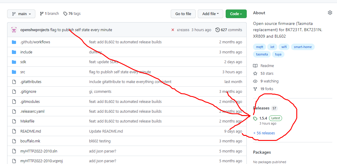

  • #724 20083627
    Posts: 14724
    Rate: 12806
    Wait, why are you compiling?
    Binaries (RBL) are automatically released on my repository.

  • #726 20083675
    Posts: 14724
    Rate: 12806
    download RBL for your chipset and use the "drag and drop" in extra app panel (javascript)

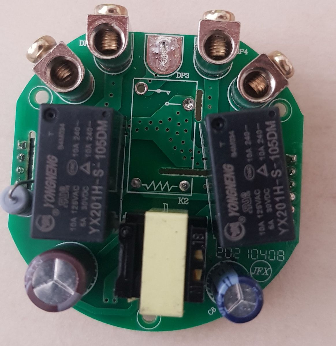

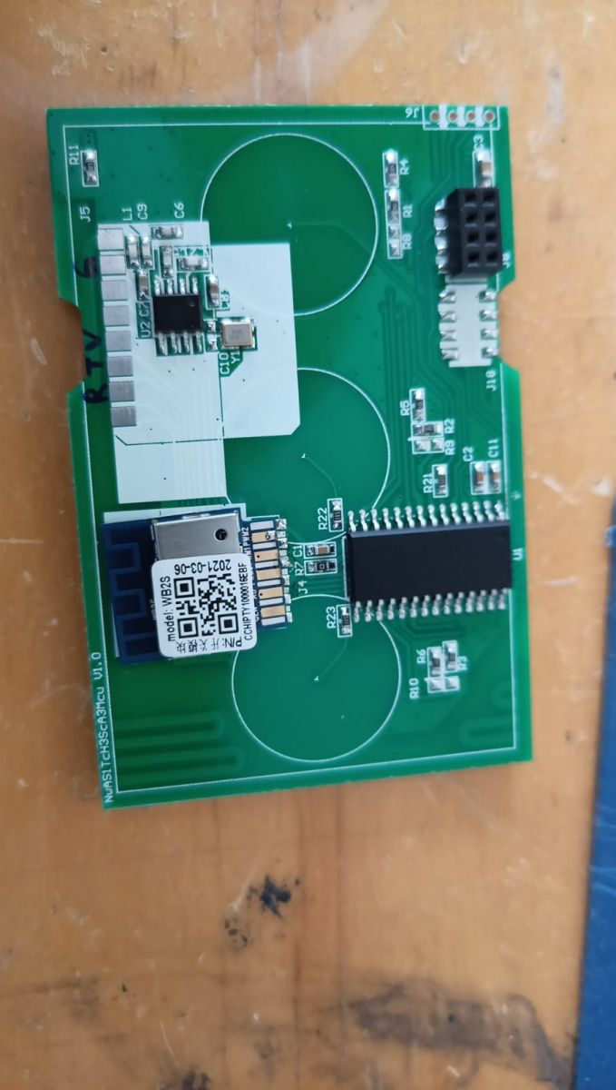

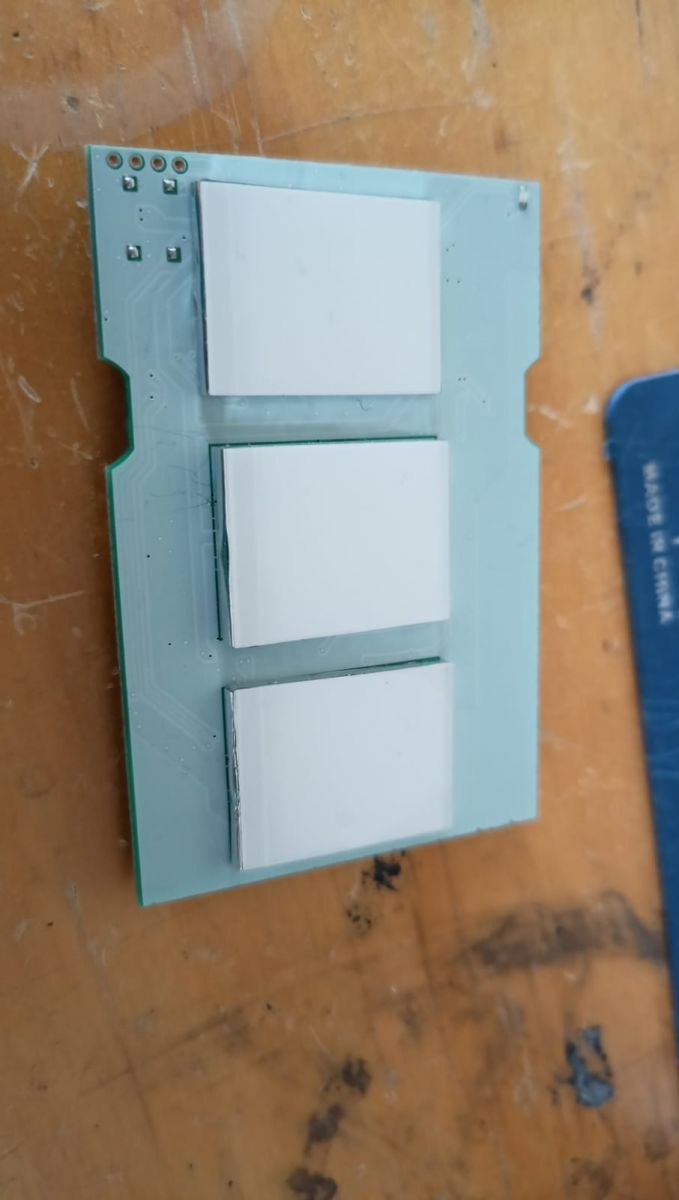

    I found this MOES 3 gang switch, It has two boards, the main one with the logic and the daughter with the power and relays.
    There are 3 ic's in the main board a WB2S a small IC I don't know what it does. The big one is a microcontroller where al inputs and outputs are connected to. this IC communicates with the WB2S using the TX and RX pins. Unfortunately, the number in the IC's has been removed.
    It seems that the bigger IC holds the logic for the board. As even though I haven't assigned any pins, the buttons still activate the relays.
    [BK7231T] My HTTP server, configurator, MQTT support from Home Assistant [BK7231T] My HTTP server, configurator, MQTT support from Home Assistant [BK7231T] My HTTP server, configurator, MQTT support from Home Assistant

    It's a TuyaMCU device. TuyaMCU is already supported, but first you need to find out dpIDs for the configuration. Are you able to connect it to 3.3V power supply (or to 5V power supply, if you connect it to the input of 3.3V LDO on the board), and use USB to UART converter to capture the packets?
    Or maybe it was an ESP device and TuyaMCU dpIDs are already known?
    Well, maybe you could get away with just programming WB2S module and then pressing the buttons and watching the OpenBK console which dpID coresponds to which button..
    https://www.elektroda.com/rtvforum/topic3898502.html
    Of course, there will be a small problem with programming/reading the firmware, because the RX/TX lines for programming are also used to communicate with TuyaMCU....

    Or maybe you already have it flashed? If so, activate TuyaMCU and watch the console log in OpenBeken, this should show what it's receiving , that way you can also determine dpIDs

    #734 20088538
    Tow96
    Level 4  
    Rate: 7
    I started TuyaMCU and pressing a button triggers two dpI
    -------- ON -----------------------------------------------------
    Info:TuyaMCU:TUYAMCU received: 55 AA 00 07 00 08 07 02 00 04 00 00 00 00 1B
    Info:TuyaMCU:TuyaMCU_ProcessIncoming: processing command 7 (State) with 15 bytes
    Info:TuyaMCU:TuyaMCU_ParseStateMessage: processing dpId 7, dataType 2-DP_TYPE_VALUE and 4 data bytes
    Info:TuyaMCU:TuyaMCU_ParseStateMessage: raw data 4 int: 0
    Info:TuyaMCU:TUYAMCU received: 55 AA 00 07 00 05 01 01 00 01 01 0F
    Info:TuyaMCU:TuyaMCU_ProcessIncoming: processing command 7 (State) with 12 bytes
    Info:TuyaMCU:TuyaMCU_ParseStateMessage: processing dpId 1, dataType 1-DP_TYPE_BOOL and 1 data bytes
    Info:TuyaMCU:TuyaMCU_ParseStateMessage: raw data 1 byte:
    -------- OFF -----------------------------------------------------
    Info:TuyaMCU:TUYAMCU received: 55 AA 00 07 00 05 01 01 00 01 00 0E
    It seems that dpId 1, 2, 3, control the relays and the button LED's. No Idea what 4 byte value the dpId 7, 8, 9 control
    Also it seems that there is no dpId for the WiFi LED, probably will need to check the pcb again
    EDIT:
    The WiFi LED is definetely connected to pin 11 of IC. shouldn't it be controlable via a dpId? the Hearbeat command does nothing

    How did you flash that WB2S? Do you have a firmware backup, for tuya-cloudcutter guys or something? Did you desolder whole module?
    Since you already have TuyaMCU packets receiving, maybe try configuring it and sending something? Link channel 1 to dpid 1, channel 2 dppid 2, etc.. just to see if it works.
    You can also try doing some guesswork, maybe dpid 4 is a wifi LED? Wouldn't hurt trying
    I don't know why it sends two signals at once. Have you tried doing a double click or long press hold to see if the signal changes?
  • dpId1-4 control relays, dpId7-10 are timers
    #736 20089893
    Tow96
    Level 4  
    Rate: 7
    I was unable to flash it using bk_writer, it uses a BK7231T so maybe is an issue with my PC. So I flashed it using python. While trying to flash I desoldered the VCC pin from the TuyaMCU so the RX and TX bus was free.
    However, I was able to pull the backup with bk_writer and the TuyaMCU still wired. Don't know if that affected the bin produced (my guess is probably yes) or if it is possible to flash the WB2S module without desoldering (probably not). I have a spare switch that I haven't flashed. So when I write a full documentation tomorrow I'll use it to verify both things.
    Hooked it up to Home Assistant, works perfectly. dpId4 and dpId10 also exist which seems to be for a fourth switch, the relay board has space for a fourth relay, but is unused.
    Tried other dpId's I didn't got a response.
    And finally figured out what the secondary dpId's do:
    dpId1-4 set the state of the relay (I linked these to MQTT)
    dpId7-10 toggle the relays after a n amount of seconds (Maybe useful for somebody, but not for me, so I didn't link them)
    Should I post the documentation in this thread or should I create a new one?

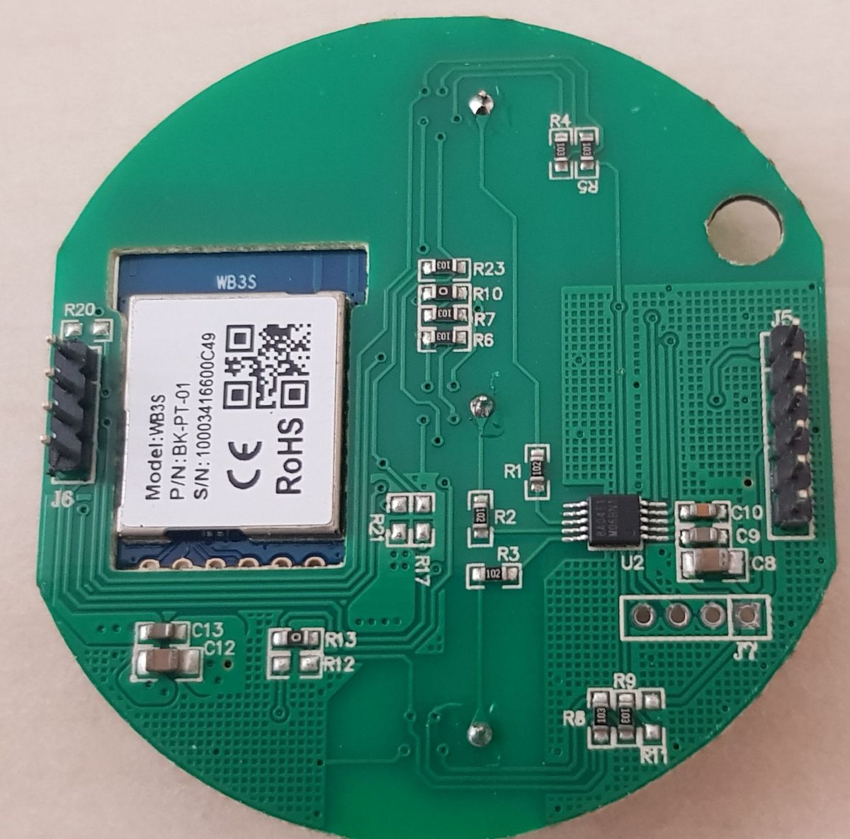

  • Identified BK7231T pinout for curtain switch relays
    #738 20092188
    leecher1337
    Posts: 11

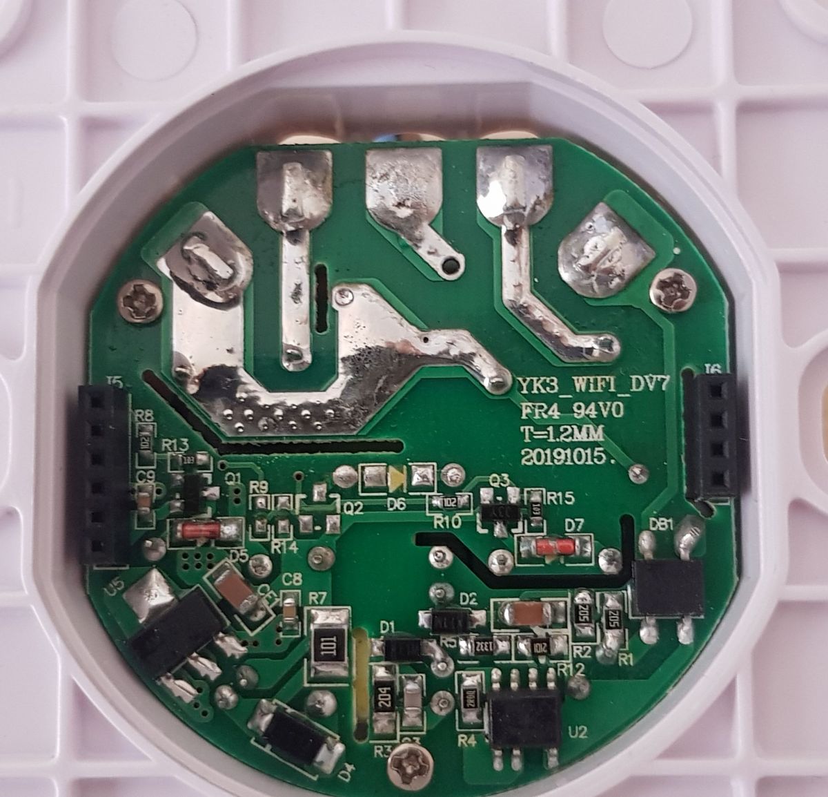

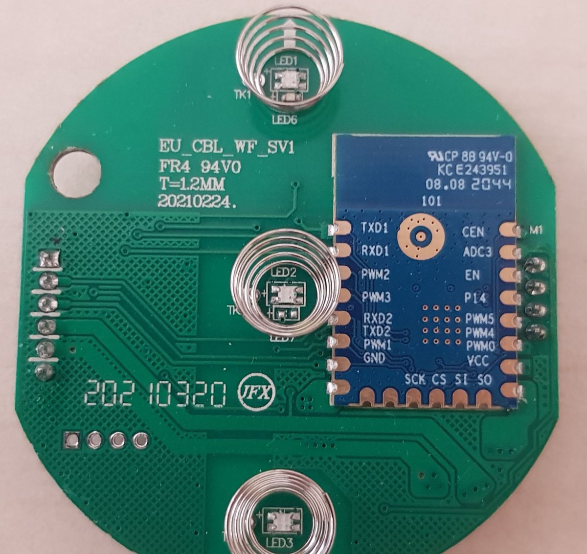

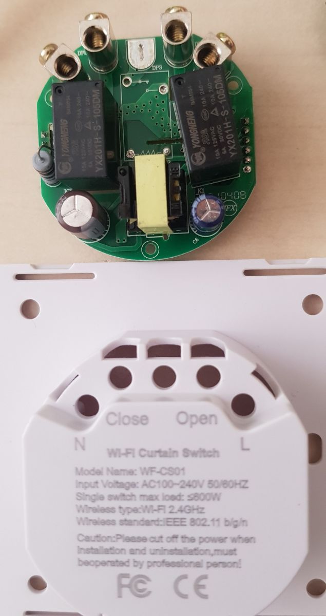

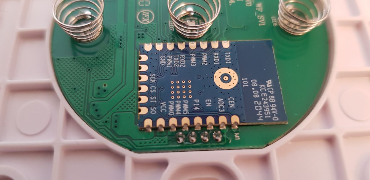

    I'm currently trying to get a Curtain Switch Etersky WF-CS01 to work.
    This used to be an ESP32 device that worked with Tasmota, but now it uses Beken.
    These are the images and Templates from the previous versions that used to be ESP:
    https://templates.blakadder.com/WF-CS01_EU.html
    https://templates.blakadder.com/etersky_WF-CS01.html
    Now I'm trying to find out the pinout and if this can be made working with OpenBeken, I guess something like Tasmota Shutter Support would be needed.

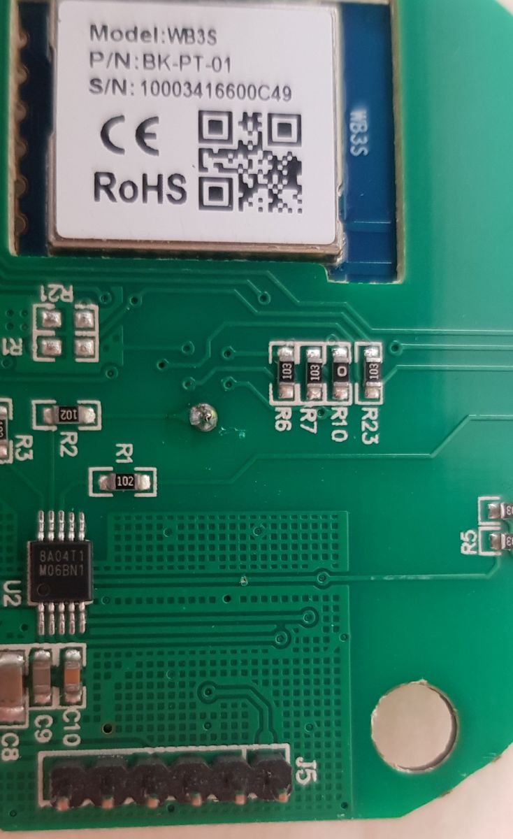

    The only pins I found out so far are:
    PWM1 10 Button1 (Middle button)
    PWM4 6 Relay2
    PWM0 7 Relay1
    I tried nearly every pin as Button 2 to check if it reacts to the key press of the upper or lower button, but to no avail.
    So I'm a bit clueless now how this whole shutter device works. Any hints on what I could try to find out buttons and LEDs and to get this Curtain Switch working?
    Measuring the PINs to Buttons wouldn't be of much use, as the buttons end in this 8A04T1M06BN1 chip, no clue, how to talk to it.
    [BK7231T] My HTTP server, configurator, MQTT support from Home Assistant [BK7231T] My HTTP server, configurator, MQTT support from Home Assistant [BK7231T] My HTTP server, configurator, MQTT support from Home Assistant [BK7231T] My HTTP server, configurator, MQTT support from Home Assistant [BK7231T] My HTTP server, configurator, MQTT support from Home Assistant [BK7231T] My HTTP server, configurator, MQTT support from Home Assistant [BK7231T] My HTTP server, configurator, MQTT support from Home Assistant
    Thanks
  • #739 20092208
    Posts: 14724
    Rate: 12806
    Can you check where RXD1 and TXD1 and maybe RXD2 and TXD2 goes?
    Getting one such device for testing would be helpful....

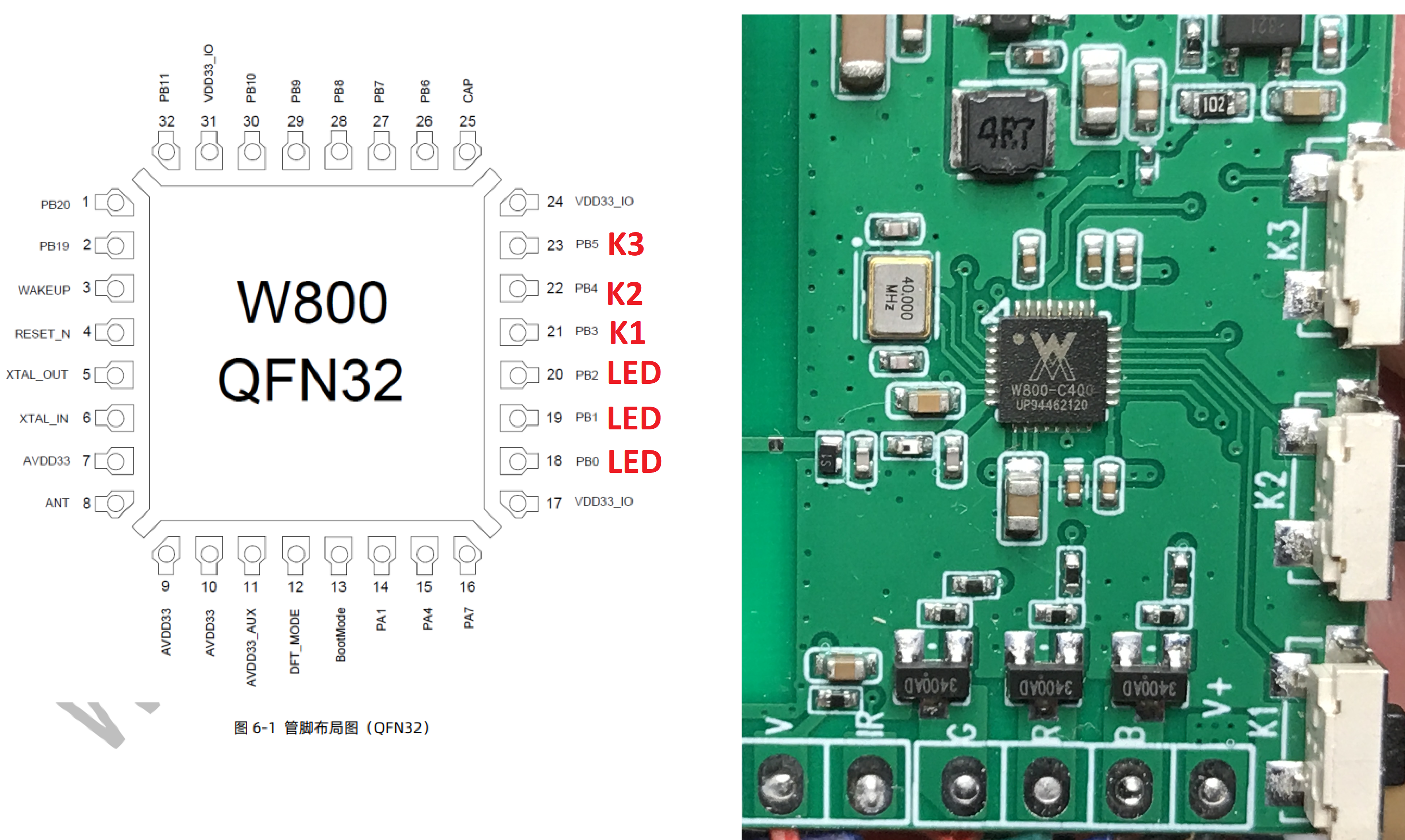

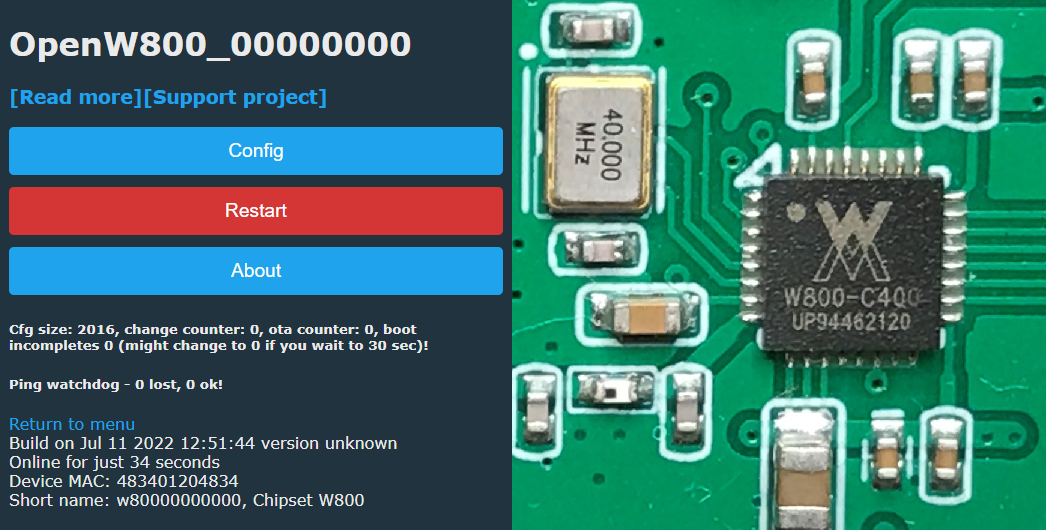

    Futhermore, yesterday I received a device with new chip, that still has SDK (and even dev boards on aliexpress) available:
    W800-C400 chip, I'll check if it's easily flashable

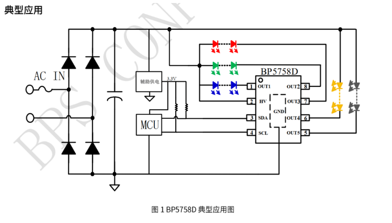

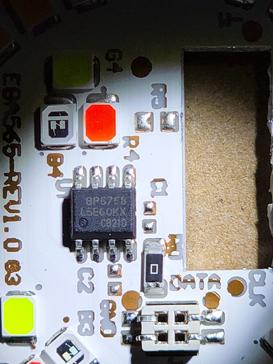

  • Asking about I2C and BP5758 support in OpenBK7231T
    #743 20096765
    eakeyson
    Posts: 8
    I am trying to get Merkury smart bulbs from Walmart to work with OpenBK7231T/ Home Assistant. They have a WB-2L wifi module in them and I have successfully uploaded the new firmware to the module. LEDs are controlled by an obscure I2C controller (BP Semi BP5758) for which there is little information. What is the status of I2C support in OpenBK7231T and is there any chance that this chip is supported either generically or specifically? FWIW, the latest version of Tasmota 12.0 specifically supports this chip. Just wondering where to go next. Thanks. [BK7231T] My HTTP server, configurator, MQTT support from Home Assistant [BK7231T] My HTTP server, configurator, MQTT support from Home Assistant [BK7231T] My HTTP server, configurator, MQTT support from Home Assistant [BK7231T] My HTTP server, configurator, MQTT support from Home Assistant
  • W800-C400 support announced for next platform
    #744 20097177
    Posts: 14724
    Rate: 12806
    @eakeyson I2C is working, so you just would have to add a specific driver for this chip. I would do this myself if I had that bulb at hand. I think I also have another, similiar I2C bulb waiting for me to write a driver.
    @AcuarioCat where can I buy a such a development board, for a relatively affordable price?
    Next platform is starting to get supported - W800-C400 WinnerMicro WiFi & Bluetooth MCU!

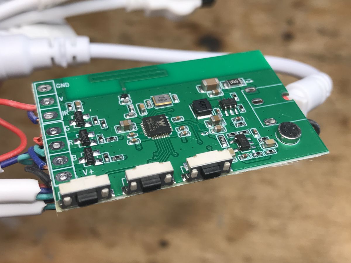

  • OB38A04T1 touch controller pin mapping found
    #747 20097586
    leecher1337
    Posts: 11
    @p.kaczmarek2
    Only additional wiring I found so far regarding the controller
    that gets the touch input:
    The Microcontroller is a OB38A04T1
    Datasheet: http://www.lookmcu.com/pdf/620169.pdf
    Connections to it that I could find so far:
    RXD1 -> P0.4/TK0
    PWM2 -> P0.3/TK1
    I guess, without having knowledge about the code that runs on the
    OB38A04T1, there won't be a way to find out how to check the
    touch keys?
    I made a dump of the original firmware of the device, if this is helpfu for reversingl:
    https://github.com/tuya-cloudcutter/tuya-cloudcutter/files/8603335/dump2.zip
  • W800 support nearing completion with MQTT and GPIOs working
    #748 20097653
    Posts: 14724
    Rate: 12806
    @leecher1337 why not just connect external UART to USB converter and capture the the communication data? That way we will know if it's a TuyaMCU or something
    or just enable TuyaMCU in OpenBK and see if it receives anything, for a start...
    I am finalizing W800 support.
    MQTT is working, buttons are working, GPIOs are working, PWMs are working

    W800 port is now fully functional, even with OTA!
