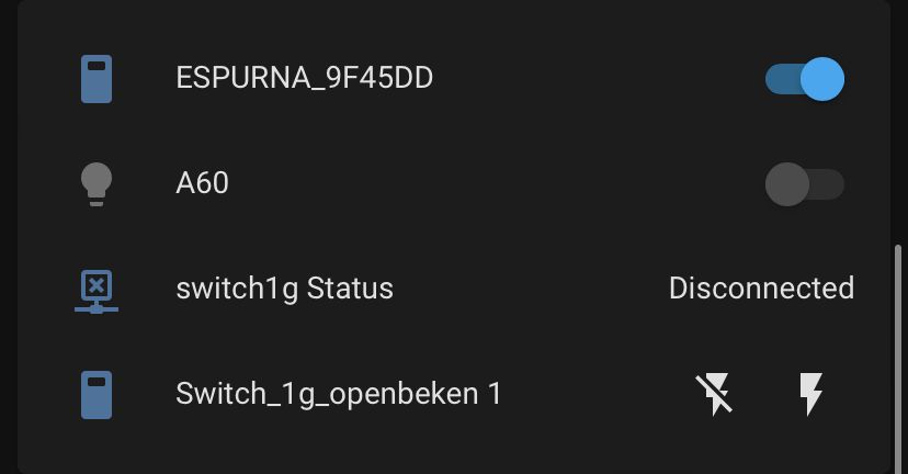

    Disabled device group(removed name) and added the command above,
    But changing the relay/toggle push button from openbkt doesn't change the nightlamp device relays
    I also added the command for another N device (1 gang) but also nothing changes to the group
    addChangeHandler Channel1 != 0 DGR_SendPower "nightlamp" 1 1
    addChangeHandler Channel1 == 0 DGR_SendPower "nightlamp" 0 1
    On further testing
    Device group enabled - Only get status relay, but I can't change it and the device is unresponsive after a few minutes. I'll try hooking up to tx2 to get the log output when that happens again.
    Device group disabled - Working nicely, I can get relay status and change it from homeassistant and device stays online.

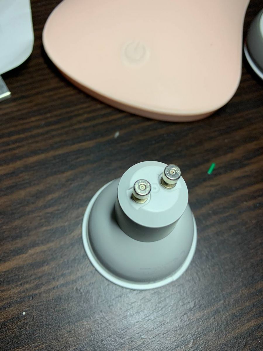

    Not related to device group, but since the openbkt tutorial involves an E14 led teardown
    Do you have any advice how I should proceed to teardown this GU10 bulb safely?
    The cables inside is too short to pull out the pcb, I believe the chip inside is a BL602

    I don't have that kind of socket at home, but I already did a teardown of such bulb about twice for research purposes.
    As far as I remember, it should be possible to take out the "legs" of the bulb, they are attached on long goldpins.
    https://www.elektroda.pl/rtvforum/topic3896404.html
    [BK7231T] My HTTP server, configurator, MQTT support from Home Assistant [BK7231T] My HTTP server, configurator, MQTT support from Home Assistant
    It's tricky to do that, I have already failed once and the gold pin broke off instead of coming out of the "leg"
    I will try to add more debugging tools soon to investigate the rare N platform issue
    What was your method to successfully remove them?
    Do I pull right away or a twist and pull? Once removed, can you assemble them again or some adhesive requires for the bottom pins?
  • #939 20194117
    Posts: 14724
    Rate: 12808
    As you can see, the goldpins are in square shape, so no twisting, just pulling.
    I think you should be to put them back on together later.
    Still, it worked only for one of my bulbs. In the case of second one, the gold pin broke:
    Thanks, i noticed that gold pin in the center, which tool did you use for this?
    My pliers just can't get a grip on the legs

    I use a different plier this time, as i was pulling the leg i noticed cracks on the bottom base.
    Seems like the bottom protuded metal that connects to the leg pins are dragging the base as i was pulling it. Making this job a lot more difficult than it should
    Just a pliers, I might try to find some old GU10 bulbs and if they have the same construction I'll try to make a video or something
