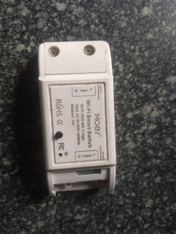

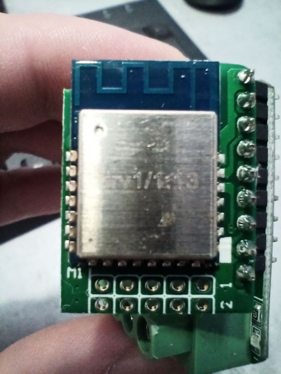

    svobodaelektroda
    well, the best way is to look at the PCB and at the datasheets and follow the traces
    I have w2bs https://developer.tuya.com/en/docs/iot/wb2s-module-datasheet?id=K9ghecl7kc479 , but that doesn't tell much. it has there 11+4 PINs, but my plug has e.g. relay on pin 26.
    You were mentioning 'follow the traces'... any help pls how?
    thx,
    os

    Well, do you have the device open? Maybe can you show photos?
    Do you know the pinout of WB2S?
    Do you know the pinout of BL0937?
    Do you have a multimeter?

    svobodaelektroda
    Images attached and multimeter I have, so happy to check anything 😁

    @svobodaelektroda well, now, find the BL0937 chip, and find the pin called CF.... put one probe there.... and then probe pins of WB2S... you can see which pin is on images posted earlier.... and tell me where does the CF goes?
    Then the same.... for CF1.... and then... for SEL... and that's it.
    You have both pinouts posted by me above, both BL0937 pins and WB2S.

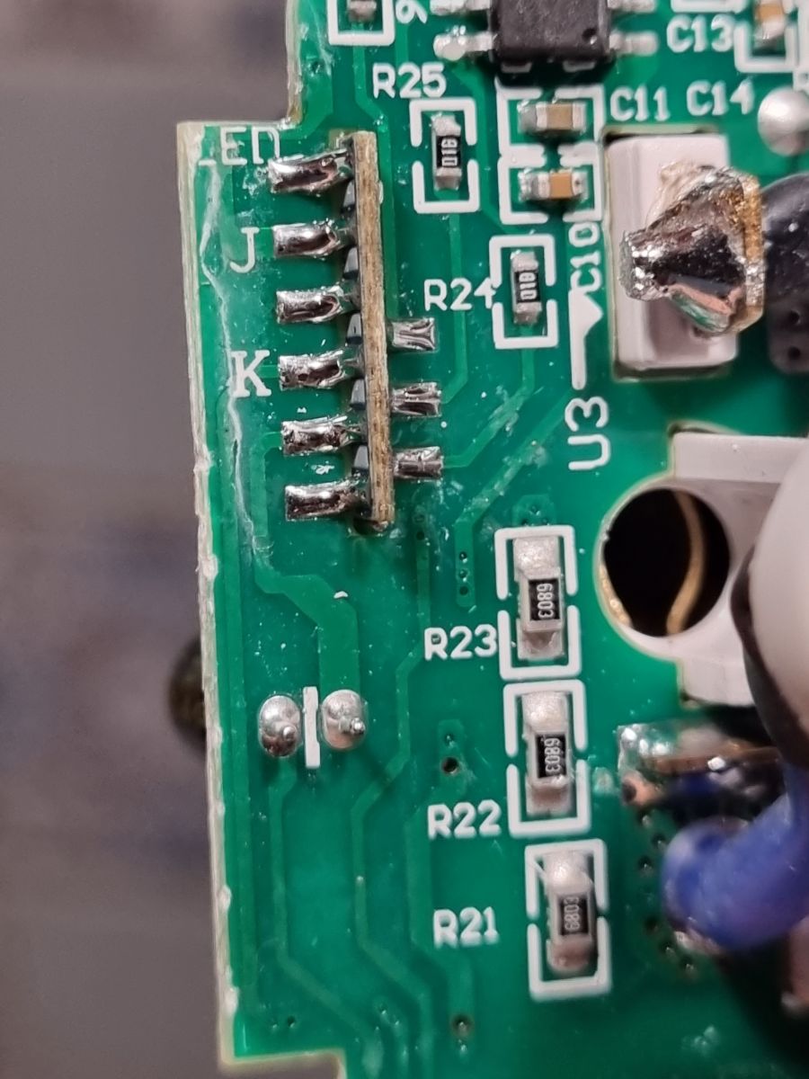

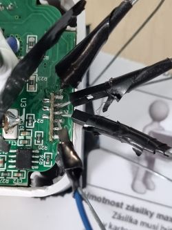

    brianandrus
    Posts: 13
    So, I have successfully flashed the board inside the new FEIT Wall dimmer from Costco. Now, I am not sure of the steps to figure out what the configuration should be. It looks like I need to trace what pins go where or such.
    Anyone have any insight on next steps? I have it connected to my wifi, can connect to it via the IP and web app and have it successfully connecting to my HA MQTT.

    @brianandrus there are two ways.... either look at the PCB with multimeter (when it's disconnected from mains) and probe connections or just try each pin, try setting each one to relay, button and everytime check and see if it reacts
