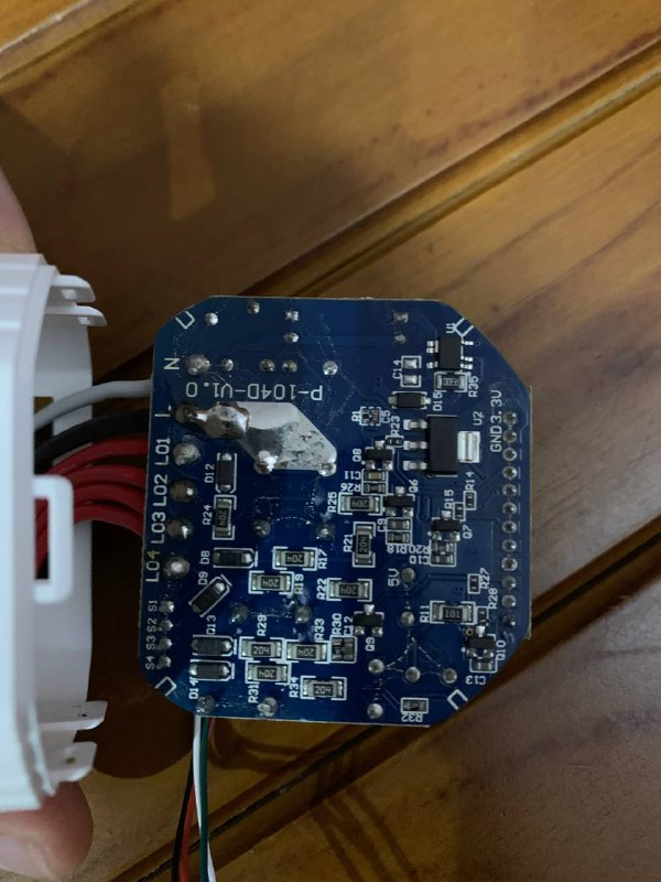

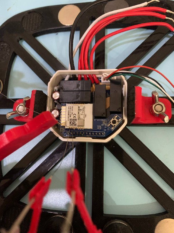

    Hi @p.kaczmarek2
    Trying it on tuya relay device, it's N device, flashed the QIO.bin and hooked it to main.
    But I'm not seeing the openbk ap. Then i flashed the UA.bin but still the same issue,
    Any ideas why or how to fix this

    @ferbulous Did you flash it to correct offset?
    What is the debug output of the device?

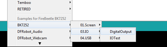

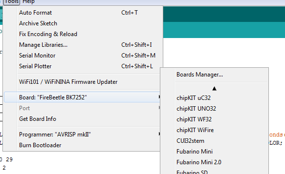

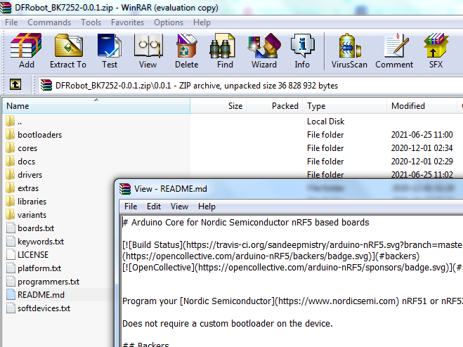

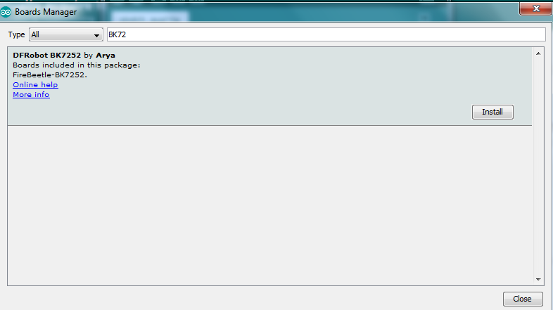

    @Tych0 good to see someone else with this camera, altough I mostly meant the bootloader so data starting at 0x0
    Maybe we should try SDKs for BK7252
    https://chowdera.com/2021/07/20210727131509465r.html
    env_released_1.1.3.7z ?
    https://docs.dfrobot.com.cn/DFRobot-BK7252/
    this file looks like Arduino core for BK7252, anyone wants to try installing it?
    It seems that compiler has to be manually placed:
    exec: "/bin/arm-none-eabi-g++": file does not exist
    Error compiling for board FireBeetle BK7252.
    edit ah ok you install it by:
    http://download.dfrobot.top/DFRobot-BK7252/package_bk7252_index.json
    it compiles something, and that's it for me now, as I am away from home and don't have BK at hand

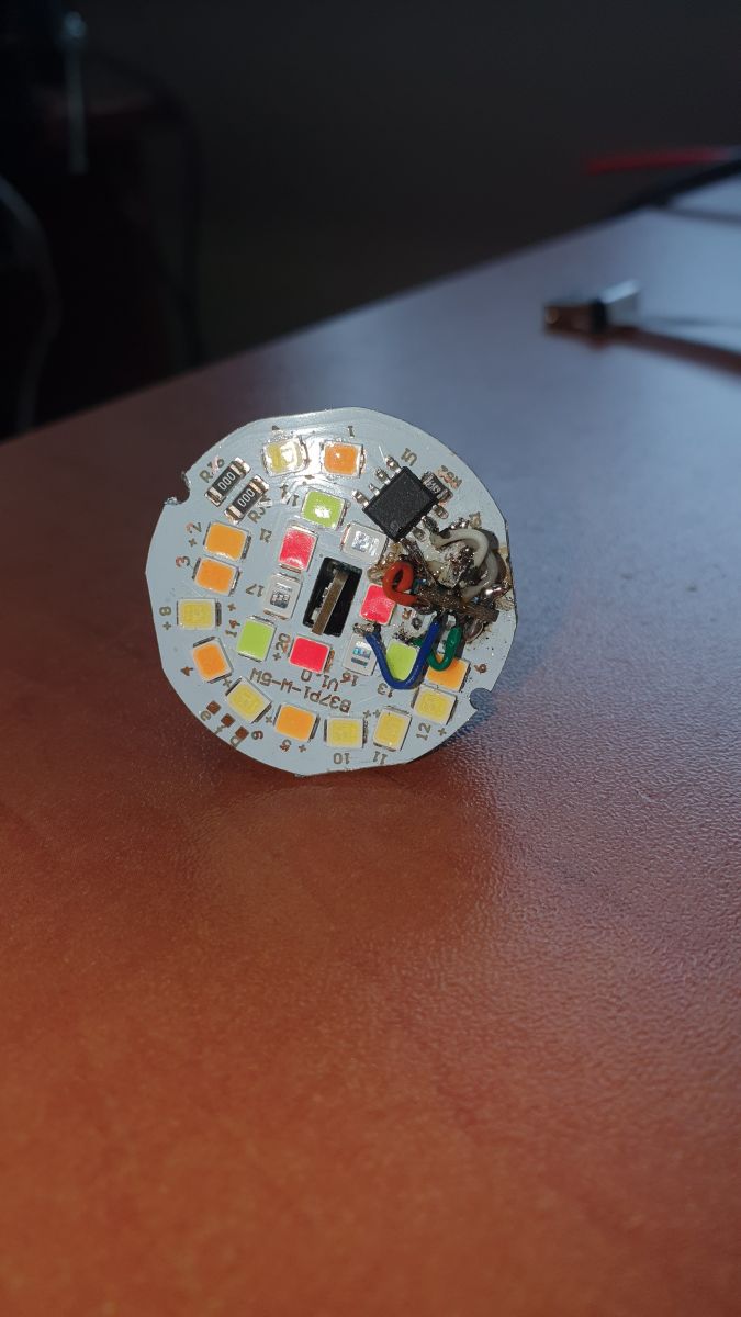

  • BK7231T bulb pinout and firmware dump shared
    #876 20151316
    Dark Man
    Posts: 74
    Rate: 20

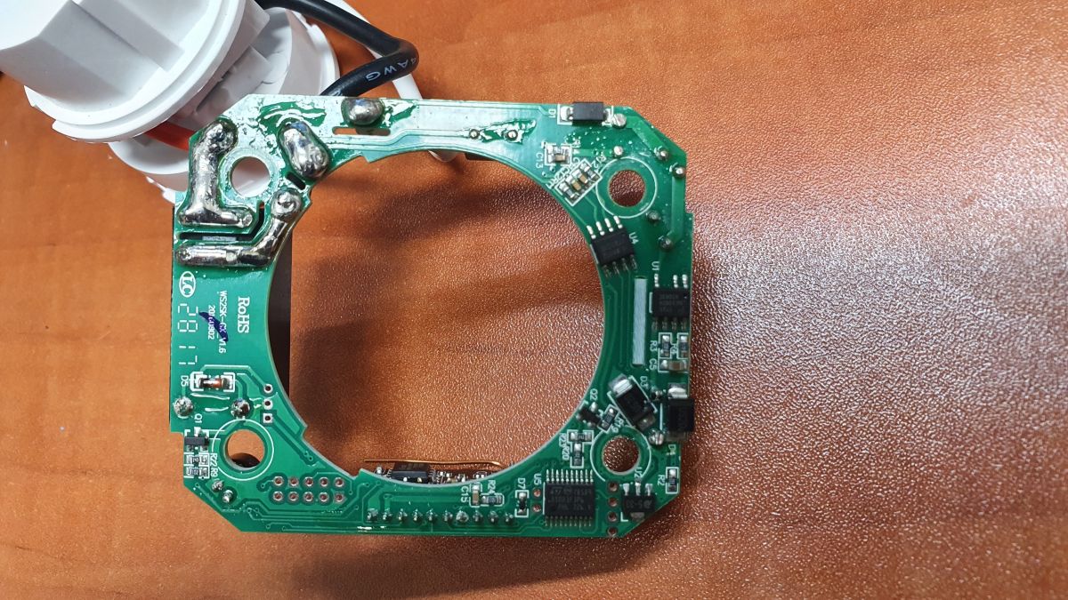

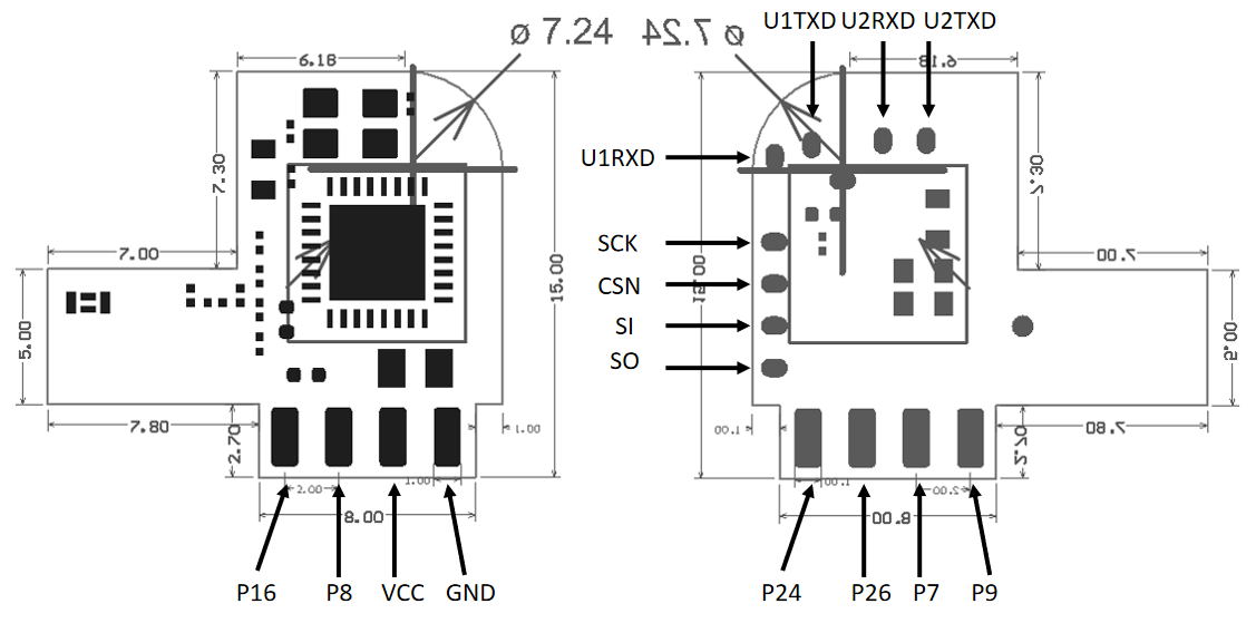

    I will share my latest struggles.

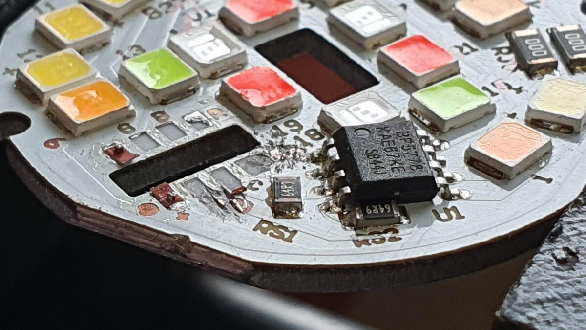

    About 3 months ago I bought a light bulb at Action and immediately after that I tried to take it apart to find out what chip it is based on.
    Opening it ended with breaking the casing a bit and tearing out the pads connecting the power supply with the PCB with LEDs.
    Unfortunately, it turned out that there is no ESP but the WBLC9 module on the BK7231T chip and I left it for a better time.
    Today, having some time, I returned to her.
    I desoldered the module, downloaded three times the original firmware (not yet connected to Wifi) - attached (maybe it will be useful for cludcutter, because I did not find this bulb in the profiles)
    I have uploaded your latest firmware and detected the following pin configuration:
    R: P8 PWM 1
    G: P9 PWM 2
    B: P24 PWM 3
    C: P26 PWM 4
    W: P7 PWM 5
    I soldered the module, connected the broken pads with cables and it works :)

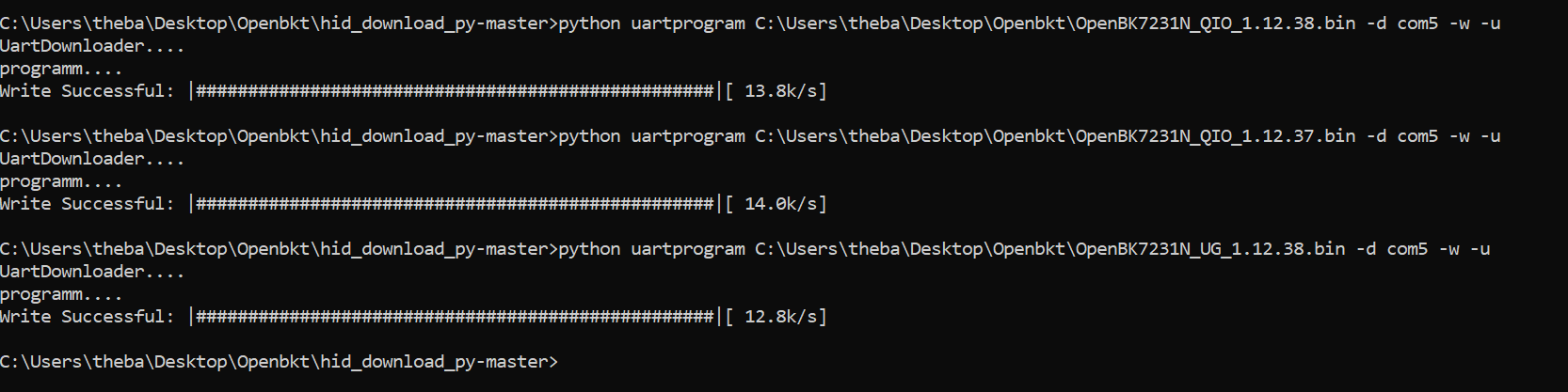

    Do you mean this?
    python uartprogram C:\Users\theba\Desktop\Openbkt\OpenBK7231N_UG_1.12.38.bin -d com5 -w -u -s 0x0
    This worked for my other N devices
    Just tried flashing on my 2nd tuya relay device, and it's the same thing again, the ap's not showing up
    As for the debug output, I'll need to find my 2nd uart. So I just need hook it up to tx2, rx2 and how do I get to the console?

    Just hook it up. Your USB dongle RX to the CB2S TX2.
    Wait.... for N, I always flashed QIO binary, not UG. I haven't even tested if flashing UG works.
    As far as I remember, UG is for tuya-cloudcutter.

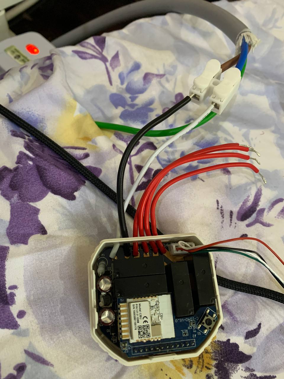

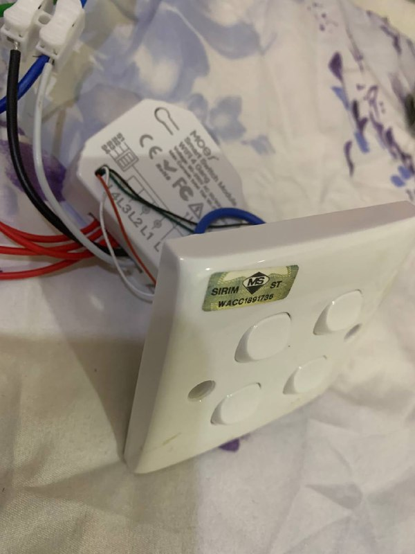

  • Relay and button pin mapping still unresolved
    #879 20151474
    ferbulous
    Posts: 419
    Help: 8
    Rate: 56

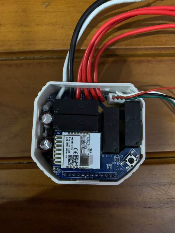

    Then I would just use putty, and go to COM5 (for the uart I'm using) to see the logs, correct? Just the TX2, so no RX2
    Looks like it's working now, I'm not sure why it wasn't working previously when I already had flashed UG.
    As for resetting the device, is there another method now other then cutting off the power 6-7 times until it resets?

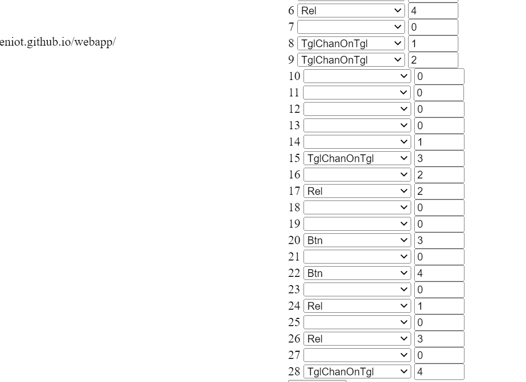

    Trying to configure the pins now, I've got the relays but not the buttons
    Relay
    L1 - P24
    L2 - P17
    L3 - P26
    L4 - P6
    Button
    P8
    P9
    P15
    P17
    P28
    On stock firmware, one of them is the buzzer, but I'm not sure how to configure that one. I've assigned the remaining pins as button but it's not toggling any relays yet. Any thoughts on this?

    #880 20152569
    Posts: 14724
    Rate: 12807
    Yes
    So WiFi is up and it's ok?
    clearConfig command in console will clear all config if that's what you mean, otherwise only power cycling I think
    Check the PCB if there is really a button on this pin. Maybe this device has some extra pull up or pull downs resistor that are not expected by the firmware? Firmware assumes that button connects pin to ground and IO uses built-in pull up resistor.
    ferbulous wrote:
    I can buy that one if you need to get it working
    ferbulous wrote:
    buzzer
    what is the role of the buzzer there? Is it on PWM pin?
    To confirm - you are able to toggle relays through the web page, but not by buttons?
  • Check button wiring and buzzer pin function
    #881 20153328
    ferbulous
    Posts: 419
    Help: 8
    Rate: 56
    Working fine now
    I'll test it again with another rocker switch
    On the stock firmware, buzzer was for pairing wifi indication it seems since it doesn't have led indicator.
    That's correct, I can toggle relays from the webpage, not yet with the buttons

    Thanks for the firmware dumps, @ darkman1. I have already handed them over to where they need to be.
    What method did you desolder the module with? I'm going to throw in youtube video showing how I desolder the WB2L_M1 module with the cheapest soldering iron from Tuya LED Bulb E14, so it may be useful to someone.

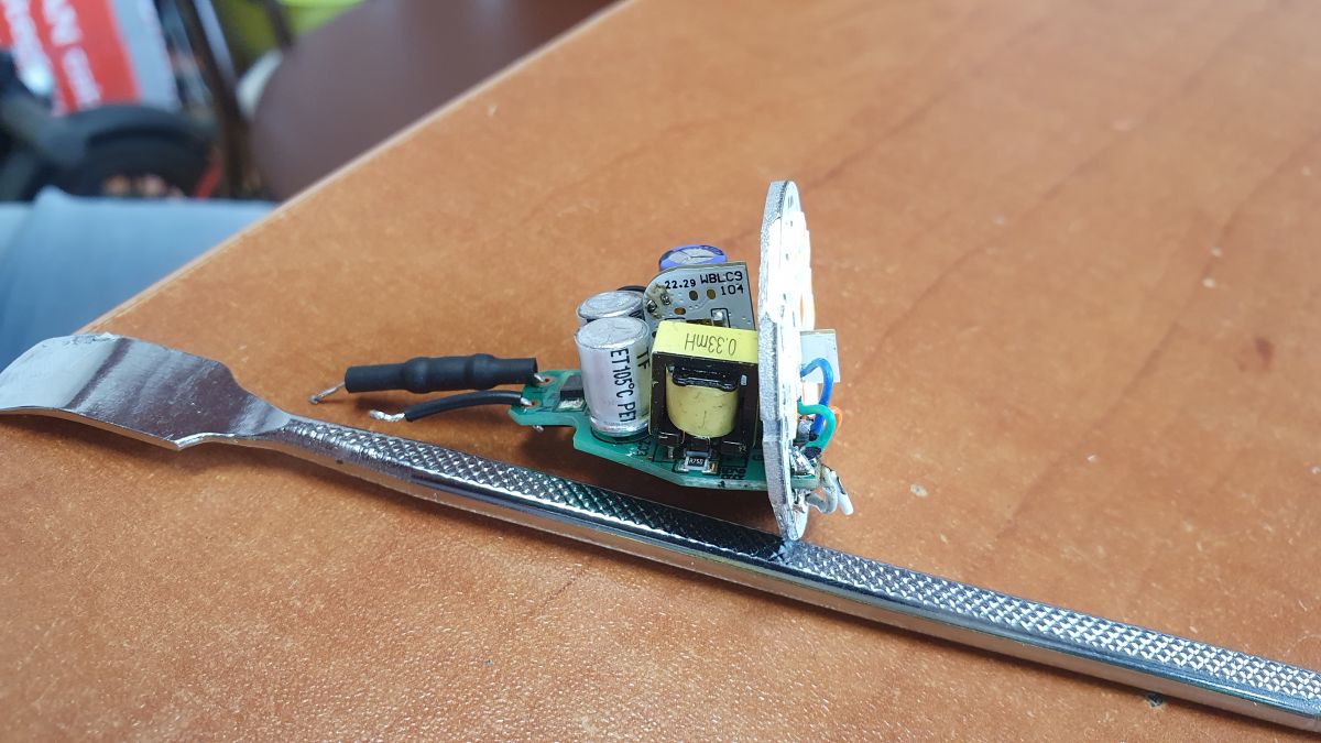

    #883 20155066
    Dark Man
    Posts: 74
    Rate: 20
    I did this module desoldering mainly with hot air from the soldering station
    WEP 872D
    because there were 8 pins to be desoldered at once.
    When assembling (soldering the module and PCB with LED) and connecting the cables, I used a butt from the same soldering station.
    [BK7231T] My HTTP server, configurator, MQTT support from Home Assistant [BK7231T] My HTTP server, configurator, MQTT support from Home Assistant [BK7231T] My HTTP server, configurator, MQTT support from Home Assistant [BK7231T] My HTTP server, configurator, MQTT support from Home Assistant [BK7231T] My HTTP server, configurator, MQTT support from Home Assistant
  • #884 20155083
    Posts: 14724
    Rate: 12807
    I have a different way, better for beginners / people without equipment.
    Circuit board with mounted electronic components held by a clamp.
    Flux + lead binder (the most common tin) given on the pads in large quantities works wonders.
    In fact, you had this lamp with a motion sensor what ADC needed? I have already added ADC and it works for BK.

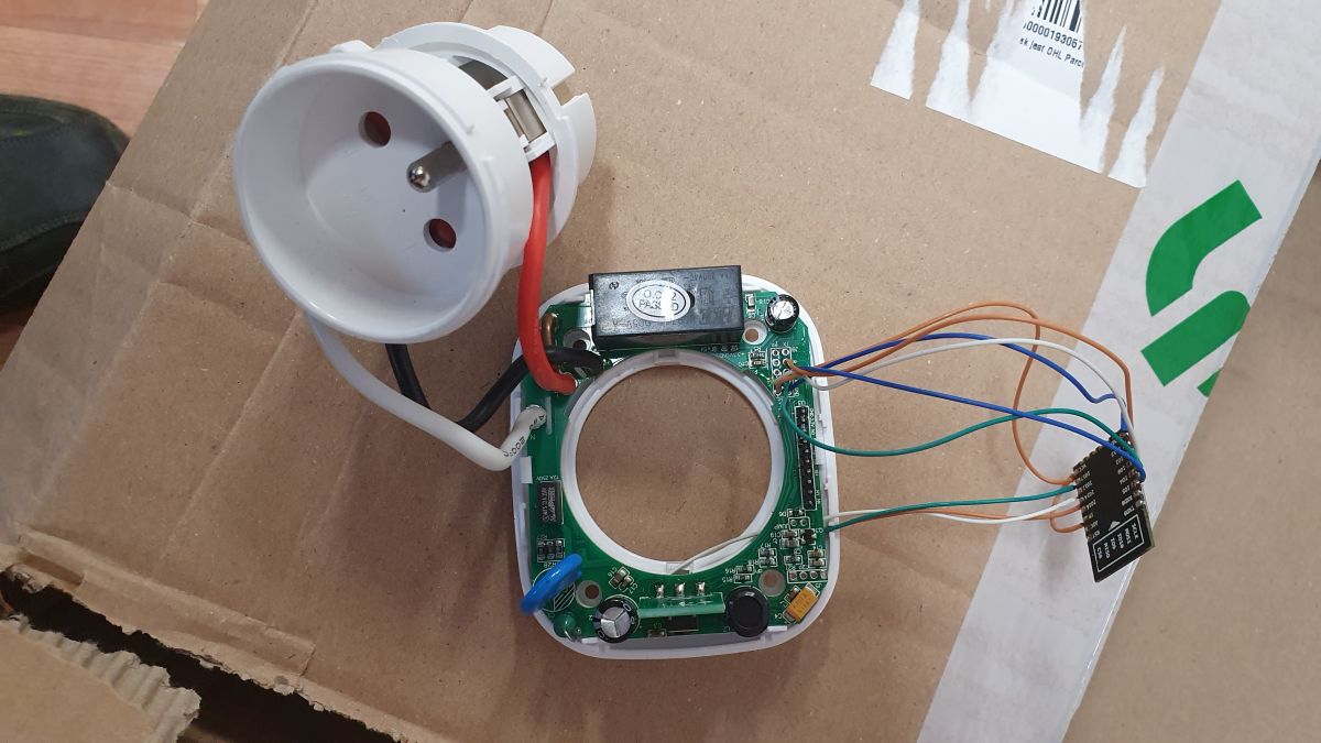

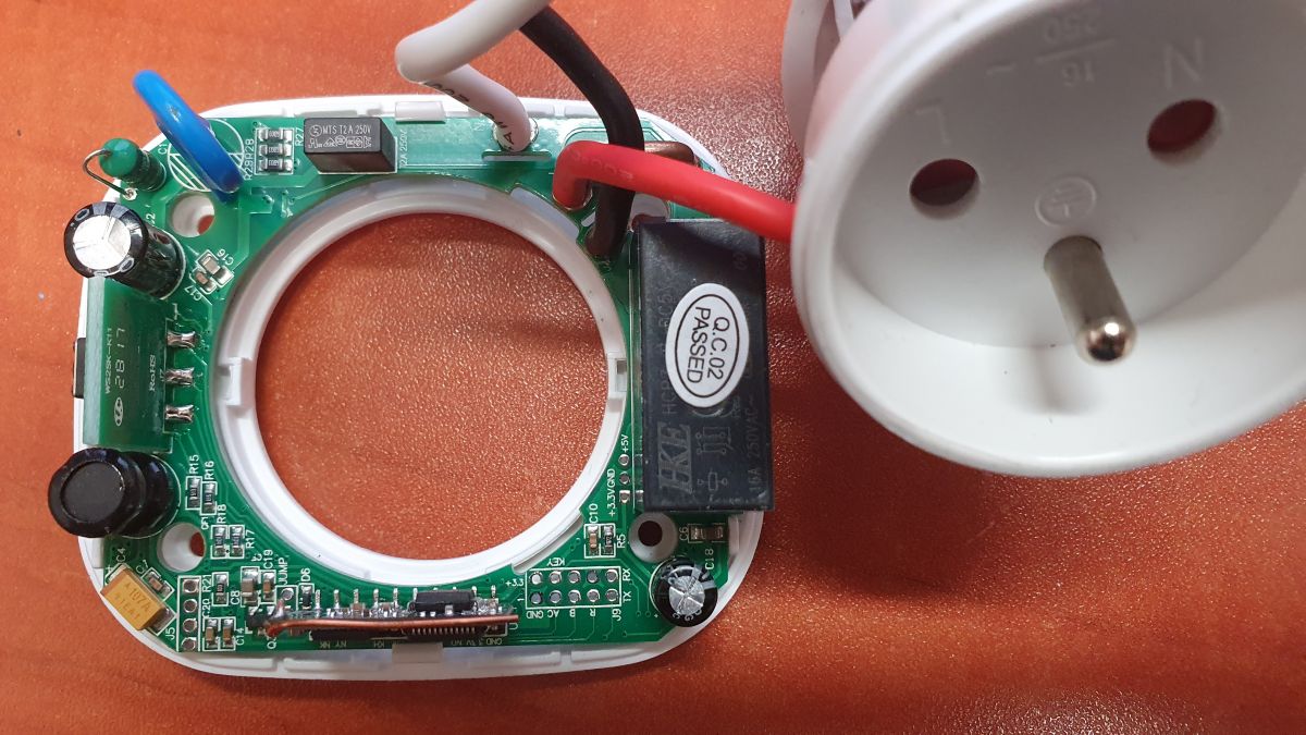

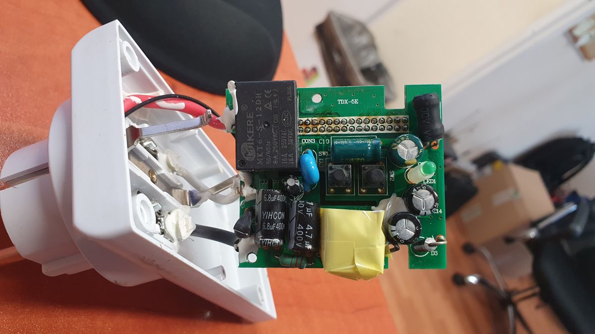

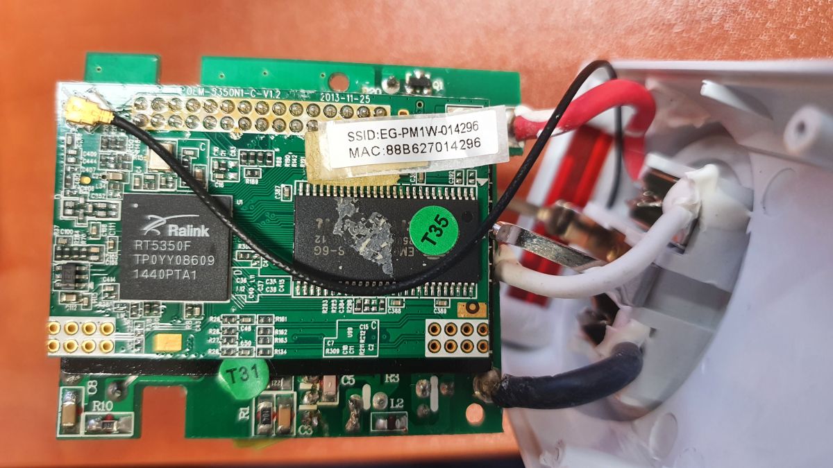

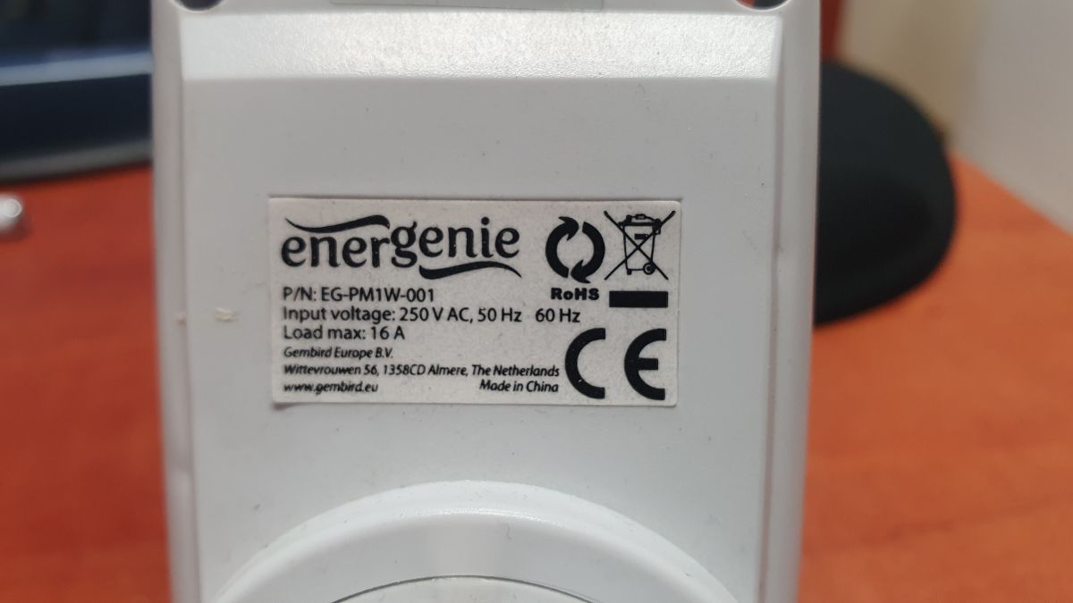

  • RT5350F smart socket candidate for flashing
    #885 20155106
    Dark Man
    Posts: 74
    Rate: 20
    I would do the same if I did not have hot air :)
    It is true that the module that I desoldered WBLC9 had pins / pads on both sides, so it would be more difficult, but it would probably work :)
    (can be combined with a pen dust extractor or a copper braid)
    Yes, I had this LSC floodlight with ADC. Then I did a transplant on the ESP-12 module. It is true that, from what I remember, motion detection worked strangely (even on Tasmot) - it detected one time and the LEDs could turn on without motion. I put it somewhere at home to mount it for tests (not in the workshop), somewhere outside, only temporarily sealing the sensor housing, but when I put it, it has not been installed since then :D
    And the time will come for her someday :P
    Added after 1 [hours] 59 [minutes]:
    In my resources I found a quite old Smart socket that I used at the beginning of my adventure with smart home.

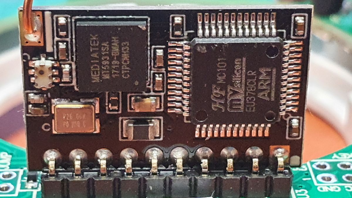

    energy EG-PM1W-001
    Ralink RT5350F chip
    + probably memory bone
    From what I remember, the interface was via a browser plus some manufacturer's cloud
    I remember that the interface was clunky and very heavy, so you didn't feel like using it.
    Do you know anything related to the chip type?
    Maybe something fresh could be uploaded there? :)
  • RT5350F port possible but low priority
    #886 20155339
    Posts: 14724
    Rate: 12807
    I do not know this RT5350F chip, but from what I can see there are even open hardware projects on it:
    https://www.olimex.com/Products/OLinuXino/RT5350F/RT5350F-OLinuXino/open-source-hardware
    https://www.olimex.com/Products/OLinuXino/RT5350F/RT5350F-OLinuXino-EVB/open-source-hardware
    Some SDKs are also:
    https://github.com/search?q=RT5350
    You could probably make a port, but unfortunately, as long as only one socket with this system is known, I do not know if I will find time for it, because there are more popular systems and features to be added in the queue.
    And as for this ADC floodlight, how much did it cost and what exact model was it? I think I will buy something to test on the ADC on BK7231, because so far I have only tested "artificially" by connecting the potentiometer to the Tuya 4CH relay controller board

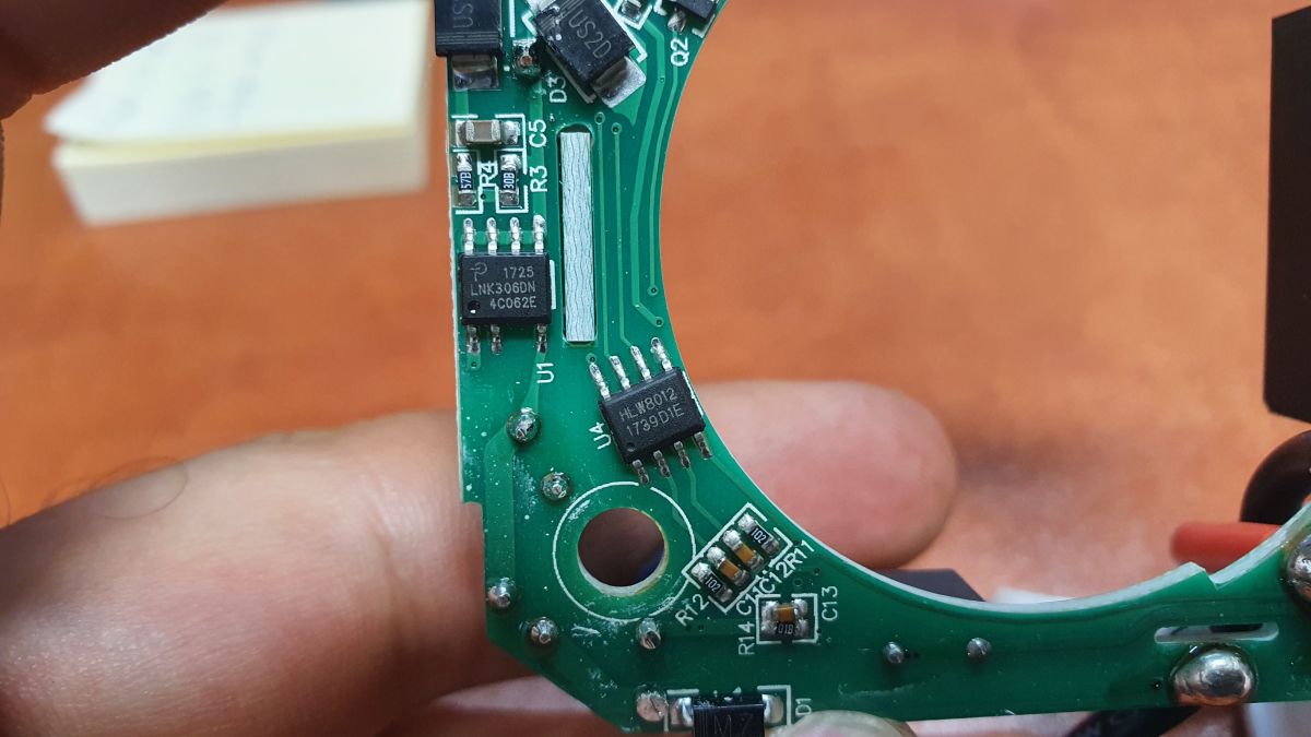

  • Found Ferguson FS2PG with HLW8012 and ESP12 paths
    #887 20155365
    Dark Man
    Posts: 74
    Rate: 20
    Some SDKs are also:
    Okay, no need to play with the old socket, there are other newer ones :)
    And as for this floodlight with ADC, how much did it cost and what exact model was it? I think I will buy something to test on the ADC on BK7231, because so far I have only tested "artificially" by connecting the potentiometer to the Tuya 4CH relay controller board
    This is exactly this:
    https://www.action.com/pl-pl/p/reflektor-led-lsc-smart-connect/
    Price PLN 45
    Power 20W 1500lumens
    I would like to remind you that all control with the Beken system is in a protruding housing with a PIR sensor :)
    I found another socket in the scraps.
    This time it
    Ferguson FS2PG - 16A with current measurement on HLW8012
    https://ferguson-digital.eu/produkt/inteligentne-garówka-wi-fi-fs2pg/
    It was also waiting for better times, because there is an ARM system in it and a second Mediatheque :)
    I will not combine with an unknown chip, but I am already preparing ESP12 for it, because I have already found the paths :P

    Added after 8 [hours] 30 [minutes]:

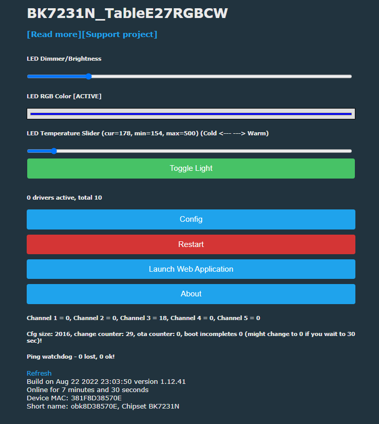

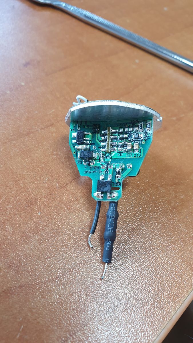

    R: P8 PWM 1
    G: P9 PWM 2
    B: P24 PWM 3
    C: P26 PWM 4
    W: P7 PWM 5
    https: // www.action.com / en-pl / p / intelligent-multicolor-led-lsc-smart-connect3-led-bulb
    Intelligent multi-color LED bulb LSC Smart Connect
    470 lumens
    5W
    E14
    case model: 970721

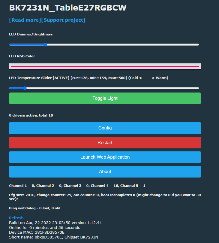

    I have a problem with the software of the bulb - it loses Wifi connectivity after trying to control the Home Assistant via MQTT.
    This is exactly how:
    Appears on the network after approximately 15 seconds after connecting to the power supply. It can still be controlled via the GUI in the browser. It connects to the MQTT broker and is visible in the Home Assistant.
    With any command sent, e.g. turn off, change color or brightness, immediately the bulb disconnects from the Wifi network (it cannot be pinged) and does not come back anymore, unless I disconnect its power and turn it on again.
    Firmware version: Build on Aug 19 2022 10:42:51 version 1.12.39

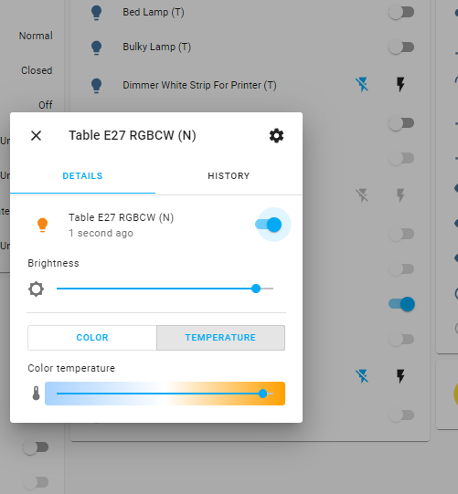

    HA configuration:
    - name: "obk42E97C5D RGBCW"
      unique_id: "OpenBK7231T_42E97C5D_light_rgbcw"
      rgb_command_template: "{{ '#%02x%02x%02x0000' | format(red, green, blue)}}"
      rgb_state_topic: "cmnd/obk42E97C5D/led_basecolor_rgb"
      rgb_command_topic: "cmnd/obk42E97C5D/led_basecolor_rgb"
      command_topic: "cmnd/obk42E97C5D/led_enableAll"
      availability_topic: "obk42E97C5D/connected"
      state_topic: "obk42E97C5D/led_enableAll/get"
      payload_on: 1
      payload_off: 0
      brightness_command_topic: "cmnd/obk42E97C5D/led_dimmer"
      brightness_scale: 100
      brightness_value_template: "{{ value_json.Dimmer }}"
      color_temp_command_topic: "cmnd/obk42E97C5D/led_temperature"
      color_temp_state_topic: "cmnd/obk42E97C5D/ctr"
      color_temp_value_template: "{{ value_json.CT }}"

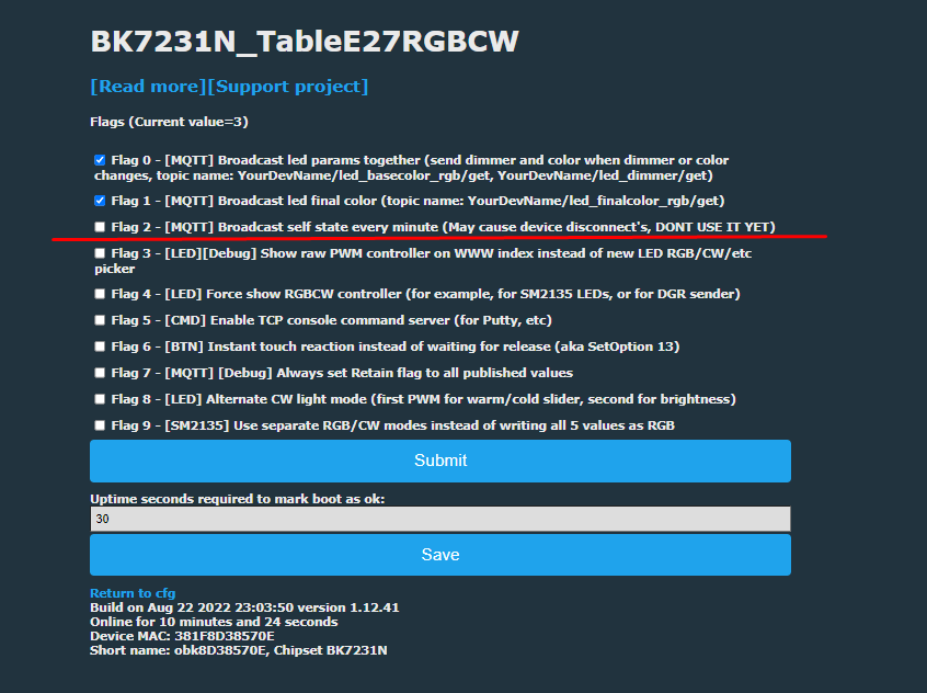

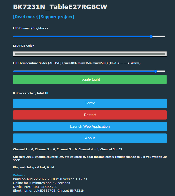

  • #888 20156410
    Posts: 14724
    Rate: 12807
    Today I fixed one problem on some devices in rare situations, but I don't know if this is the bug you are seeing.
    Would you be able to give the whole log or somehow narrow down the situations, define what's breaking?
    and if you enter the command via the console (e.g. this is led_enableall) or led_basecolor_rgb it is also a problem?
    What flags do you have on?
  • GUI commands do not break MQTT connectivity
    #889 20156418
    Dark Man
    Posts: 74
    Rate: 20
    Commands sent in the GUI do not break connectivity
    I checked: led_enableall and led_basecolor_rgb
    the change from HA no longer generates the logo because there is a loss of connectivity immediately
    Info:MAIN:Time 44, free 102752, MQTT 1, bWifi 1, secondsWithNoPing 0, socks 4/38

  • #890 20156650
    ferbulous
    Posts: 419
    Help: 8
    Rate: 56
    @p.kaczmarek2
    Hi, I browsed a few posts back and apparently I might need to use togglechannel for my buttons
    I tried that, but it's still not toggling the relays
    Anything else I need to add in the custom command
  • Test DigitalInput pins and check PCB pull resistors
    #891 20156687
    Posts: 14724
    Rate: 12807
    @ferbulous it should work in this configuration. Are you saying that the device is not able to discover the change in pin state?
    Ok, so do two things.
    1. Set those pins to DigitalInput (with pull up and without - test both cases) and see if the OpenBeken is able to read the state on those input pins (1 or 0, depending whether button is in ON or OFF state)
    this obviously is not a final solution but it's a way to determine whether the wiring is correct
    2. Check the PCB tracks to determine whether there are some extra components on those tracks, like pull down or pull up resistors
    PS: I fixed a serious HTTP crash last night, but haven't yet time to test on all devices, so wait a day or so with updating to latest build
  • Checking PCB tracks for pull-up or pull-down resistors
    #892 20157309
    ferbulous
    Posts: 419
    Help: 8
    Rate: 56
    Relay
    L1 - P24
    L2 - P17
    L3 - P26
    L4 - P6
    Remaining pins:
    P14 - reset button, set to button 1 triggers relay 1
    P16
    P7
    P8
    P9
    P15
    P28 - could be for buzzer? when I setup as button 4, it was toggling relay 4 on and off, like a wifi led that's blinking behavior I think?
    Tried assigning remaining pibs P7, P8, P9 & 15 for digitalinput & digitalinput_nopull up
    It does toggle the relays on when I assign digitalinput & relays off for digitalinput_n. Same goes for digitalinput_nopullup
    Toggling the physical buttons doesn't trigger anything yet so far
    --Update--
    Pin 14 - Reset button on the wifi module, set to button 1 triggers relay 1
    How can I check for that?

  • MQTT led_enableAll command breaks connection
    #895 20157914
    Dark Man
    Posts: 74
    Rate: 20

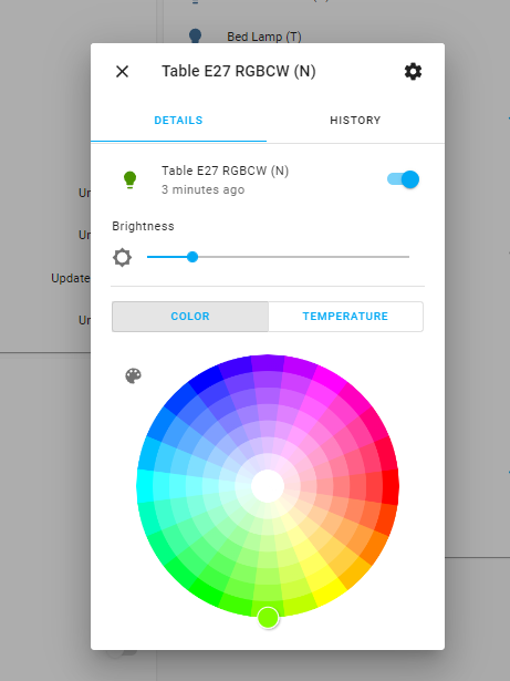

    I'm making progress. Here's what I was able to deduce from HA, MQTT, ICMP and GUI debugging:
    - I do not have access to UART
    - the new build didn't change anything for me
    - I did not turn off PWM in OpenBK, because I started to play with the configuration in YAML in HA
    - I think that the generated YAML code (in GUI) for PWM channels should look different (after many tests on one channel):
    - unique_id: "OpenBK7231T_42E97C5D_light_1"
      state_topic: "obk42E97C5D/1/get"
      command_topic: "obk42E97C5D/1/set"
      brightness_command_topic: "obk42E97C5D/1/set"
      brightness_state_topic: "obk42E97C5D/1/get"
      on_command_type: "first"
      qos: 1
      payload_on: 100
      payload_off: 0
      retain: true
      optimistic: false
      availability:
        - topic: "obk42E97C5D/connected"
    (of course replacing the abbreviated name and channel number)
    Thanks to the above code, we have the real status of the PWM channel, we can control the on / off, we know the real state of on / off (come on, and here it would be better to fix OpenBK to add the PWM channel status as 1 if it is set from 1 to 100 and the status 0 if PWM is 0
    eg: obk42E97C5D / 1 / state 1 | 0
    - while I found a possible reason for breaking the connection: OpenBK is not able to process the led_enableAll command sent by MQTT in the subject
    cmnd / obk42E97C5D / led_enableAll
    after sending a test in "MQTT Explorer" with a value of 1 or 0, the bulb breaks the connection.
    If you can fix it, I will test it further and make YAML code for the generator.
