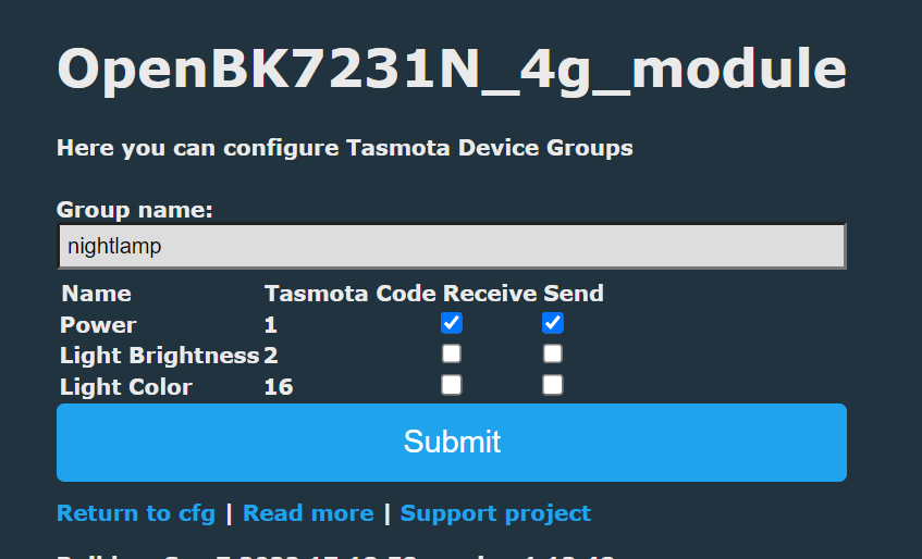

  • DDP support for wireless WLED bulb control
    #908 20173332
    staszek_org
    And what is the division of duties between the chief inspector and a single lead teacher?
    The easiest way would be to add the required stuff to OpenBeken, as it would also work right away on BL602 and W800 and other supported platforms.
    DDP has already been submitted for implementation by one of the US users and will be done as a very simple protocol.
    Could you please mention which functionalities of this WLED you use?
    @ darkman1 could use a UART log, so do older versions have this problem?
    I send DDP from ESP32 (works like a controller for 10 bulbs) with WLED installed:
    https://www.youtube.com/watch?v=d0ow9qJT8Ak
    https://kno.wled.ge/advanced/ddp/
    Then these bulbs are like virtual addressable LEDs (something like sk6812) for the main ESP32 controller, only connected wirelessly.
    And this is connected to the LEDFX installed on the computer so that it reacts to the music (I will just try with xLights).
    Of course, you can connect more controllers and 10 light bulbs each for more light sources.
    That is:
    A computer with LEDFX, xLights or Hyperion NG installed (if you add support for real time UDP) controls the ESP32 chip on which WLED is installed (so as to wirelessly receive commands from the computer), and then ESP32 continues to send wireless control instructions to specific incandescent lamps (DDP is a fast protocol, so good for it).
    For the computer, the bulbs themselves are seen as ESP32 with WLED installed and 1 pixel long SK6812 (or WS2812) LED strips directly connected (as if 10 separate addressable LEDs were wired, even though they are bulbs wirelessly connected via DDP).
    I have sent a more detailed description to priv.
    Regards. :)

    ferbulous
    Posts: 419
    Help: 8
    Rate: 56
    @p.kaczmarek2
    Hi, so I'm testing the device group again but it's not working for me
    Added group 'nightlamp' which is the group for for my 4 tasmota bulbs & 1 tasmota switch.
    But turning off the tasmota/bulbs does not toggle the relays for the openbk device and vice versa.
    I don't see anything much in the logs though

    ferbulous
    Posts: 419
    Help: 8
    Rate: 56
    @p.kaczmarek2
    Here are the settings
    [BK7231T] My HTTP server, configurator, MQTT support from Home Assistant [BK7231T] My HTTP server, configurator, MQTT support from Home Assistant
    For the bedroomswitch,i use devgrouptie and assign the 3rd button for the group
    How do I modify this command line for my device?
    DGR_SendBrightness roomLEDstrips 128
    DGR_SendPower testSocket 1 1
  • DGR_SendPower binary relay state encoding
    #926 20181940
    Posts: 14795
    Rate: 12944
    This will send power state 0 for nightLamp assuming that nightlamp has 1 relays
    DGR_SendPower nightLamp 0 1
    This will send power state 1 for nightLamp assuming that nightlamp has 1 relays
    DGR_SendPower nightLamp 1 1
    If you have multiple relays, for example 4, you do something like:
    DGR_SendPower nightLamp 7 4
    This will send for nightlamp 4 relay states (4 is a number of relays) with power states encoded as binary 7, 7 is a binary 1 + 2 + 4 , it's 0b0111, so first 3 relays will be ON and fourth OFF

    As for DGR command line this is what I'm getting
    Debug:API:POST to api/cmnd
    Debug:CMD:cmd [DGT_SendPower nightLamp 1 1]
    Error:CMD:cmd DGT_SendPower NOT found (args nightLamp 1 1)
    Debug:CMD:cmd [DGT_SendPower nightLamp 0 1]
    Error:CMD:cmd DGT_SendPower NOT found (args nightLamp 0 1)
    Debug:CMD:cmd [DGT_SendPower nightLamp 7 4]
    Error:CMD:cmd DGT_SendPower NOT found (args nightLamp 7 4)
  • Typo in command name and relay index question
    #928 20182539
    Posts: 14795
    Rate: 12944
    It seems there are multiple problems to solve. We will try one by one.
    You have a typo in command name - DGT instead of DGR
    ferbulous wrote:
    Info:DGR:Received 25 bytes from 192.168.1.158
    Info:DGR:Received 25 bytes from 192.168.1.198
    Info:DGR:Received 25 bytes from 192.168.1.199
    Info:DGR:Received 25 bytes from 192.168.1.53
    If you say "toggling Tasmota don't toggle Beken", I need to know, if the Tasmota IP is on this list?
    Or to phrase it differently - are Tasmota packets seen by Beken?
    Question: do you Beken relay indices start with 1 or with 0? Code expects them to start with 0.
    ferbulous wrote:
    3) Toggling on relay from openbk turns off the nightlamp group devices (invert?). Toggling off relay from openbk doesn't do anything.
    Unless it's a byproduct by some other book, then you can use Relay_n pin types in OpenBeken to mitigate it.
    If issues persists, I will try to setup myself a 4 relays scenario and check this on my own.
    EDIT: What exactly are you trying to do? Do I understand correctly - you have 3 separate lamps and a single 4 button device and want to control 3 separate lamps by single device? I'd need to get in-depth explanation.

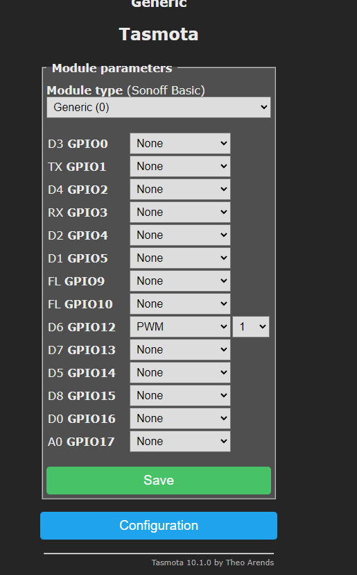

    OK OK, wait a minute, I think I suspect where one issue might be.
    I haven't used devgrouptie, but now I'd worry that OpenBeken sends a packet with numRelays = 4 and binary (4 bits) mask for relays to all lamps and devgrouptie acts like each group is a separate group of relays with numRelays = 1 and binary (1 bit) mask.
    If that's the case, then it won't work now with this approach.
    The correct approach for you could be scripting "onChange" listener and doing DevGroupSend...
    but maybe let's check this first.
    Can you show pins configuration of each Tasmota bulb?
    I mean this:
    And to phrase question differently: do you always have "1" on each bulb selected, or does bulb 1 has 1, bulb 2 has 2, bulb 3 has 3?
