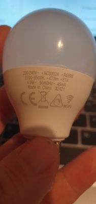

    @p.kaczmarek2 thx put sensor projact on hold until battery (sleep function add draining battery fast).
    new project ldv bulb RGBCW with drv_bp1658cj pinout is gpio8 is data and gpio24 is clock
    but not working dosent do anything some driver isu or somthing did maping to 1 0 2 3 4 any help apriciated.

    @azavialov I am not at home right now and I can't check your fix, but at least one of your setting seems to be duplicated:
    @botioni did you enable "force show rgbcw controller" flag?

    Yes flag 4 and 12 enabled ther is a therdown of a hama gu10 bulb on forum I folowd it but pinuts are not the same I configured it acording what is in the bulb I have one open thet is was broken and 1 thet is flashed with tcc the broken I can see pinout and IC

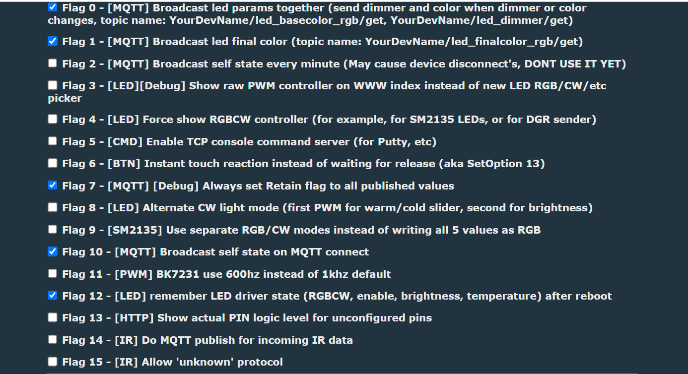

    Posts: 48
    @exploware all of that shall work.
    Option to remember LED state:
    pins config CW:
    gui for CW:
    I will update comment on the Relay saving page.
    Indeed, this works, I just confirmed it in my setup. Thanks!

    Thank you, that comment saying "LED saving state not supported yet" was a left over on our part, we have also updated this comment.

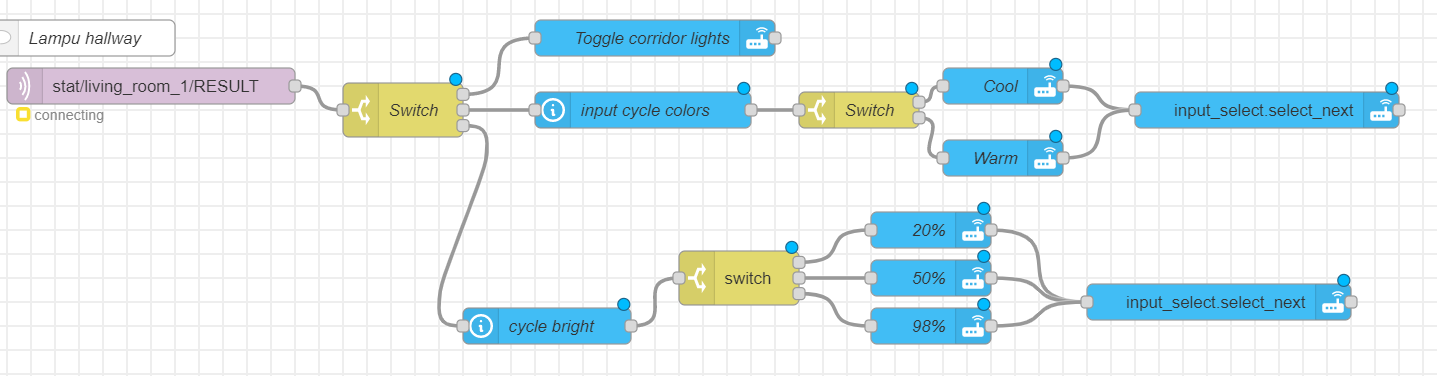

    Maybe we could try catching both first press of button and setting a variable to 0 there, then catch each hold and increase variable on each hold. But that would send a lot of packets. I will try it for you, wait...
    but what are you trying to achieve? Why not simply two buttons, one for brightness up and second for down?
    Indeed, that's a better solution for wall switch with more than 2 buttons.
    How does that work? Does it mean the longer I hold, the higher the variable increases,
    i) It sends brightness variable after I release button or
    ii) It keeps sending the brightness variable as I keep holding the button
    What I was trying to achieve was for 1 button wall switch.
    My nodered flows is this:
    Click - toggle lights on/off
    Double Click - toggle between cold & warm light
    Hold - Cycle between 20%, 50%, 90% brightness <-- using hold action to just cycle different brightness. using input helper,the flow retains the last brightness toggled, so if it was 90%, another hold action cycles/reset back to 20%. Next hold is 50% and so forth.
    https://pastebin.com/nmfPHqcB

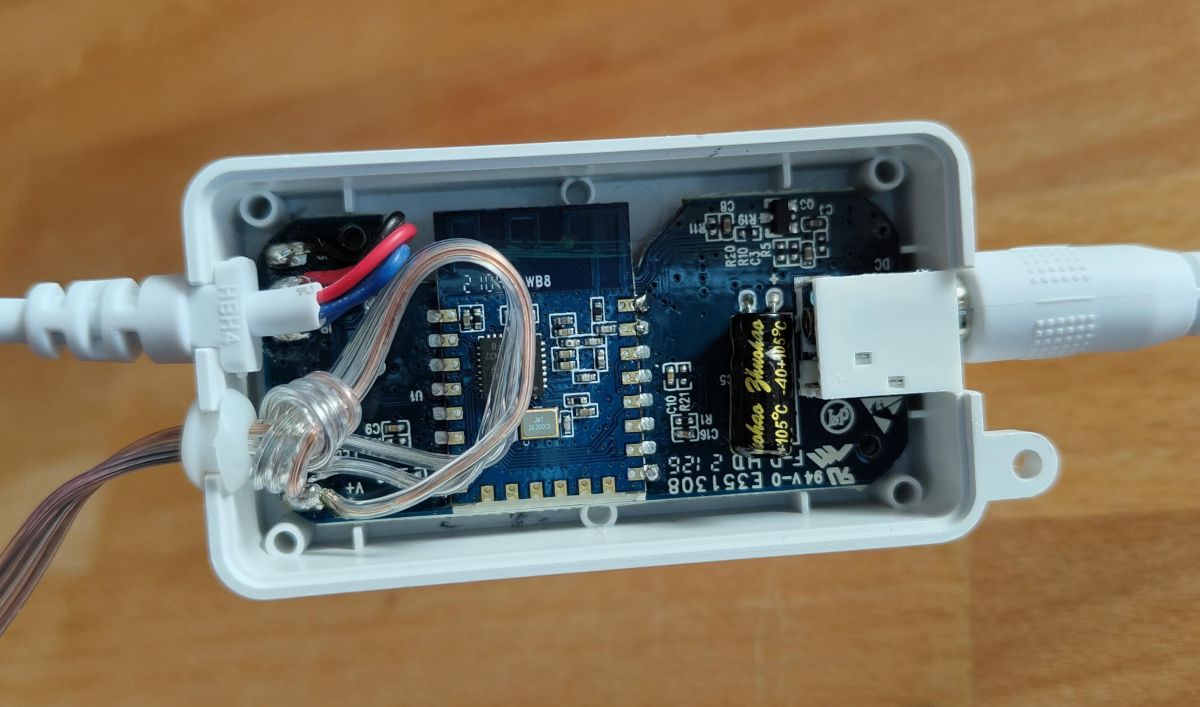

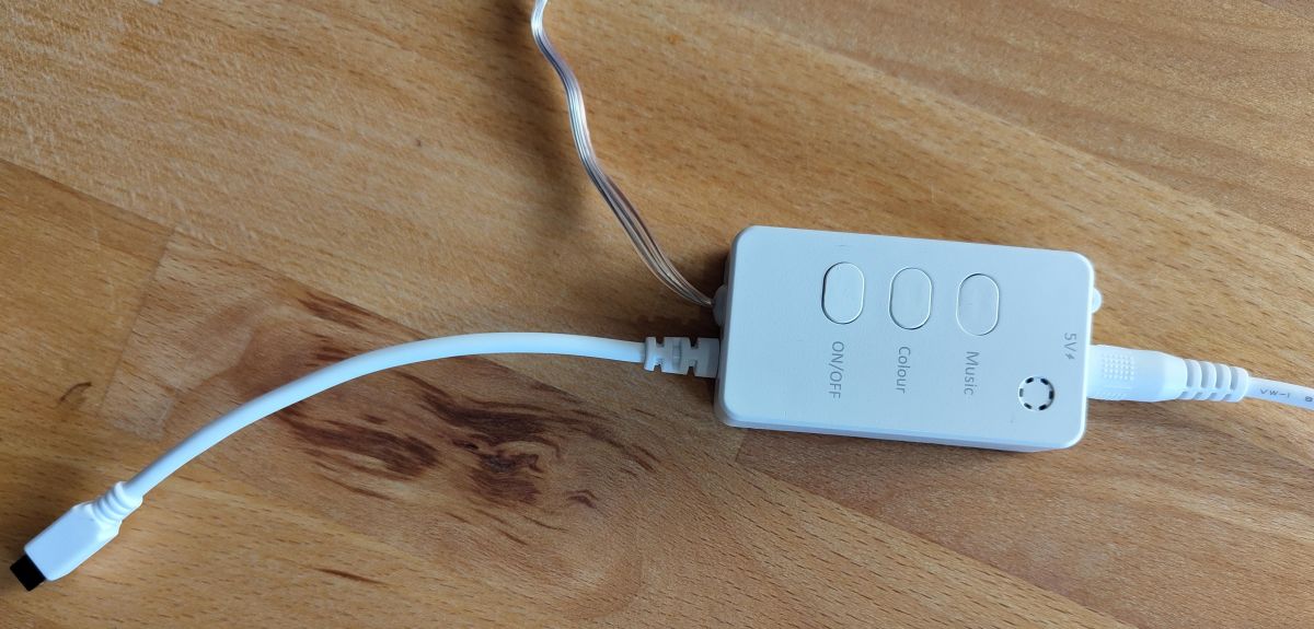

    Hi, can you help me with the new device?
    I have a lamp - https://www.aliexpress.com/item/1005004319893210.html
    BL602c20 has inside, I flashed OpenBL602_1.14.90, the controller started, but the control of the lamps turned out to be through UCS1912S led driver chip. And I don't know what to do next.
    I have already identified all GPIOs.

    botioni
    Posts: 17
    Ledvance bulb done
    Startup command
    BP1658CJ_Map 2 1 0 3 4

    yonnit
    Hi,
    a while ago, I purchased these fairy lights:
    I successfully flashed them with OpenBeken, but I had no luck configuring them so far and was hoping I could get some help here :)
    My device looks pretty similar to that one here: https://www.elektroda.com/rtvforum/topic3866123-330.html#19932845
    But instead of having 3 outputs for R G B mine only has one labeled LED. I think because they are individually addressable LEDs.
    I tried tracing the connection labeled LED with a multimeter and marked the pin on the WB8 chip on the attached picture.
    Here are some pictures:
    [BK7231T] My HTTP server, configurator, MQTT support from Home Assistant [BK7231T] My HTTP server, configurator, MQTT support from Home Assistant [BK7231T] My HTTP server, configurator, MQTT support from Home Assistant [BK7231T] My HTTP server, configurator, MQTT support from Home Assistant
    Please let me know if I can provide any additional information or pictures that could help!
  • #1013 20267694
    Posts: 14725
    Rate: 12809
    @yonnit I can get a driver for you for that device, but are you able to determine what kind of LEDs are used there, or at least tell us if they were able to have different colors (each LED different color) with Tuya firmware?
    I'd suspect they are ws2812b.

    ferbulous
    Posts: 419
    Help: 8
    Rate: 56
    @p.kaczmarek2 hi, there's this odd thing happening when I'm choosing colors, the brightness keep changing.
    As for the warm & cold lights, changing the brightness also changes the rgb bulb color icon (not actual warm & cold lights) for some reason.
    Anything else I need to enable in the general settings to fix this?
    Btw, I just reset one of my switch and 1 bulb and both are getting the same mac id:
    Device MAC: C8:47:8C:00:00:00
    I tried changing the switch mac id by grabbing random mac address from mac generator but now it's no longer connecting to wifi.
