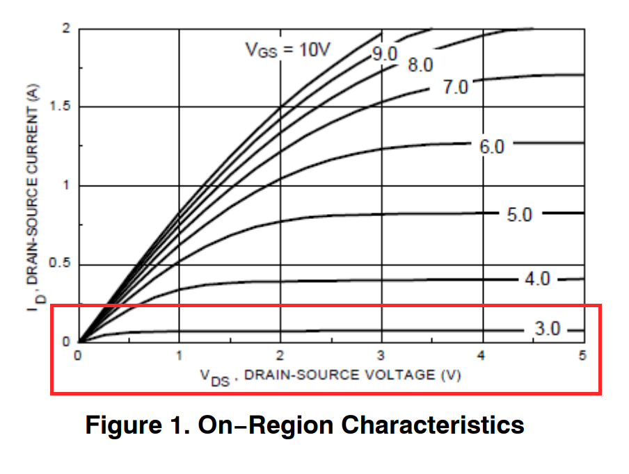

    spec220 wrote:
    Even if you want to switch on individual branches, you still have to refer to something to maintain the set current. By the way, there are 3 branches, because there are 3 different thresholds for the load capacity of the output itself, while the same current stability in a given threshold is responsible for the source that will prevent the maximum current value from being exceeded for this threshold.
    I don't have to refer to anything - each transistor can act as a current source in a certain operating range.
    It is enough for it to have the appropriate output characteristics.
    Example: BS170
    System for 1 USD * - TV remote control by piotr_go
    At a certain voltage Ugs, the Id current is constant, regardless of whether the diode is on or not.
    The voltage at the gate changes in proportion to Vcc and the current Id changes.
    spec220 wrote:
    I specialize in analog.
    As an analog specialist, you should know this.

    spec220 wrote:
    Power up the gate and connect different loads with the same voltage. while
    I see that a specialist in the analog of the basic characteristics of a transistor cannot read.

    spec220 wrote:
    Characteristics where the dependence on the different Robc is not shown.
    Dude, this is pure saturation characteristics of the transistor, not the so-called dynamic.
    A load of crap. You read the current for a given Vgs and a load resistance of zero ohms.

    spec220 wrote:
    anyway, drive the gate of such a transistor with 5V and you will see what happens when the drain is fully shorted
    Which means what?
    As for the system discussed in the topic, I dare to assume that the drain current of the output transistor will have a value of about 23 mA at Ugs equal to 5 V #twenty

    Spec220, there is nothing to fight for.
    First, primo :) when you power the 3.3V or even 5V system, you will not get Ugs 10V, maybe 4.5V in gusts.
    Secondly, take a look at the characteristics of low-power transistors, once I wanted to use BS138 to control displays and I had to throw a series resistor from the display segments, because Rdson for some pieces was several dozen ?.
    Thirdly, simple current sources on Mosfets are made by throwing a resistor into the drain and connecting the gate to ground, but you probably know this from analog circuits (of course, the transistor must conduct at zero voltage on the gate, in amplifiers, for example, BF245 is often used as a source for a differential pair ).
    I don't remember many of the US technologies, but there is usually a problem with obtaining high resistances, in the times when I was learning it, it was common to use sources on Mosfets instead of resistors, which results in a non-linear output characteristic.
